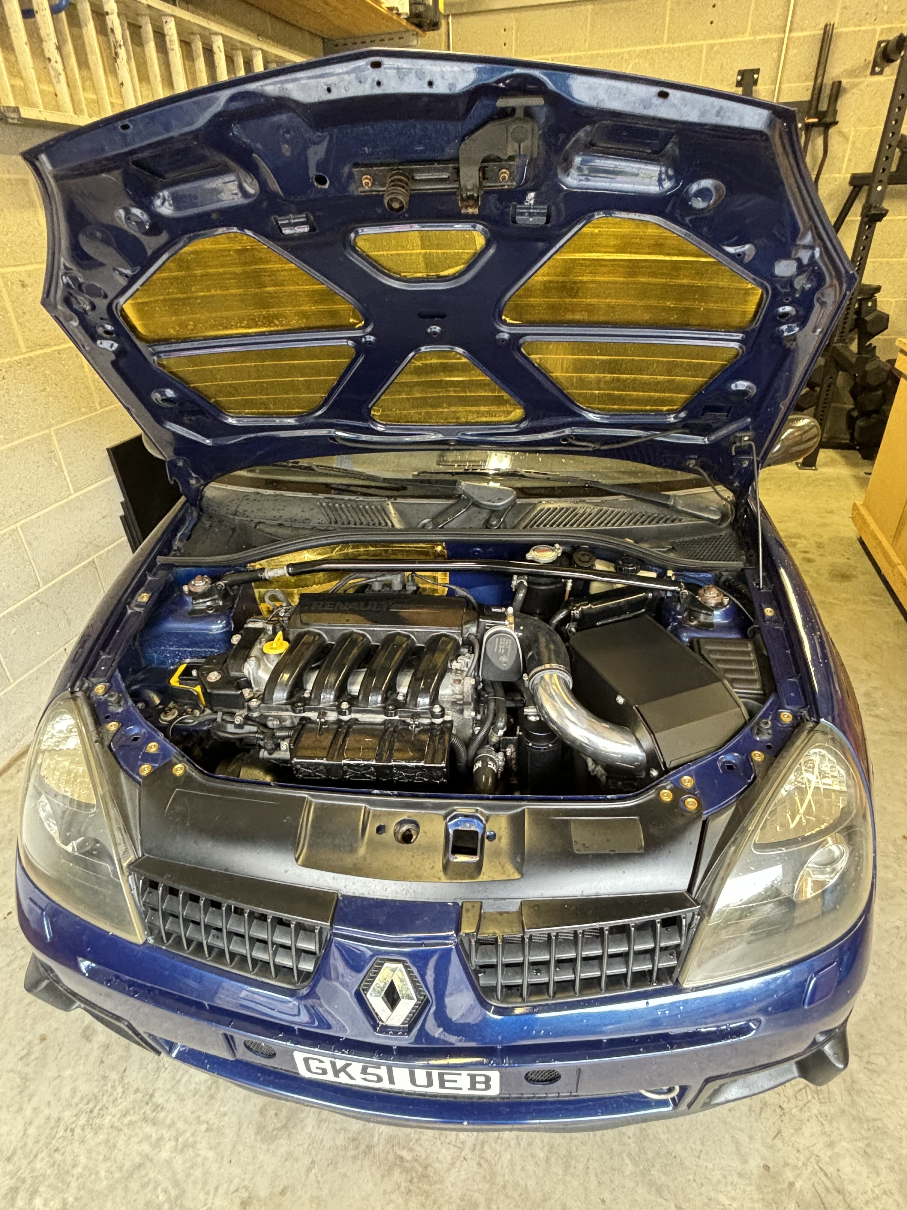

Also made a bit of a DIY induction kit with a lightweight battery

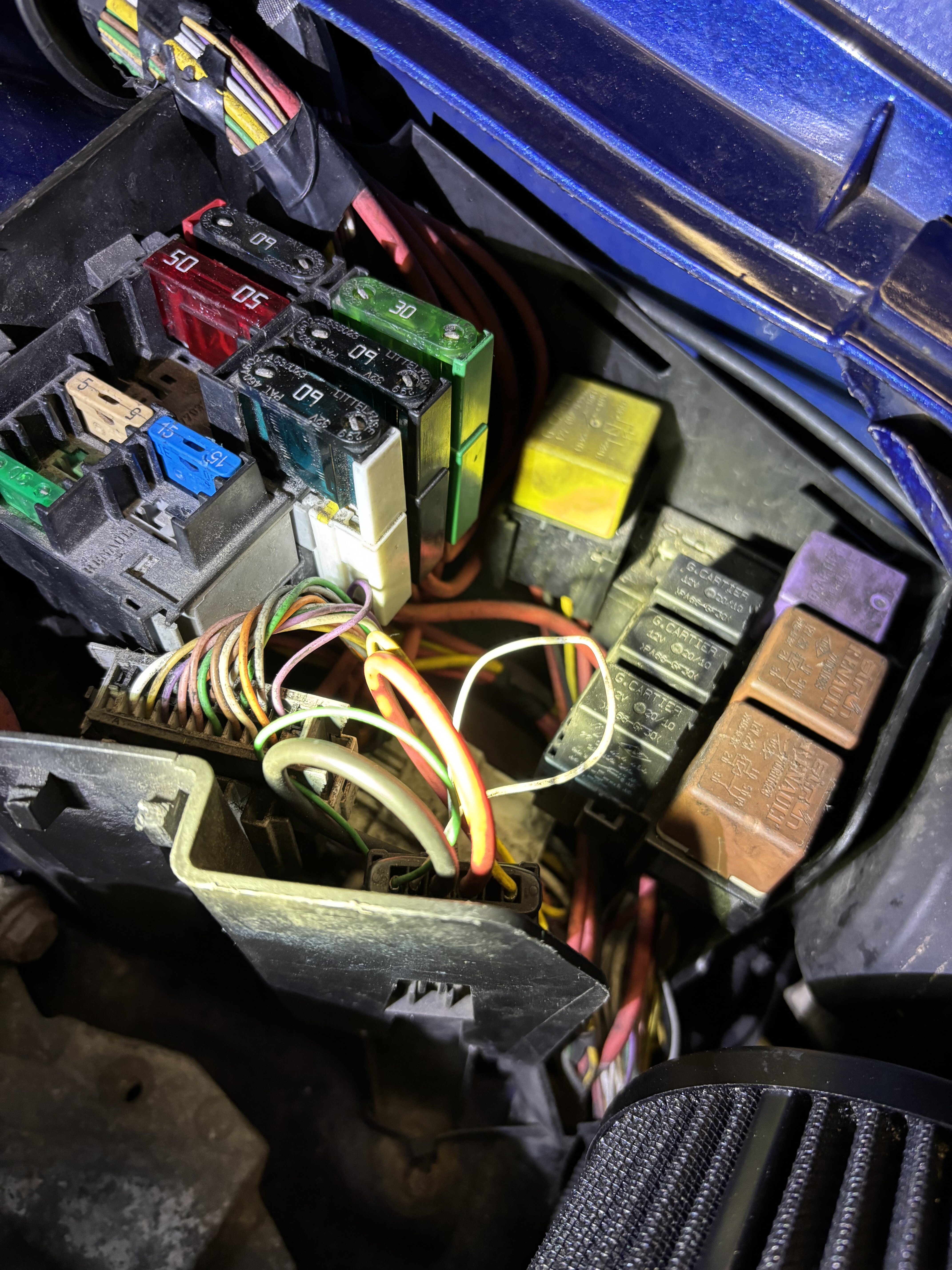

The relays I jiggled around last time which may of made a difference were the 3 little black ones in this pic (above the brown ones)
I feel like I’m looking for a fuel relay issue - are any of these fuel relays?
Any advice? I’m a very amateur mechanic so be kind! I’m determined to sort it without going to a garage if possible though…
I've got a 2005 182 but the relay board is the same from what I can see, only my relays are all Brown.
Those 3 smaller Black relays are for injectors, cooling fan and starter motor. The two bigger Brown relays are for fuel pump and fans (A/C) and the purple relay is for the fan blower inside the cabin.

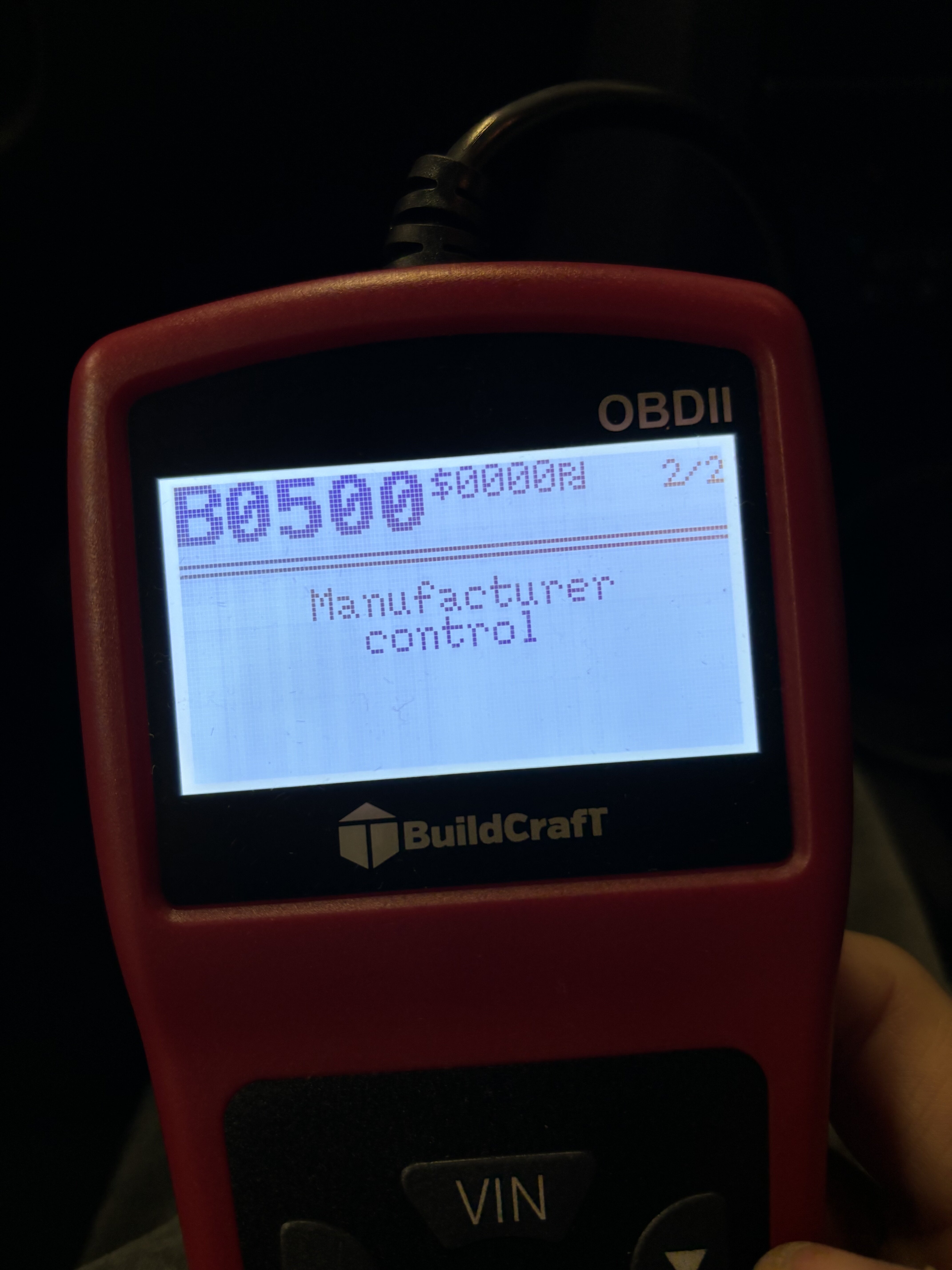

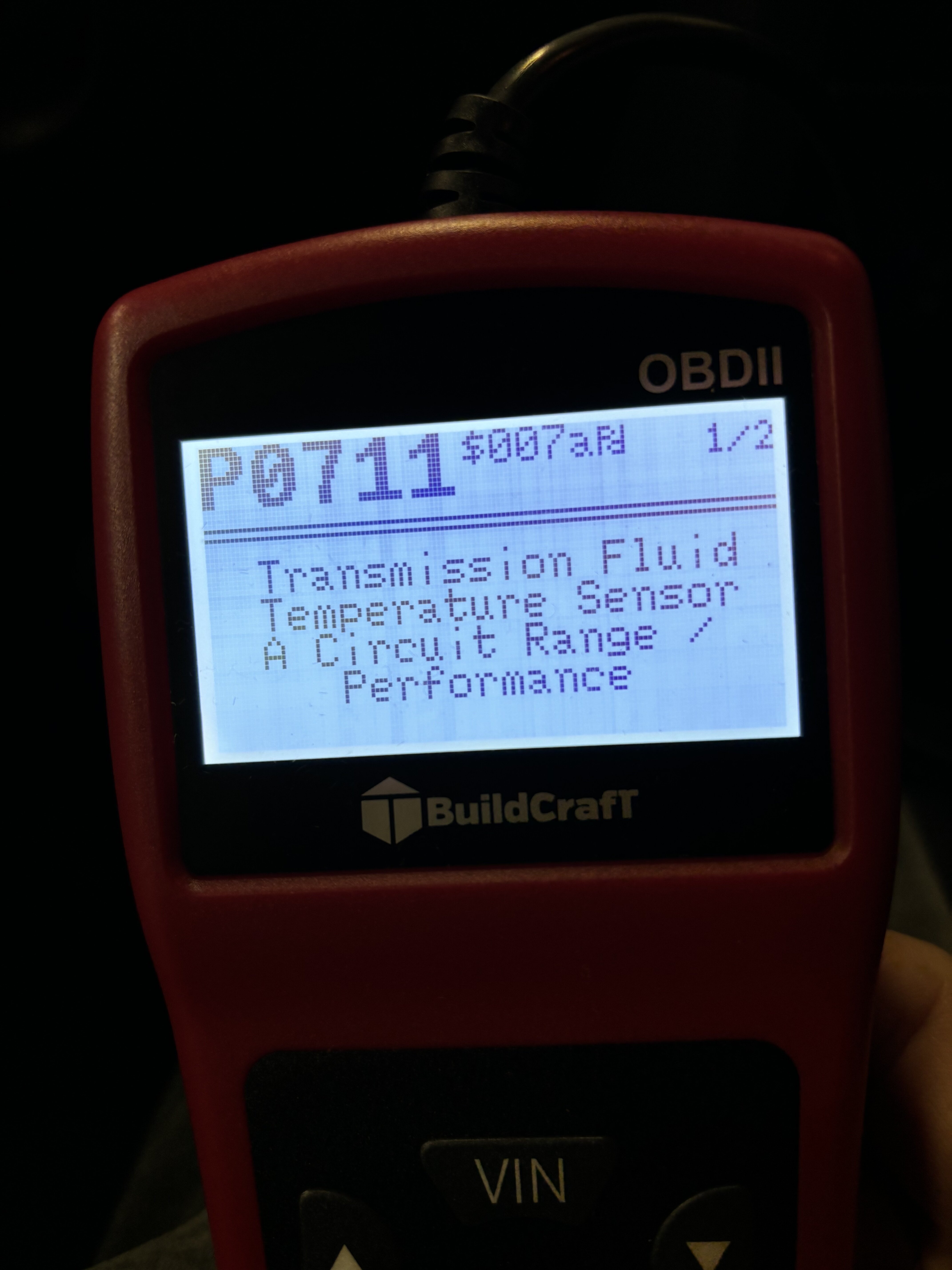

I have a cheap code reader and it’s come up with the following:
From some quick research this one doesn’t look like it’s anything (could be wrong though)
It’s also come up with this
Again an initial google is coming up with Crank sensor - could this be why it’s turning over but not firing?
Where is the crank sensor on a Ph2 172, does anyone know and how easy is it to change?

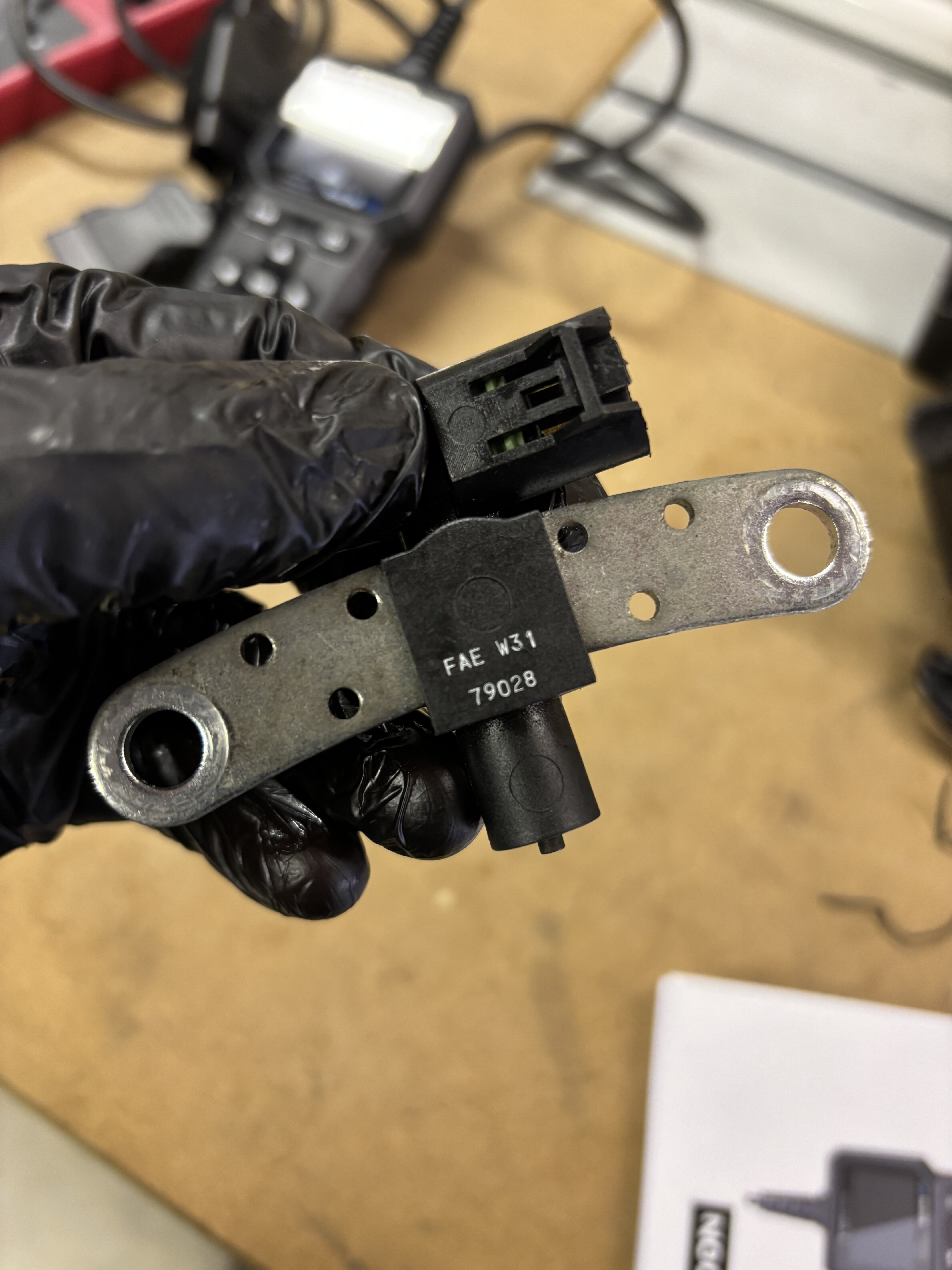

Further update…
Crank sensor located, removed and cleaned and put back - still cranking but not firing 🤬
Worth buying a new one does anyone think? Do these just fail over time I’m guessing?
Cheers
Those cheap code readers always show those two codes on these. Nothing useful there unfortunately.
