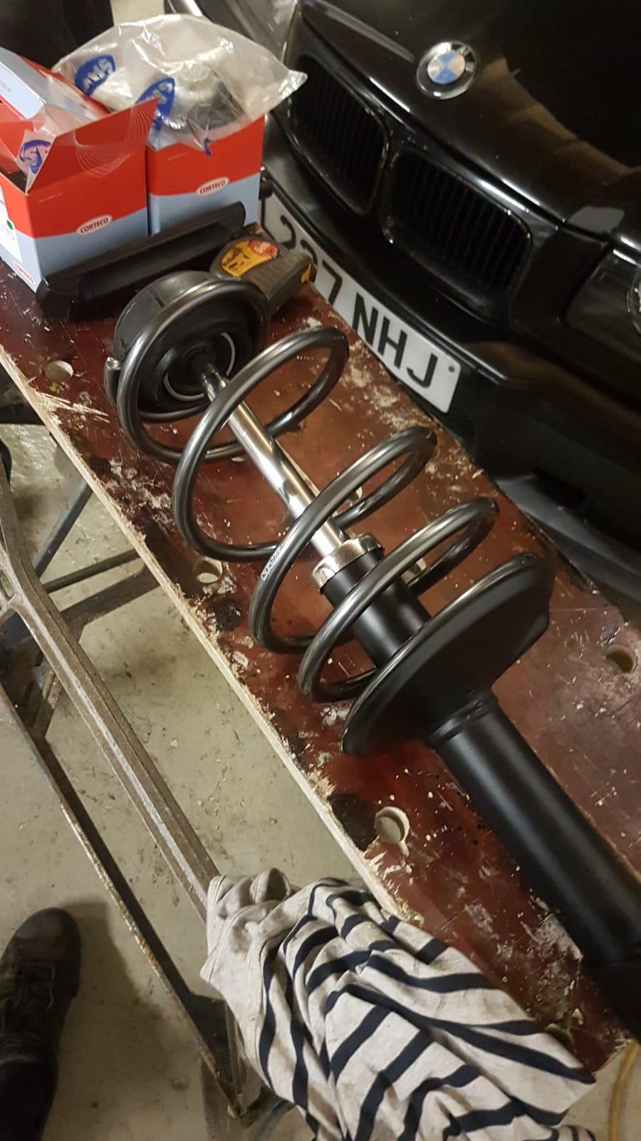

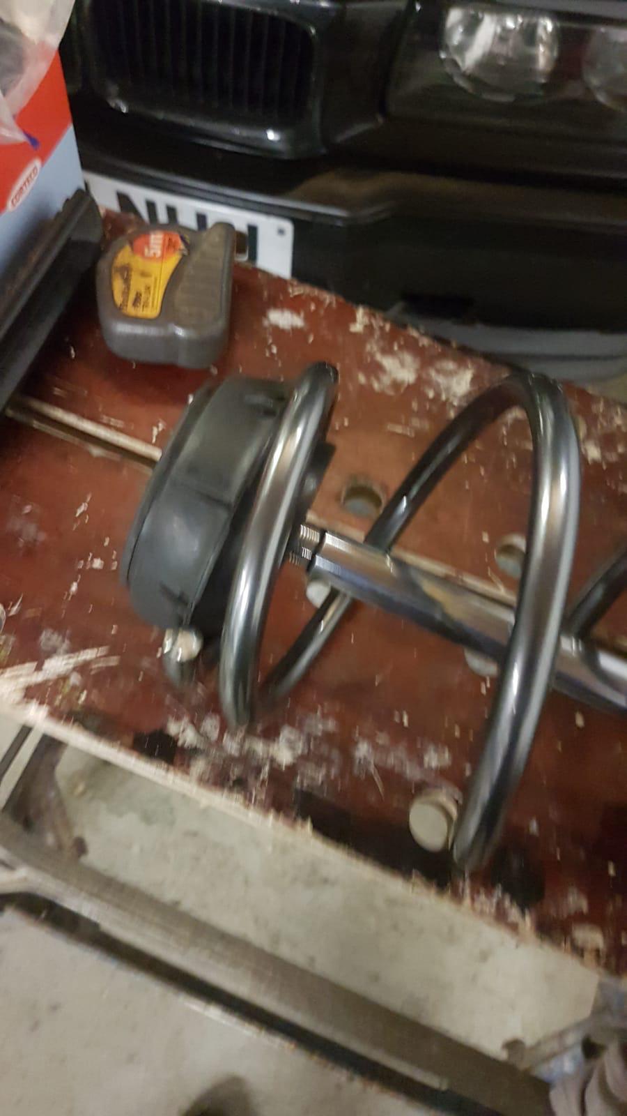

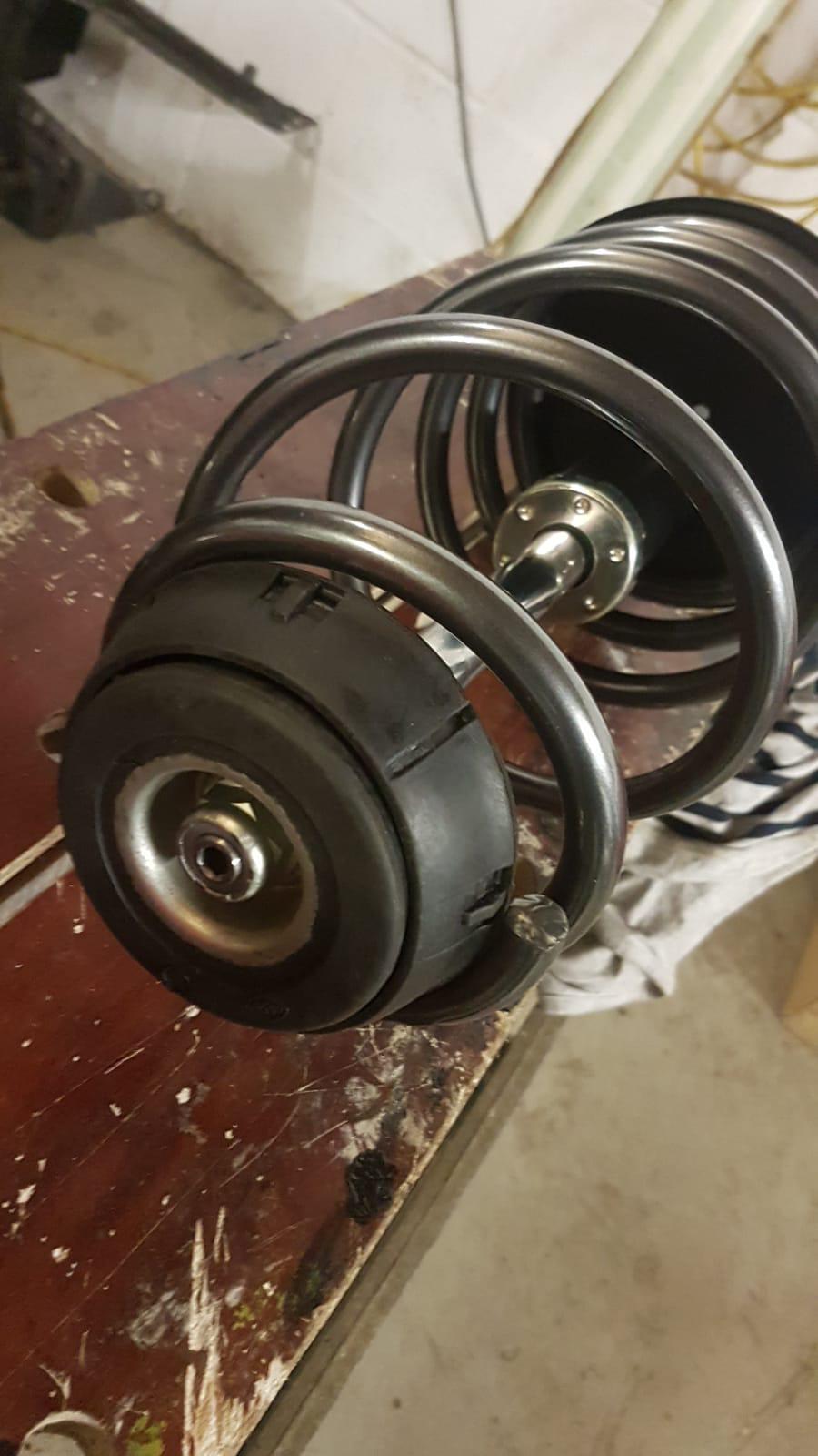

Does this seem right. Don't seem to sit properly

your missng the top hat that seats the spring. dontput them on the car whatever you do, as soon as you set off th car will be about 100mm lower
Brilliant trolling, you had me for a second there...oh wait you're serious! :LOL:
Basically what @ZachB said, your missing the plate that sits on top.

Lol. Only asking as I ordered the top mounts from a car parts place as the whole top mount kit and that's all they sent me, and they saying they don't provide the plate I need. Does anyone have a link from a euros etc for that part only.. I phoned main dealer but they can't get the part till Monday earliest.
Cheers
Dont you have the original ones from the car? Im not sure exactly what they are called but you should put up a wanted thread for them
