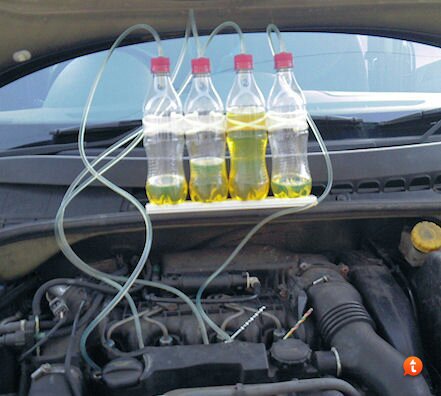

Try adding some easy start and see if the rail pressure reading ramps up. I'd also consider a leak off test as it may be a faulty injector on No.3 causing the drop.
  Clio DCI80
Yeah good idea that would be just like bumping it I.e. factoring in some compression right? I've had her fire on easy start but didn't take any data I'll try that tomorrow night. How do I do a leak off test and which injector is no. 3? Thanks for the advice
MicKPM
ClioSport Trader
  Clio16v/Zoe Z.E.50
Cylinder 1 is always flywheel side on Renault engines. To carryout a leak off you will need a test kit (you can make one with some tubing and a bottle but it's not gonna provide an accurate means of measurement).
Guess which one has an issue above?
  Clio DCI80
That's great thanks mate
  Clio DCI80
I made a leak off test like the one above but didn't get anything coming through - the car won't run tho - I thought the test would work just cranking the engine over but I've read it needs to run to perform the test? I put a new injector on no.3 but it didn't solve the problem. Just to add to things I had to install clip onto another laptop and now I can't get it connected - either get the green can light on when it's in one usb socket, the green ISO light if it's in the other usb socket but neither together. I've also noticed there's no fuel returning from the injectors to the pump when cranking. If it's the fuel pump that's nackard I think I'll sell her salvage but a few people have mentioned the regulator on the end of the pump which looks like just a bolt on job. How can I distinguish between a regulator fault and fuel pump fault? I'd hate to let her go for a song if it was as easy as just bolting a new regulator on but with all the money I've spent so far on sensors/filter/glow plugs/injector I'd also hate to throw another 70 quid down the drain. Can anyone advise me on this?
