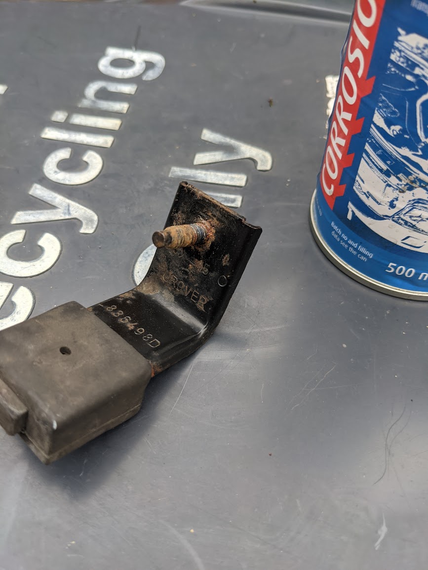

Hi everyone, finally got Florence's front end off but in doing so I snapped one of the upper radiator mounting brackets, the L shaped ones. So I'm on the scrounge if anyone has the left hand side bracket. Thanks in anticipation.
Florence is my very strange MK2, you know it. All the front end fixings were rusted so the whole job was a right royal pain in the harris

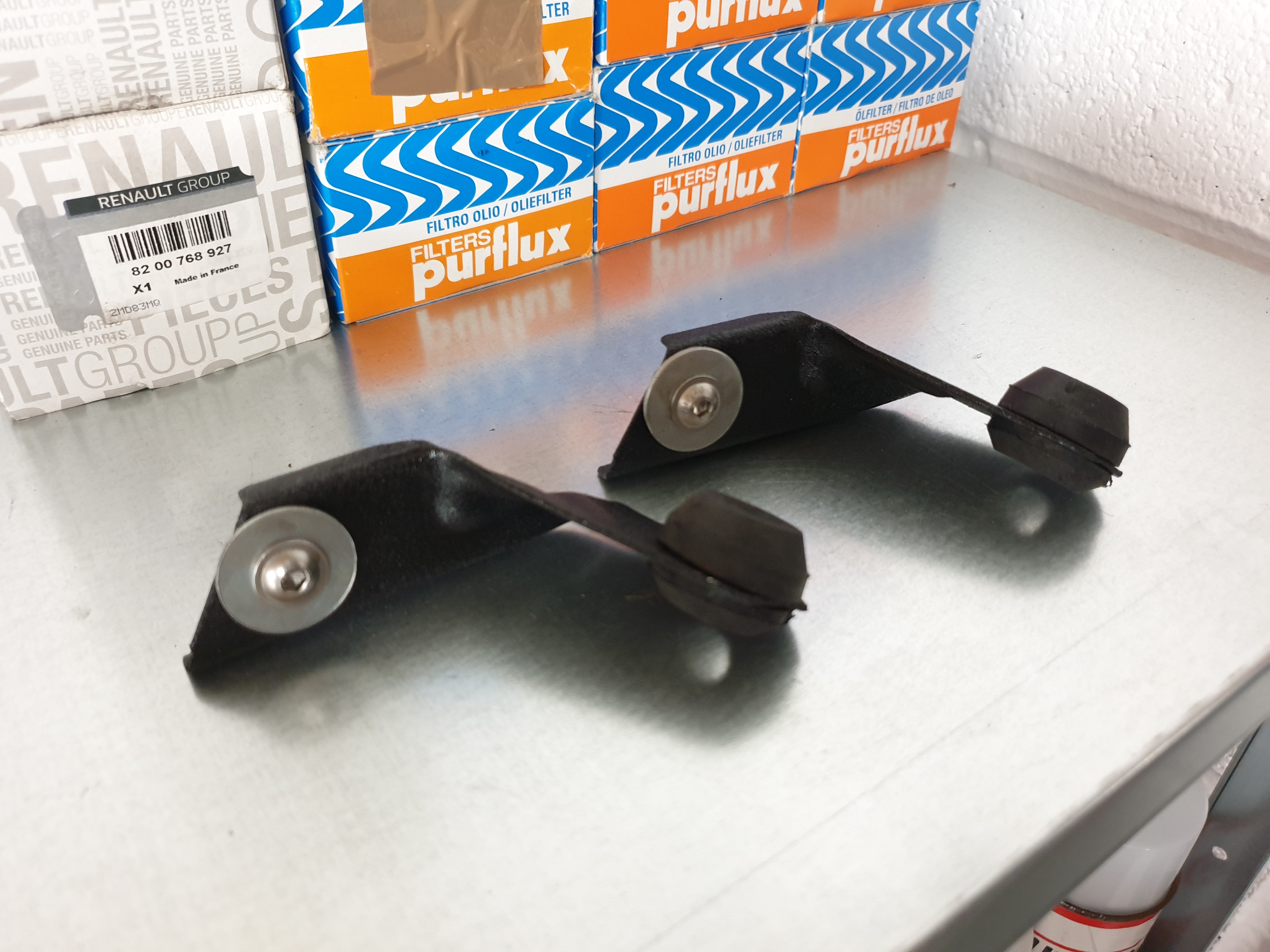

These type?

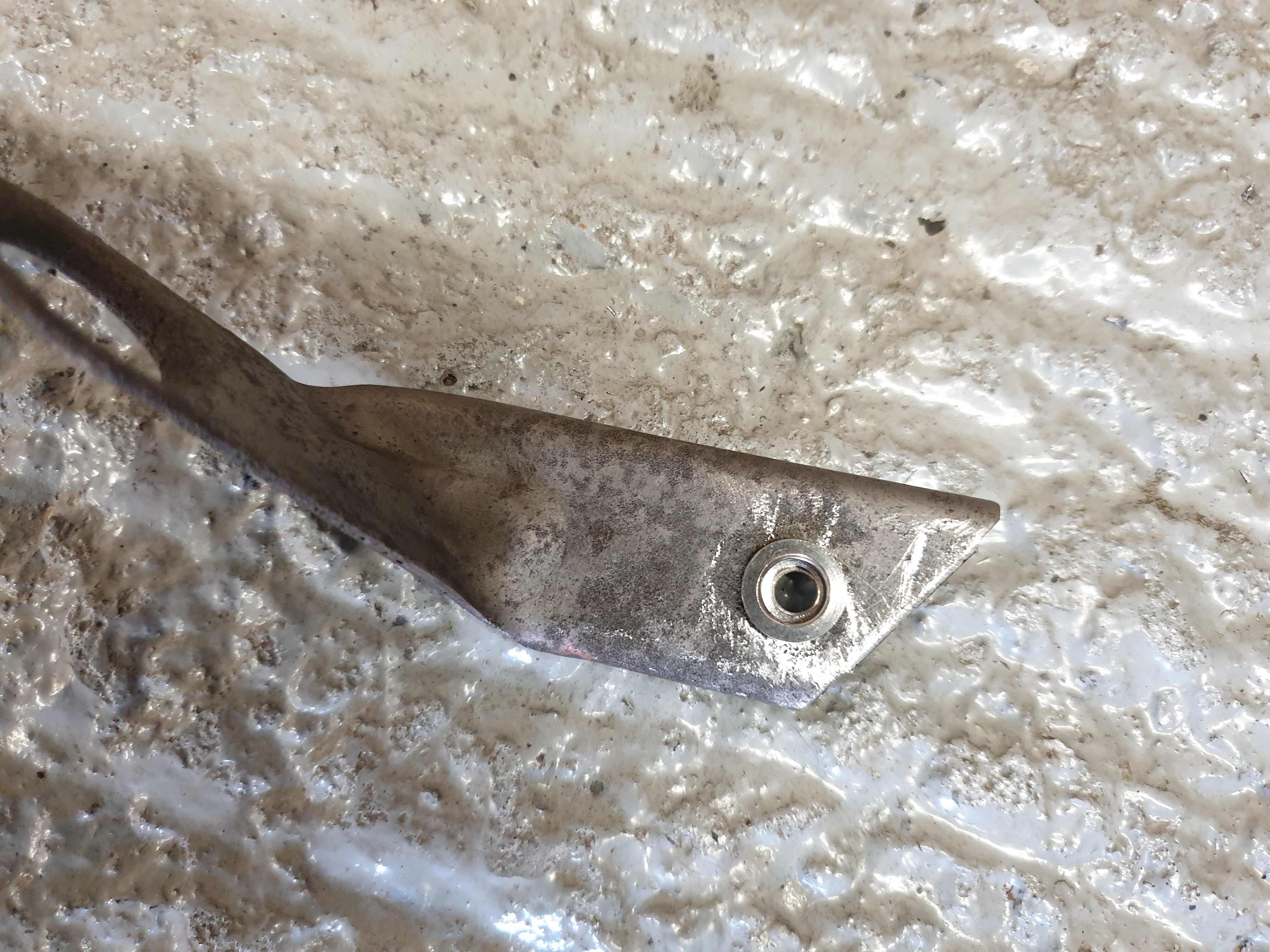

Drill out the remains of the bolt and put a nutsert in.
