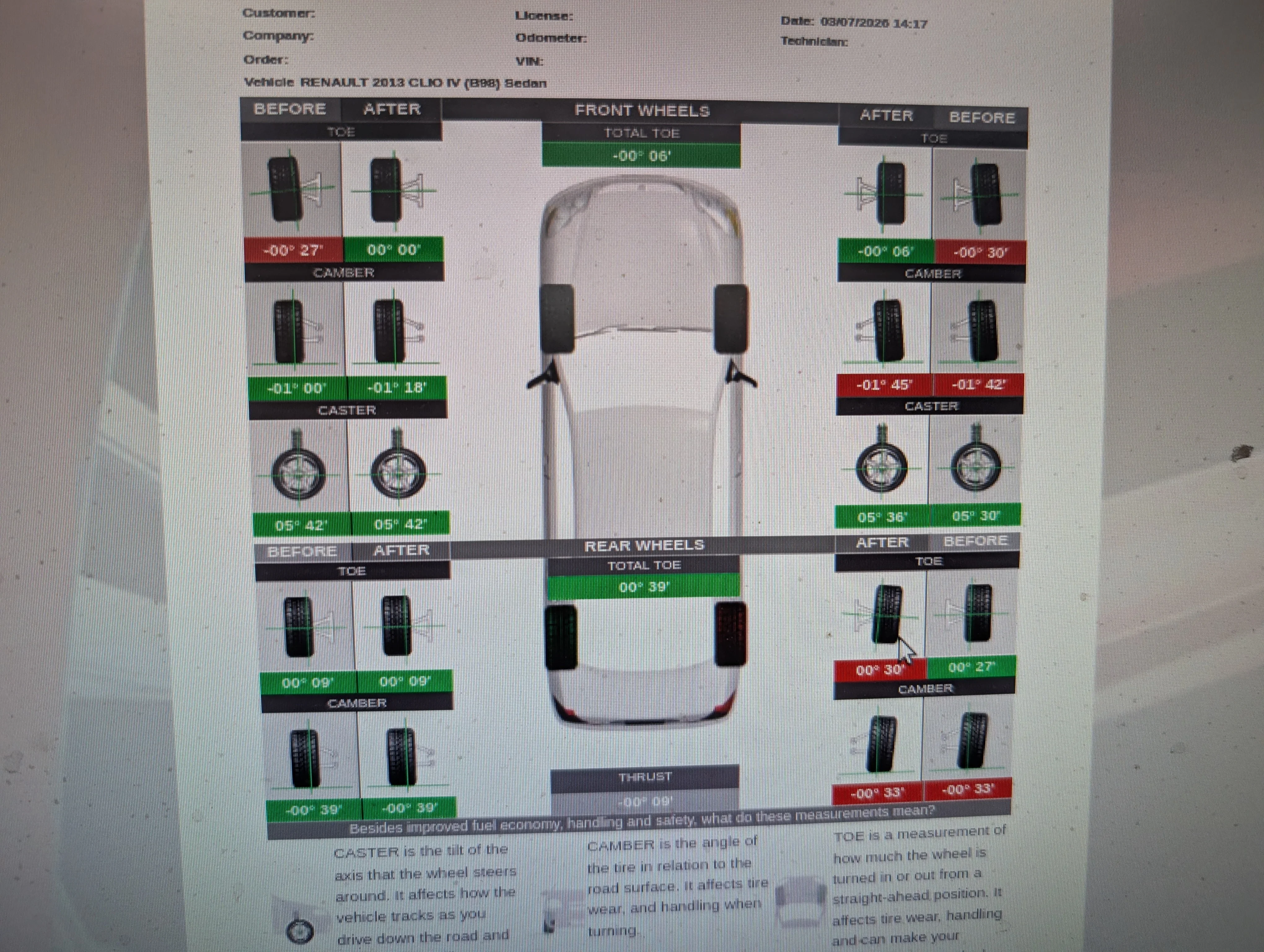

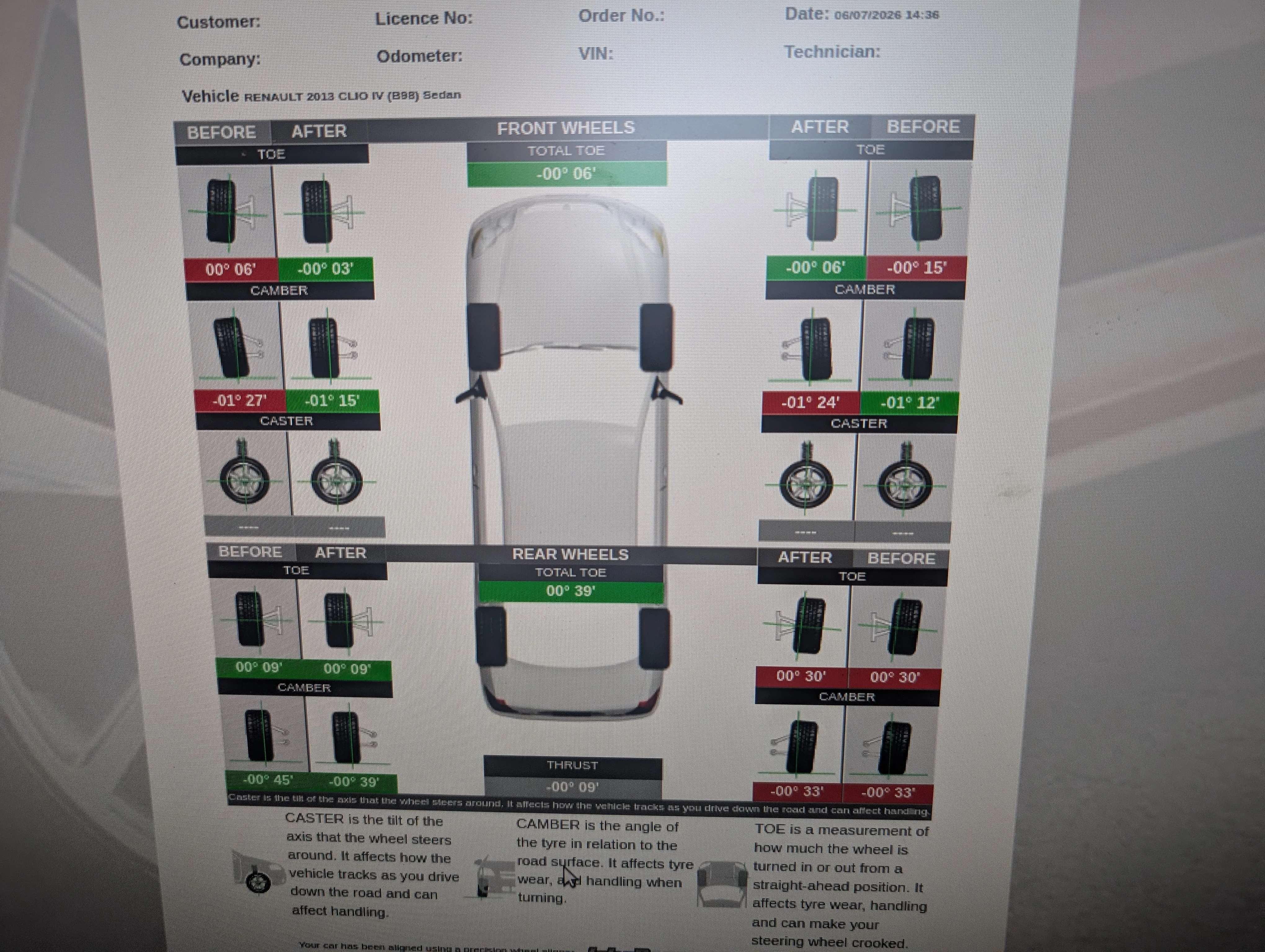

Recently had alignment on the Clio, but I'm not especially happy with it. I have a bit of left hand down and it can be a bit squirrelly under harder braking. Can anyone offer advice on what I need to do? The car is running standard suspension apart from lowering springs. Would i need a 20' OSR axle spacer? The front toe and camber is a bit different on either side despite adjusting the top mounts. Would be awesome if I could sort before CSF at CSF worst case. Tagging people for help @Filters @Adey. @Brigsy @Touring_Rob
