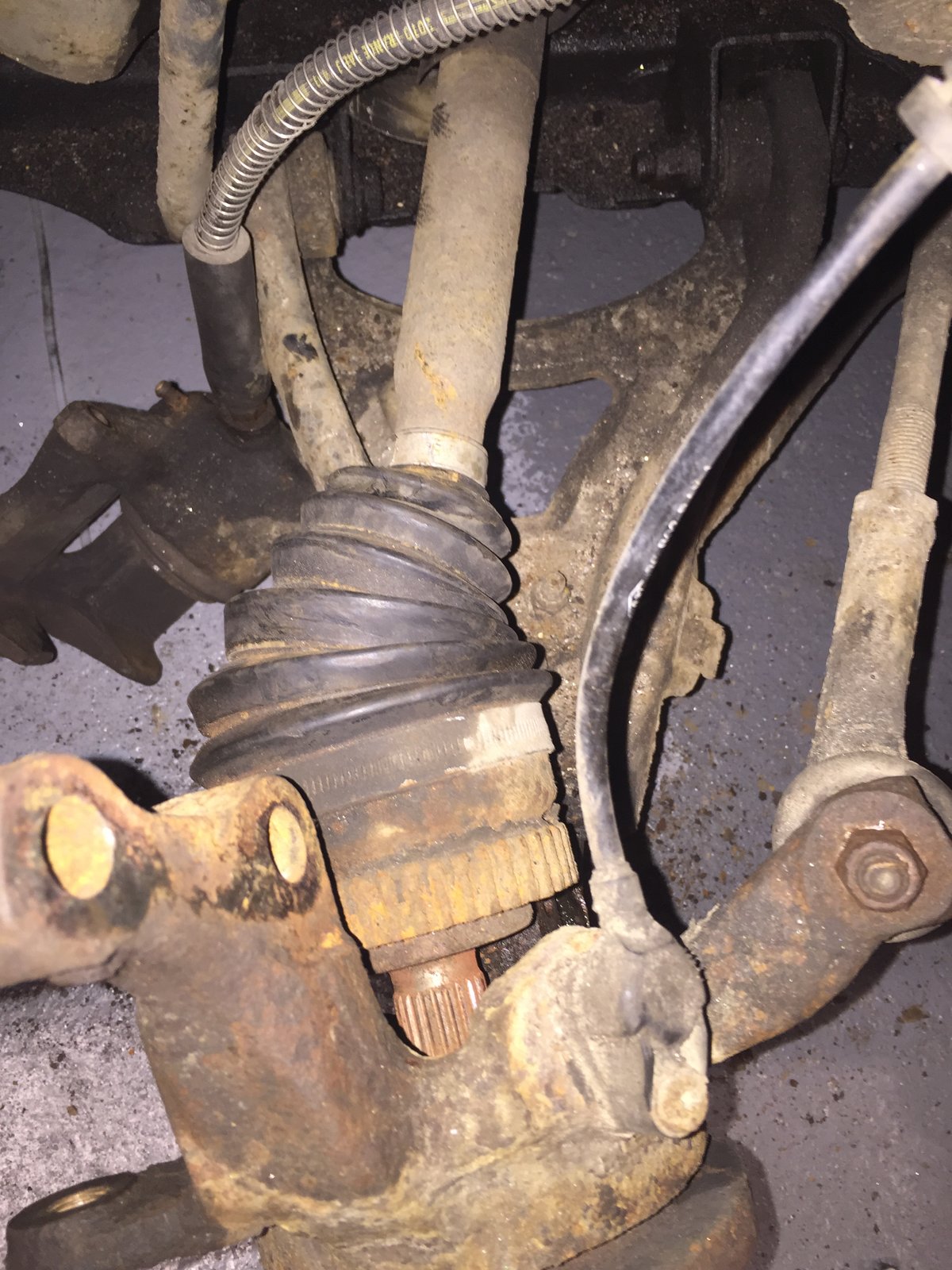

Hi guys, sorry to jump into the thread. I have just been trying to replace my ABS rings today and can seem to get the driveshaft out of the hub. I have taken most of the stuff off apart from the TRE. Any help/suggestions would be very helpful.

Yeah I managed to get it done, just make sure both sides of the car are up and you should be able to leave the TRE and the lower ball joint connected. Requires a bit of force but should come out eventually. Remember to loosen off the hub bolt before jacking up. I struggled more with getting the rings on and off, make sure you have a good wire brush etc to clean up the surface where the ring sits. I ended up cracking one of them to get it to come off. Getting them on was hard, I would suggest the heating method.
