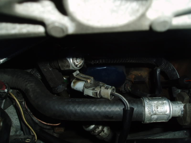

was replacing my oil sender and slipped and broke a sensor off on a pipe in front, think its steering or aircon pipe
7700435692 is the part number
its air con, air con sucks id just rip it out
or if u want it
ur gunna have to drain down the gas (outside) then get either a second hand sensor or new, then bung it on the re gas the air con
any idea what that sensor actually does then as i need my air con? will it work without it or is it vital
Ideal thats cleared that up i guessed it was.so that would be the switch that increases the revs slightly on full lock during parking etc
Aha i see.i wont be paying the 60quid from renault to get it fast in that case.will see if i can get one secondhand somewhere.thanks for the help
When I changed my oil and filter back in March and unplugged mine for access, realised the other day I hadn't plugged it back in. Made no difference as far as I could tell :s
If it's a pressure switch, my guess is it's 'normally open' so leaving it unplugged would have no effect.
