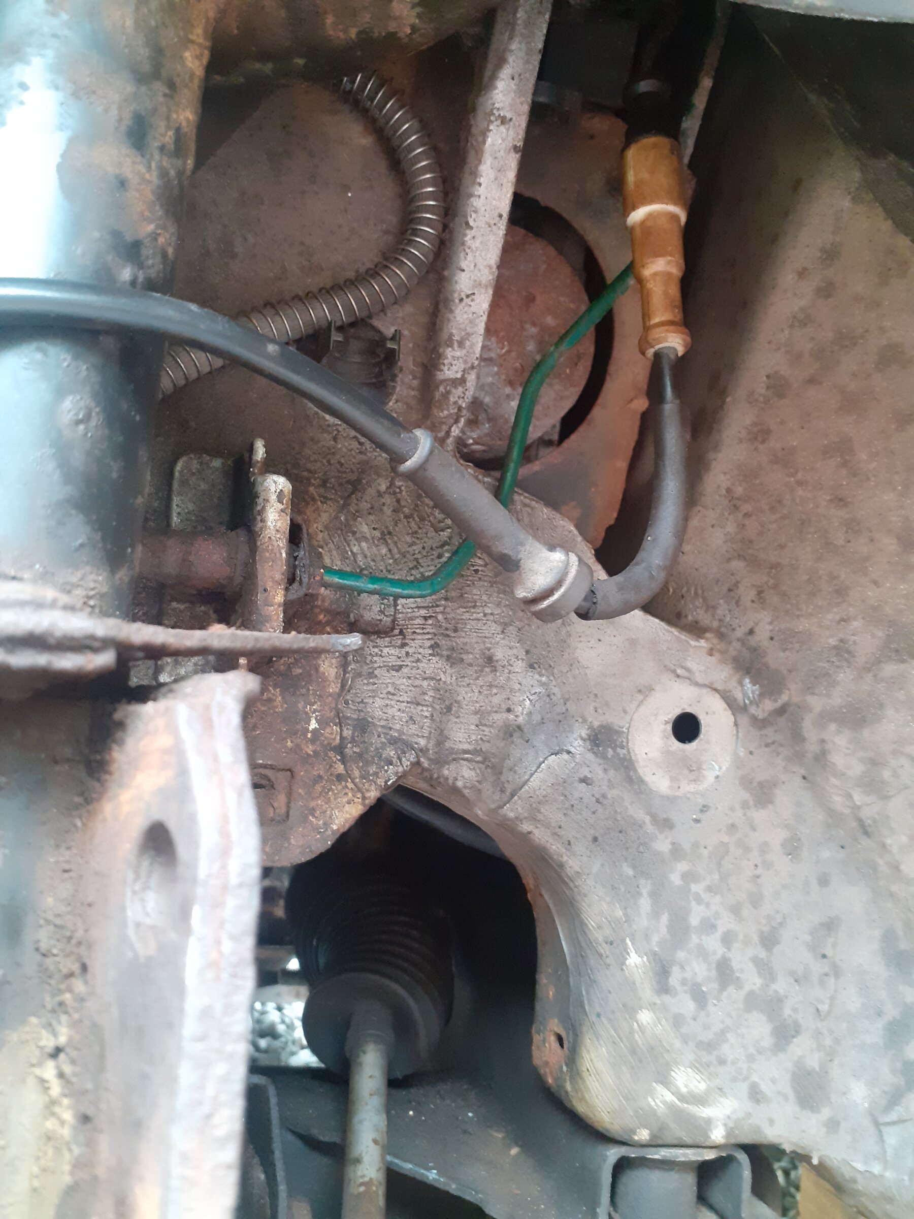

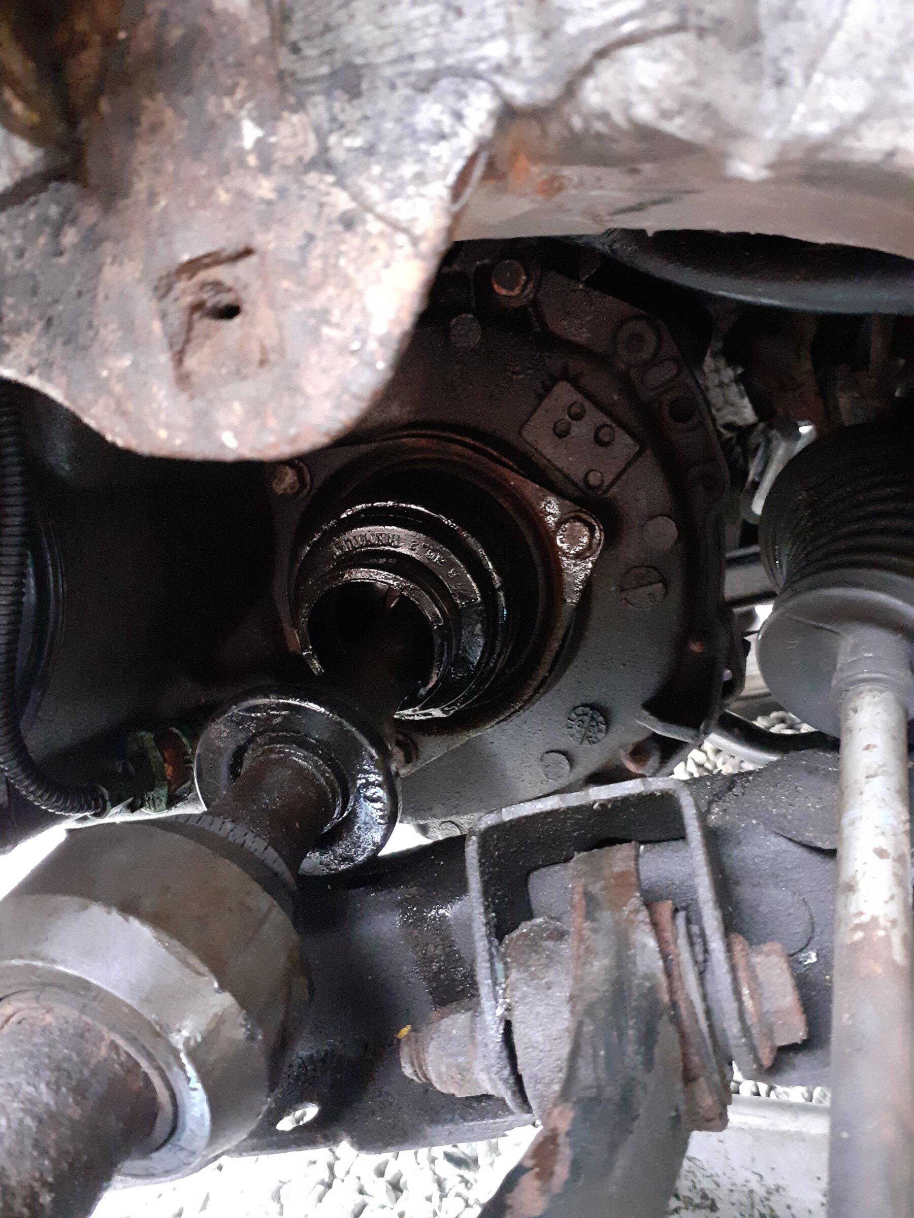

Any help appreciated here folks! Planned on removing hub to get to wheelbearing, all well however my passenger side drive shaft has came out the gearbox and pissed oil everywhere, things going smoothly til this point so half expected something to go wrong 😂
Any advice here or new driveshaft needed as well as gearbox oil?
Also any ideas on how to get the abs sensor unplugged I have completely wrapped today as of now
Any advice appreciated

looks like the rubber boot has split, if you remove the triangle looking plate with the three bolts, the rest of the boot should be loose then you can just remove the driveshaft and replace, the boot, if you've lost gearbox oil, it's best just to drain it then fill it with fresh oil when it's all bolted back together
Thanks a lot for the quick replies so it is just a boot rather than a whole drive shaft ✊
