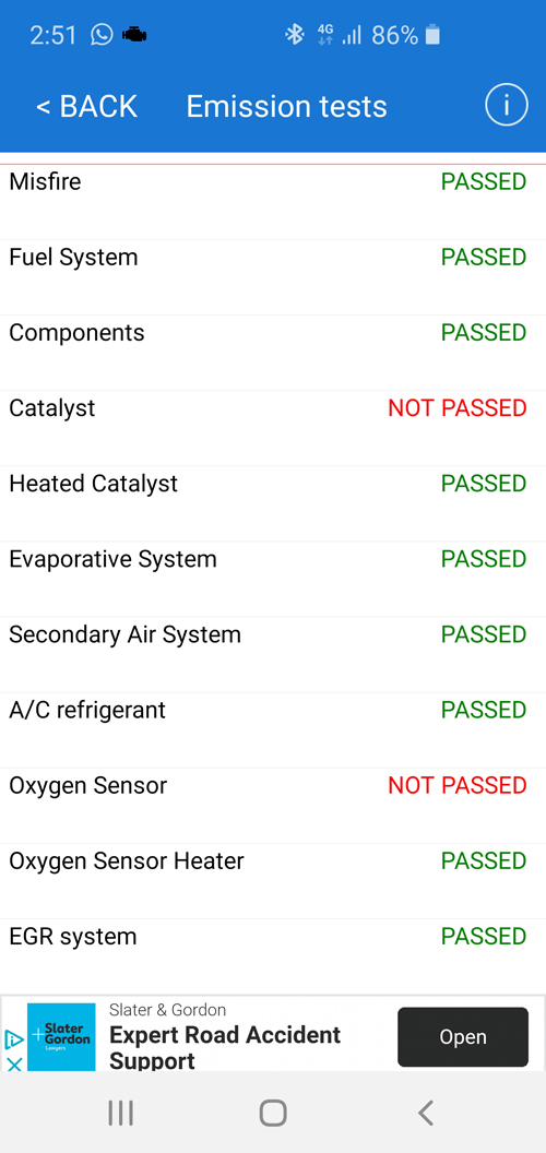

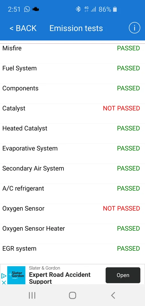

Can anyone help me diagnose this OBD2 data? The car has been getting lower than normal MPG and just sounds a little off to me (louder). I had it in the garage today to check for an exhaust leak but they said it is fine. Something has sounded different to the startup sound and general running sound since it had its gearbox replaced recently.

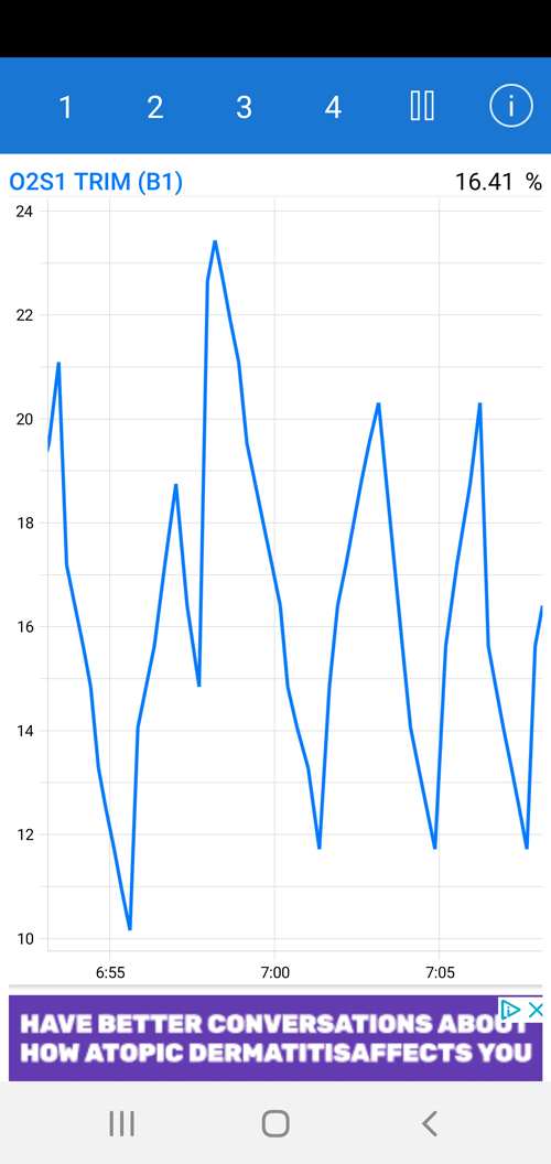

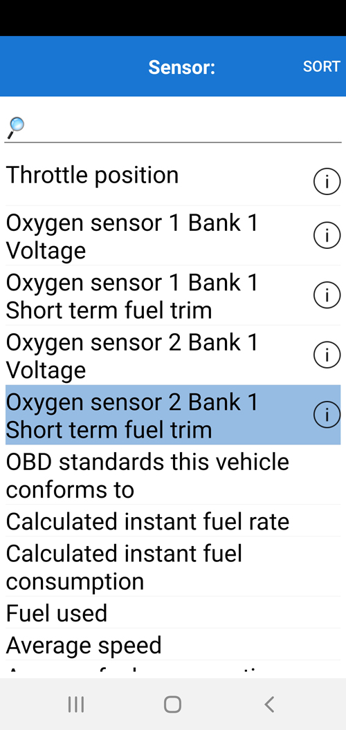

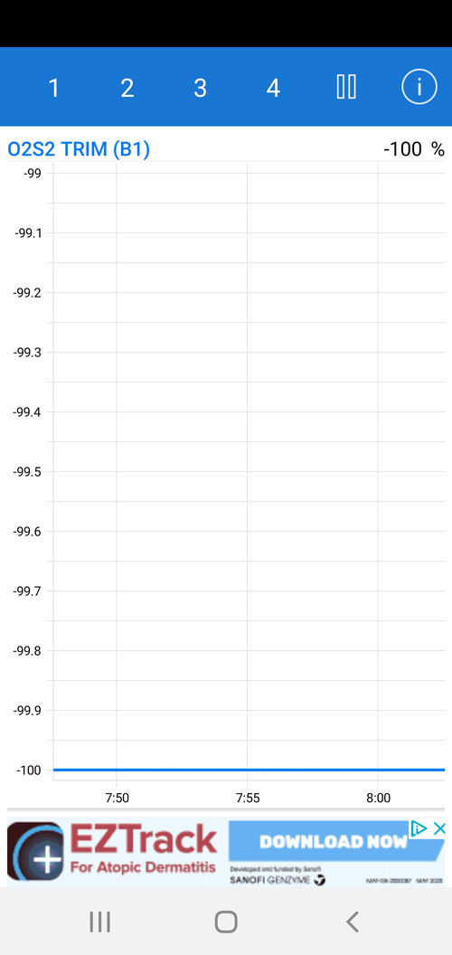

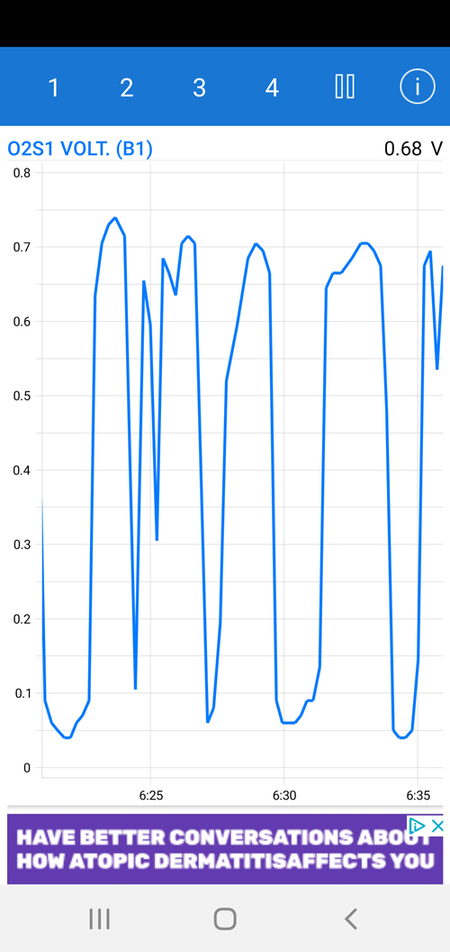

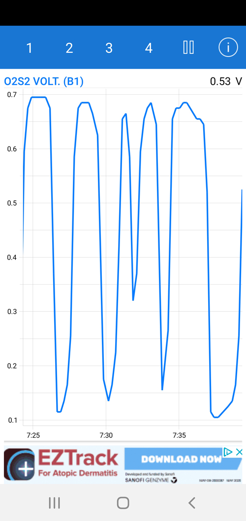

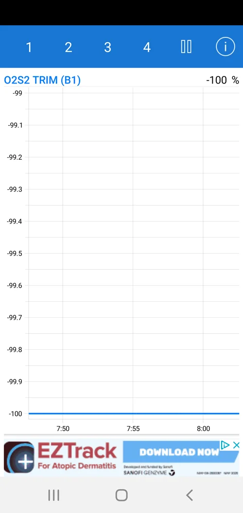

The software is showing the cat and oxygen sensor as being the issue. Is that the lambda sensor nearest the engine or nearest the cat? I've included the data for the sensors too, I don't really know what I'm looking at tbh. It was all taken at idle. Any help appreciated :)

So I remembered that my old rotten cat has a lambda in it! I've been trying to get it out with grips and an oil filter gripping tool but it is solid! I was going to try swapping them if I can get the lambda off the clio, but both are putting up a good fight.
I'll nip to halfords first thing tomorrow for a 22mm spanner. If I can't get it off with that it will have to be a garage job

Give the lambda plug a good push through the ring spanner. It will fit!
Yeah I was looking at them on halfords site too. It's so far away from the bit you are trying to turn though. I feel like it would slip off easily with all that leverage
Well the spanner and hammer worked perfectly! Both came off very easily 👌
The hardest part was plugging the connector back in
Went for a drive and the mpg hadn't really changed. So I reset all fault codes and the mpg shot up to ~42mpg. That got my hopes up, thinking it was fixed. But as I drove it just kept dropping and dropping. Eventually going back to low 30s :(
So this lambda could also be knackered as it has been sitting for over a year, or there could be something else causing this.
I could still buy a new lambda tomorrow, or I could try swapping the rear and front lambda sensors. I'm not sure if either will fix it. It is still showing the oxygen sensor as not passed.

Just now it is starting at ~34mpg and sometimes as low as 29mpg. It's also still showing the emissions fault on the OBD2 reader. So something is still wrong.
