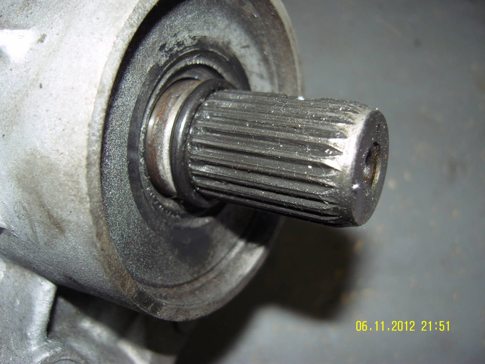

Hi guys,
Could anyone tell me the size of this o ring please, its from where the drivers side drive shaft meets the output shaft of the gearbox
Many Thanks
  172 Ph1
Measure the shaft diameter with a set of vernier callipers and take 2mm off what you got - boom there you have it .
Besides o rings stretch anyway . So get a smaller one . It's only to stop water getting in - don't work for s**t anyway . Lube it up with copper grease when fitting it back
