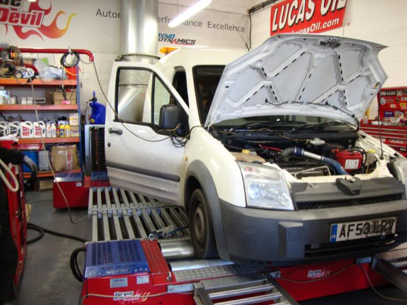

Im new to the fourm. Im 23 and currently drive a 275bhp Transit Connect.
I also own a ph1 172 and a 182 full fat :)

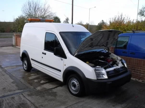

I built the connect and have done everything myself,
Heres the spec

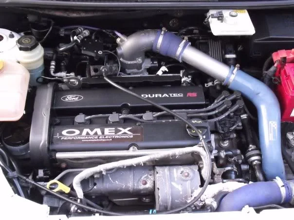

- 2003 Focus RS engine that had covered 26,000Miles
- Turbo Technics Hybrid T28 Turbo
- Forge Adjustable Actuator
- GRS Front mount Intercooler
- Custom Silicon Boost Pipes
- Blue-Flame De-Car
- Powerflow 2.5inch Custom Stainless Exhaust (With No Boxes)
- Focus RS Gearbox (With Quaife LSD)
- Omex 600 Standalone ECU (Fully Mappable)
- Cosworth 3bar MAP sensor
- Denso ITV24 Iridium Spark Plugs
- Focus RS Fuel Pump
- LPG Conversion
- Modified Inlet manifold (To Accept the LPG Injectors)
- Kenlow Hi-Flow Rad Fans

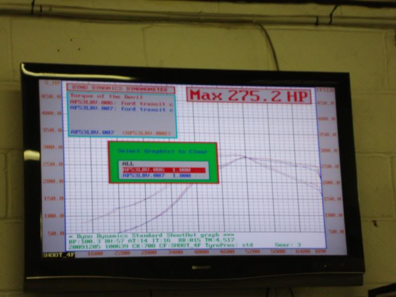

- Power 275BHP@18psi
- Mapped By Michael Woodford Motorsport (ME)
- Yokohama Prada Spec2 Tyres (All 4)

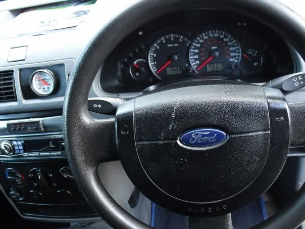

- Ford Racing Boost Gauge (Mounted in custom air vent pod)

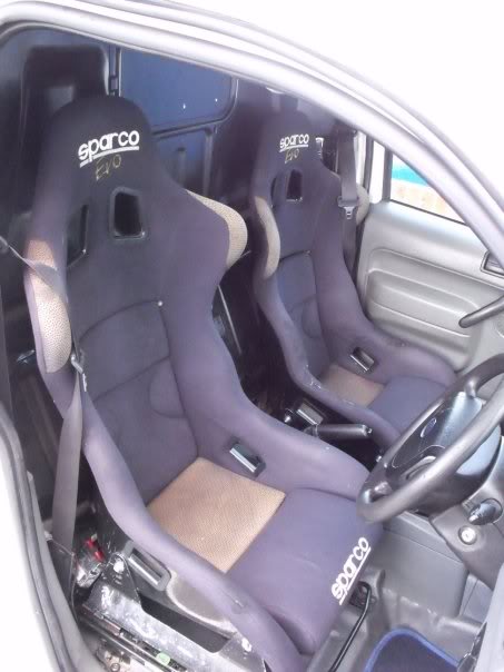

- Sparco Evo Fibreglass Buckets On Custom Frames (Slightly tatty but not too bad)

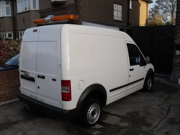

And a couple of photos :cool:
