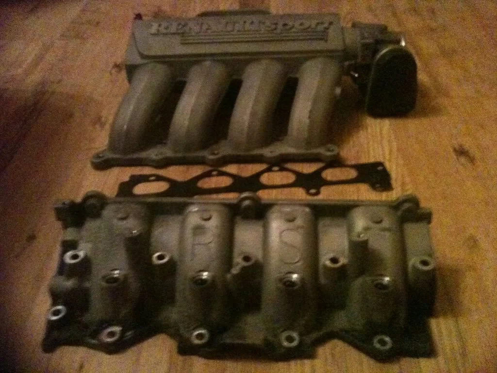

Didn't mean to put you off the engine! The inlets is a good call, if there not RS stamped you should be guarenteeed some gains from matching them.
If youve already got a Magnex, with a De-Cat (or Sports-Cat by thats the expensive route), free flowing Filter, Inlets and a RS Tuner or live Map you should see 183 - 187BHP, which isn't bad!
My 182 had an ITG Filter, BTB Cat back Exhaust and a Superchip and made 184BHP, always wondered if it had had the Inlets done at some point though.

Hi Saner, what is the RS stamp you referr to and where would I find it? I take it if this is an RS it is a better quality more free flowing?

Cheers for uploading the pics much appreciated, i take it that you can see the RS without taking anything bar the injector rail guard off or do I need to remove it all? If so I didn't see an RS stamp when I changed the oil. If I dont have an RS stamp is it worth getting the matched inlet manifold :)

No RS Stamp = worth doing IMO
