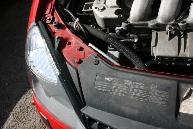

Just had to mod the holder to make sure all the wires passed though the holder the cliped the holder in the back of the headlight got a few pics of how I did the change - pics to follow
  S2 106 GTI
Leave yourself 'PLENTY' of time!! I thought it was going to take a couple of mins to fit - turned into a few hrs!
I decided to remove my headlights totally as the Air Con pipes were in the way and it was going to be a tight fit :dapprove:

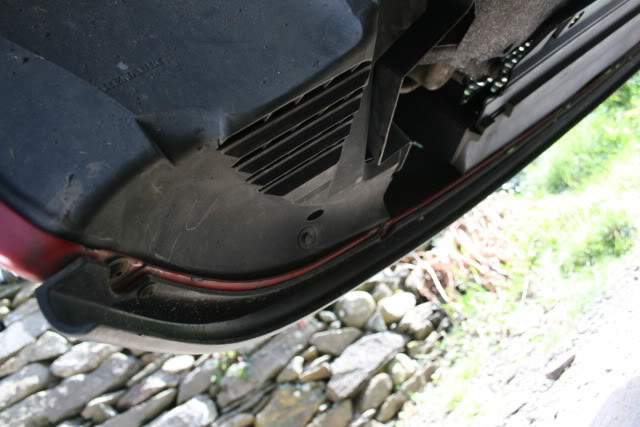

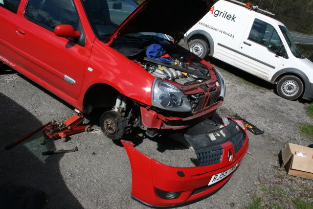

-Jacked car up
-Removed BOTH front wheels

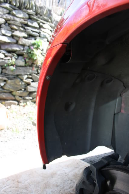

-Removed both arch linings - Just pull the bungs out and there are 2 Torx screws underneath near the splitter

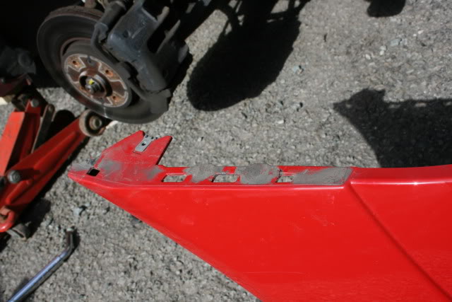

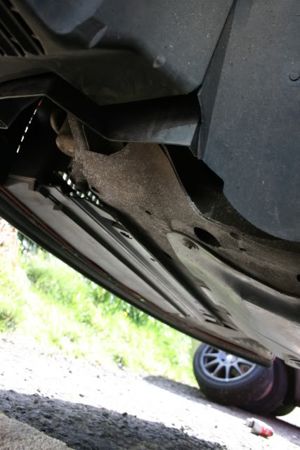

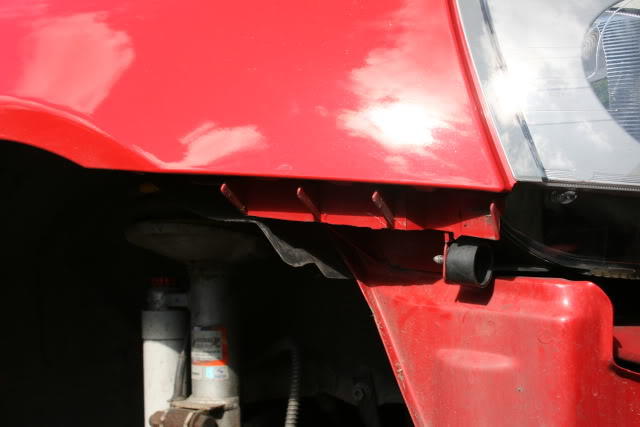

Once I had these out the way I could see the bolts which holder the bumper on - Also 2 underneath where the under tray is

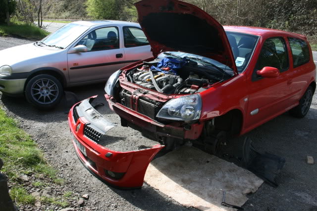

The bumper is a two man job! you need to pull the bumper ends out to the side then pull towards the front of the car and it sould drop off! you need to pull hard though!!
**Also remember to undo your screws for the grill as this comes off in one piece with bumper!
how the bumper is held on

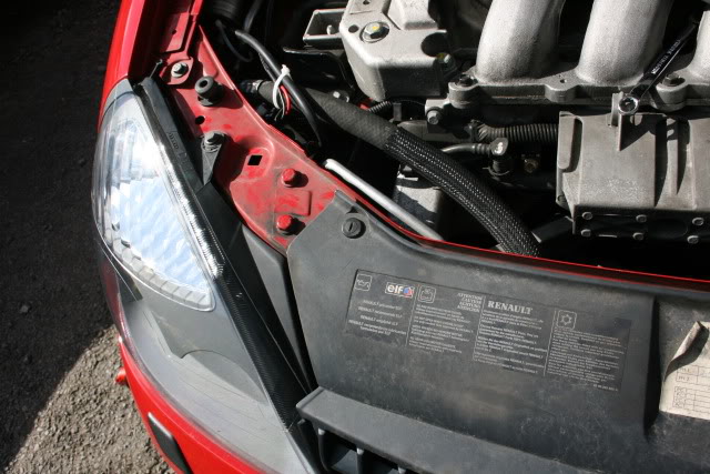

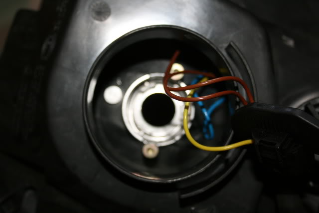

once this was off you can see the headlight bolts which hold them inplace - just undo the wiring to bulbs and pull them out!

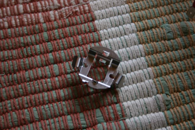

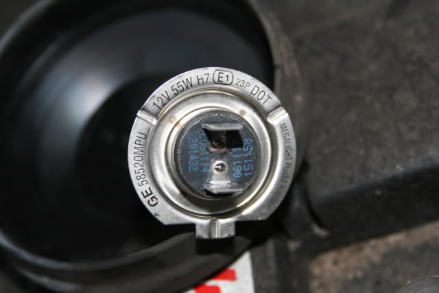

With the headlight in your hand you can see how the bulb is held in place and what you need to do.

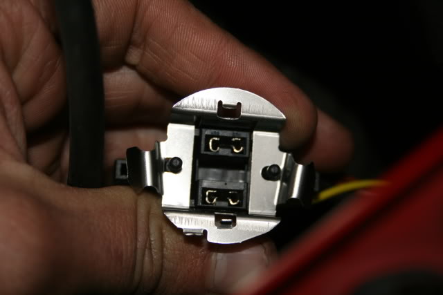

This is what I did to the holder (taken from HID4u website)
Connect the HID in the back of the headlight (make sure its a good fit!! or you will have trouble getting to it again! and will have to do the process again)
Put headlght back on car and connect all wires up making sure the Ballast is in a secure place and all wires are out of the way.
Same with other side...
**Try them out! just incase something has worked loose or not connect correctly
If all is well - re-attach bumper and away you go!
Thats how I did mine, may differ from different models of clio.

I've just fitted mine, that I got from renclio. Piece of piss TBH. All done in under an hour and no f**king about at all. Loads of room for the ballasts under the headlights.
I'll get some shots tonight.
