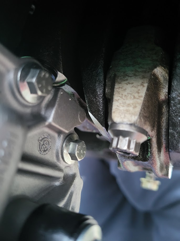

I mentioned this in another thread but it didn't get anything back so its getting its own thread.
I have installed the uprated oil pump kit from PMS as part of my bottom end rebuild. The clearance to the crank is quite concerning to be honest, got about a gnats pube worth of clearance to the crankshaft. I know I have an early ph1 that appears to have a different crank in it from the fact I don't have a keyway where the cam pulley goes, not sure if its different in other areas too.
Has anyone else done this conversion and can confirm that this clearance is OK?
How does one "remove the end float"?
Id say there is about 3-5mm between the pump and crank at this so unless the float is going to take away nearly all of that then I would say a feeler gauge will fit.
will give it a little tap when I make my final assembly. I assume its just a little tap on the flywheel end.
I'll be honest also, i did contact Nick from PMS already and he said it was fine, wanted a second opinion,
Yep, when you measure crank end float you generally set a dial indicator up on the nose of the crank and push the crank forwards/backwards, towards the gearbox and away. It's in the order of .1-.2mm so naff all really... If you have >1mm clearance the crank end float will never cause the crank to contact your pump.
If your mind clearance was 0.5mm or less I would be worried.
Was that a megane oil pump you installed or just the clio dci one? I recently installed a dci one from PMS on my ph1 172 and didnt notice any clearance issues.
