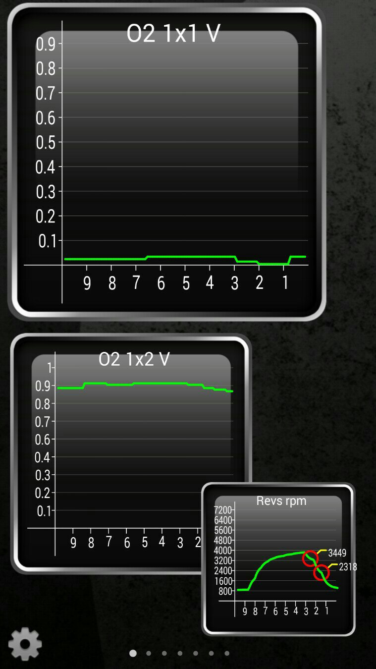

According OBD, lambda 1 jumps between 0.03v to 0.68-0.74v
Lambda 2 sits at a solid 0.74v
Although, graphing it after restarting the car gave me this:

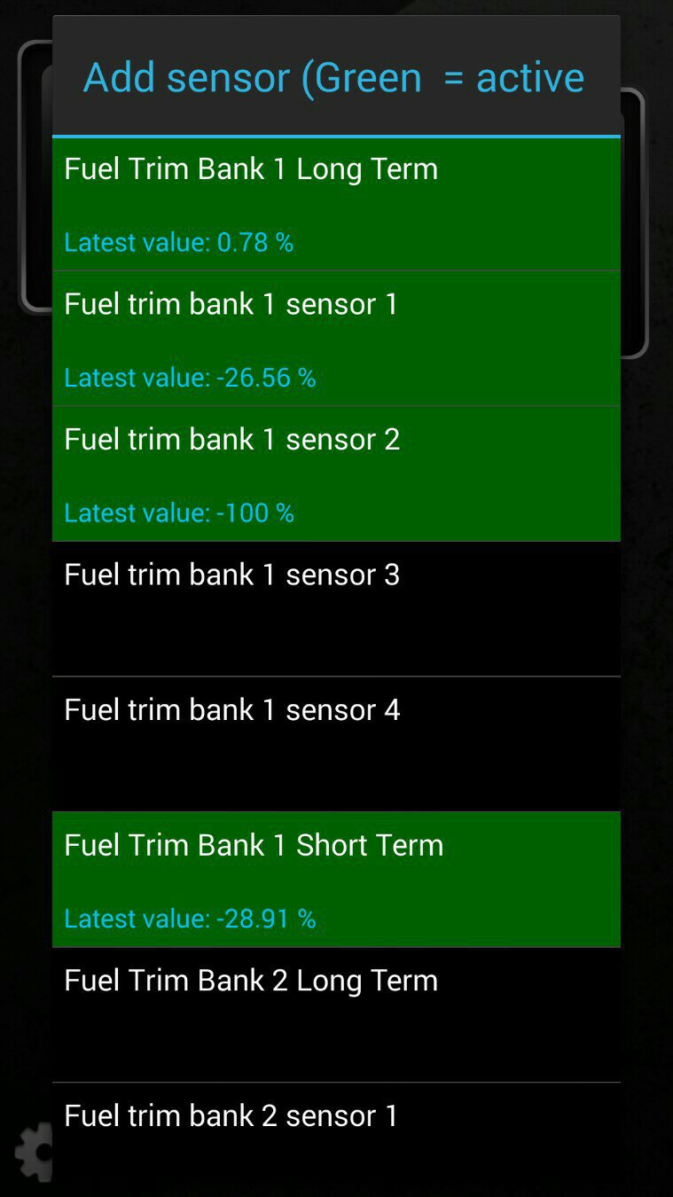

Fuel trim:

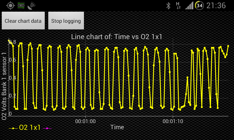

Heres what the pre cat lambda should be reading
That graph is handy, thanks.
