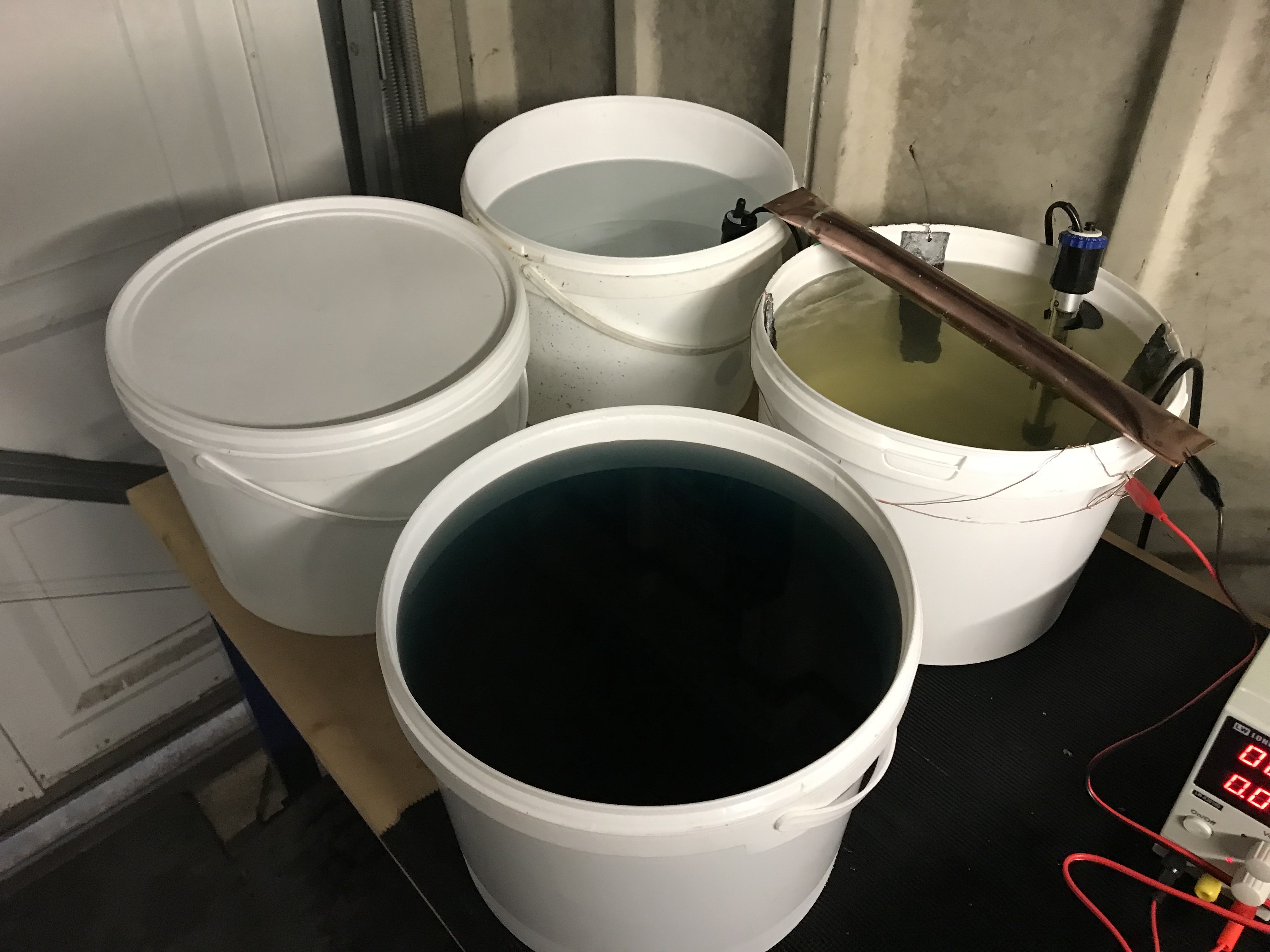

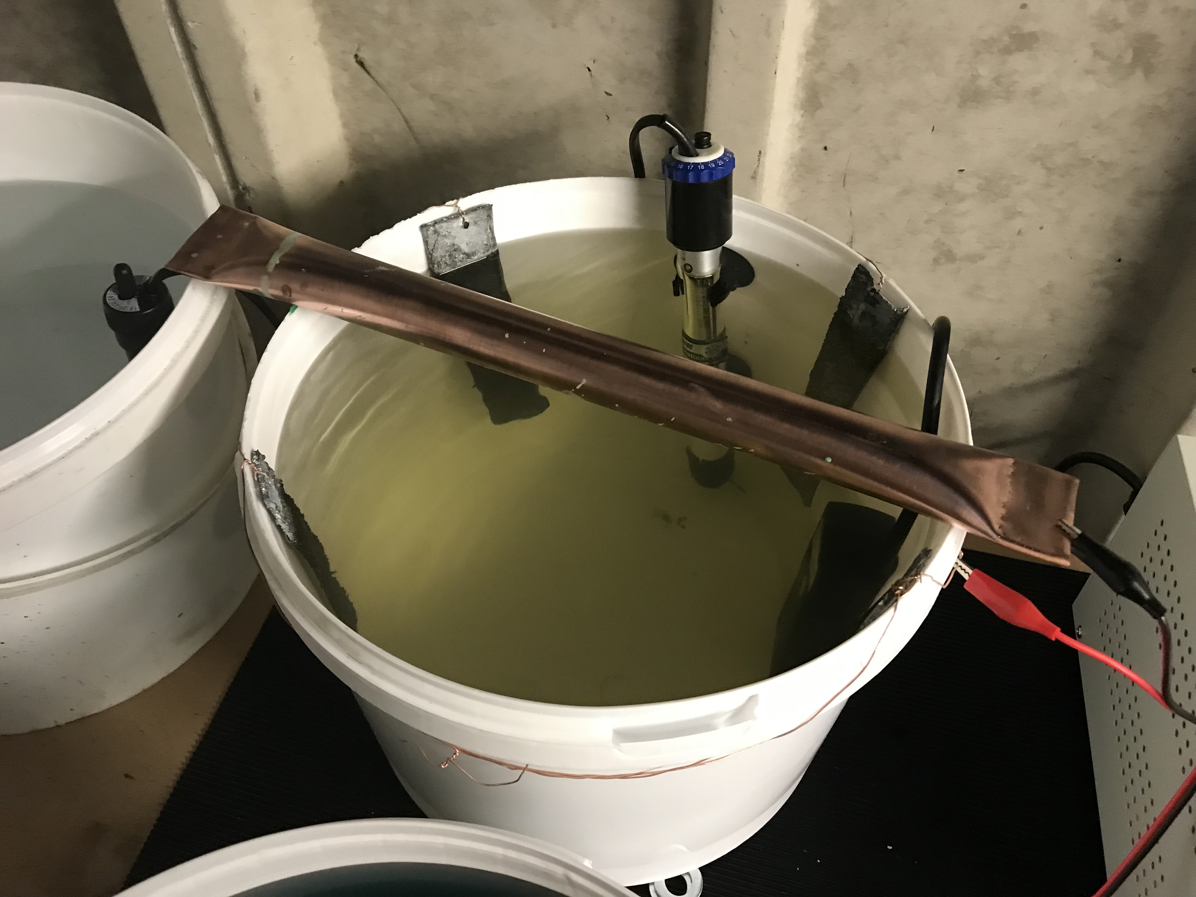

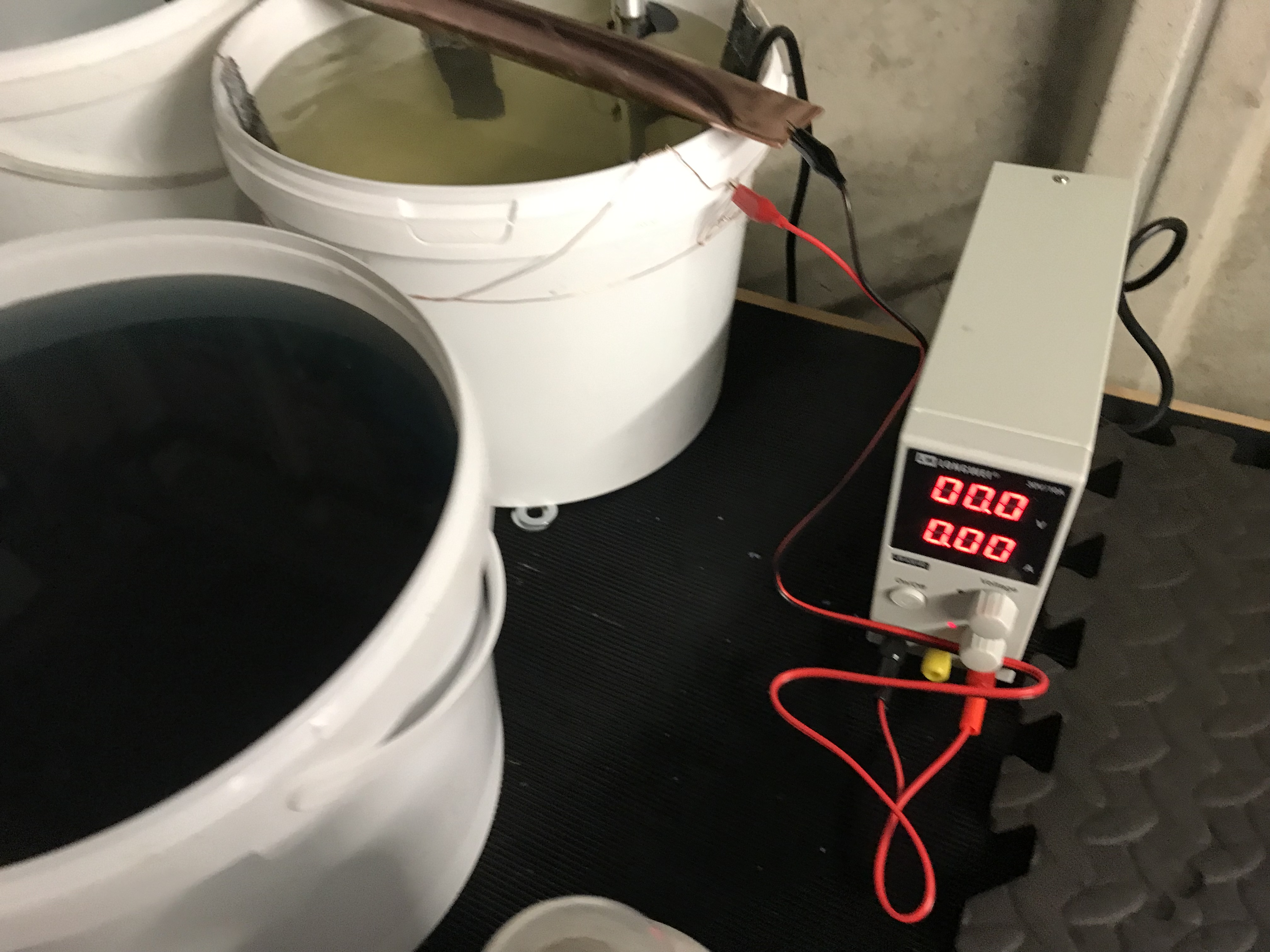

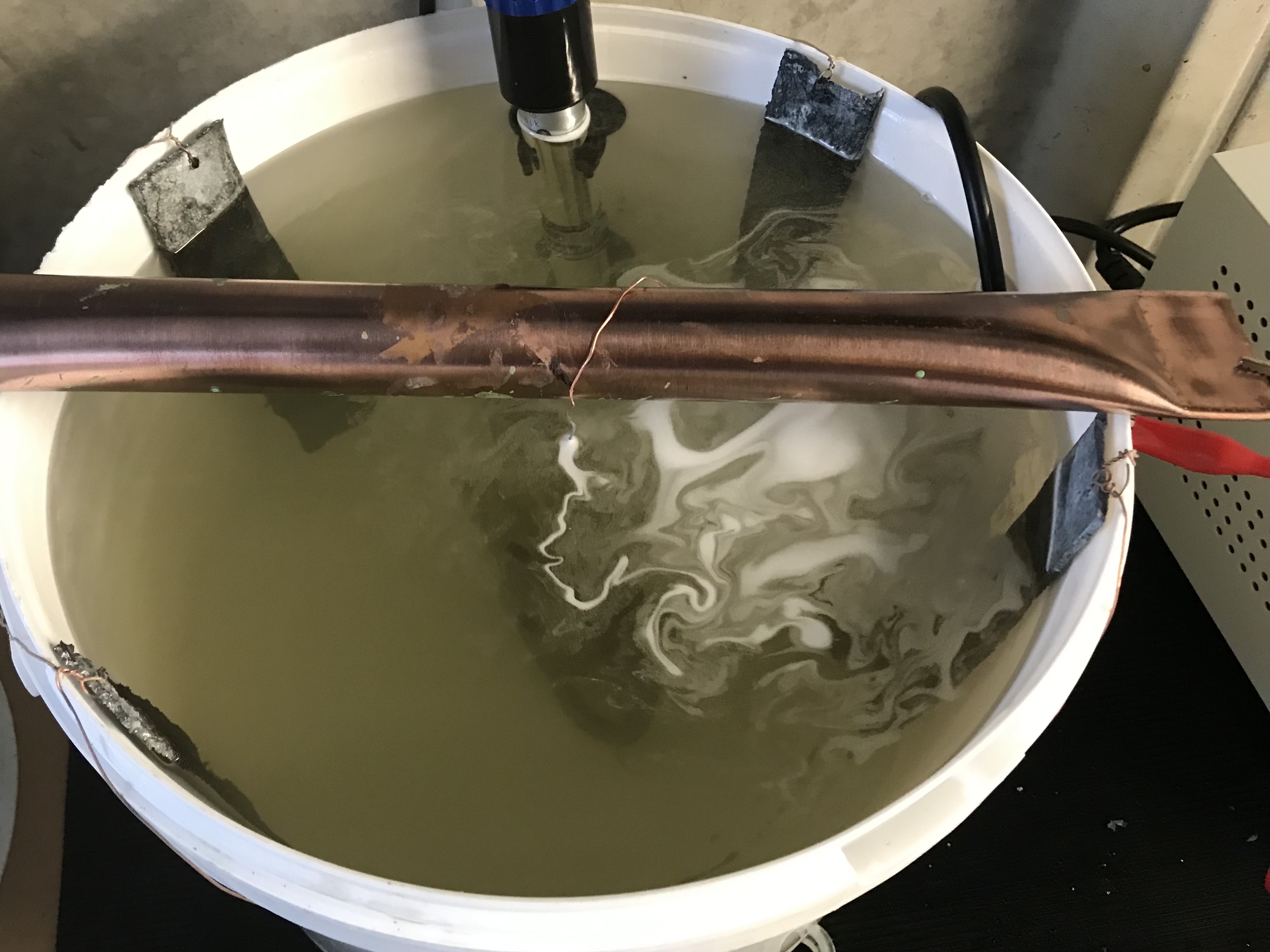

I bought this kit https://www.gaterosplating.co.uk/all-products?product_id=207 Then I bought more tank heaters, then a power pack, passivates etc. Don’t buy cheap tank heaters, especially through winter unless your garage is really warm. Really important to keep temperature of solutions around 25c.
Got good results but it does take a little time to get voltage right (which is dependent on the size of the part you’re plating).

My set up
View attachment 1578418View attachment 1578419View attachment 1578420View attachment 1578421

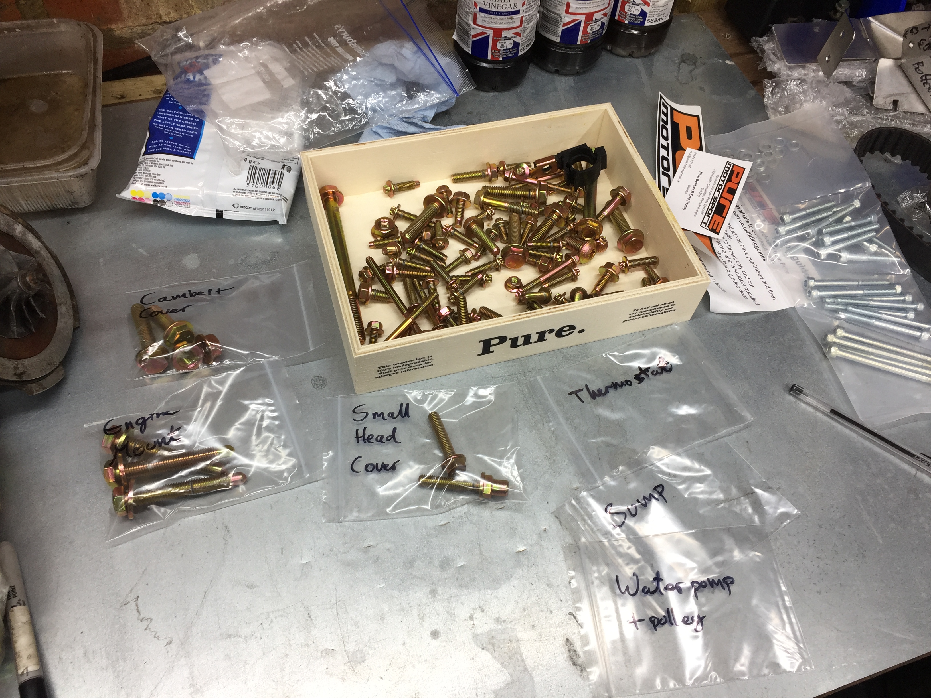

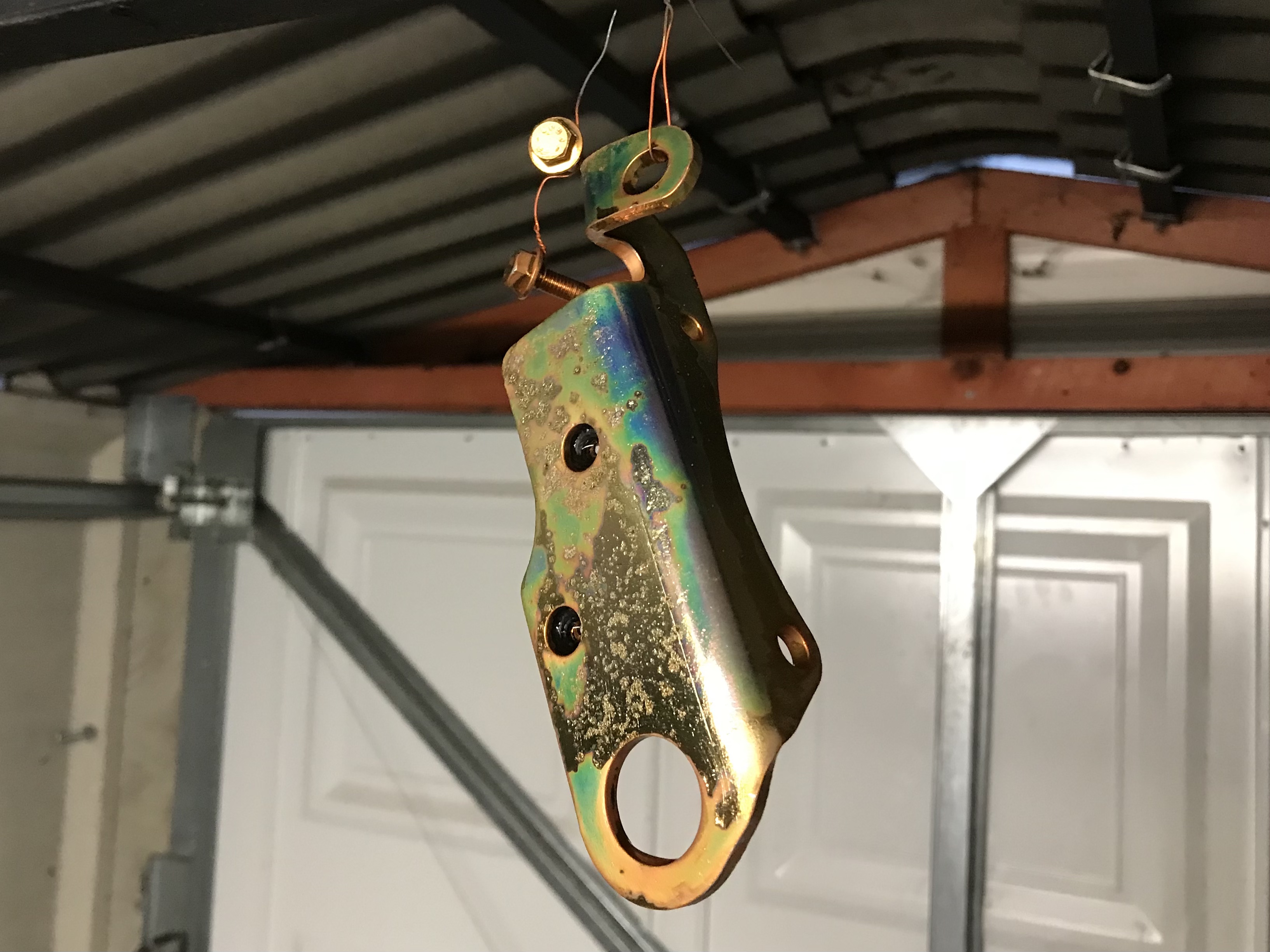

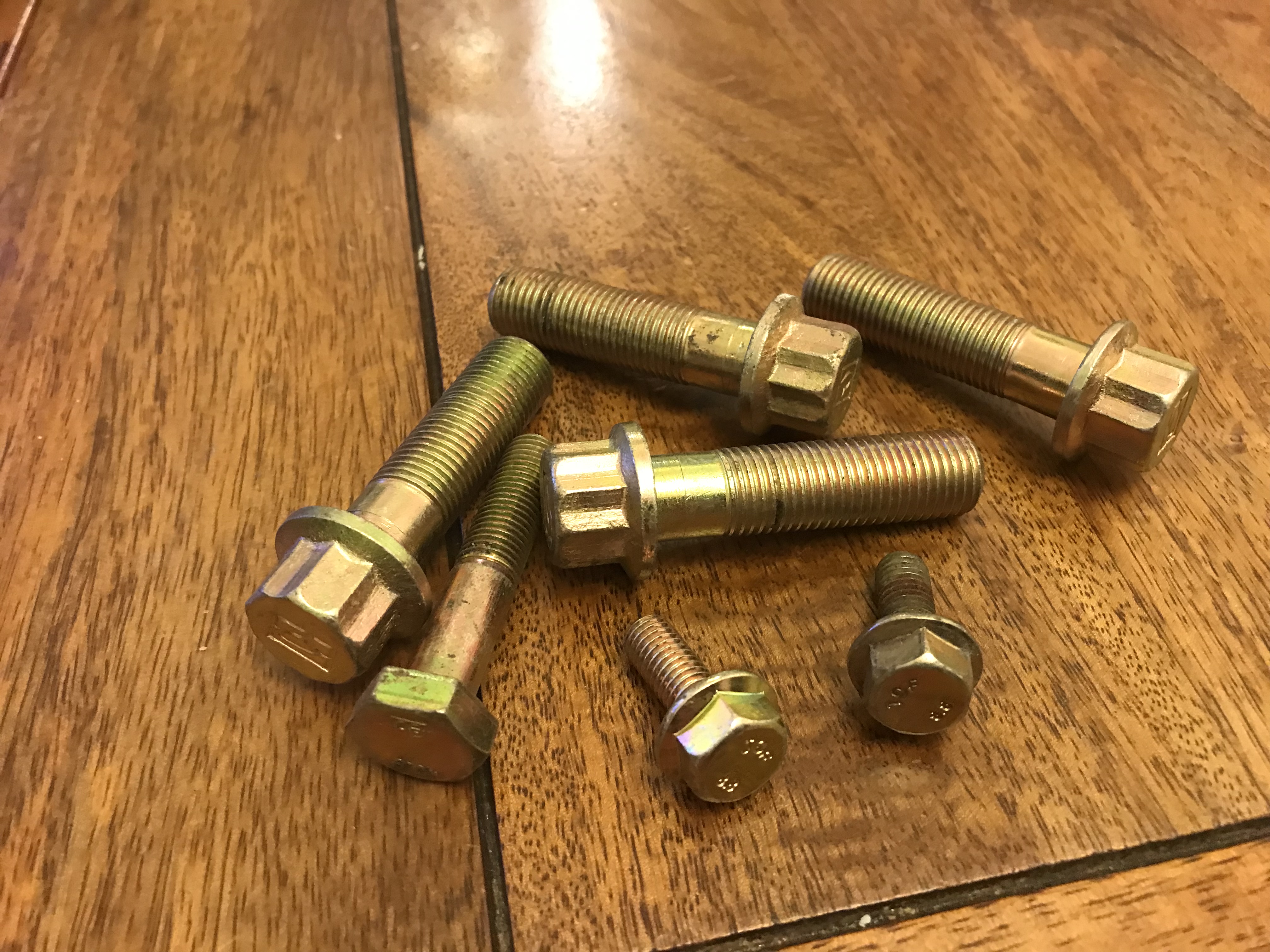

My first attempt at zinc plating with yellow passivate. Voltage too high and didn’t appreciate how chemically clean the parts needed to be, hence uneven coverage.
Next attempt. Much better and as good as you’re going to get for a DIY kit.

Yeah but I soon discovered you need a proper power pack with good voltage range and extra tank heaters. The passivate needs heating, the zinc solution needs heating and I also heated the de-ionised water. The pickle is essentially your cleaner which activates the part ready for dipping.

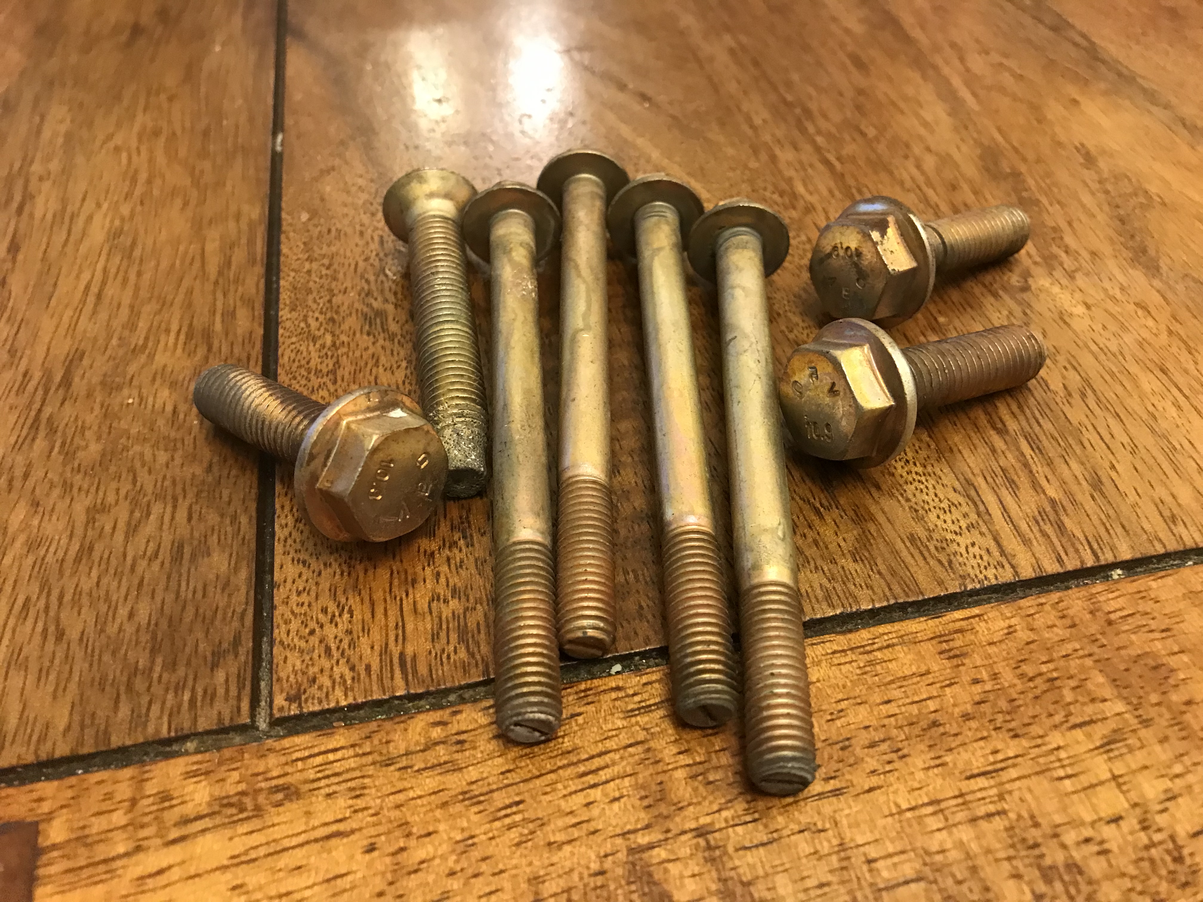

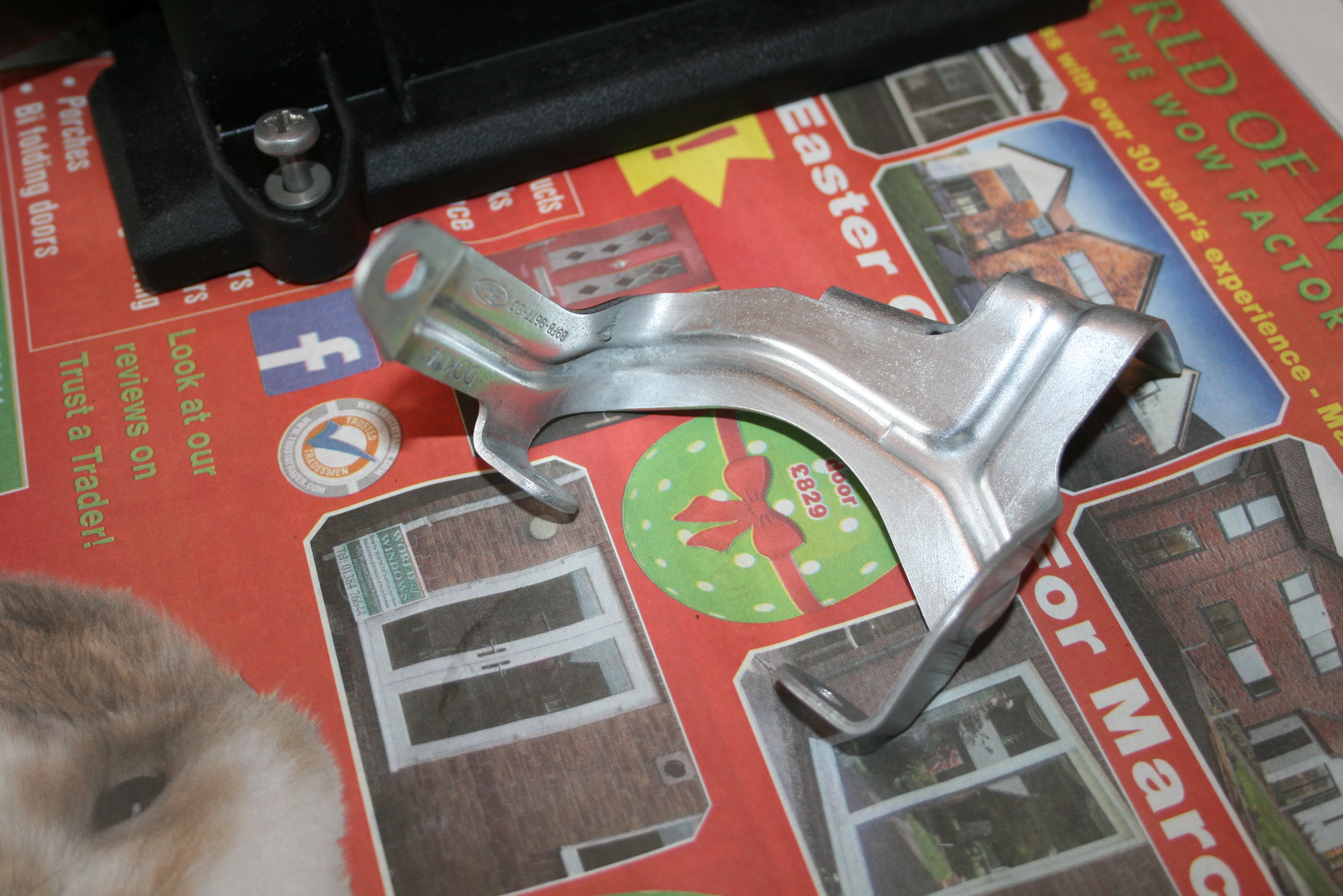

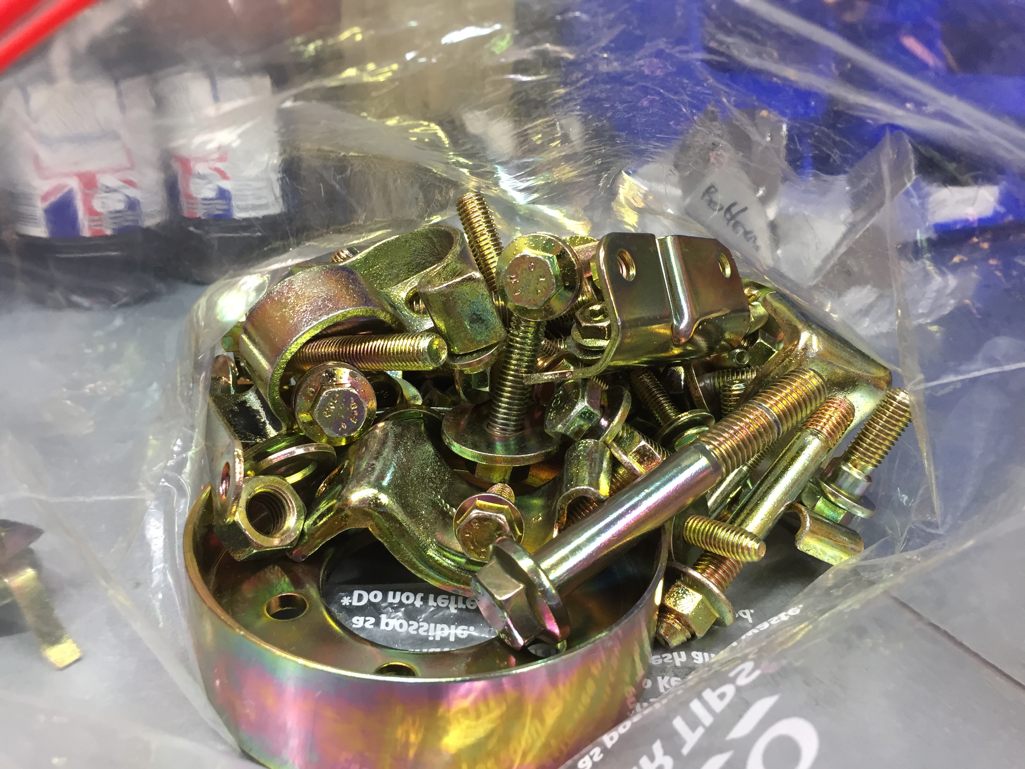

I used a company called TSR vapour blasting for all my plating. About half of the parts they tumbled/plated and the other half were soaked in brown vinegar with hours invested cleaning up on the wire-wheel. The results from the tumbled parts were incredible and whilst the wire wheel parts were also good, they were certainly not as good and adhesion wasn't on par.
The tumbled parts are those below with a smoother and more pink tint (top photo)
Given the huge amount of prep labour I'd hand it over to a professional outfit and just make sure you have all the bolts included.

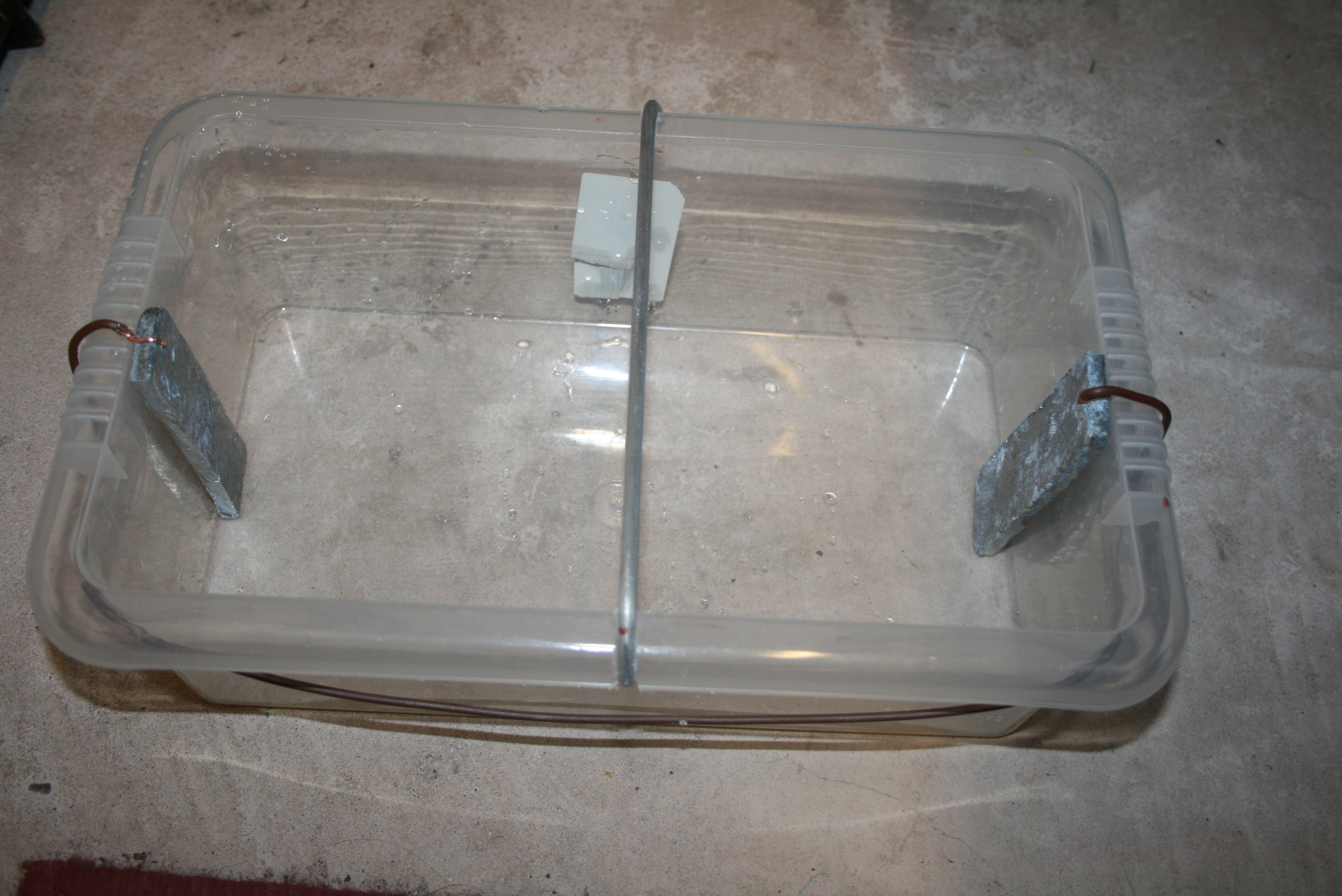

A few years back did a few small zinc plated parts with a Heath Robinson set-up .
Cost about £25 for a pair of zinc anodes and chemicals, I already had a regulated PSU to supply the power.
The results were fine and quite pleased with the few small parts I did and they still look good after about 5 years, didn't do any passivating though as I didn't need that finish.
Still got the all the stuff around somewhere.
Good results take time and trouble with the prep, used all the usual things -tumbling, acid dips etc, and the parts must be chemically clean, most of the zinc plating turned out dull but it polished up great.
