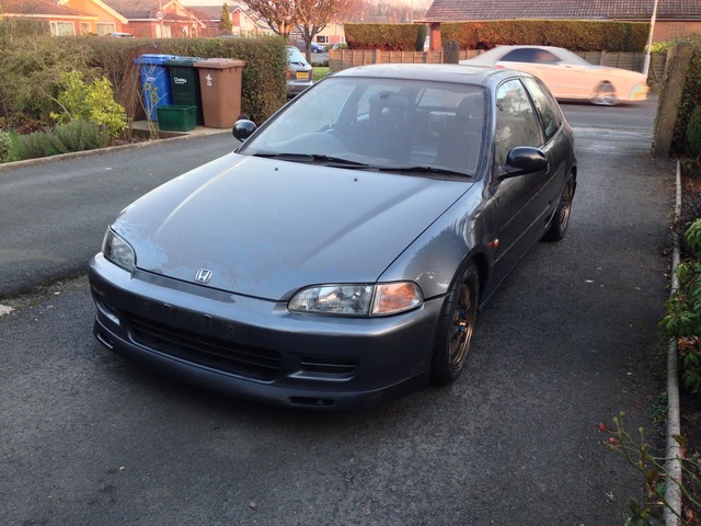

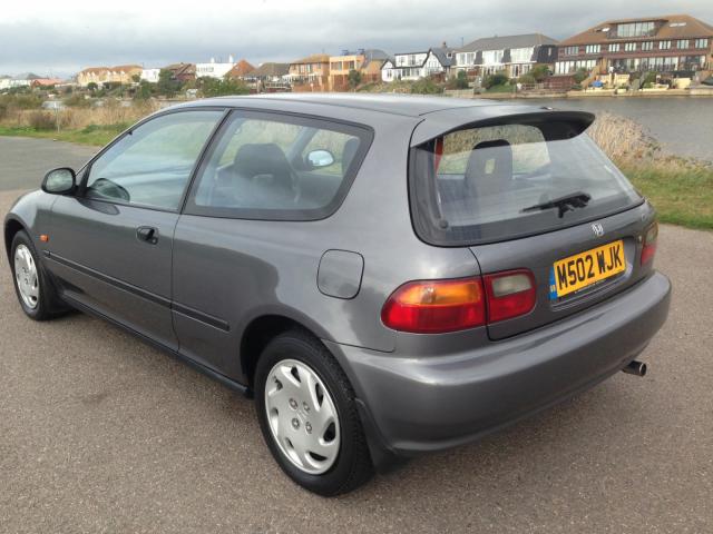

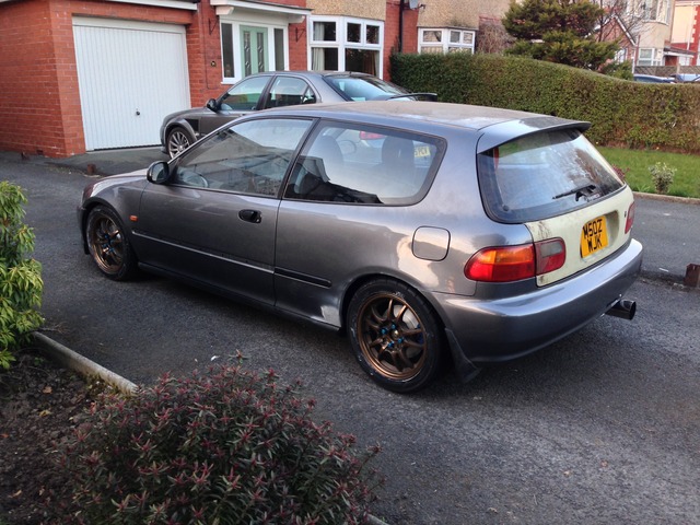

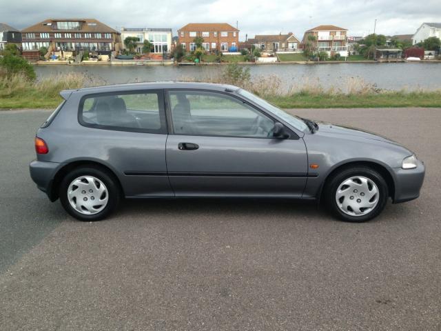

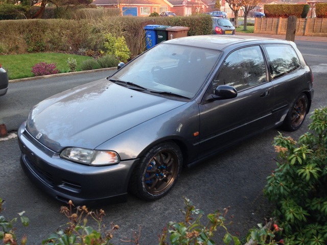

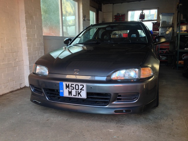

I have been away from the Honda scene for a couple of years now and had various Clio 1*2's in the meantime but have always missed lure of a modified Honda. My first car was a Civic EG so i have always had a special place for them.

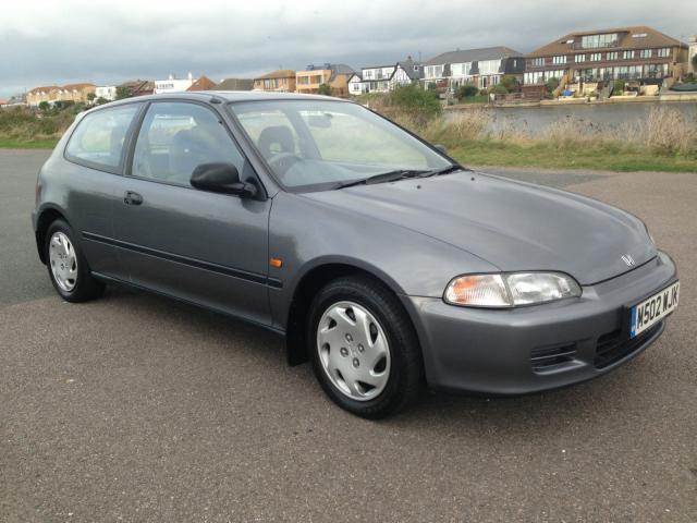

When this mint example came up for sale with just 30k on it with no rust, i had to have it. I have big plans for it, they have such a following the amount of aftermarket parts available is ridiculous.

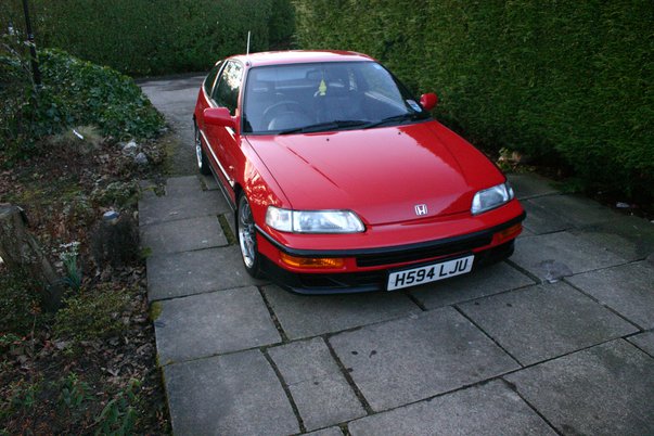

A couple of my old Hondas:

My old one: (B16A, DC2 Suspension etc etc)
Back on topic, rust free original EGs are so so rare - what are your plans with it?

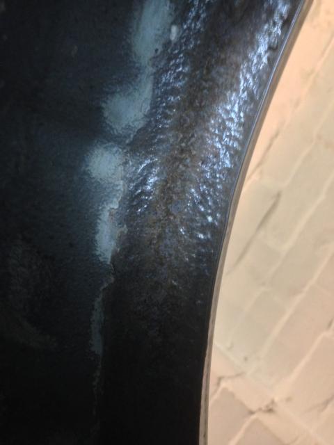

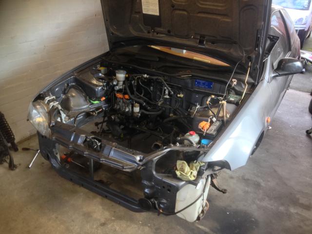

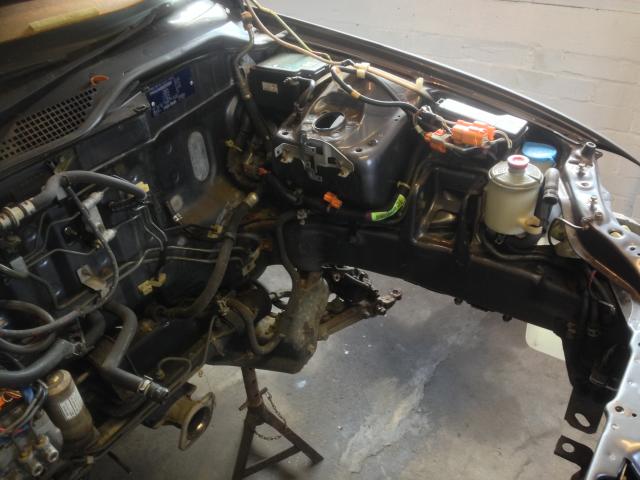

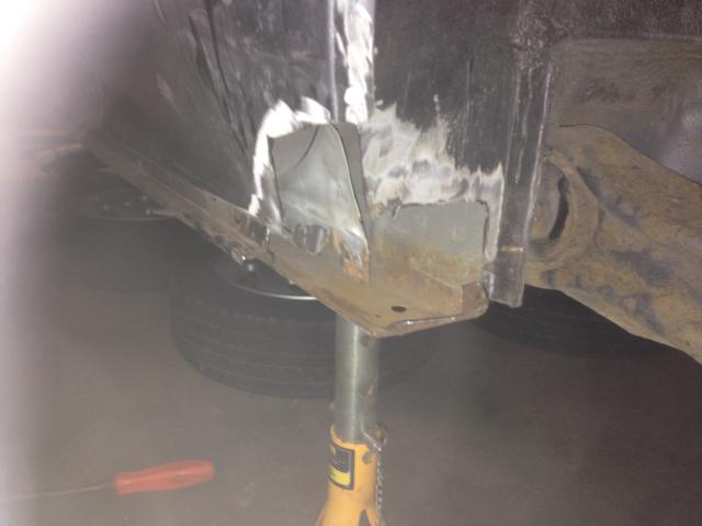

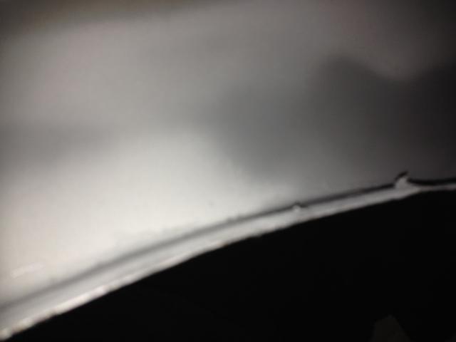

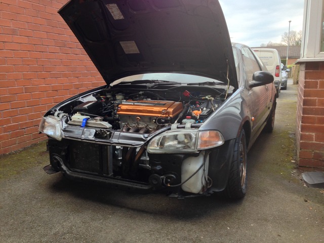

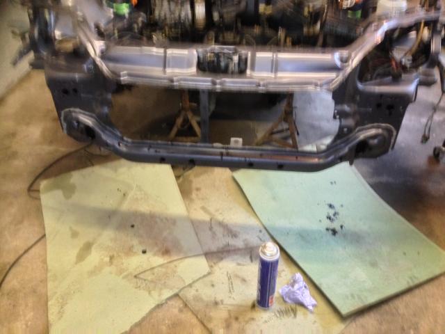

Little Update: I am progressing with the build slowly and just stripping everything down at the moment. What I thought was a rust free shell is not quite as I thought…. I found a small patch of rust upon removal the side skirt where the sill meets the arch. It appears someone has repaired it in the past with good old filler… GREAT! So I got onto a local mobile auto restoration man who came and sorted the rust to the nearside rear. Upon grinding back to bare metal it was evident someone had cut a 5p size hole out in the past and fillered over it. Not being one to do thinks by halfs I had it all cut out and a new inner and outer arch/sill fabricated, replacing metal with metal. All the surface rust inside the sill was ground off, treated with Bilt Hamber Dynax S-50 to prevent rust coming back. The inside face of all the fabricated pieces was also coated with zinc primer before welding in place. It was nice to see it all being done rather than handing it over to be bodyshop where they could be doing anything and they generally don’t replace the inner arch pieces let alone coat the inner pieces with zinc primer.

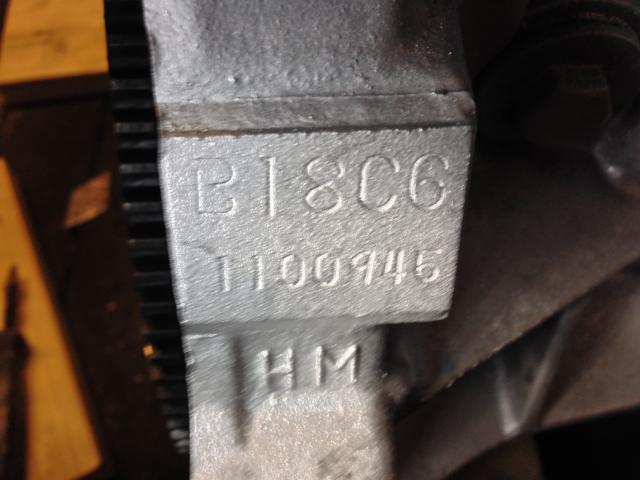

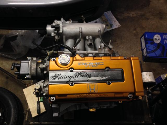

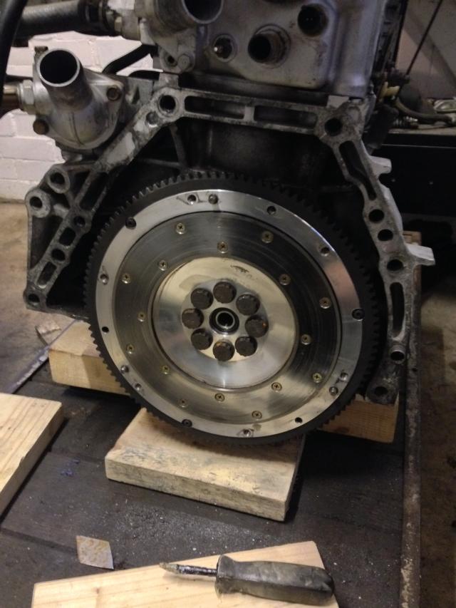

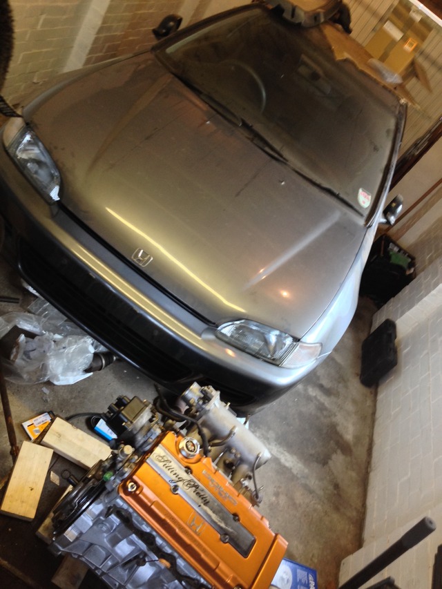

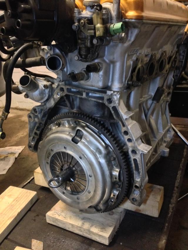

I have also purchased a newly rebuilt B18C6 from the Integra Type R.

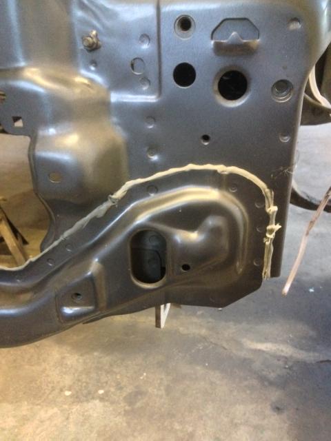

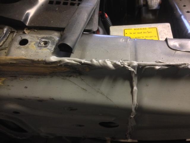

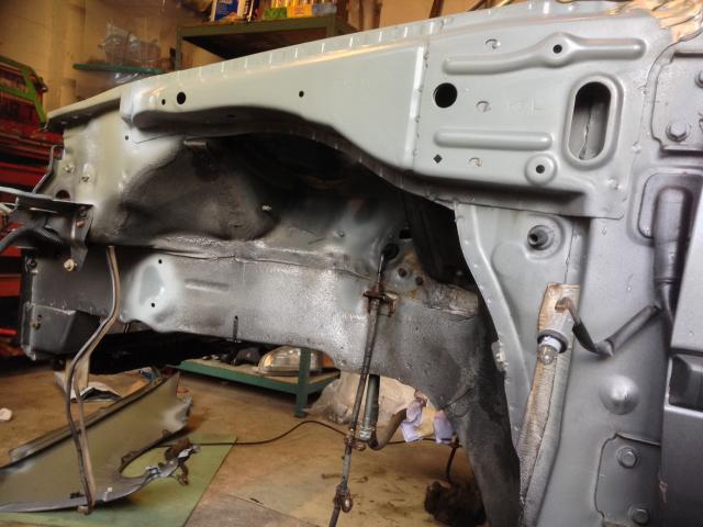

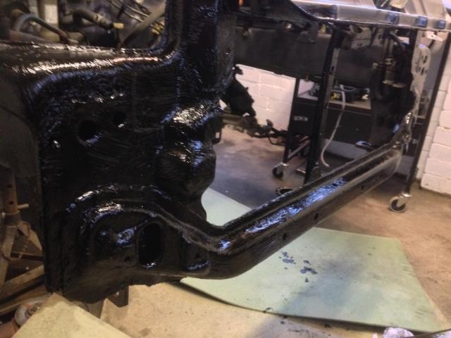

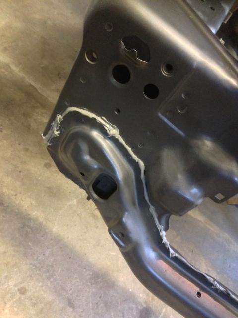

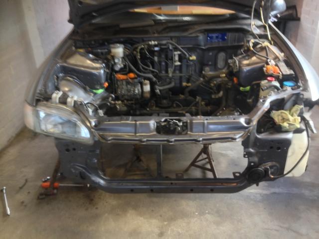

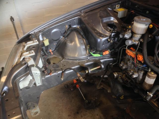

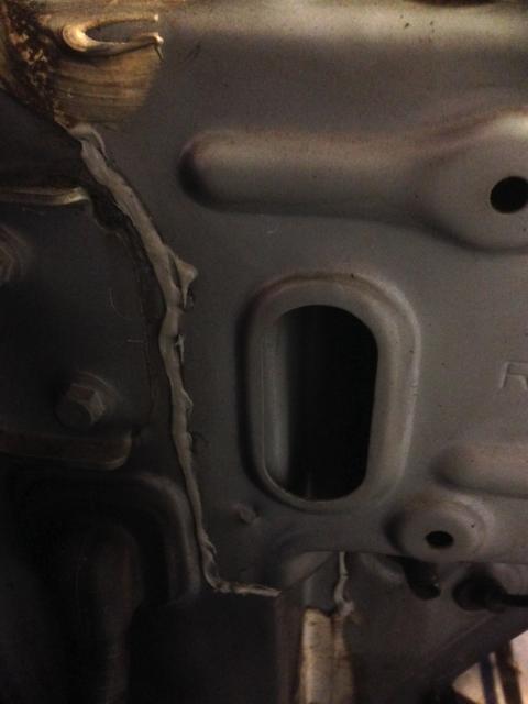

My concentrations are now aimed at getting the front end sorted. I am currently on with stripping it all down, seams are being filled with seam sealer. All spots of surface rust are being ground down with wire brush back to bare metal, 2 coats of Bilt Hamber Electrox then behind the wings and bumper and all underneath is to be coated withBilt Hamber UB. All cavities, I.e. Chassis legs, and front cross member are to be filled with Bilt Hamber Dynax S-50.
That’s it for now!

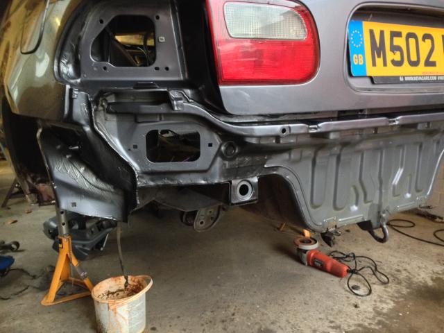

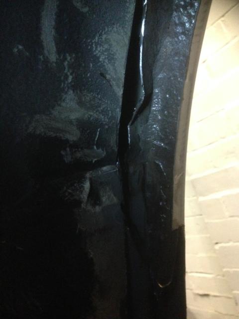

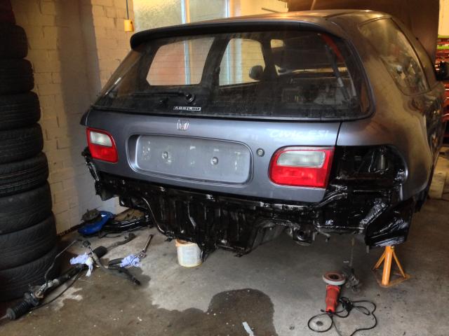

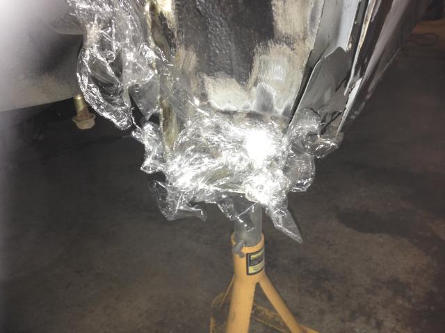

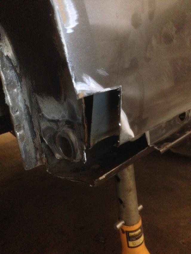

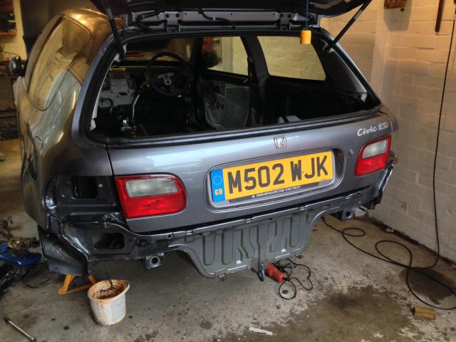

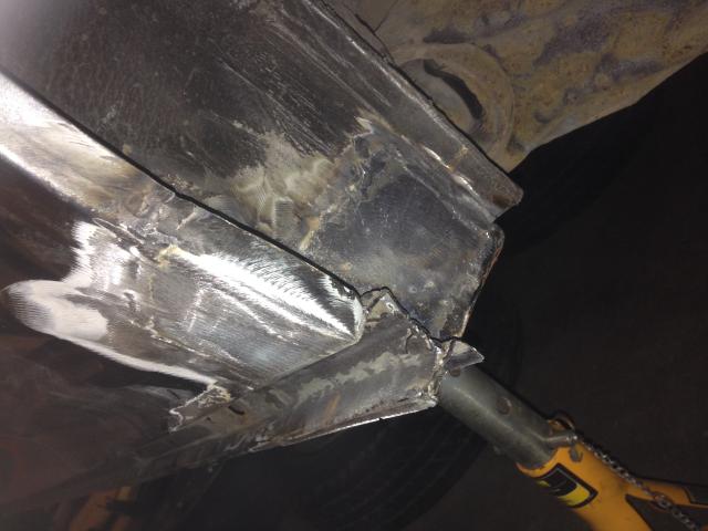

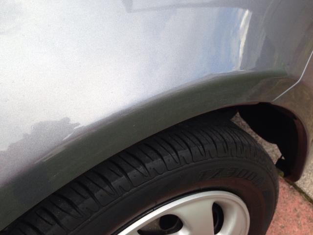

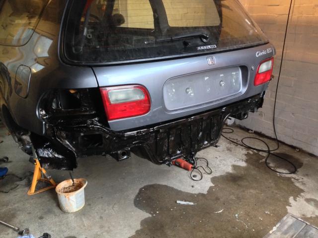

More little updates, i seem to have spent ages working on the car yet made little process. I am just taking my time and ensuring all rust has been removed before undersealing.

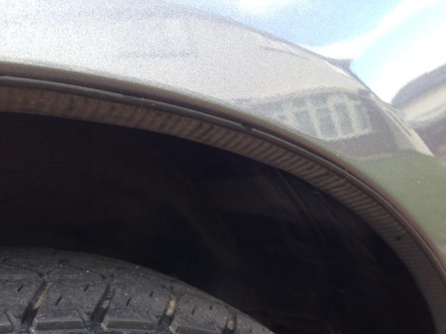

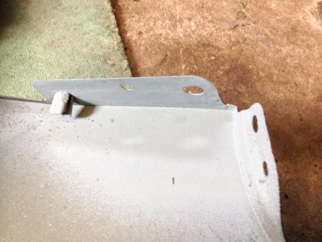

I wasn't entirely happy with the O/S/R rear arch so i have carefully cut out part of the outer arch and the inner arch was pitted in places, most people would of left it but it will only get worse so made the call to cut it out so there is no doubt. Separating the inner arch from the outer arch was a painfully slow process but it gave me chance to clean up inside the arch followed by 3 coats of Bilt Hamber Zinc Primer. Now i just have to wait for a slot with the fabricator so he can come round carry out all the metalwork.

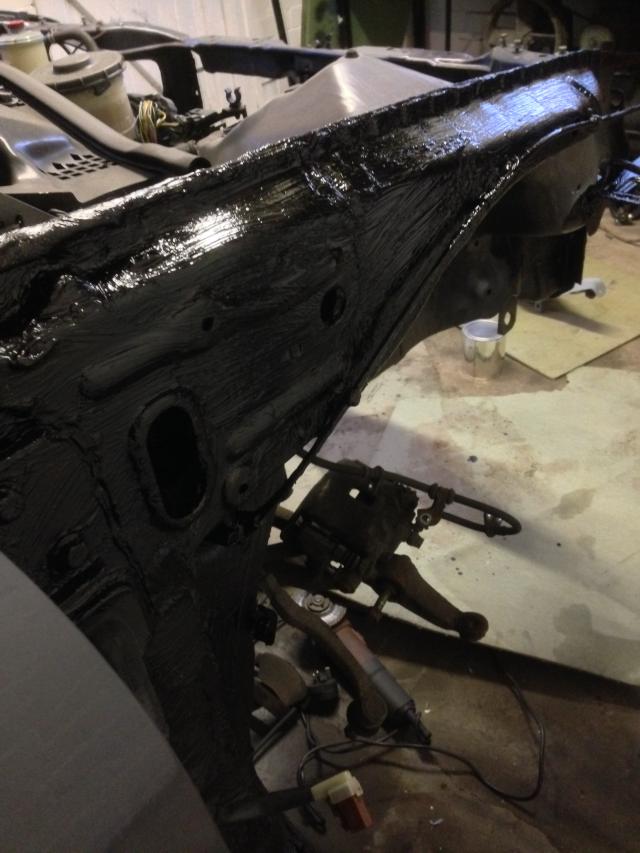

Most of the front end has now been undersealed and the front arches have been scrubbed and resealed. The wing panels had tiny bits of rust so i cleaned that up an zinc primed before reinstalling. The sills are pretty much mint so they have again been zinc primed and undersealed.

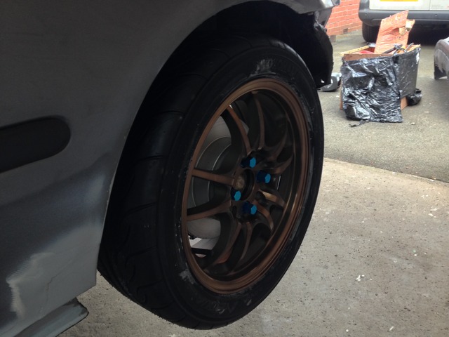

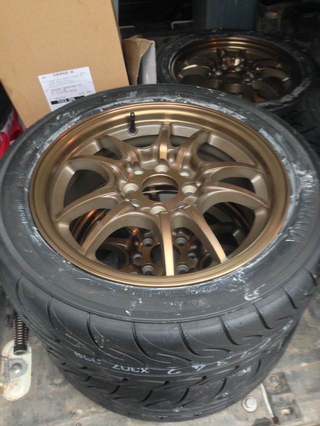

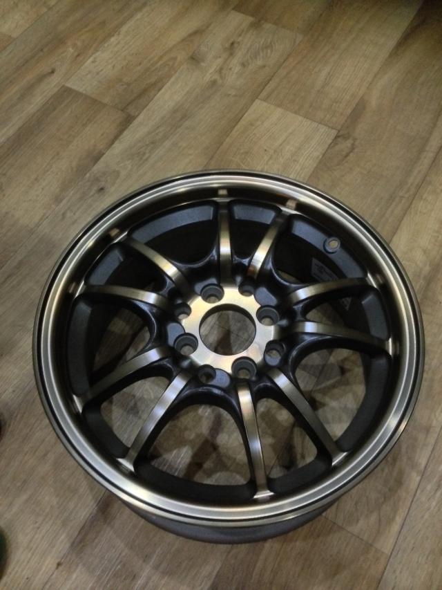

I had always intended on 15' Rota Circuit 10's so i ordered them just before Christmas only to find they have been discontinued, then by some miracle a brand new set came up on the CRX forum so i snapped them up then bought some Michelin Pilot Sport 3's.

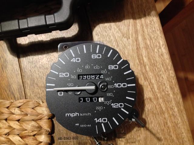

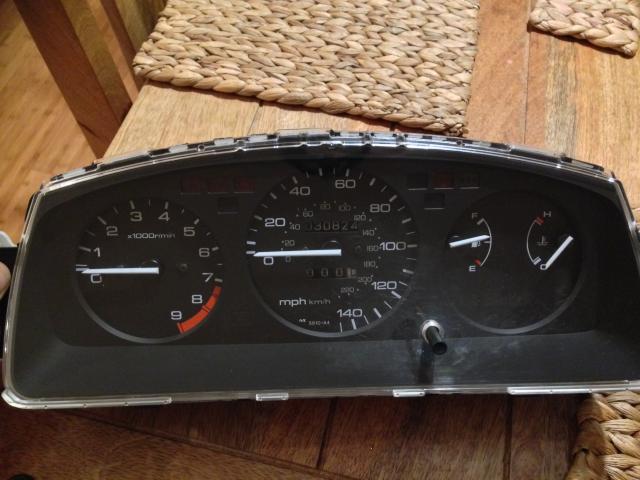

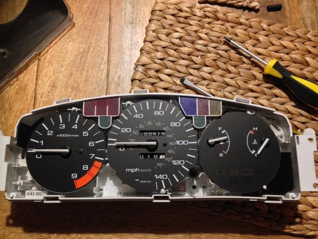

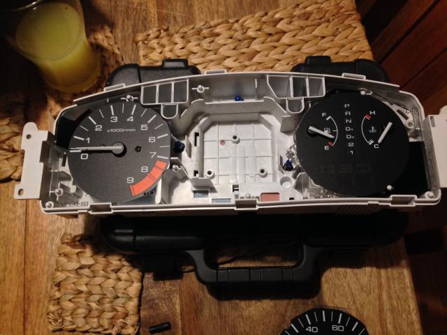

I bought a spare set of manual dials from a late spec esi with ABS and swapped my odometer into them.

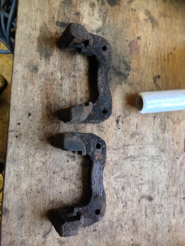

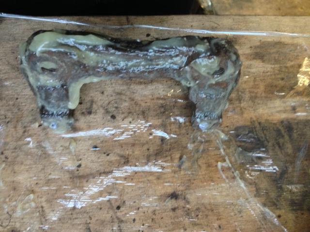

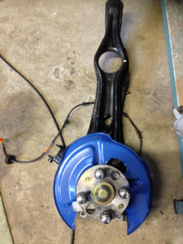

Also bought a set of MG ZS 180 rear carriers which are being cleaned up and painted. They fit straight onto my existing calipers and allow me to use 260mm rear discs and larger pads.

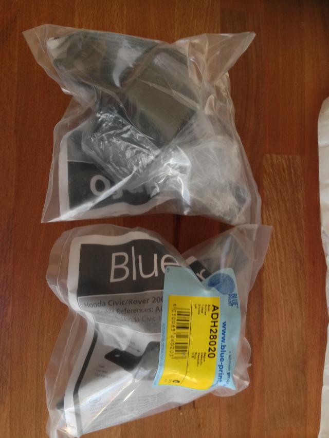

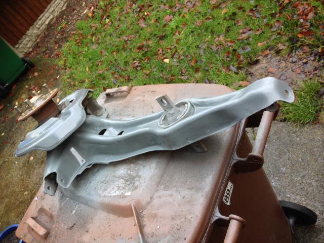

The rear trailing arms were removed, cleaned up and given a fresh coat of paint with new Blueprint Trailing Arm Bushes.

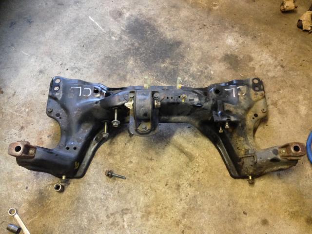

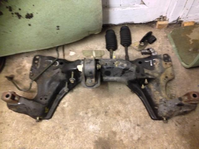

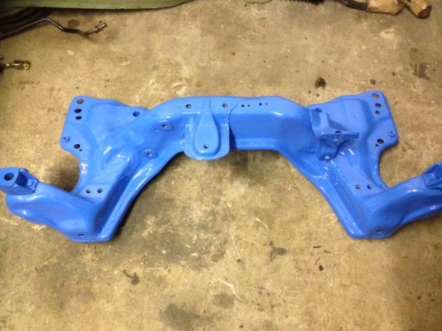

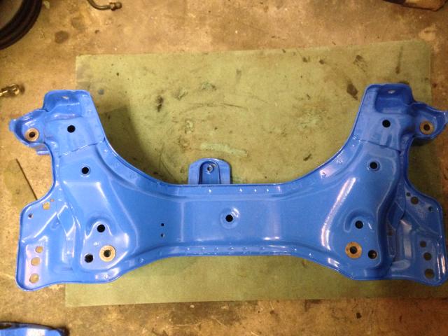

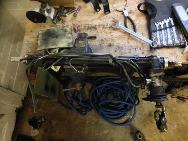

Bought an ITR Front Subframe and Rack, stripped the rack back and swapped over the p/s hoses from my eg rack as there were in much better condition. The track rod inners and ends have been ordered. I wasnt prepared to pay Honda prices and couldnt get hold of Lemforder joints anywhere. After ringing around my options were Blueprint or Moog, I opted for Moog as the make their own components rather than reboxing like Blue print. The Americans seem to swear by Moog and they come with 2years Warranty. I have Hardrace steering rack bushes on order to finish off the rack. Subframe is being sent off to be powder coated.
Pics of the rear end progress:

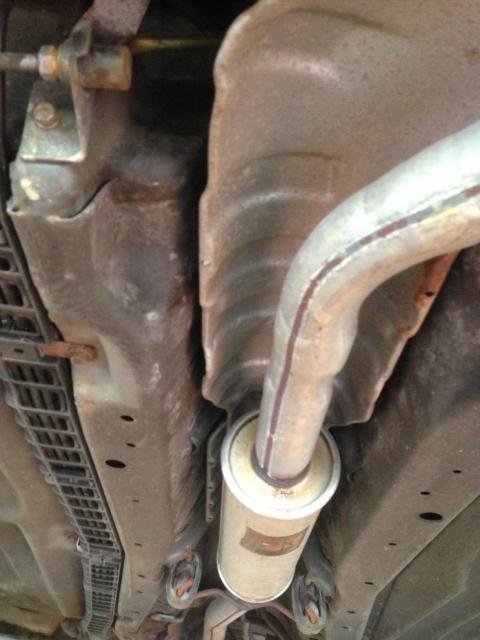

I have turned a corner with the car now and the undersealing is completed which means I can now start putting bits back on the car

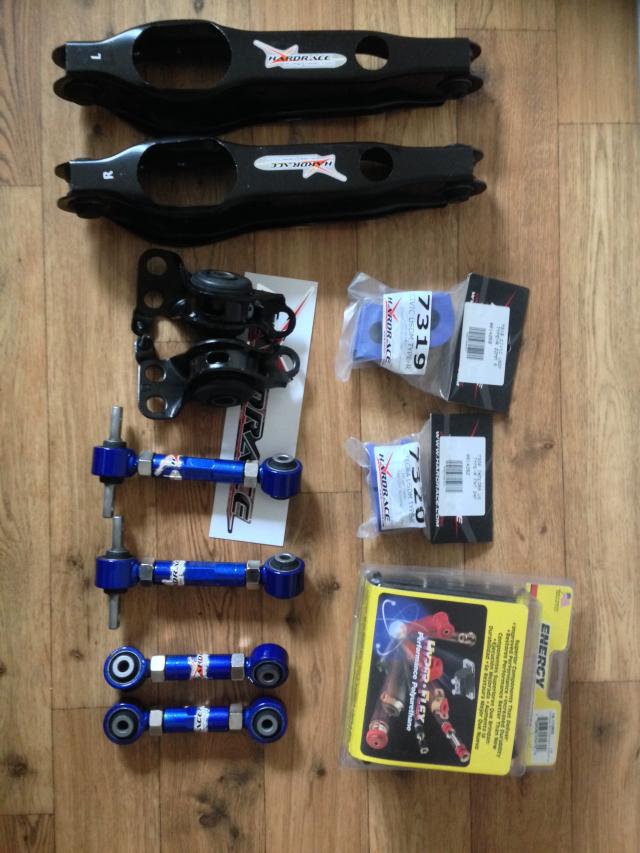

Some of the bits I have purchased:

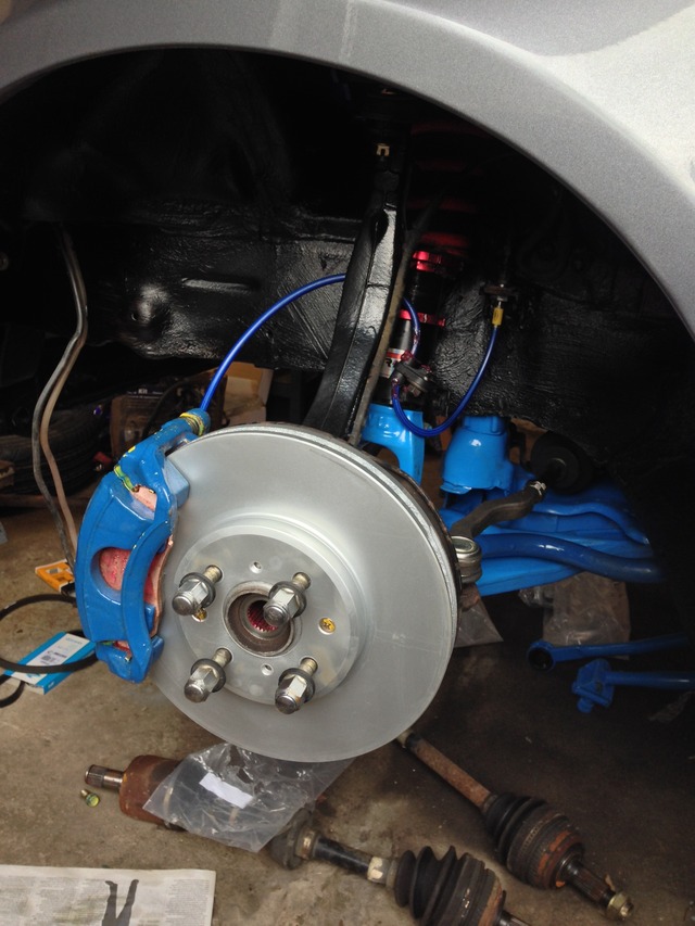

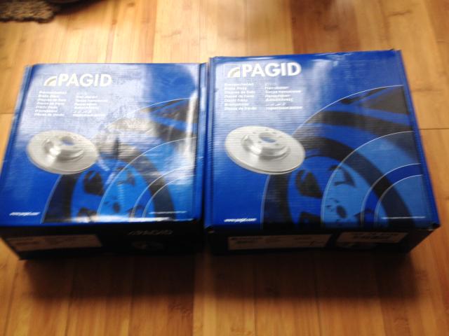

Pagid 282mm Front Discs & Pagid 260mm Rear discs:

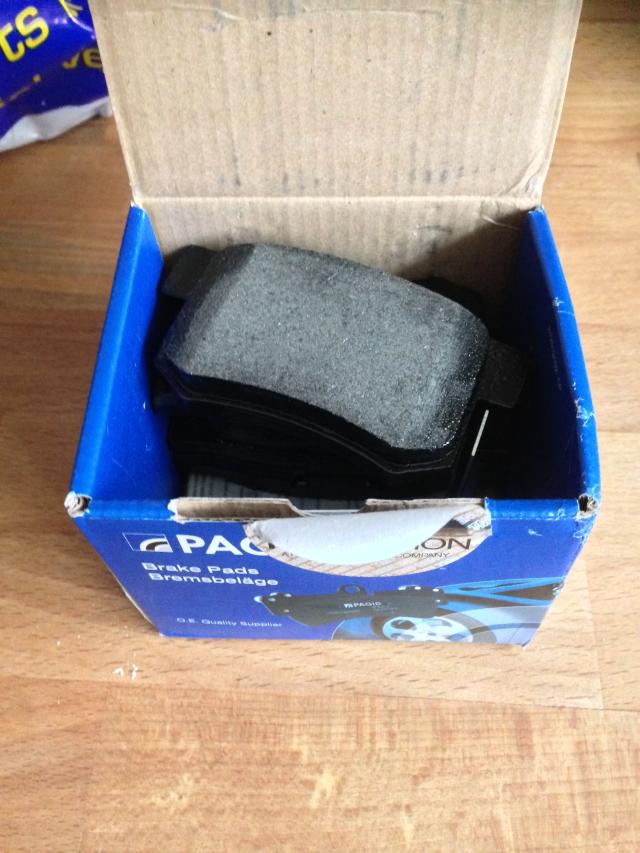

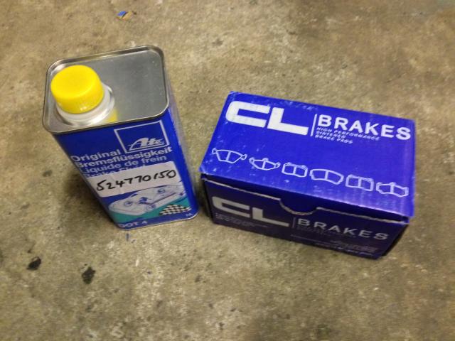

Pagid 260mm rear pads:

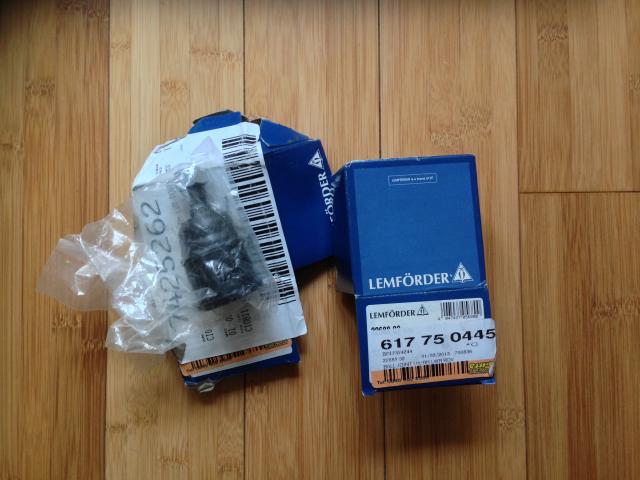

Lemforder Ball joints:

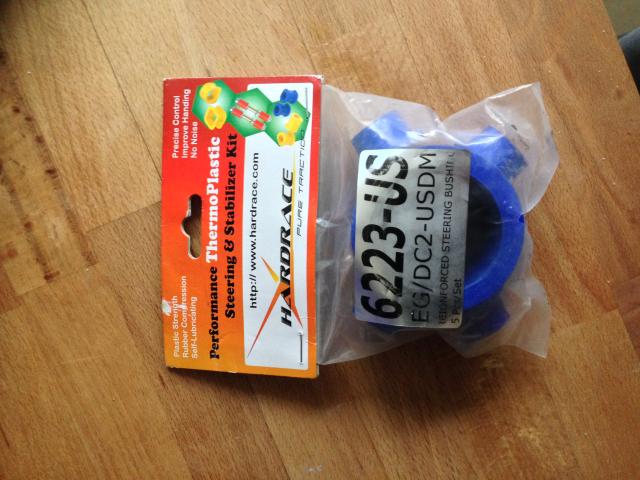

Hardrace Steering rack bushes (Now installed to DC2 steering rack)

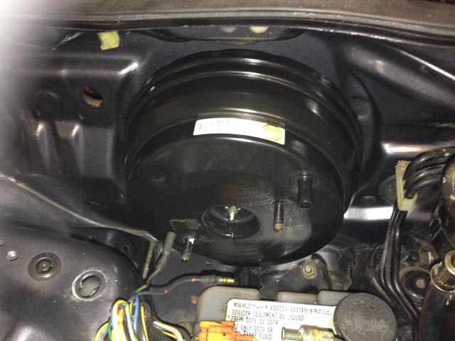

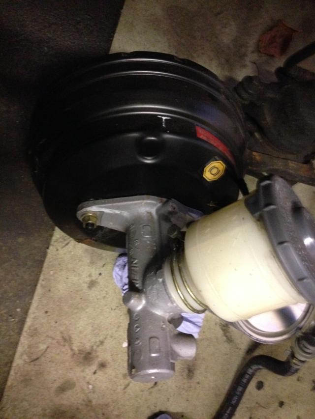

Old 15/16 Brake MC & Servo removed and being replaced with 1" MB6 - (Just having the new hardlines made up to fit)

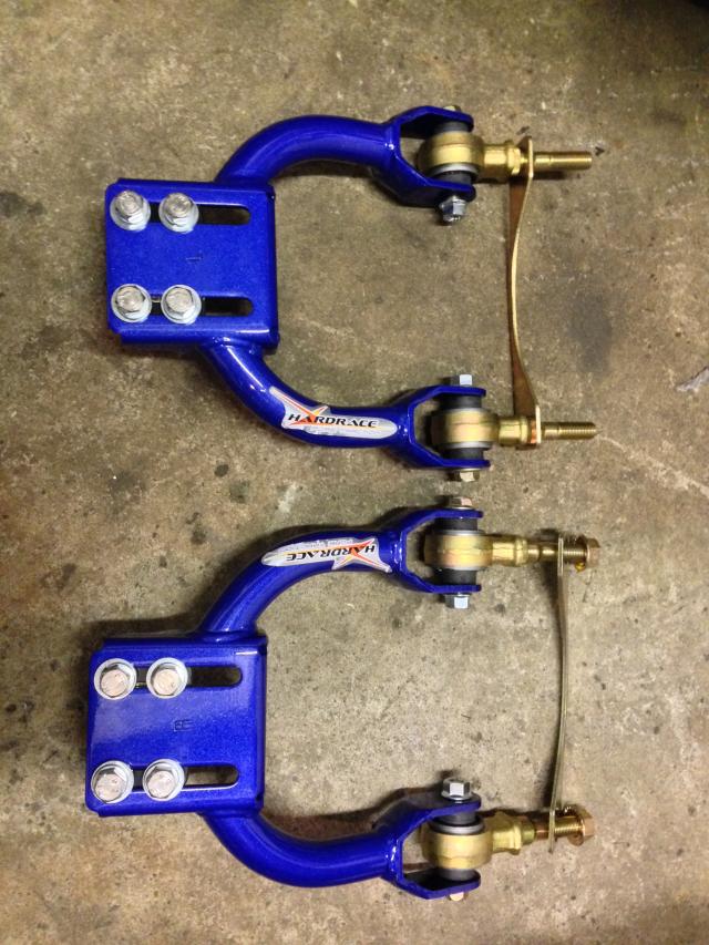

Hardrace front camber arms:

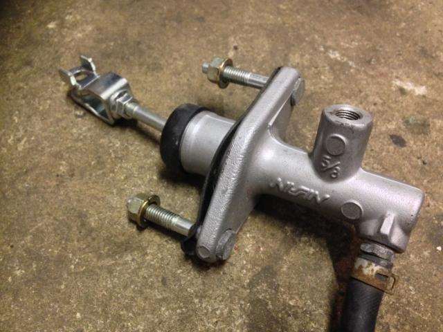

New Nissins Clutch master cylinder:

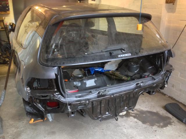

How it looks now: (tailagate removed for JDM one)

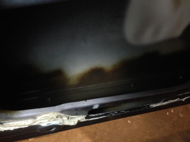

Inside of doors also sealed:

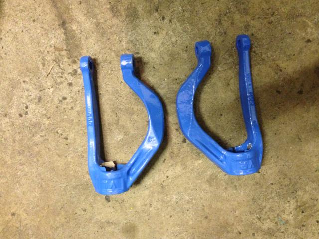

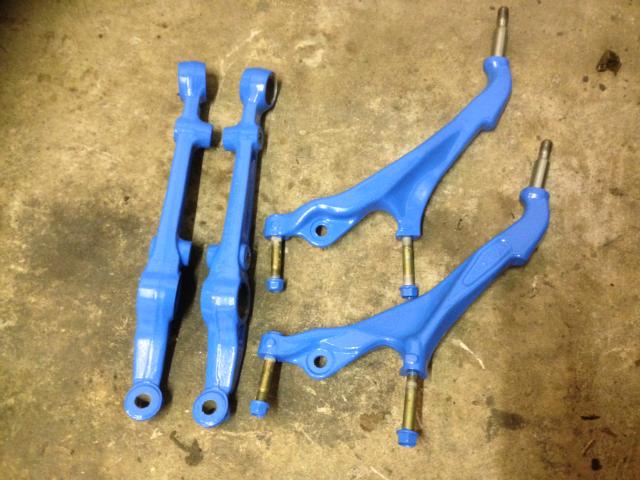

Powder coated suspension bits: Before & After:
SW Rigid collars installed:

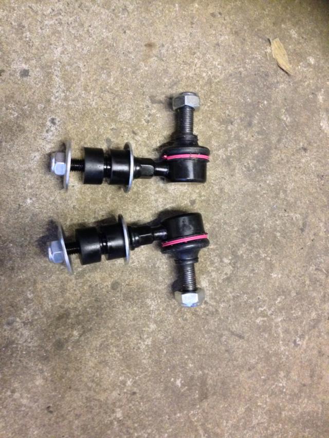

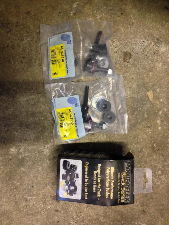

New Blueprint droplinks for DC2 ARB with powerflex bushes:

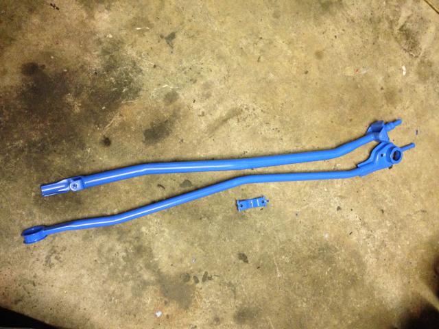

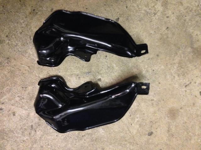

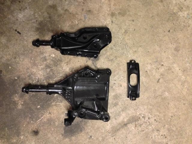

Picked up some more powdercoated bits last night:

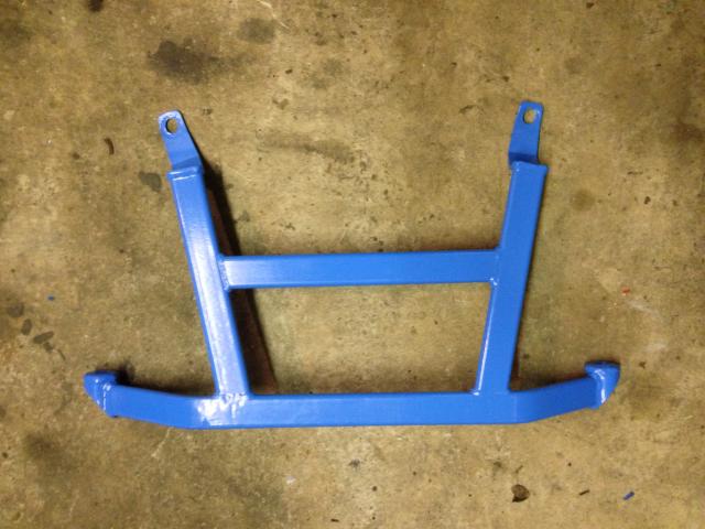

H-Brace
ITR Gearlinkage:
Suspension Forks
Torque mounts & Battery Tie
Rear caliper covers

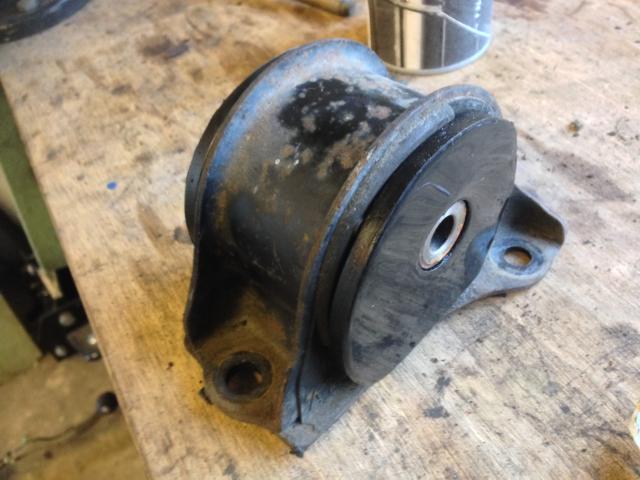

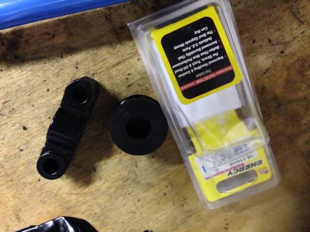

All new hardrace suspension parts & Energy solid engine mount inserts

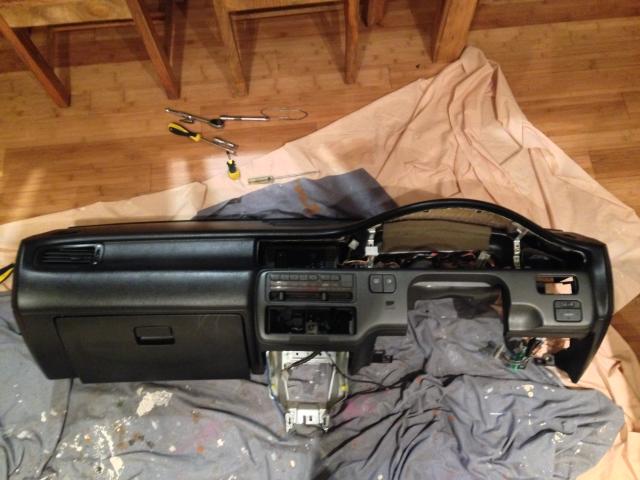

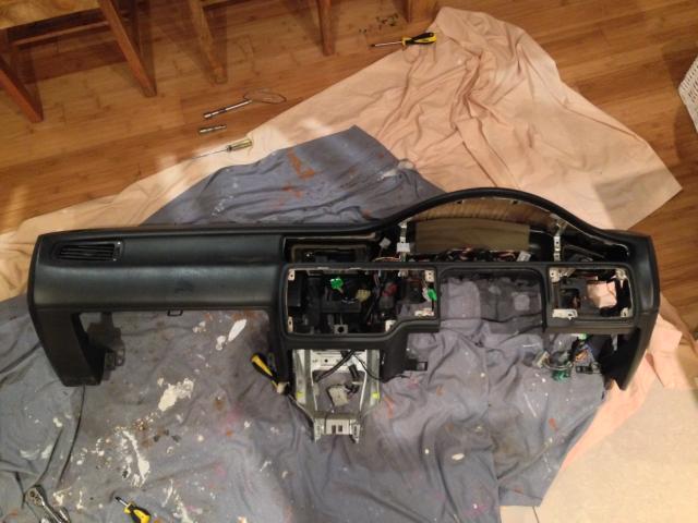

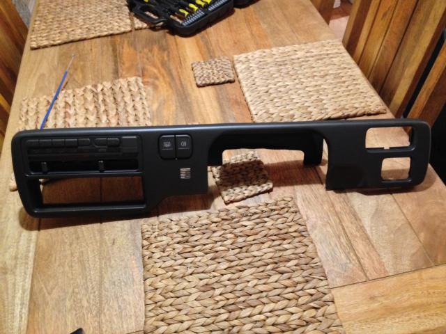

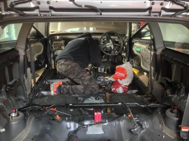

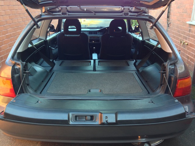

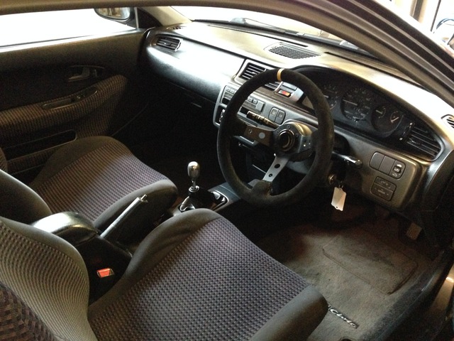

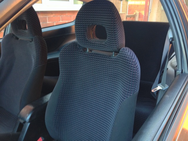

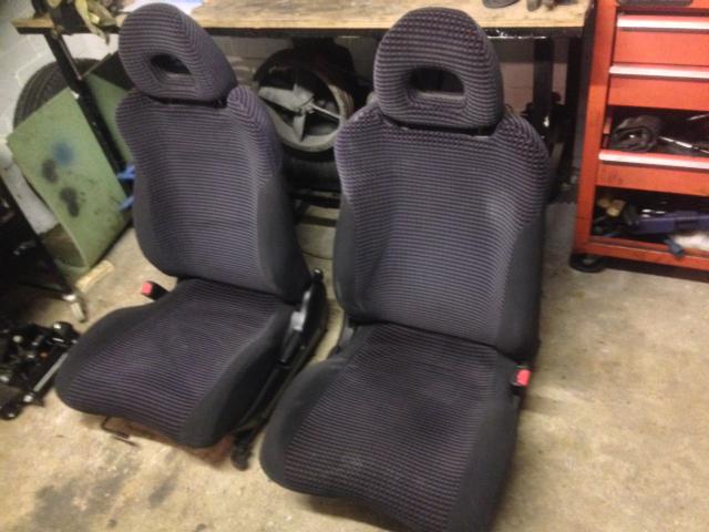

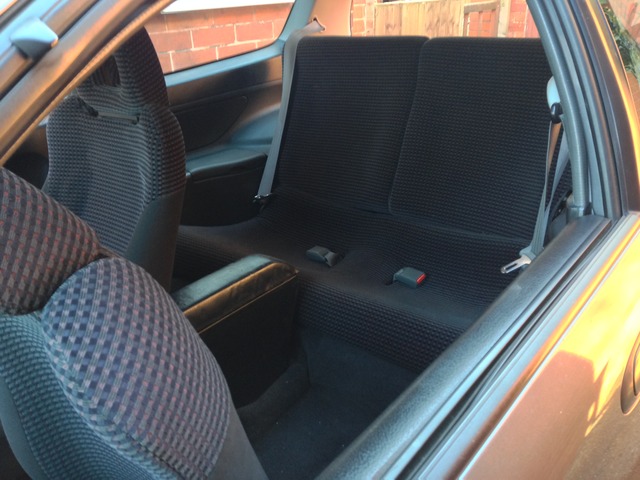

Starting clean up the black interior, the bezel panel was scratched and my original dash bezel was mint so swapped them over.

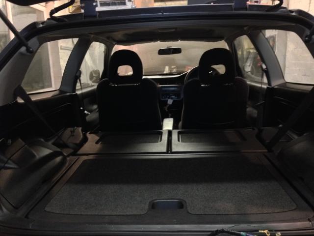

I also managed to source a rare EG6 SIR kouki interior so the EG6 VTI interior I already have will be for sale:

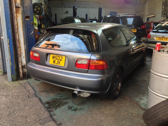

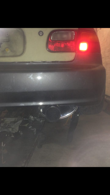

Tanabe Hyper Medallion Cat-back also fitted:

I have ordered a set of 195/50/15 AD08R tyres to go on the Rotas.
After a long wait from KAM Racing the Carbon Lorraine RC5+ Pads turned up. Brakes bled and feel good. I have had the ABS modulator off so this may or may not need to be bled later?
My brake setup is:
Blue HEL Brake hoses
ATE TYP200 Brake Fluid (Super Racing Blue's replacement)
282mm front discs with Carbon Lorraine RC5+ pads
260mm Rear discs with Pagid Pads
1' Master Cylinder
Mark Burnett came round and welded in the SIR rear seat brackets so I could fit the SIR interior.

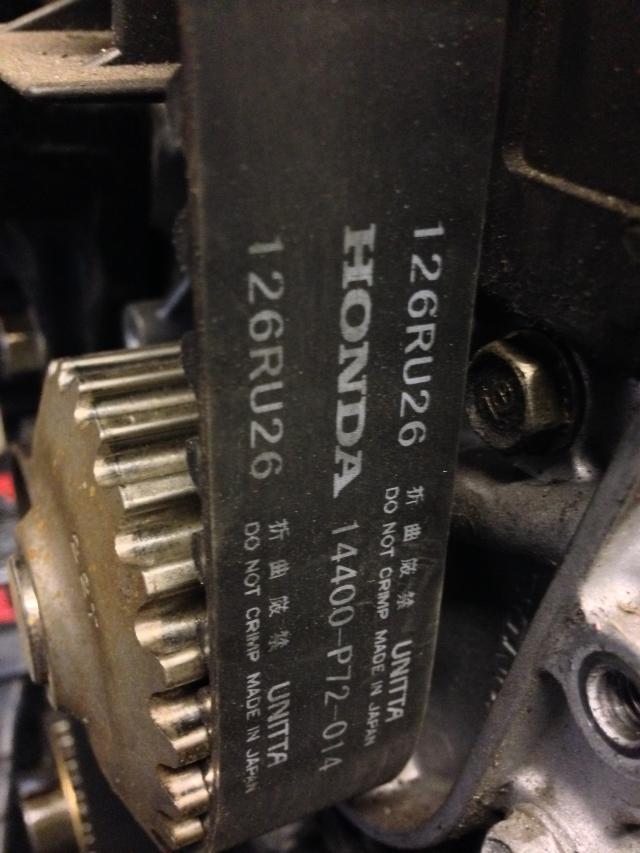

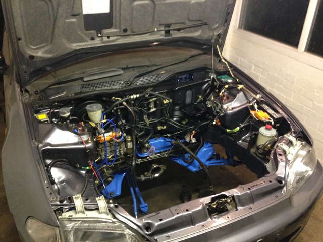

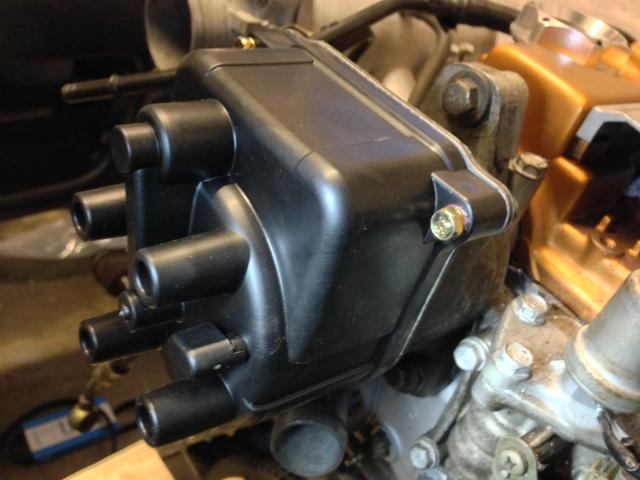

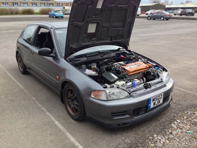

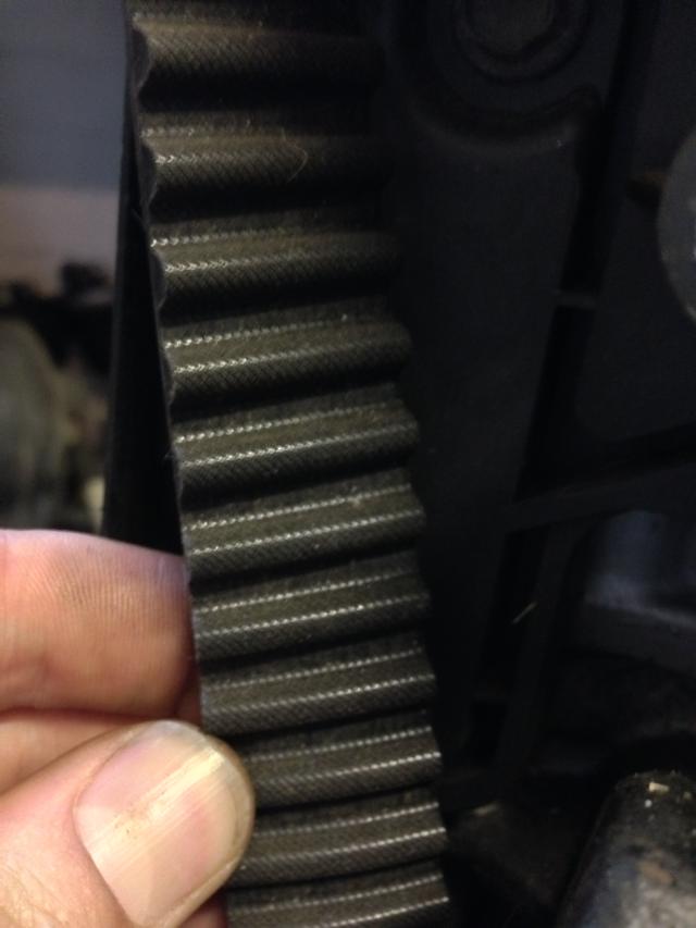

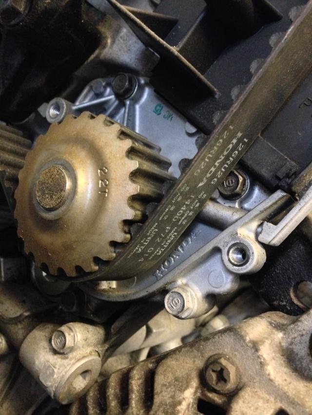

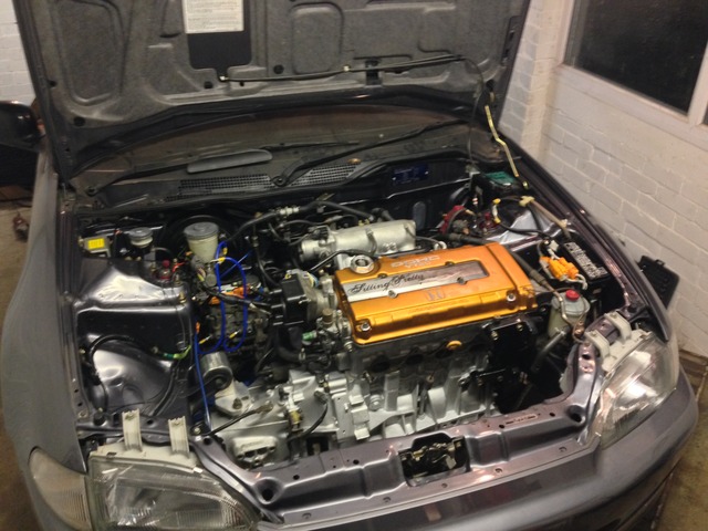

So with the interior, brakes and suspension sorted I turned my attention to the engine. I had bought a new GATES Timing belt, Koyo tensioner and waterpump but after investigating they all looked like new. The engine was apparently rebuilt 2000miles ago and this backs it up so I chose not to do the timing belt and instead fitted the Fidanza 3.4KG flywheel and Honda OEM clutch kit.
New Dizzy Cap and Rotor Arm from OEMJAPSERVICEPARTS:

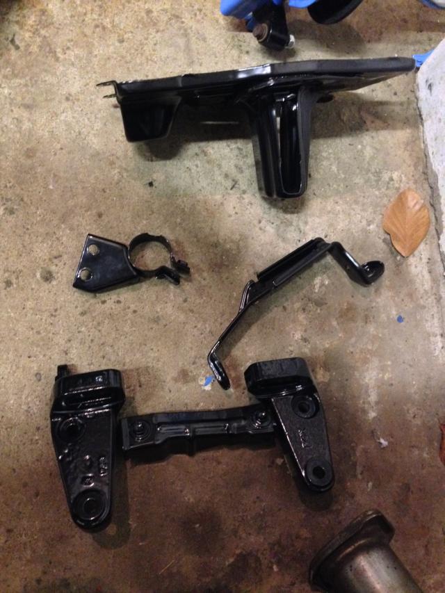

Yet more powder coated brackets:

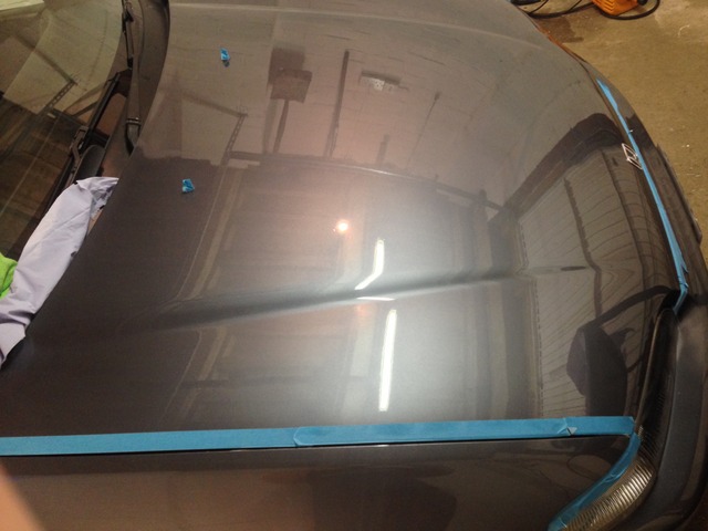

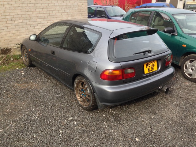

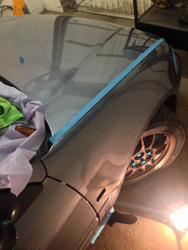

Bodyshop: So the car has been painted, I had both rear quarter panels, side strips and the JDM tailgate sprayed. The bodyshop did a great job and the colour match which I was most worried about was spot on and blended in nicely. The plastic strips on the rear arch lips arent being replaced so I had the bodyshop coat the lip with stonechip for added protection. I opted against spraying the lip and left it black to break up the colour.
Fresh out the bodyshop:
Next stop was the MOT which flew through - Now all road legal but still off the road until it could be remapped and suspension setup.

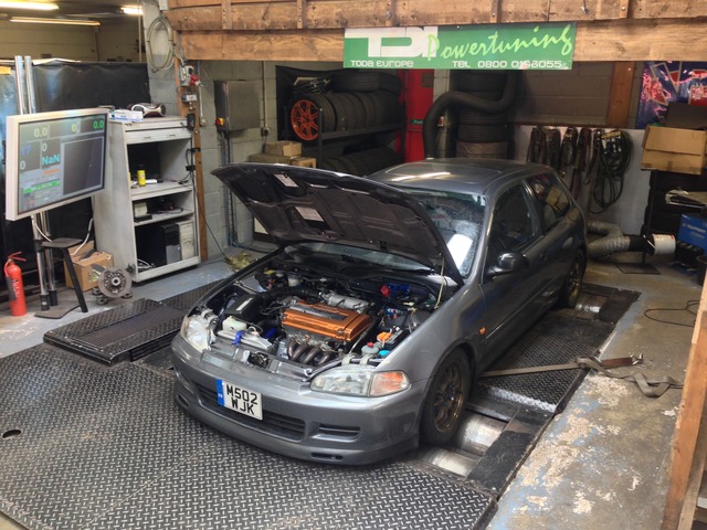

Then after what seems like an eternity as I just wanted to drive the thing, TDI North were able to map the car. It made 208bhp which I was more than happy with. The IAT was reading -15 permanently so Paul took one off an s2000 to map it which meant I came away needing to find a new sensor but all in all a good day.
Power Run:

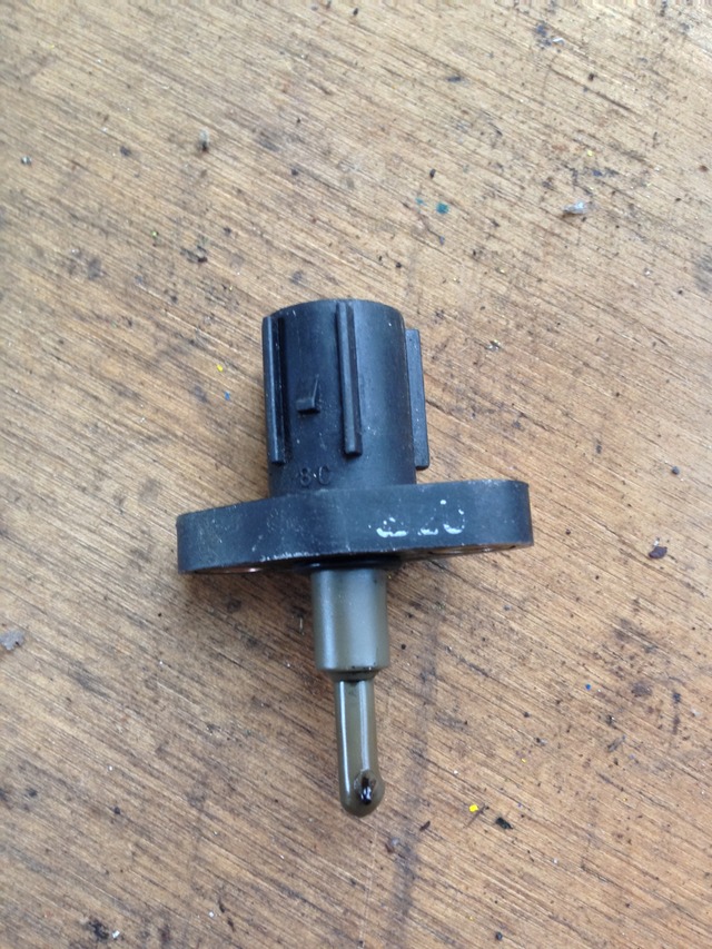

I managed to source an s2000 IAT pretty quickly and now the car was running brilliantly.
This was the offender:

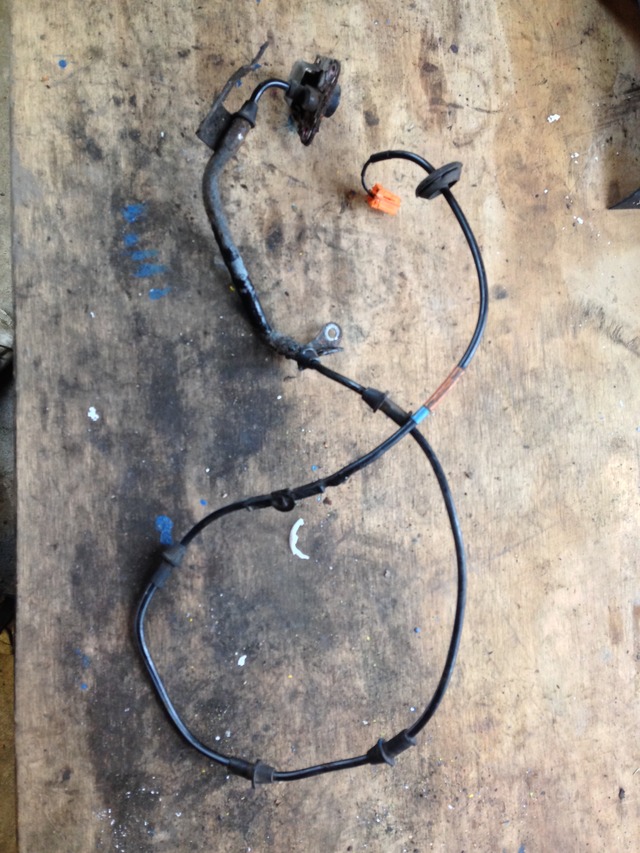

A week before I was due to set off to Germany the ABS light came on so I was able to source a new rear ABS sensor:

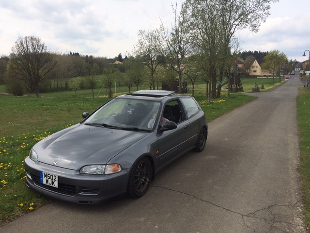

So I put alot of time and money into the car to get it ready for the Ring and pushed hard in the last month to get it ready in time. I would of liked to put a few more miles on it before I went but the car was brilliant all weekend. I managed to get 9 laps in, I had hoped for more but the Sunday was a wash out and didnt want to risk pushing the car too hard on a wet track. I filmed all my laps on the GO PRO so will put one up when I get chance.

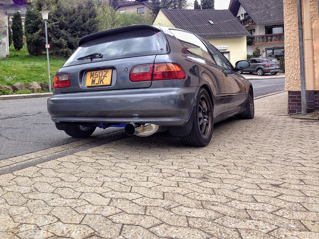

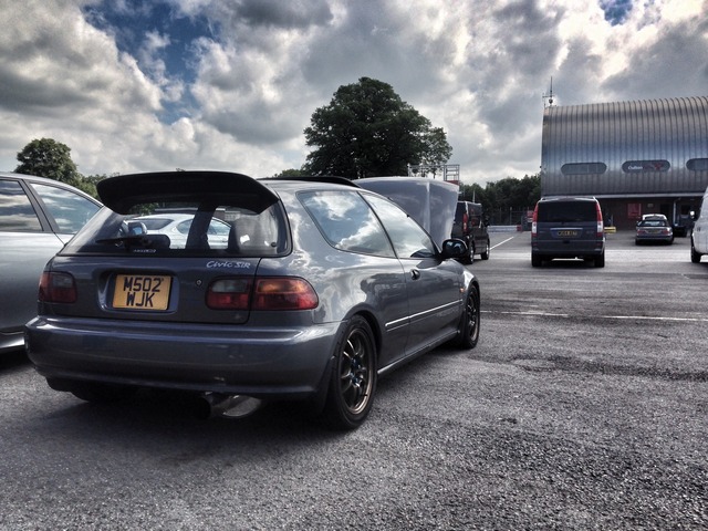

Anyway... a few pics from the weekend.

Met up with Spenny D a few weeks back in this K20 EG and got a few photos:

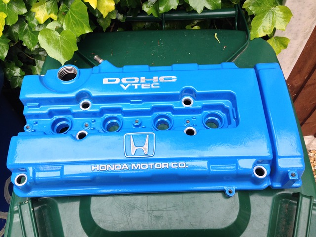

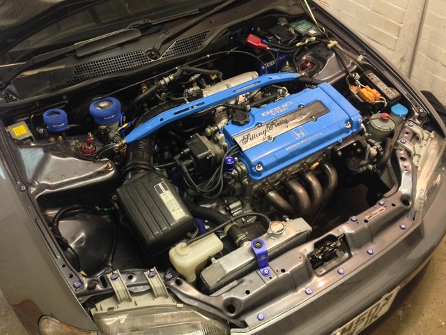

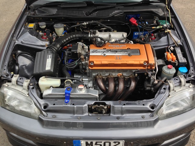

Had the rocker cover and strut brace powder coated in blue along with a few other bits to brighten up the engine bay:
Before:
After:

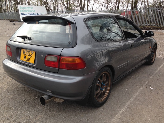

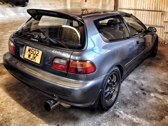

I have had a spoon spoiler laying around for ages so tried that on and I think it looks much better. The fit isn't brilliant so I will probably end up getting another that fits better. I also added a Civic SIR tailgate decal.

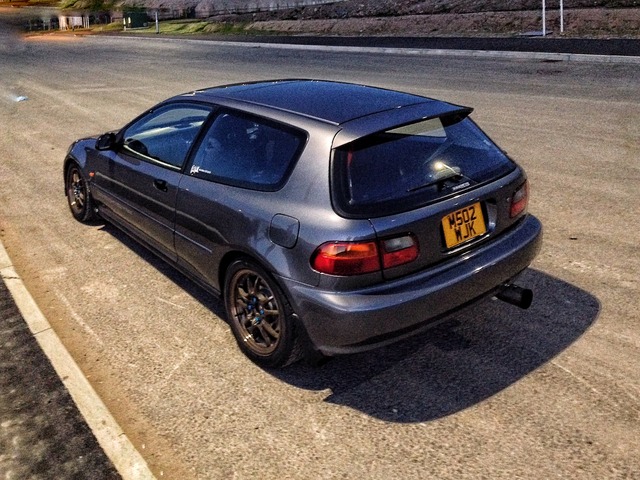

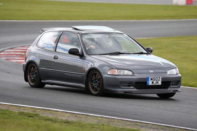

Lastly, I did an Oulton Park trackday on Tuesday, the weather was great all day so I was really able to push the car. The carbone lorraine pads were going off after 4 or so laps I think I need to look at brake ducts or the RC6 pad variation. I had a lucky moment on the last corner with the accelerator pedal becoming stuck on the mat which nearly saw me in the gravel trap!
Looking at the go pro seems my lap times were between 2.09 - 2.14 secs.
Just a few more pics from the day:
