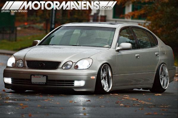

how do i get a offset ?
Offset is a measurement not a type of stance, all wheels have offset.
Do you mean wheels poking out the arches etc?
like this ?
Ahh, that's negative camber. You'll need to buy either camber bolts or camber adjustable top mounts for the front, and camber shims for the rear, which are quite hard to find IIRC.
K-tec do all the bits for the front btw, there is a pikey way of doing the rears without shims IIRC but I've no idea how to do it.
