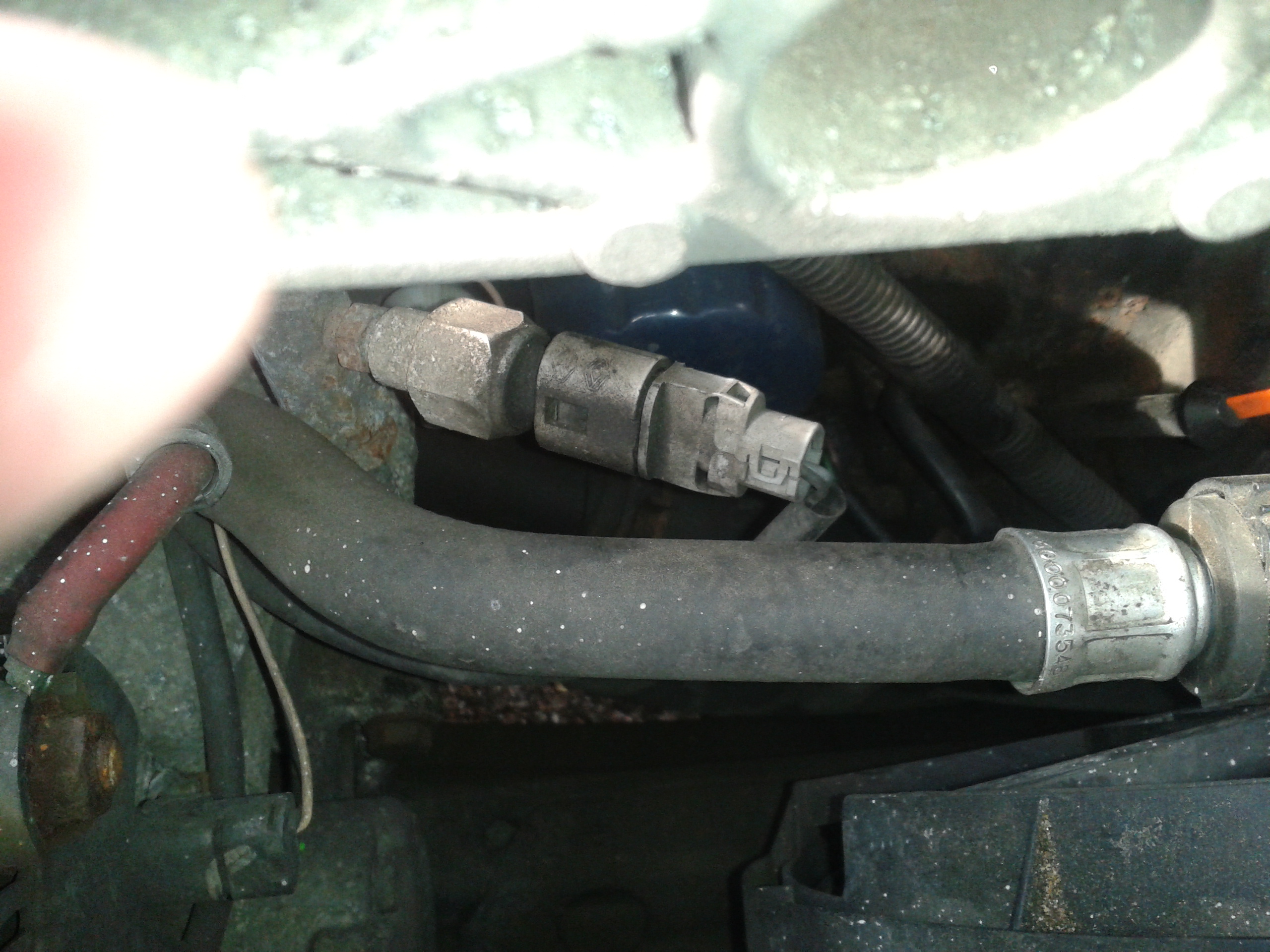

Significant oil leak on to engine undertray

is it a significant oil leak or a significant amount of time before last checked, the engine undertray will get gunky and oily overtime due to the gearbox seeping oil, they all do it
  Land Rover
The oil leak appears to be coming from a sensor screwed into the engine block right next to the oil filter?
  Land Rover
Well, it wasn’t that. The oil was actually PAS fluid leaking from a sensor just above the engine oil pressure one.
  Land Rover
I can’t order the part until Tuesday. Hopefully it will last another few days, l think it’s been leaking a while.
