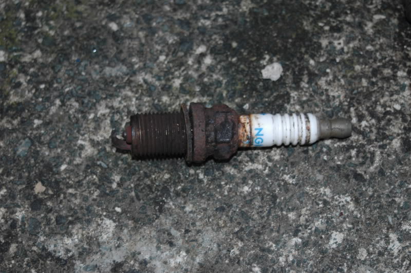

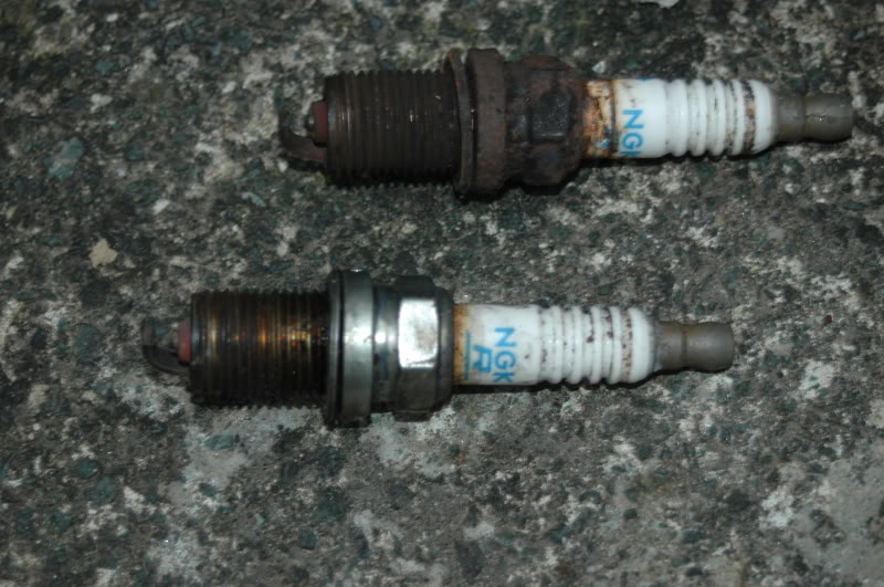

My 75k 6 year old ones in my 172 looked as good as the new ones!
+1Check the HT lead boots are sealing properly. If they let water in then any water splashed about the engine bay will find its way into the plug holes and stay there. If you don't do many long journeys it could take a long time to evaporate off!
