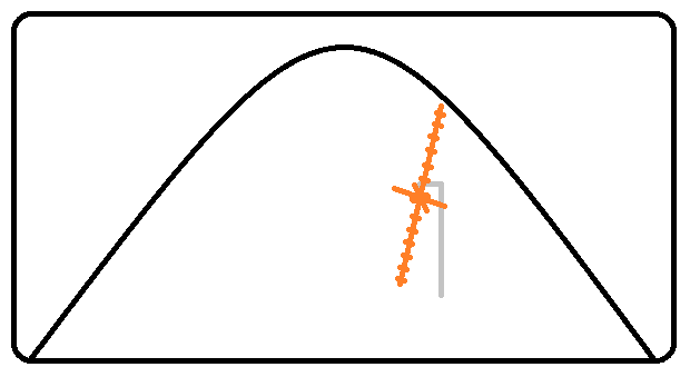

I've drawn a diagram of what I'm seeing when looking at a single road light, first within the wiper section...

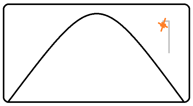

Then through the other section...

its scratches on your screen from wipers.
new screen + no wipers
or
a properly polished screen + no wipers
will solve your problems

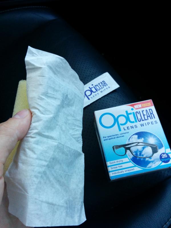

I use small wipes that are made for cleaning glasses on the interior. Made a big difference for me. Can get a pack of wipes for £1 from poundshops and supermarkets.
Wrap it round a sponge to get better coverage and wipe away.
Gotta be worth a go for the sake of a quid to see if it helps. But as above, I should expect a majority of what you get is due to the screen being scratched/marked.
