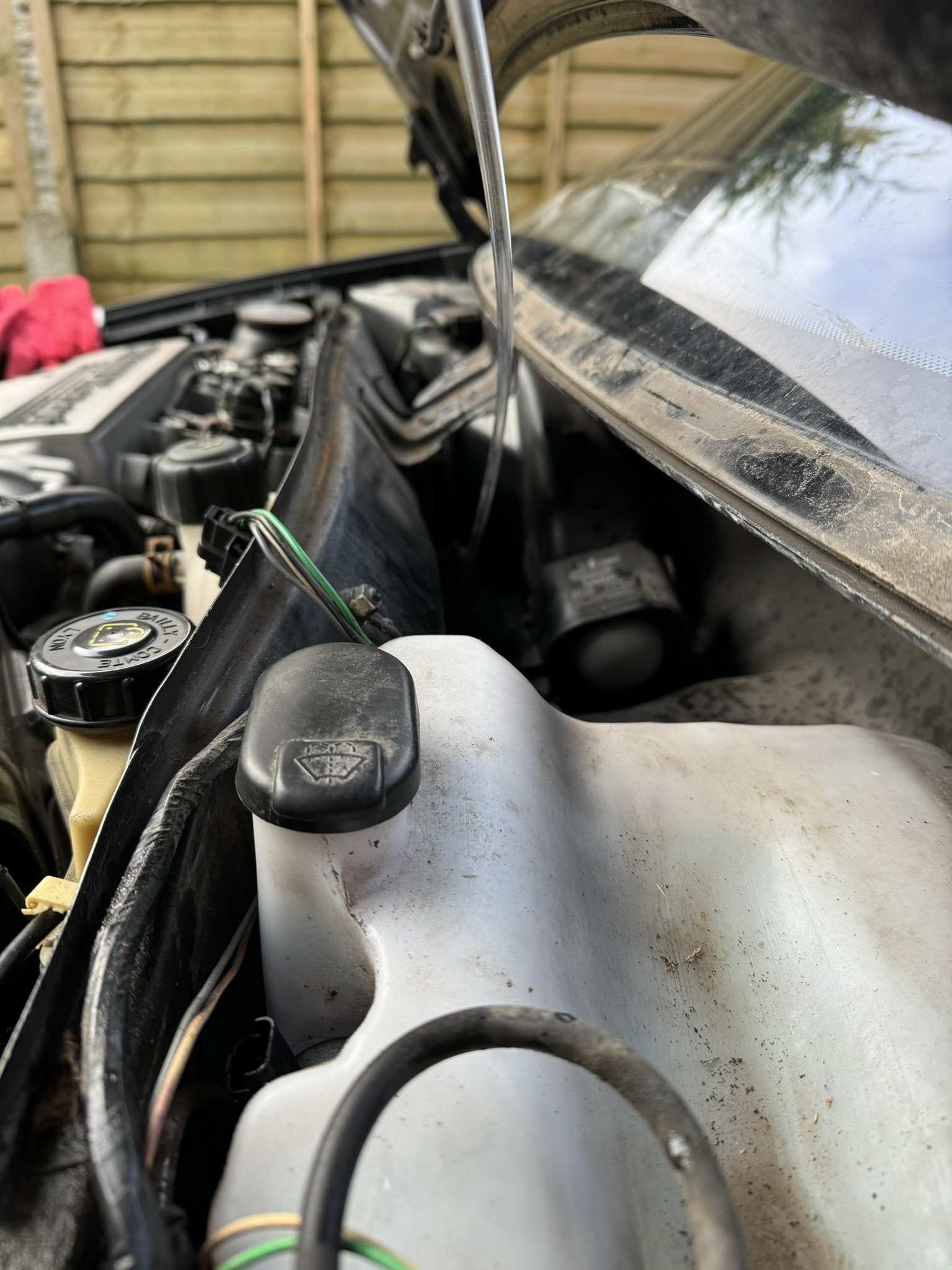

Watering can to hand, I had removed the the wiper mechanism and shimmied the water bottle across a little - enough so I could see below it. Sure enough, water gushed out onto the floor when I poured a little in. Same thing happened on the drivers side.
Repeated that in the middle area and next to nothing came out. The smallest of drips - so the centre drainage was clearly blocked.
Getting the wiper mechanism out is very easy - literally a 13mm and 10mm socket set is required. A wiper puller is a massive help - otherwise you'll be shouting and screaming in trying to get the damn things off. Something similar to this is very handy.
Once out, you should have access to the fairly large cavity that the wiper mechanism previously sat in. It also shows just how much crap gets trapped at the base of your windscreen beneath the trim!
Looking across from the water bottle to the passenger side, you can see approximately the area where the centre drainage hole is. I had a small length of clear plastic tubing (sticking upwards) which I found to be perfect for the job.

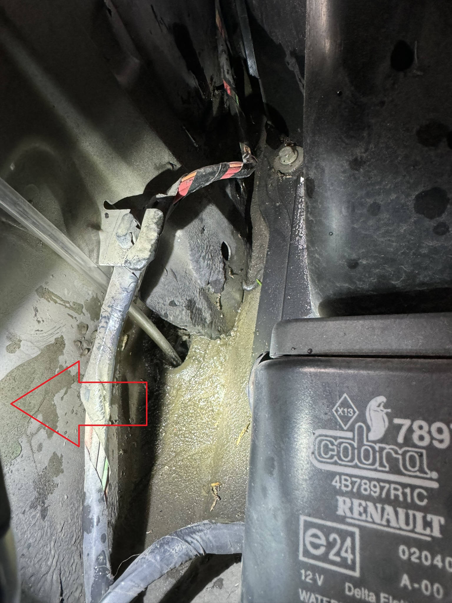

From the top down, you can see with the muck, that this was an area of water pooling. When I pushed the tubing through the hole, the water was released - quite smelly it was too. The red arrow indicates the direction of the front of the car.

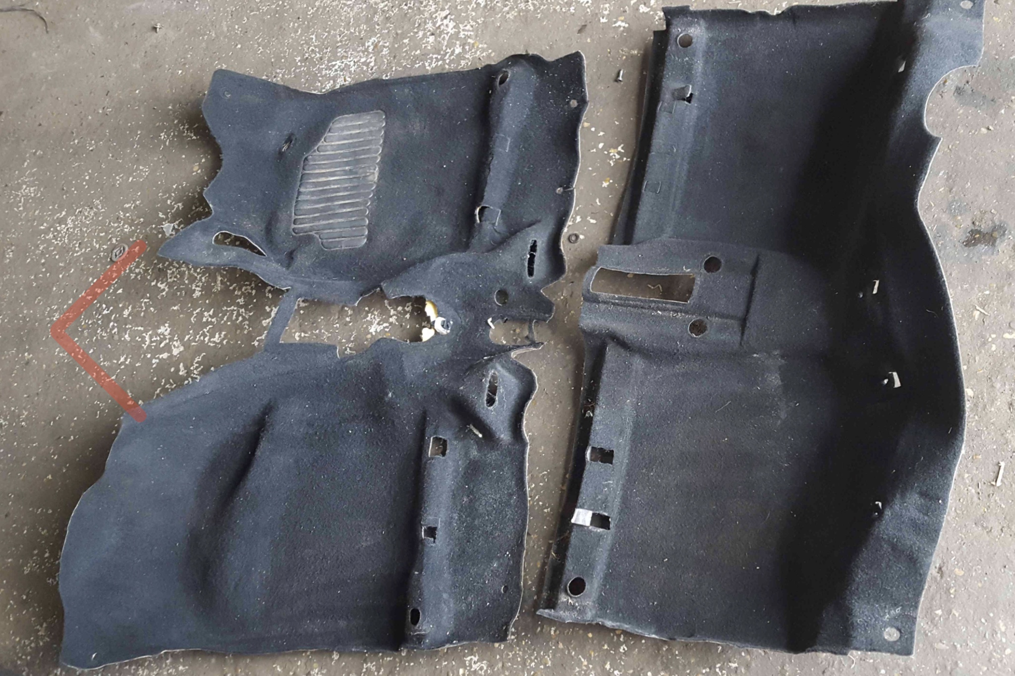

Here is a carpet and you can clearly see the strip of carpet joining the 2 floor pan sections , I think if that is cut it will result in a poorly fitting carpet . The oval cut outs in the back of the front section are where the heater ducting for the rear passengers comes through but at the front I think the ducts are over that carpet strip. The ducts also sit on the soundproofing which laps up the side of the transmission tunnel in area of centre console. I did think about cutting but really see no point cutting any carpet or soundproofing to get them out as it is so easy to do by pulling off the handbrake surround and centre console , popping 6 trim buttons , unscrewing throttle stop and 2 torx screws and even the seats are a 5 minute as side job if it’s on axle stands.
