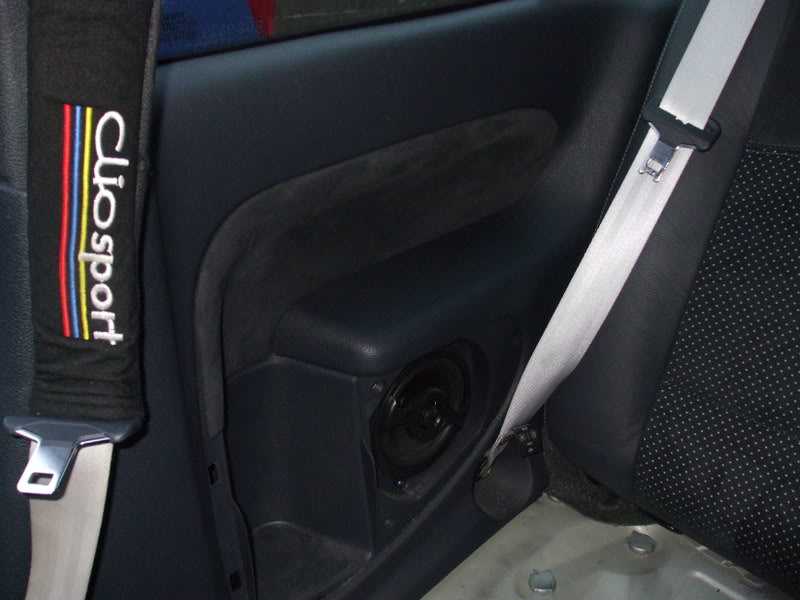

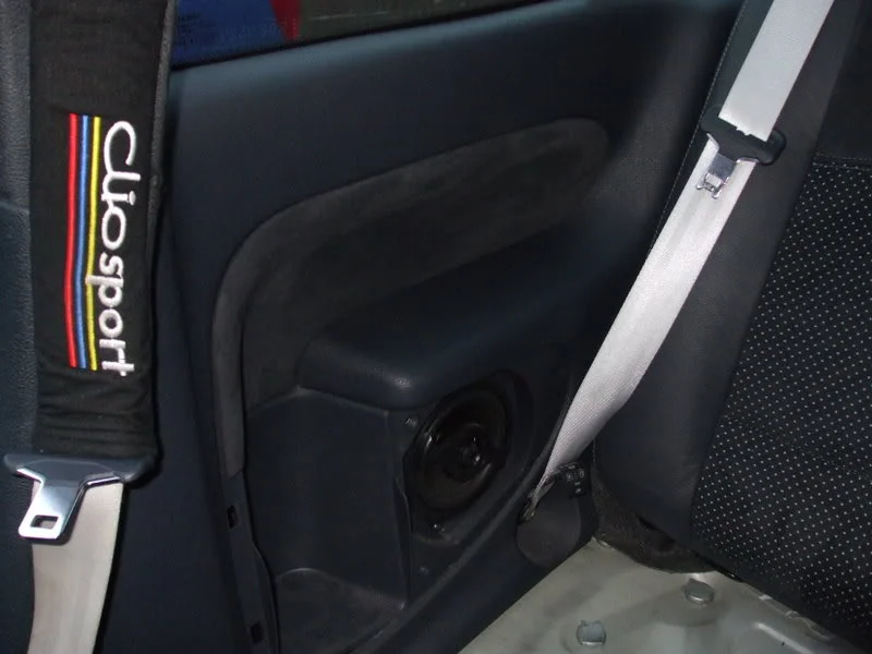

So I bought a pair of Vibe SA K 50 Co-axial speakers for the rear.

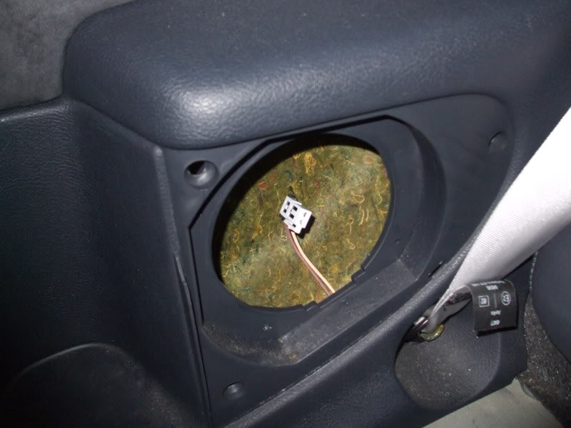

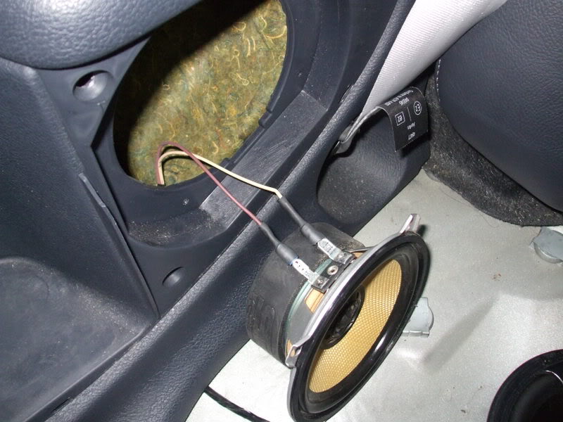

1. Cover removed
2. Factory fitted speaker removed.

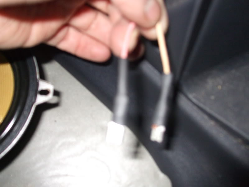

3. Wires and connectors stripped and new ones fitted.
4. Yes they were heat shrunk using Mercedes connectors. Sorry for the poor quality but you get the idea.

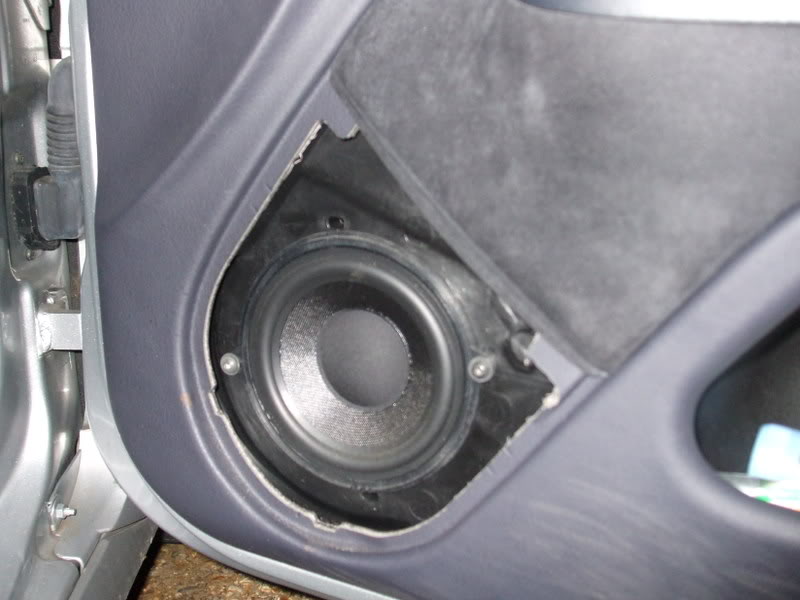

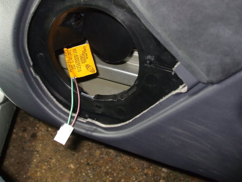

5. Front grille plate removed ready to remove the factory fit speaker
6. Front speaker removed and wiring ready to be stripped and new connectors put in.

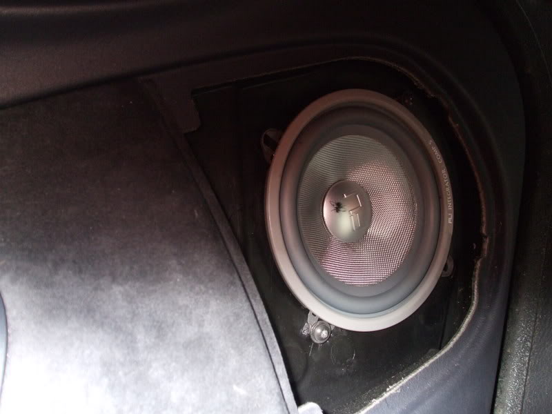

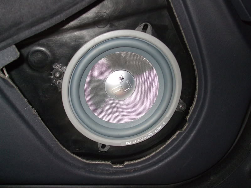

7. New speaker Fli Integrator Comp 5 wired up ready to go in. Only used woofers and left factory teeters in.
8. Another pic of the Components.

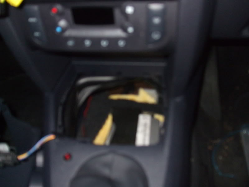

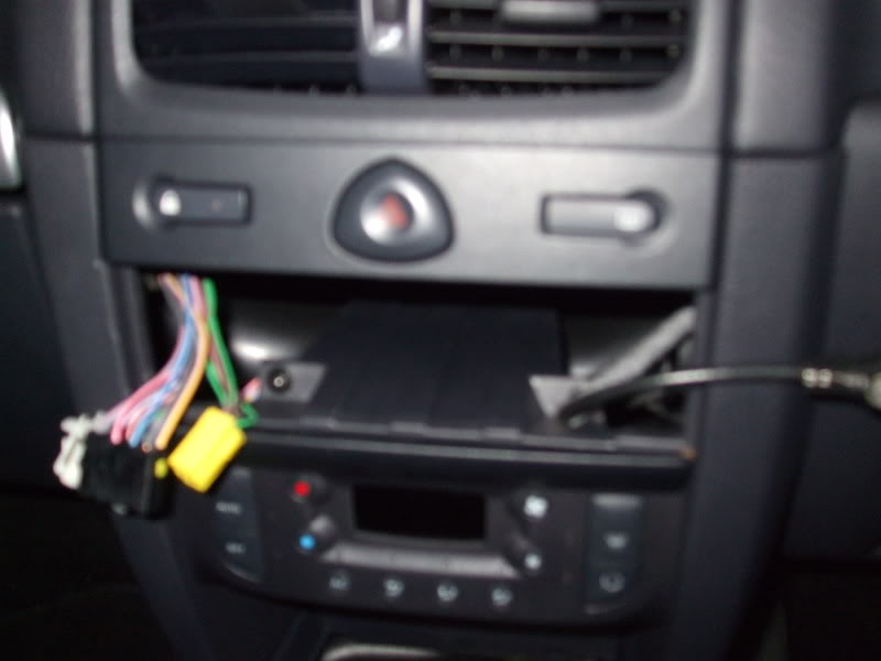

9. Original Head unit removed
10. Not much better pic and new extra wires installed

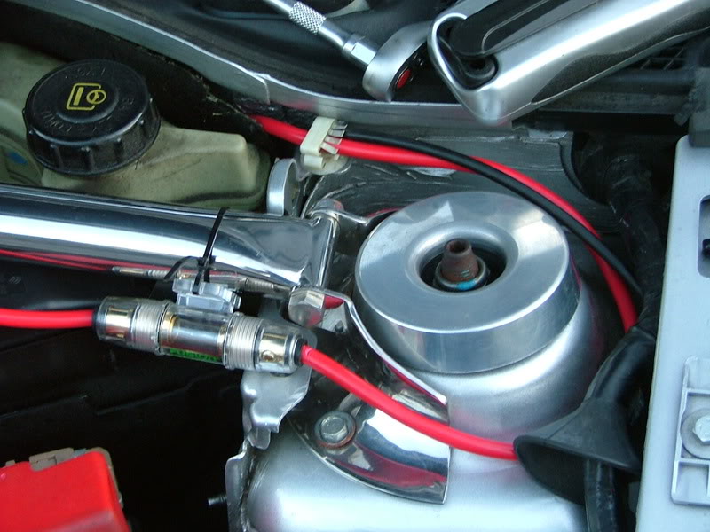

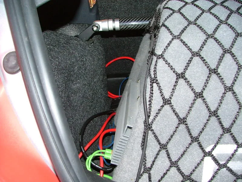

11. Finally broke through to the engine bay and got the amp wire through. Routed in nicely and used a Fusion 8 guage amp wiring kit with a nice big glass fuse.

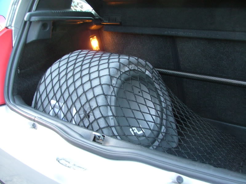

12. Installed the active sub and amp using a Vibe connector block for easy detachment when taking out the sub.

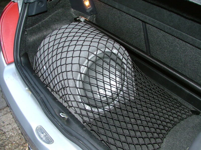

13. Sub all ready to go. I know it's a Fli Active Trap 12". but it is ideal for the budget and what I want out of a system. Thought that I would keep it contained a bit by holding it down with the boot net until I can come up with a quick release locking system.
14. Another pic of the sub

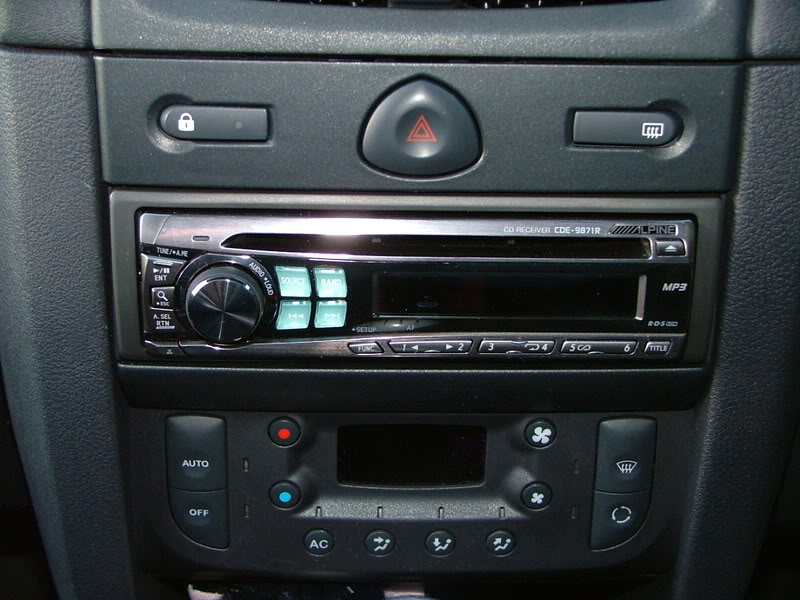

15. The head Unit to power all of the new speakers. An Alpine CDE - 9871R with i-pod connector.

Just one thing to note if those fli mids in the front were from a component kit your feeding them full range as theres no crossover in the standard system.

I'll ask my son how hard it was to remove the grilles but they do just clip in I believe.
re the grills they just pop off but be careful on the little plastic parts that hold them in place as they are easy to break.
I had that sub in my 182 and for the money you cant go wrong, its a bit heavy and takes up half the boot but other than that its class
Hip hop not hip op! Lol. Do the grills on the rear pop of like that on mine?

Stick 3 or 4 strips of this on the bottom of the sub and you should be secure enough
http://www.fabricuk.com/showspecial.php?id=68
