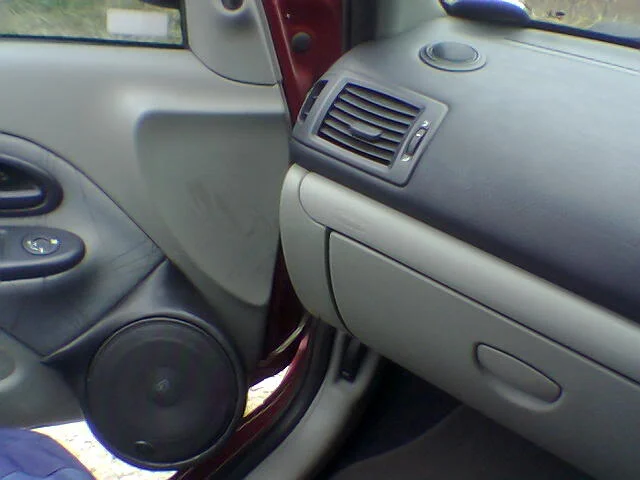

Fronts (Might be worth making some door pods so you can fit 6.5s in there like mine) = http://www.caraudiodirect.co.uk/product_info.php?products_id=3855

No they won't fit without specially built speaker pods or MDF spacer rings.
You don't actually NEED to buy 6.5" door speakers like XXXChromeClioXXX. He has done it so he gets more midbass from his front door speakers.
A decent set of 5.25" components will be fine as long as you amp them up and buy a sub to give you the low bass that the components won't be able to punch out.

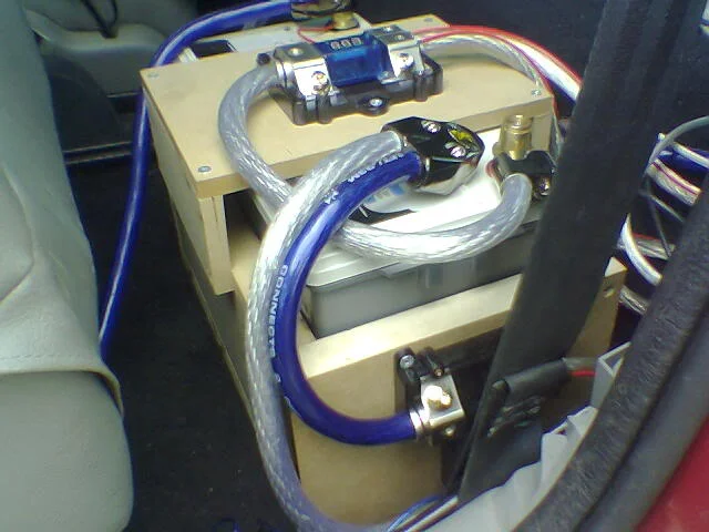

ive spent bloody 700 on 2 batterys. Its addictive what can i say :)
This is the battery behind the passenger seat

Must say your pods do look better than mine !

IMO i would run 0awg with a BD2. You will get voltage drop with 4awg and that might make the amp clip.
Run 0awg to be safe, after all what the point in having a powerfull amp is your goona starve it of power ;)
