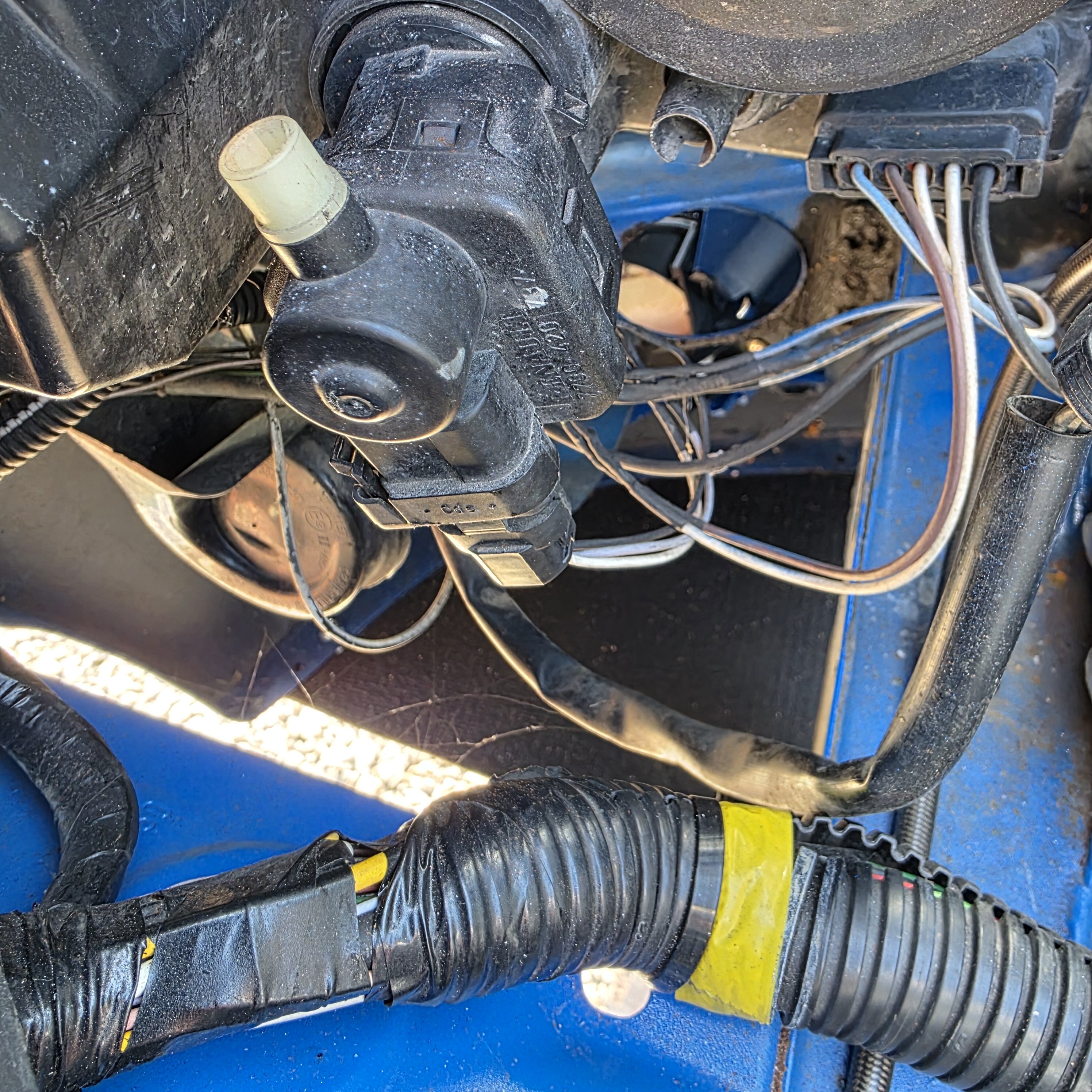

ID connectors
GasManLS7

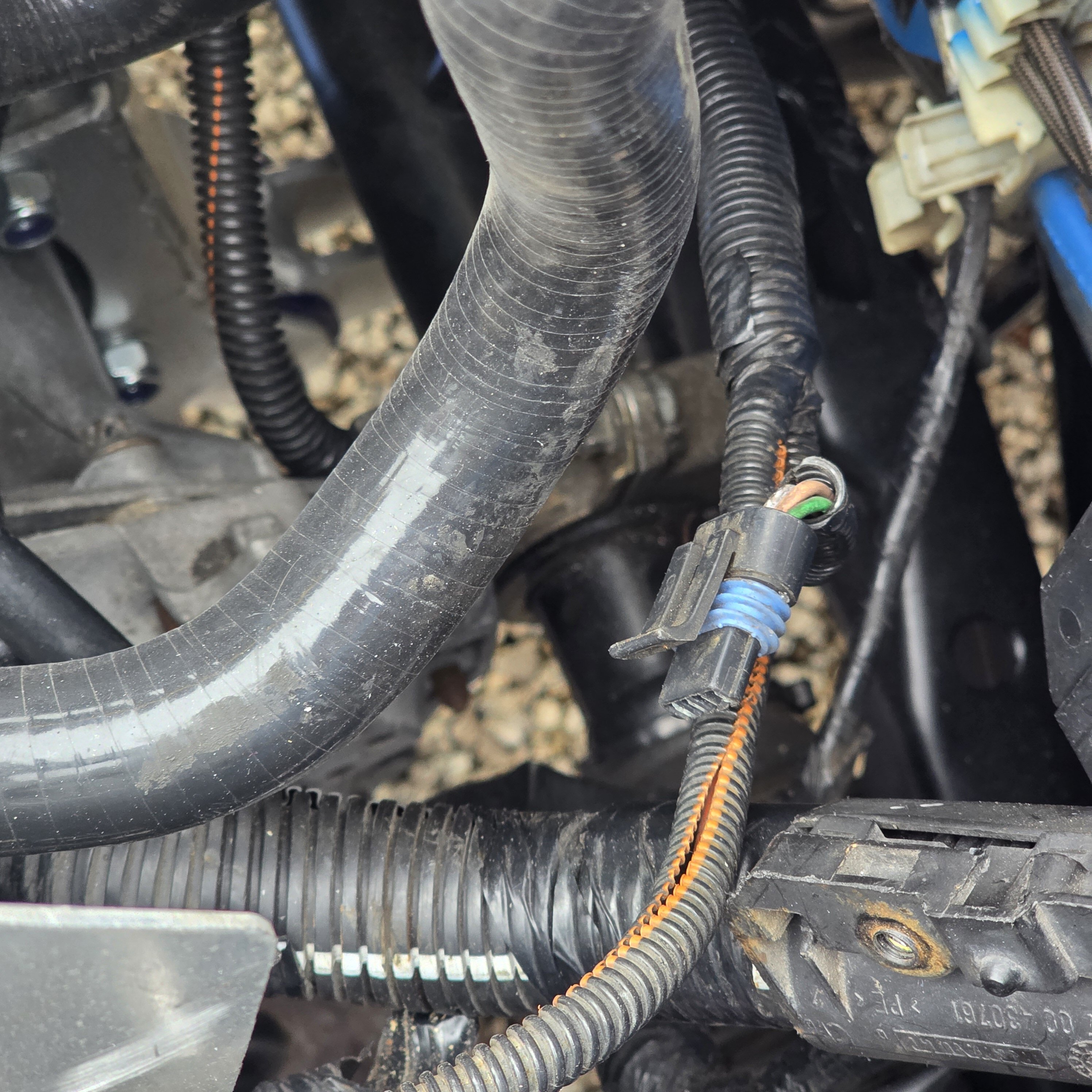

  Clio 182
Trying to figure out what these are?

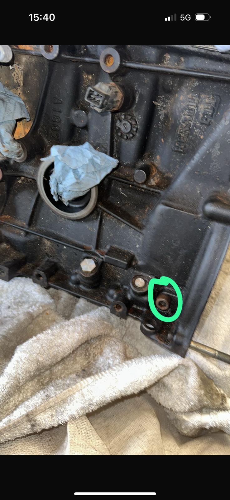

Also what goes in here?
The pic is from a mates car with dry sump conversion
JamesBryan
Not sure on the connector but the cap head bolt is what someone has replaced the oem female torx blanking plug with.
They get so crusty and usually round off, so see quite a few replaced like that.
It's where the crank pin goes when doing the belts.

Cheers mate, guessing i can just put any m12 bolt that fits in there? Does it need sealant?

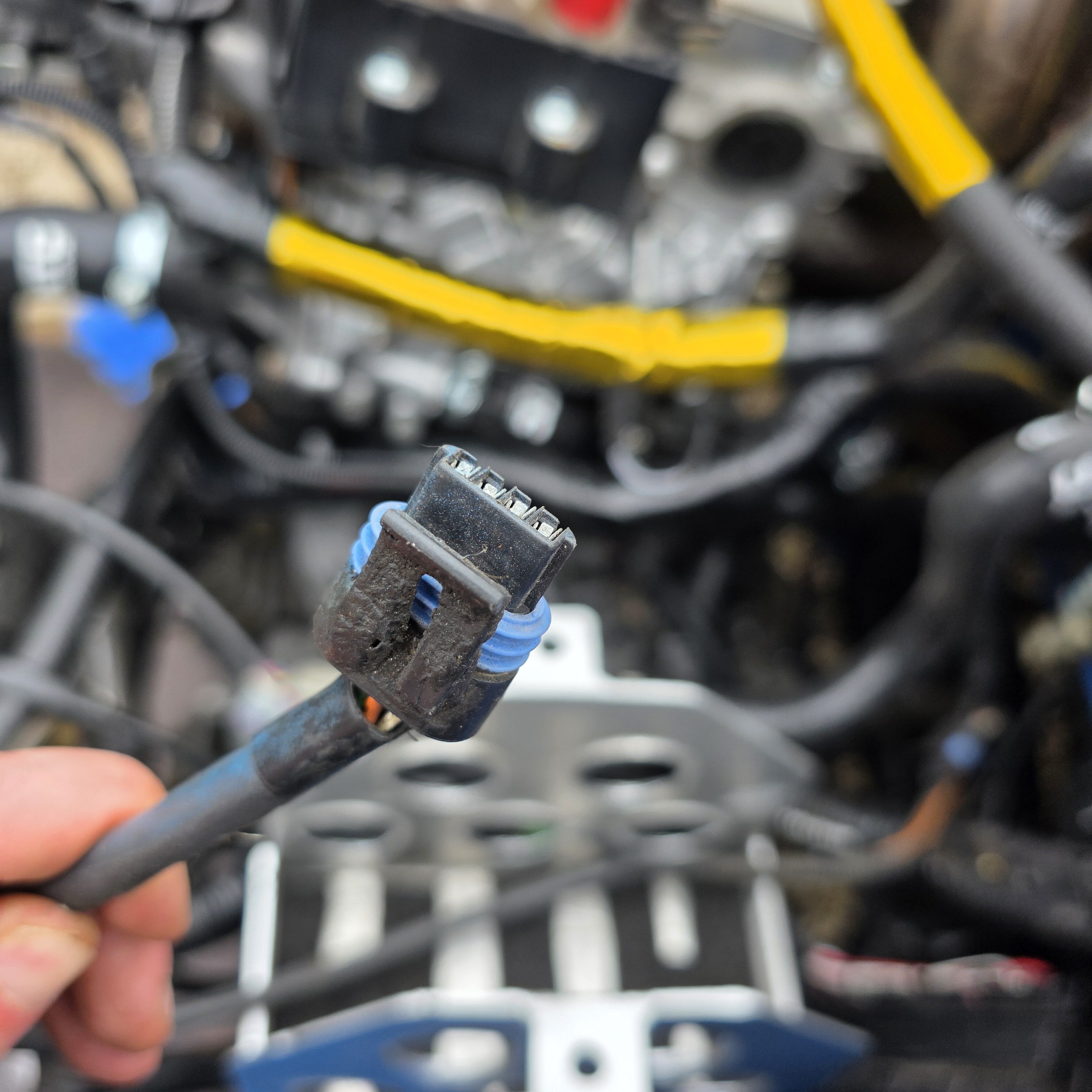

Connector is for the lambda wiring on the back of the subframe
The caphead bolt is where the crank locking pin goes
Where abouts in the engine bay are the other 3 connectors?
Other 3 are behind the passenger side headlight

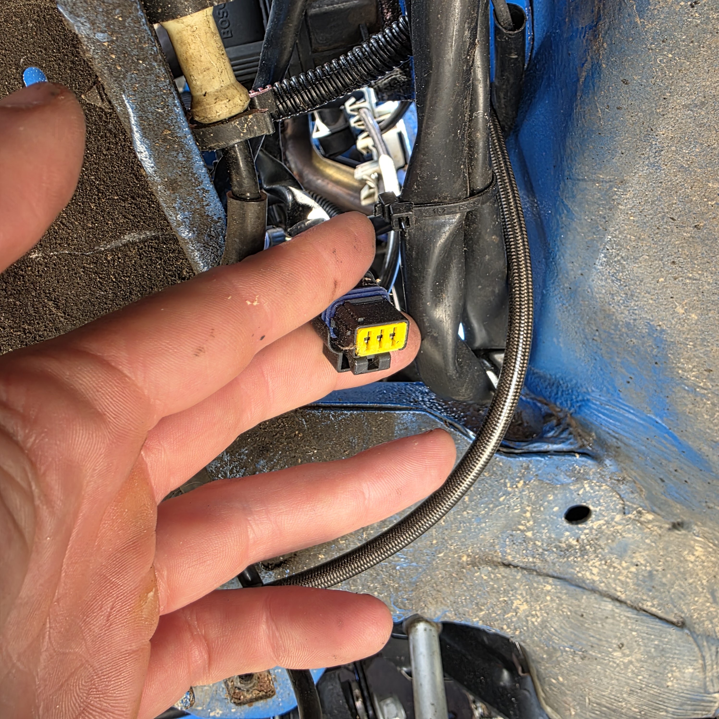

My headlights don't seem to use those connectors:
They only have two connectors and they're already connected. Is it redundant wiring from other models? The drivers side doesn't have the extra wires

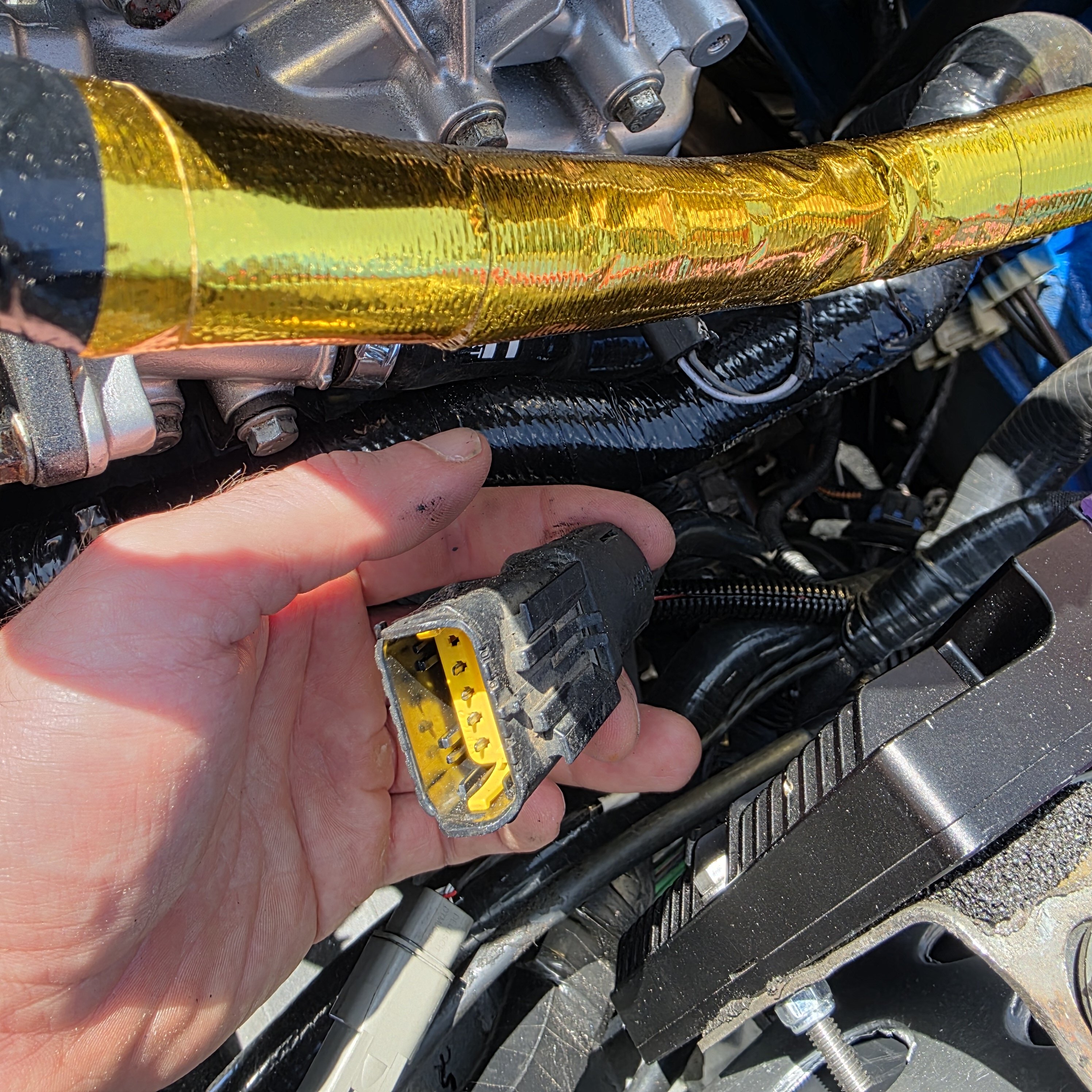

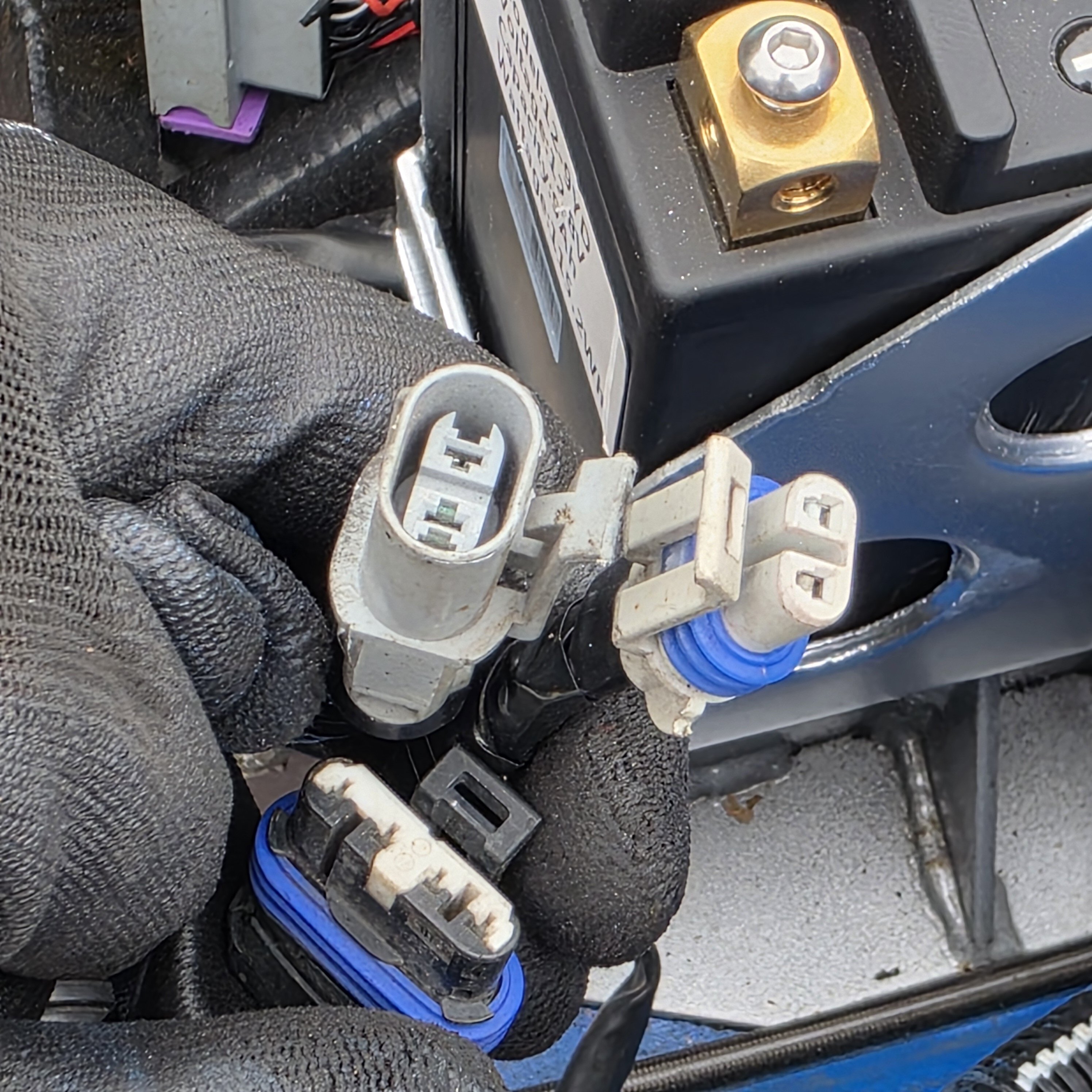

OK couple more, I believe the bigger one is for the rear abs sensors? Front one is from the abs ecu but I can't see where it connects?
YorkshireKyle
Not all gingers stink of piss. But I do.
Yeah they both look right
ABS module plugs into a sub loom on the side of the ABS module and the big plug goes down in the same place as the lambda wiring
