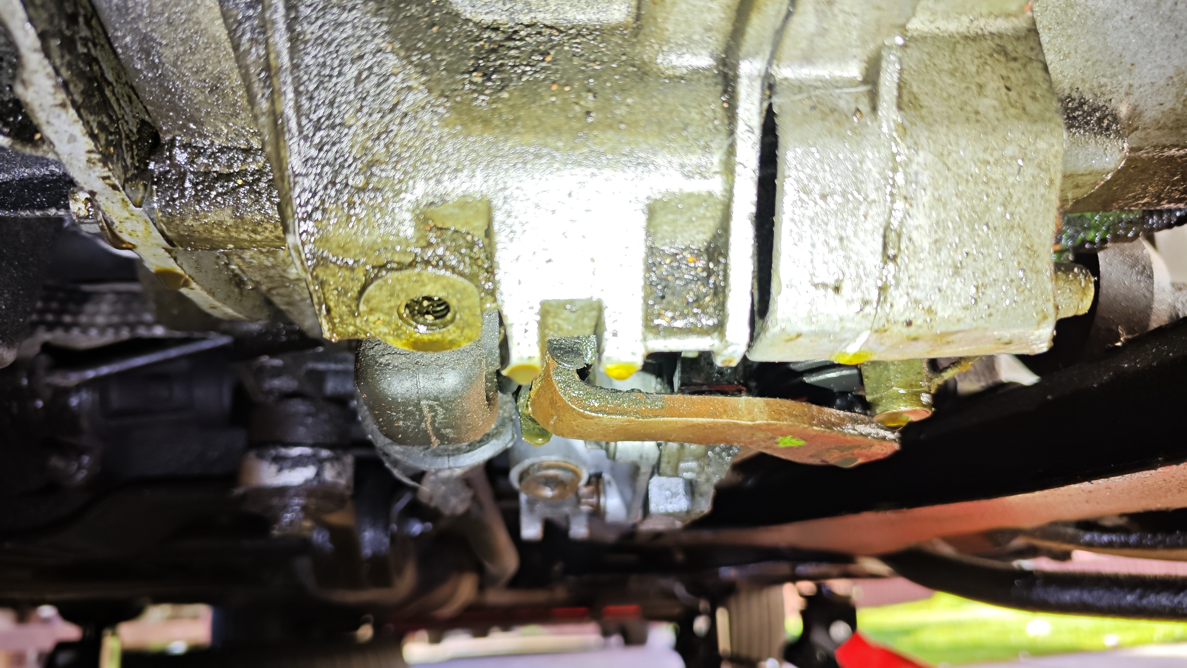

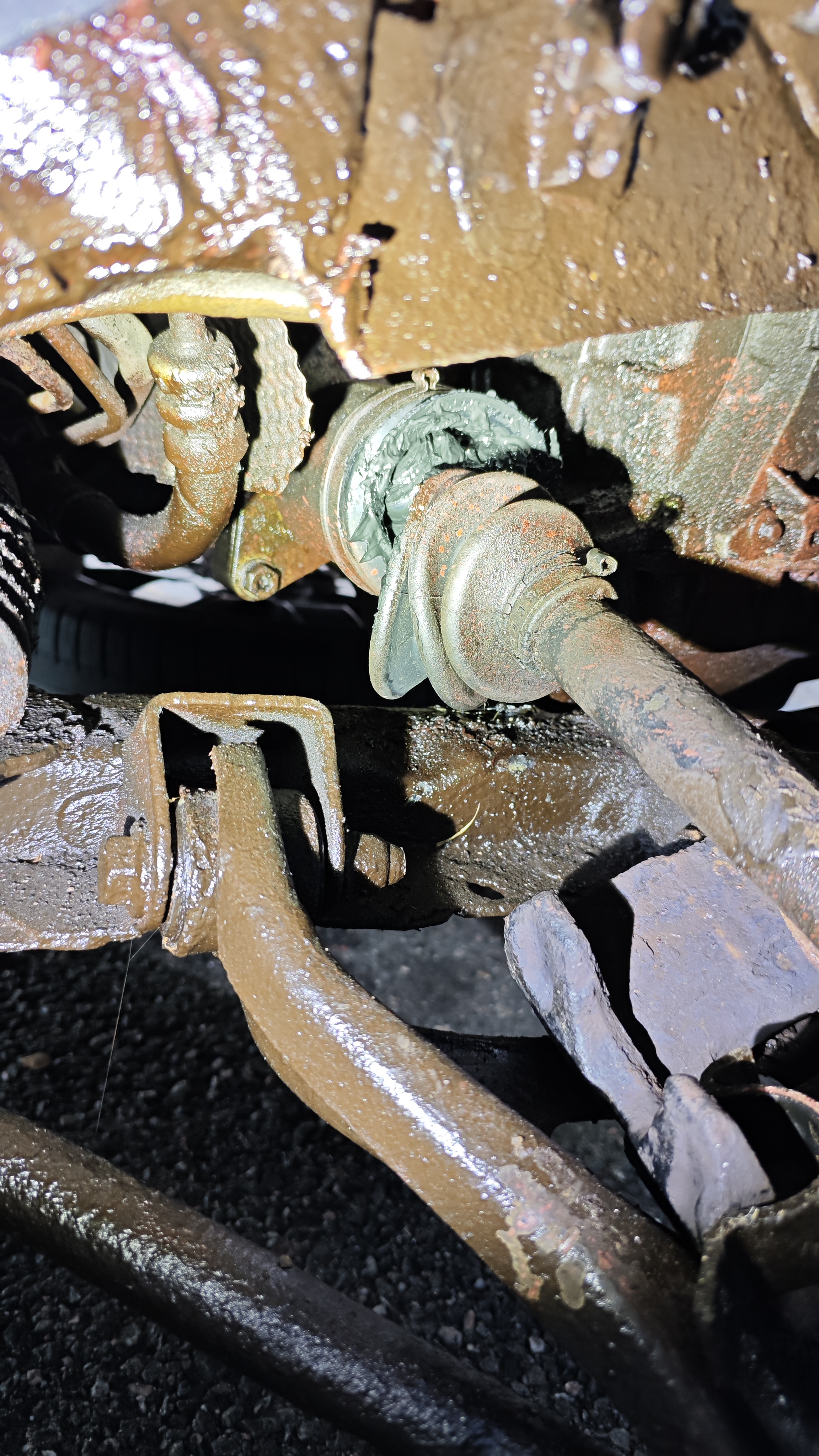

Was under the car today to replace the NSF ball joint. Stuff happened, including the right driveshaft dislocating and killing the boot (pic 1). Really not having an easy time getting it back in. How much of a pain is this gonna be? the ball joint isn't even lining up to go back in the hub but i suspect that'll be easier once the driveshaft and consequently hub are further in.

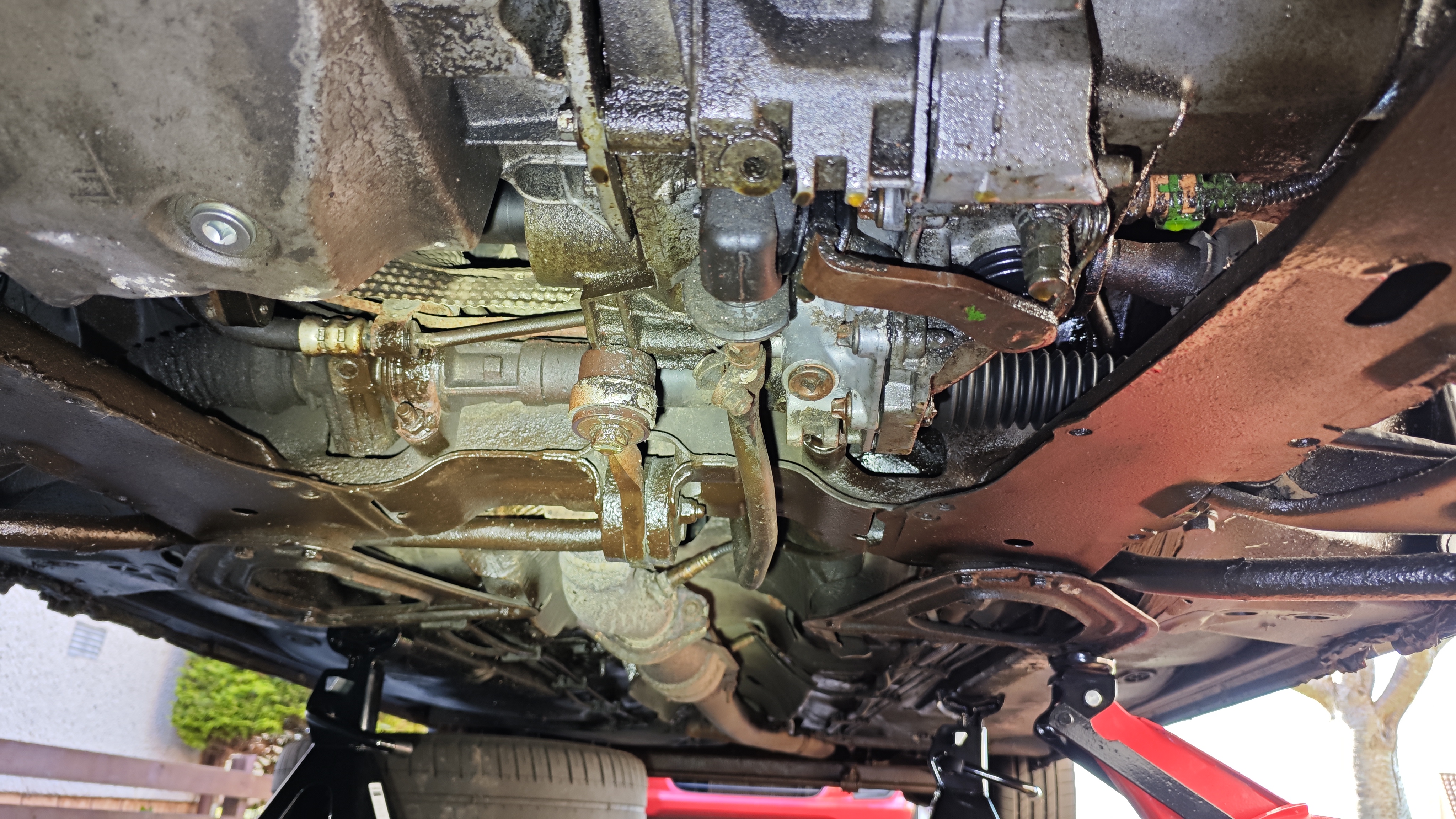

Also noticed a damp patch on the ground and saw, in pic 2 and 3, some liquid dripping (not actively dripping but the dew was there) from what I'm guessing is the gearbox or a related part. Green stuff on that electrical connector (top right of pic 2) doesn't look so fun either, google says that's likely coolant?
any kind of thoughts and input on what im looking at and what i'm gonna have to do to remedy everything are welcome.

Did research; the driveshaft "dislocating" like that isn't as bad as I feared when I first saw it but the boot replacement is very difficult to DIY since the splines holding the tripod CV joint on are welded or something like that. Basically the joint isn't supposed to be serviceable and common advice seems to be that it means a whole shaft replacement. Managed to put everything loosely back together took it to a garage and they got it on, no idea how. Still not sure what the liquid is, probably gearbox oil? I think that connector is actually green itself so not looking nearly so bad.
That's nasty under there, I'd be cleaning the entire area before trying to diagnose what the leaks are as currently it's impossible to tell what is coming from where!
