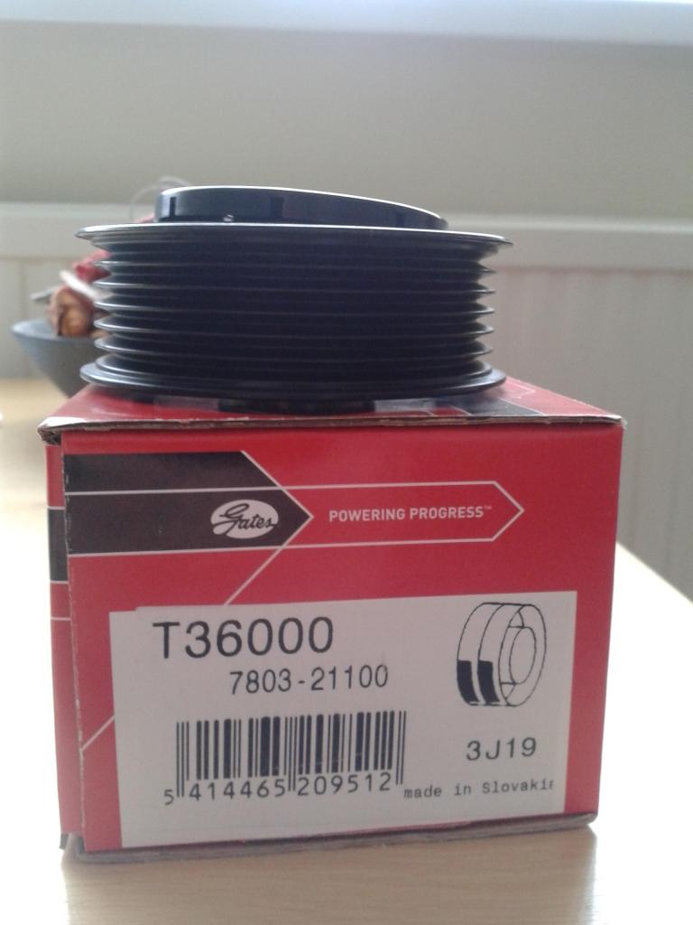

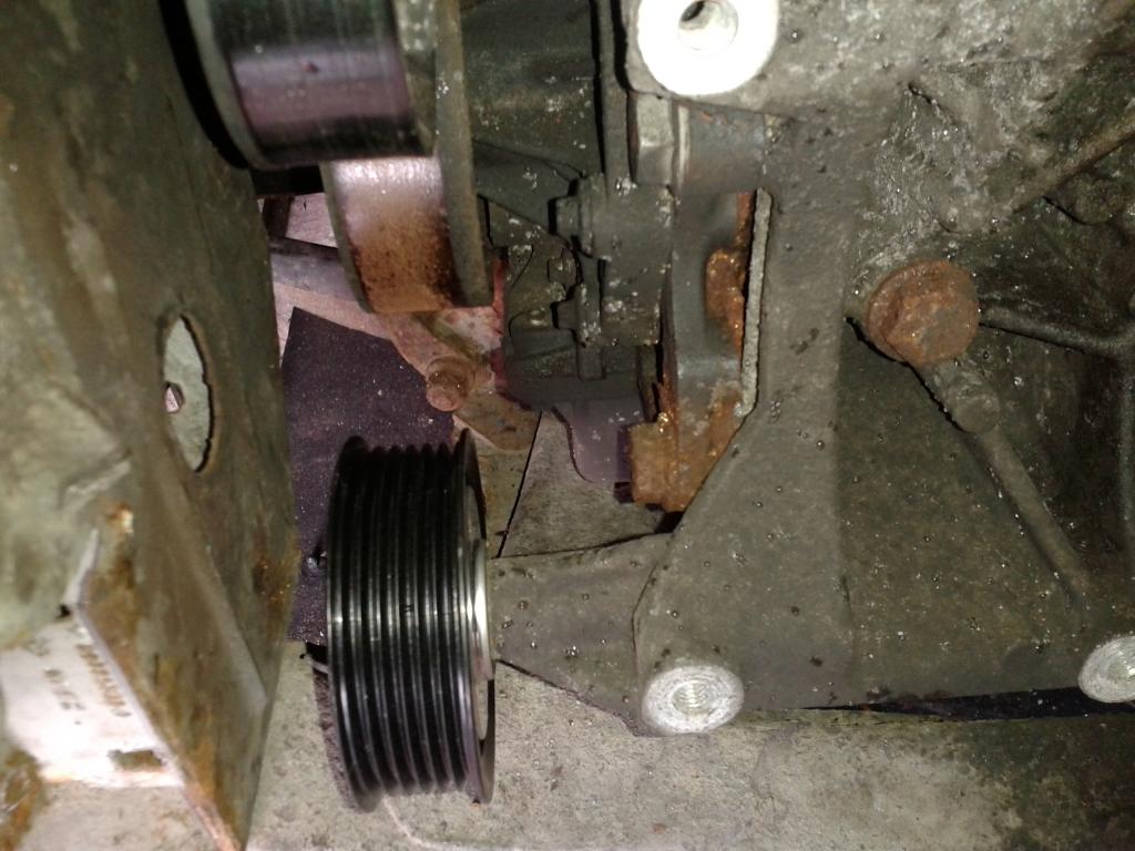

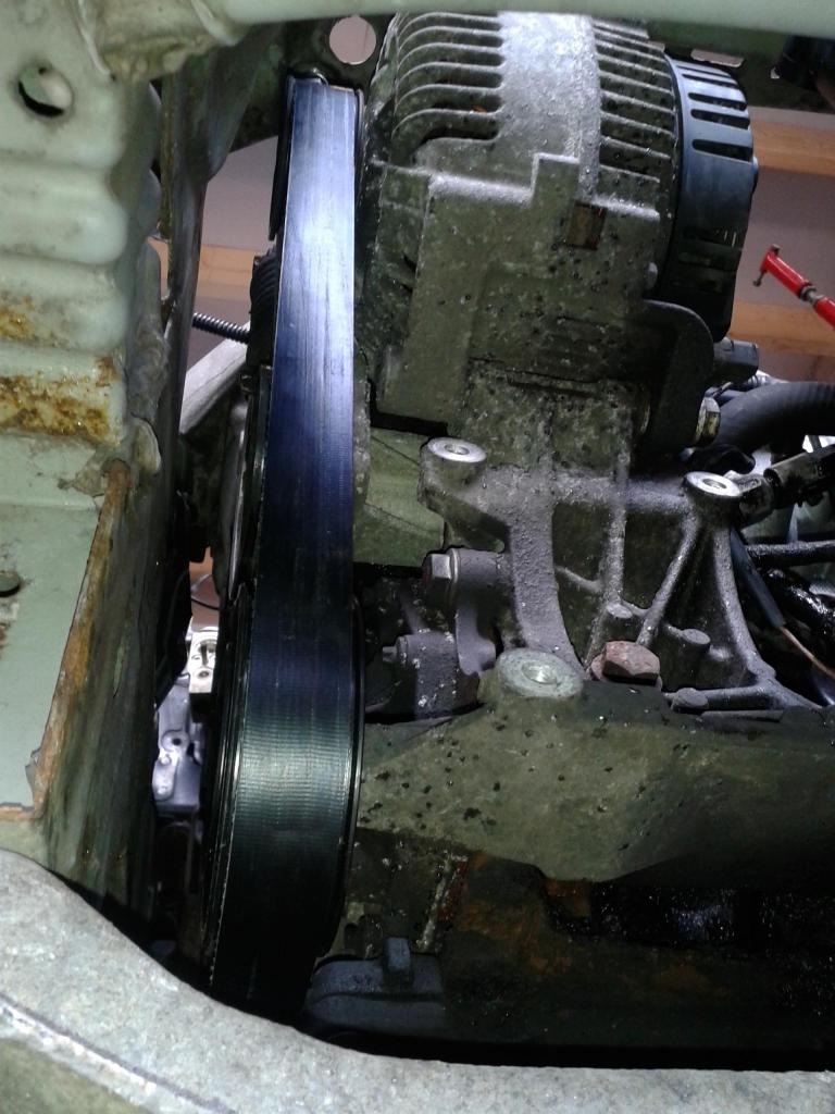

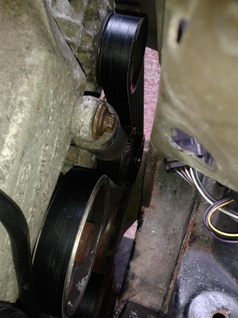

Recently removed my aircon using the original tensioner and just replaced the idler. It has been done before but people were getting confused as to what pulley they could use to replace the idler. I used this pulley and a standard sized belt and it works perfectly and all for £50 - £60. Some of the die hard fans would say it is the "cheapskate" way of doing it but it does the job at a fraction of the price of the kits
http://www.ebay.co.uk/itm/400459470758?ssPageName=STRK:MEWAX:IT&_trksid=p3984.m1423.l2648
A simple bolt on jobbie.

Yes just people were unsure where to get an idler that would fit. As far as i am aware this is the only pulley i could find with the m8 fitting. The tensioner is at 75% extension so maybe a shorter could of been used yes
