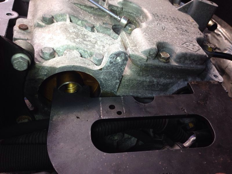

Cam timing has been checked and the timing was out by a week!! I wonder if you can guess who did the belts lol?? The timing was corrected, but it made literally no difference at all (which was strange?!). This was done by a specialist by the way with the correct tools.

When we checked the timing ........ :mad:
timing out by tommo1991, on Flickr
  182/RS2/ Turbo/Mk1
Crikey, if they were aiming for standard marks they certainly missed!
