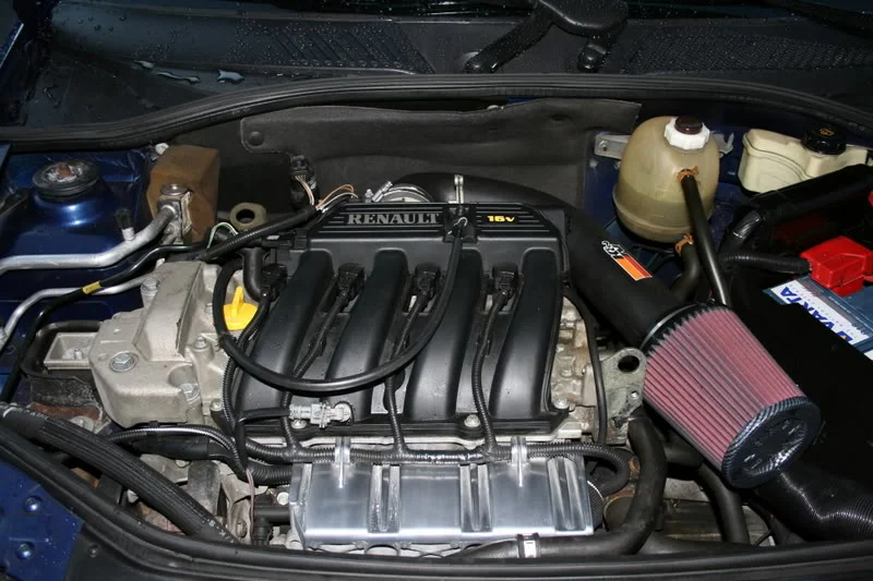

here's a very old pic of what it looks like with the K&N on.
dont really want to get rid of the k&n as it has helped with flow of air through the engine but want to try and get over the heat soak issue.

its not going to be the pipe as much as the filter sucking it in from the rad and block if your not getting a enclosed filter you would have to make some kind of heat shield.
thats what i was thinking, i'm gonna try and get an enclosed filter from fleabay or somewhere.

You could try and turn that into an enclosed IK. But then again in the long run it would probably look better and be cheaper to buy an inclosed IK lol.

Just get a cheap BMC CDA off ebay, buy the adapter to reduce to the size of your TB and wang that in!
