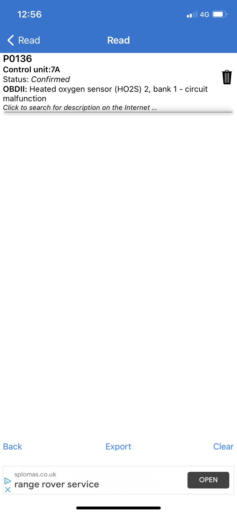

JToroPaz
  Renault Clio 182
There we go, lambda sensor. I’ll replace it, clear the code and run the engine again and see if it comes back
