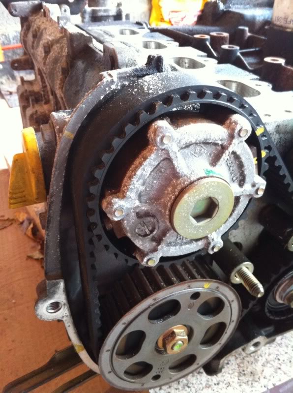

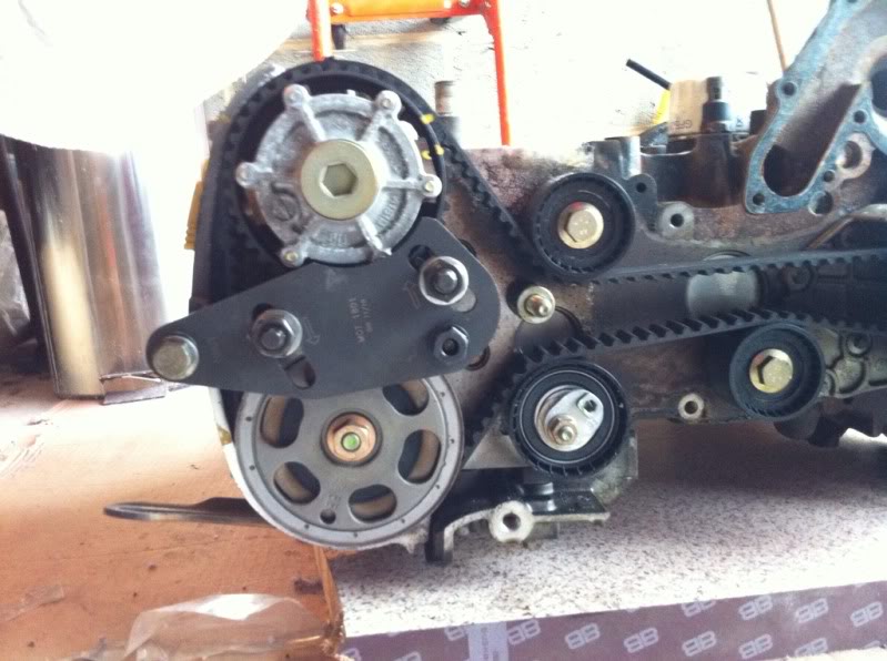

That's not been timed up properly has it?
  HBT 172 Cup
Tippex marks would indicate a hap hazard method of putting the cambelt on yes. But you cannot tell for sure just from those photos.
  172, Tiguan
The marks on the tensioner don't line up either.
Though the F4R pdf does say to mark everything up on page 7-13 so who knows.
  330i. E30 Touring.
Only way to tell for sure is horseshoe cam locking tool.
My bet is that it's out though.

As per the replies above, its the other end you need to look at once the crank is pinned in place.

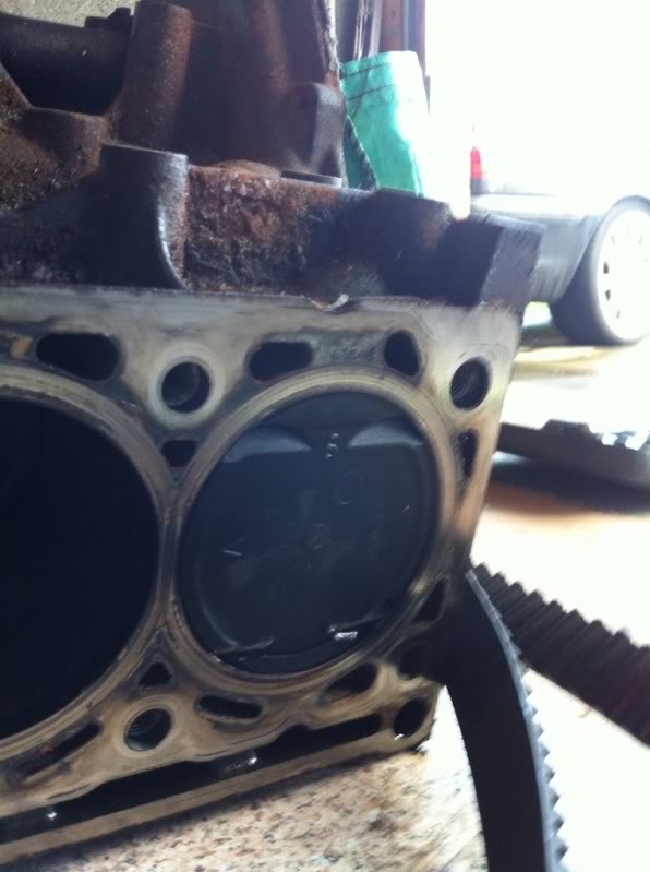

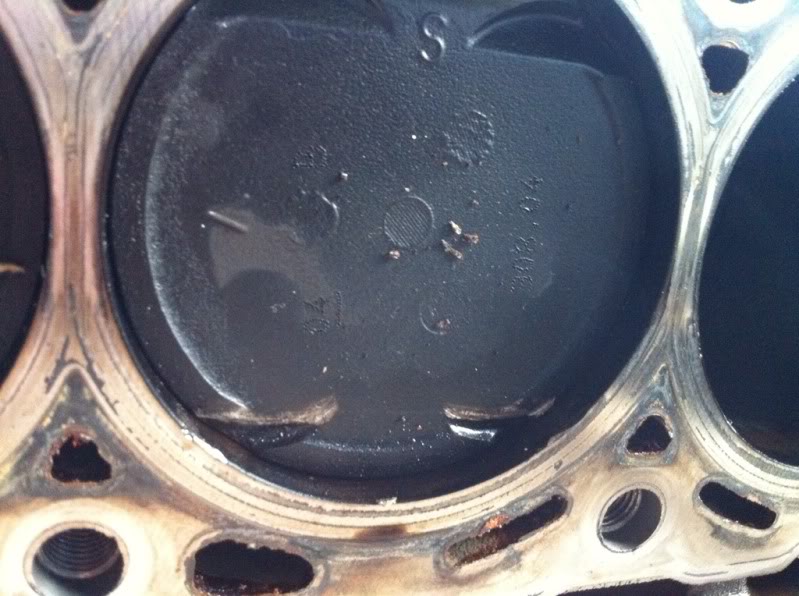

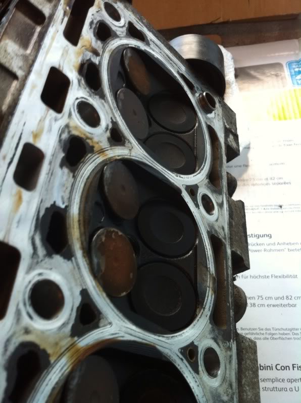

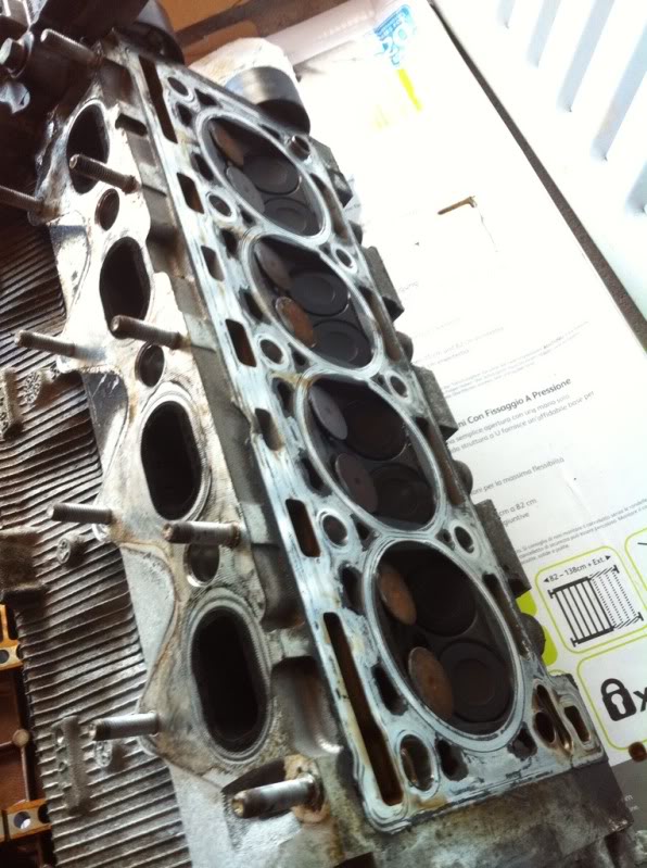

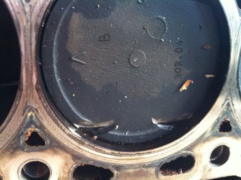

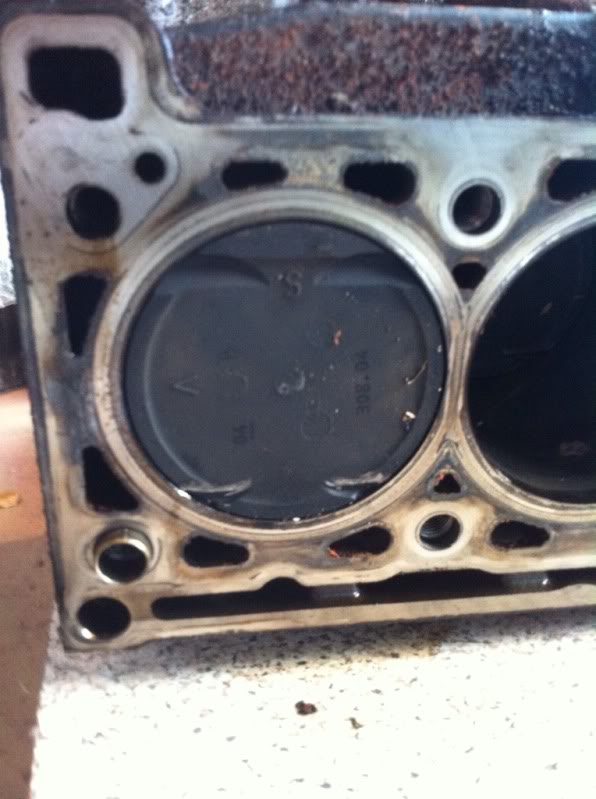

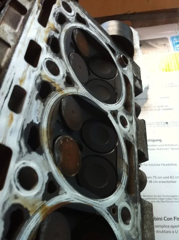

Well head came off and there are 8 bent exhaust valves which i wasn't expecting, especially when it was sold as 'running perfectly'. Nevermind.

Avoid cheap replacement valves, if you dont mind spending the money get them from renault, if not just buy secondhand ones.
Somewhere like MWM or BTM will no doubt have them lieing around from when they fit uprated ones to customer cars.

I bought it off of a guy on ebay. The block was badly damaged where the gearbox exploded, so it was nice and cheap anyway. I suspected something else might be damaged so i guess 8 bent valves isn't the end of the world. The bottom end was going to be chucked anyway, but i'd hoped to save a few parts from it. All that appears fine is the crank. The pistons have had a chat with the bent valves.

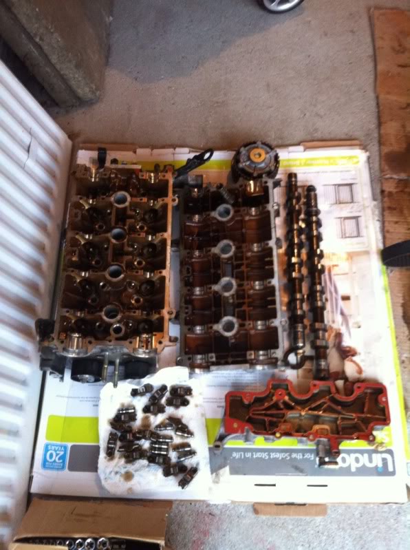

Fred, everything was out mate. The horseshoe wouldn't touch it (exhaust cam was 20 degrees out). I'll get some pics of the internals in a mo, but whatever happened to it wasn't good. Somethings slipped or shocked it. Its a shame really as the internals are like new, I can't find a mark on anything. The cams aren't even scored.

It was an ebay auction that was ended early... Not really much I can do mate tbh. With a new set of valves in it the head will be fine. I'm going to strip the block and give all the damaged bits to the rag and bone man!
