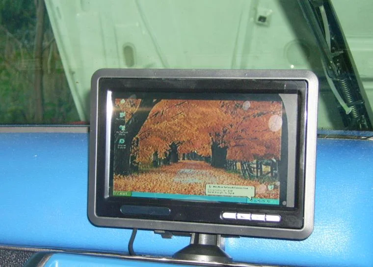

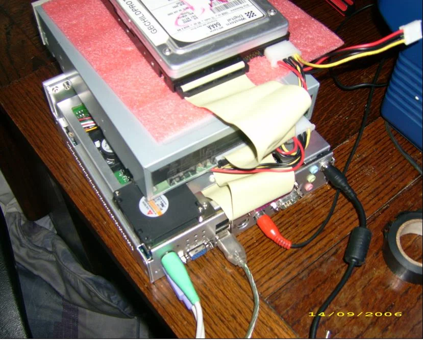

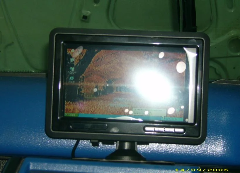

i am running
VIA EPIA M10000 Mini ITX
With a ATX Power supply. linked to my screen by Svideo witch comes standard on the back of the M10000 ITC mother board. the board its self is in the glove box with 3 fans :) and so far its all worked perfect :)
with 2.5" hard drive
  Fiat Panda 100hp
I read about this, some guy has created his own os to go in his car, looks prtty cool, and u control all the mp3s etc using the touchscreen.
Cost me about £120 to set up this
one picture is me installing windows with a STANDARD sized cd rom ;) look how small the computer is its smaller then the cd rom
