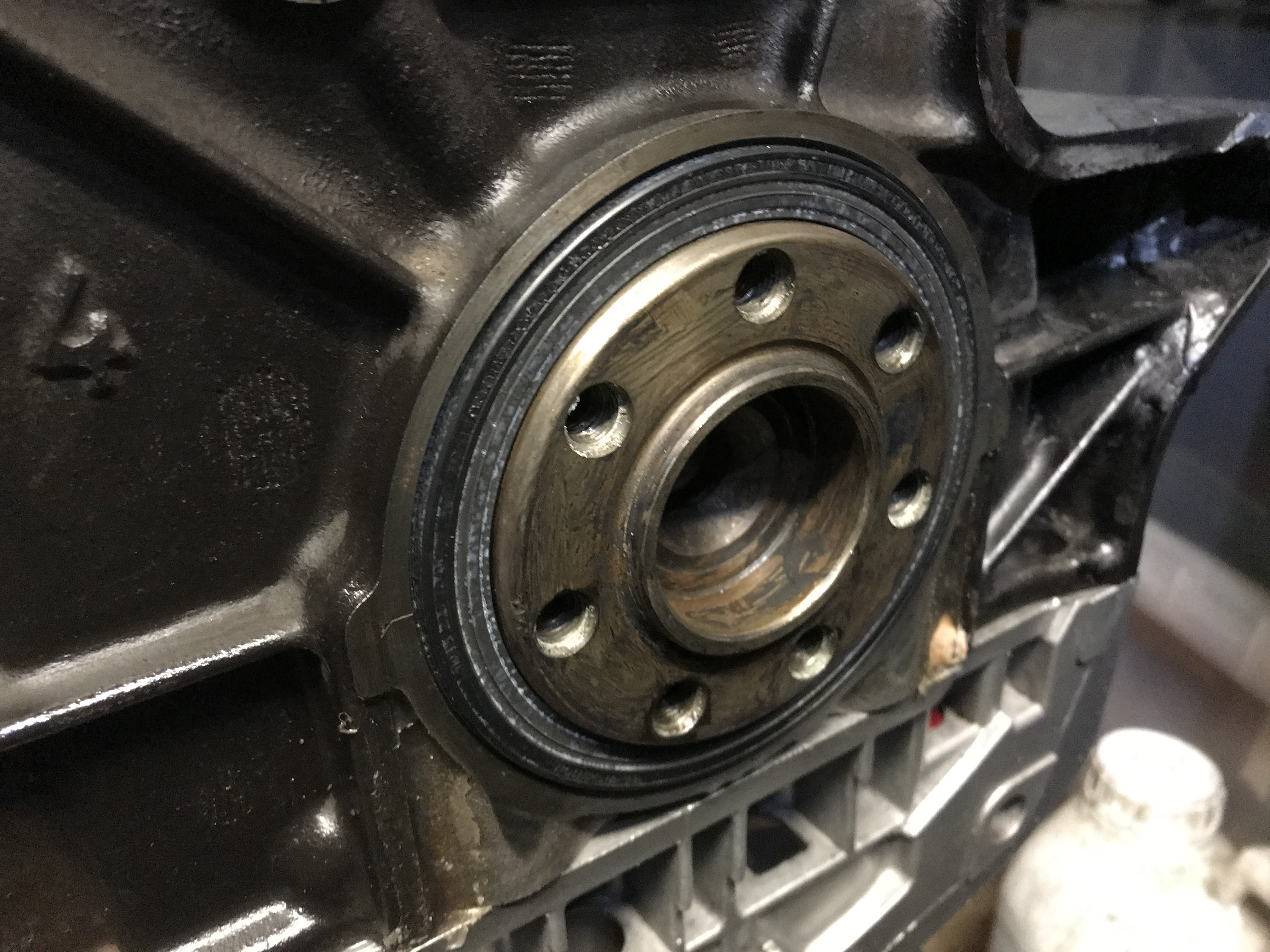

Im going to take gearbox out due repair of leaking selector shaft and while will out, I want also change crankshaft oil seal on flywheel end, is leaking too. How do you guys install this crankshaft oil seal? I know that seal is installed not flushed with cylinder block flange. In service manual there is used special installation tool which I think make a corect offset of seal towards flange... What is proven method of this without special tool, or what is corect measurement of sticking out...? I cant masure this directly on engine because seal was change at engine rebuild by previous owner and is leaking since then, so I think is installed incorectly. Thank you all for advice.

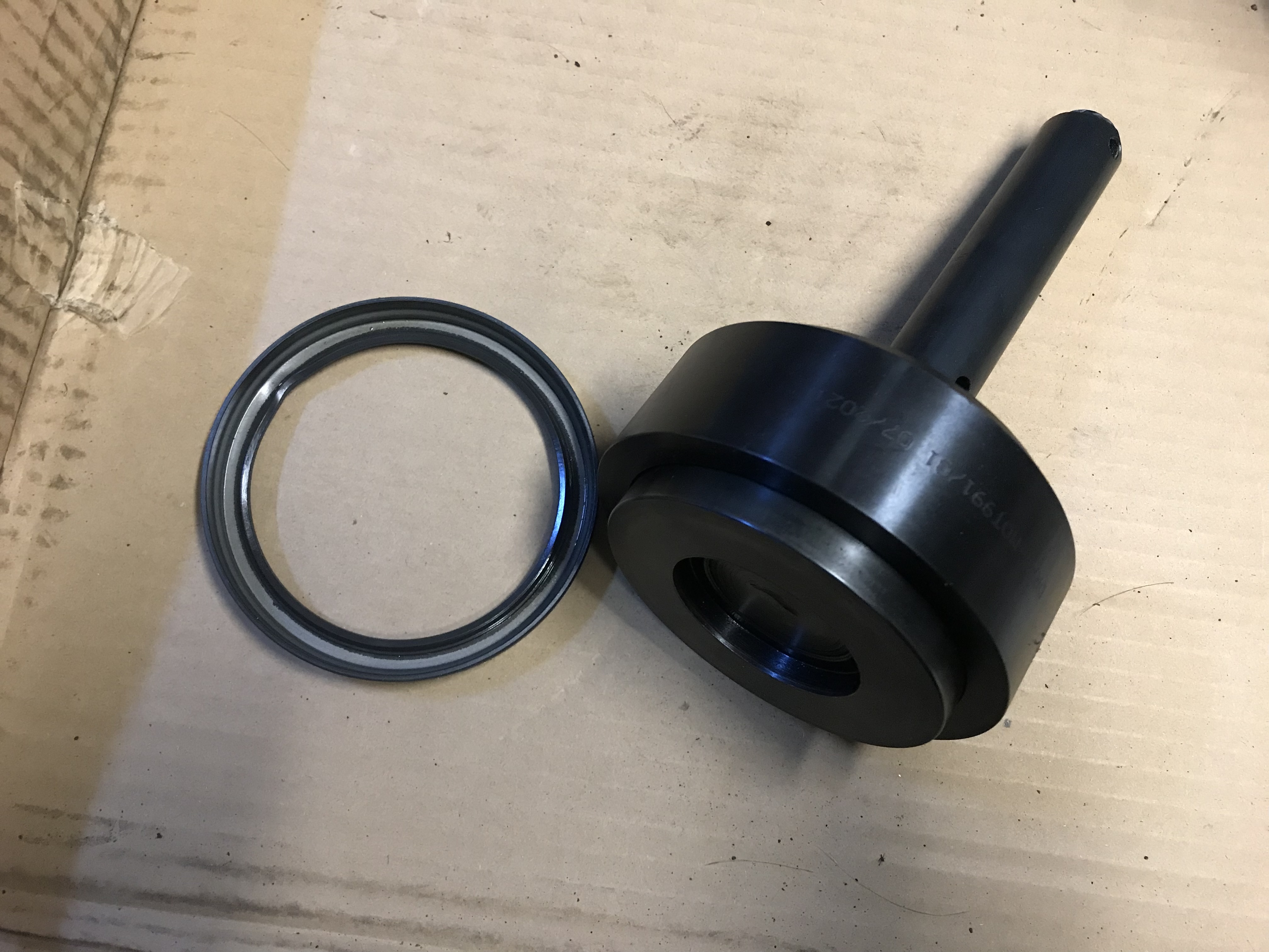

This is the tool. I got mine from my local Renault dealer, so you might get lucky. It cost me £80 and has proven to be worth the money so far.
I‘d read a few posts of people struggling to get the seal in without it leaking, so I didn’t think it was worth the risk. Not sure how far the seal goes in, as this tool is designed to push it in correctly. From what I’ve read you can push them in too far.
If you manage to find one, make sure the engine has no movement and is sitting level on solid ground. I managed to mess up my first attempt because the engine was hanging from a crane and it wasn’t stable. At £50 a seal, it’s an expensive job if you screw it up.
