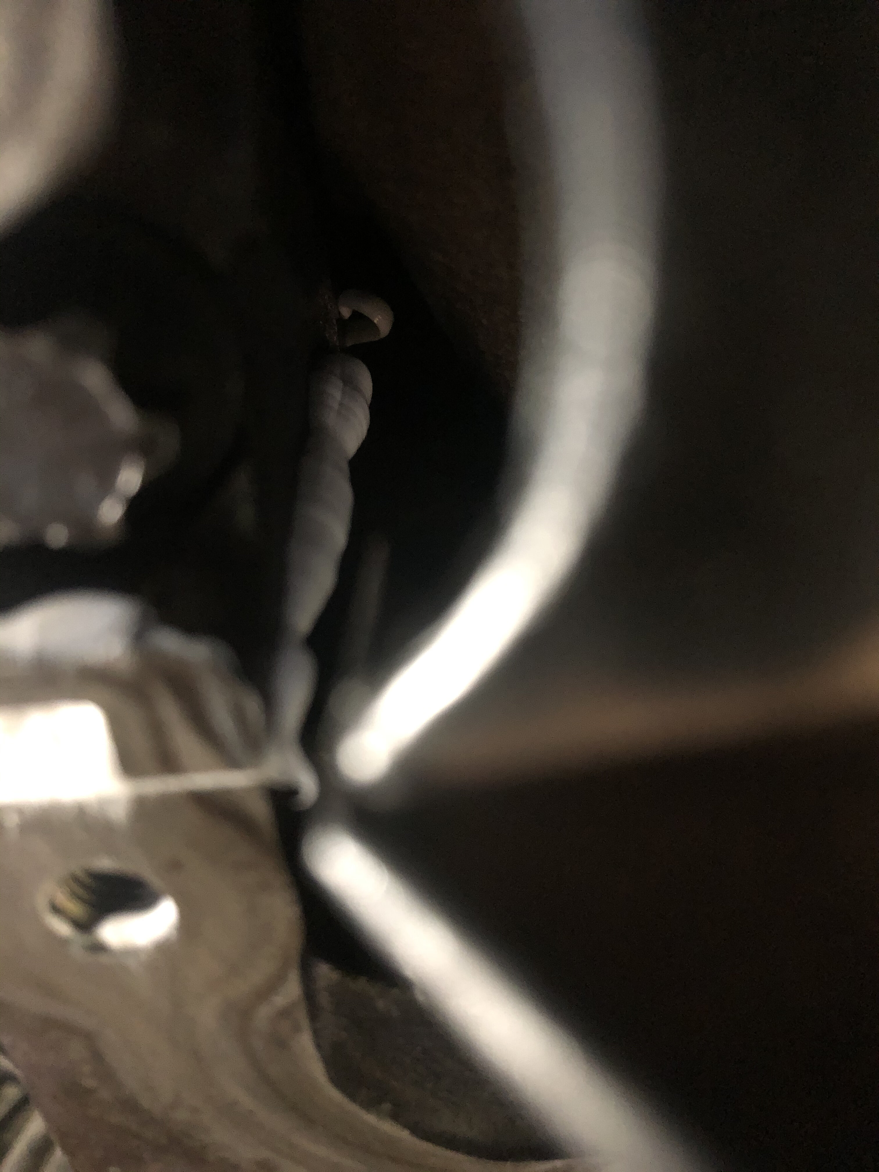

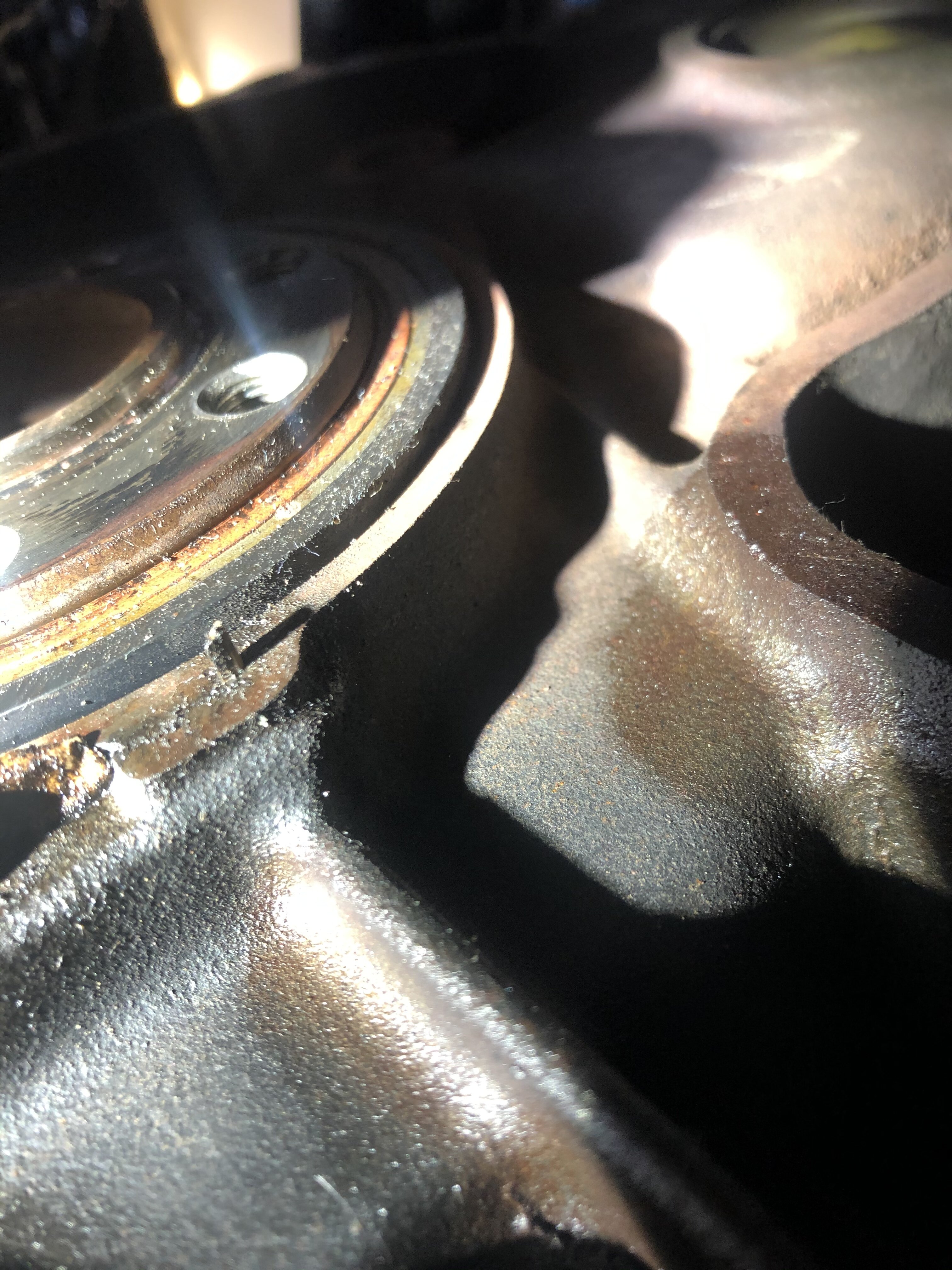

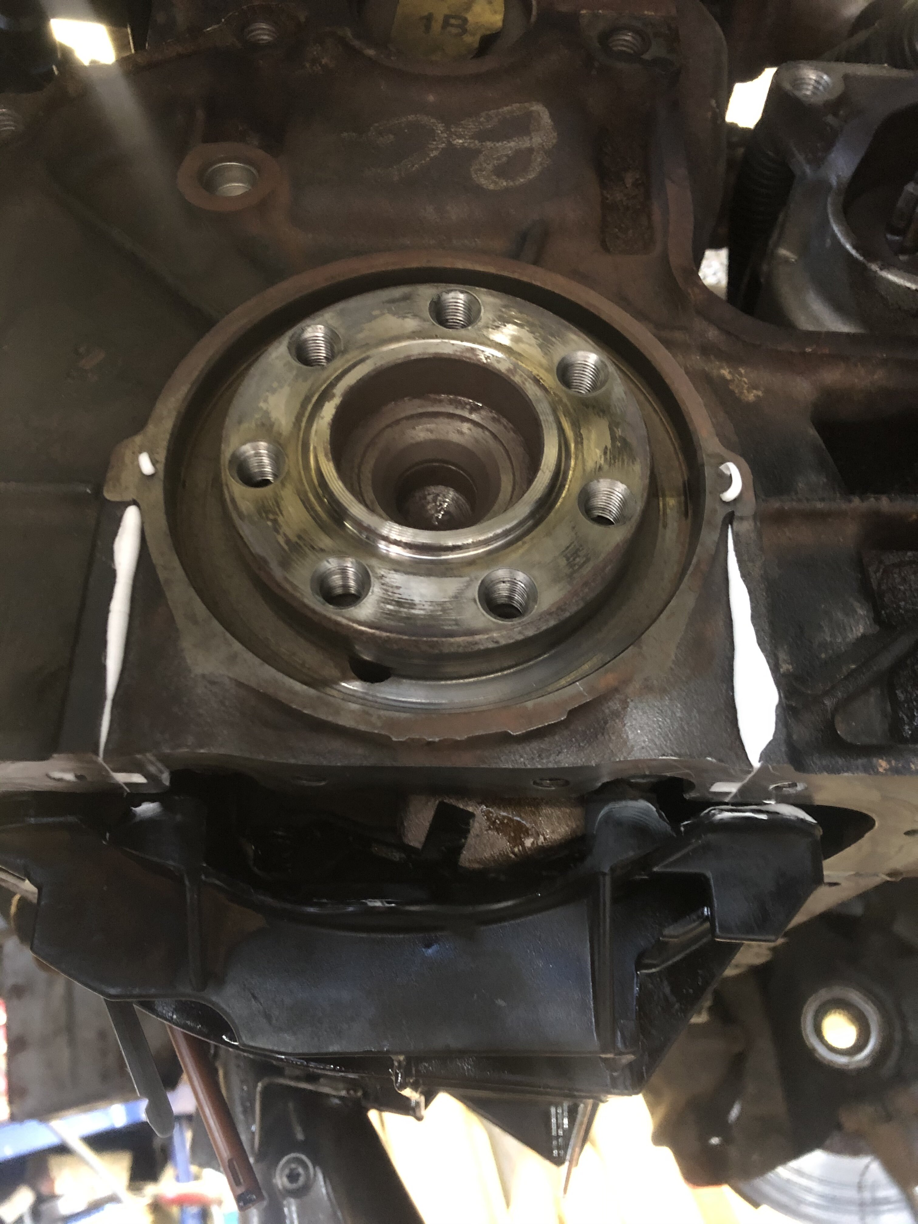

Has anyone got the procedure for installing and sealing the flywheel end crank main bearing and crank seal?
I have a 172 with a leak from behind the flywheel. Upon disassembly to replace the crank seal, I discovered the sealant in the main bearing was sliding out, so I intend to do the crank seal, main bearing sealant and sump gasket whilst I'm in there.
I've found plenty of pics and info on the cranks seal (dont push it in too far) and also on the sump gasket, but nothing on the cap, except mentions of pumping sealant into it.
Does anyone have the Renault procedure for installing it?
Thanks

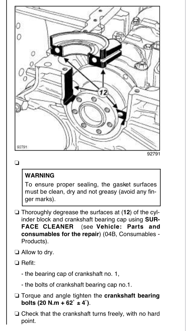

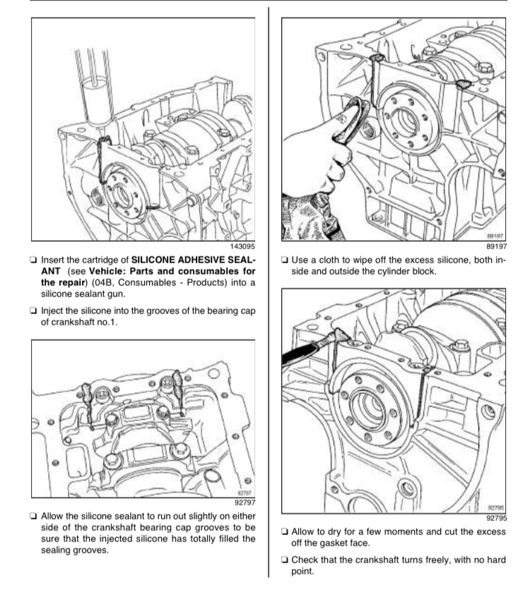

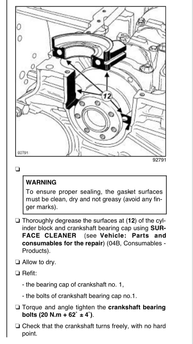

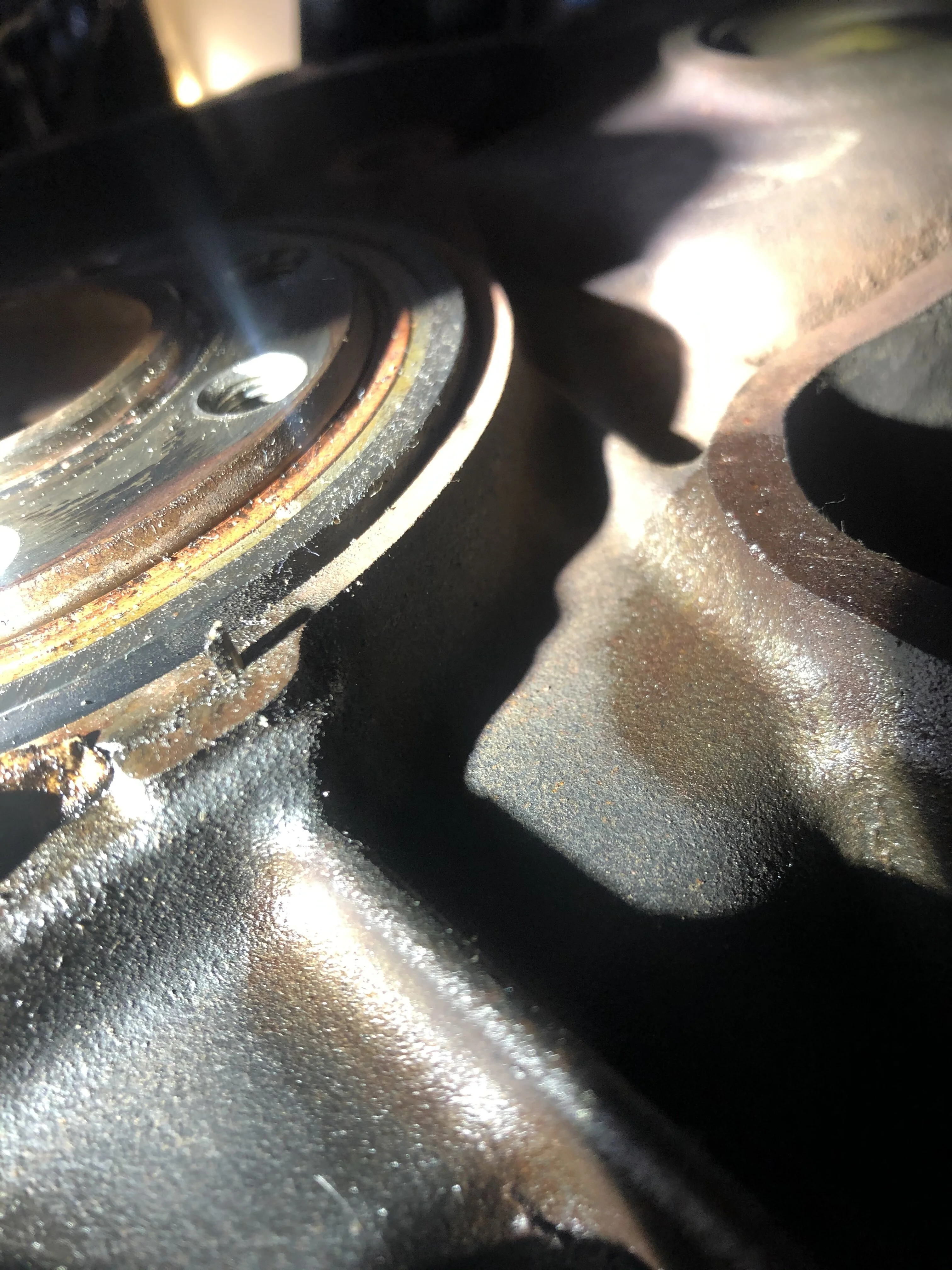

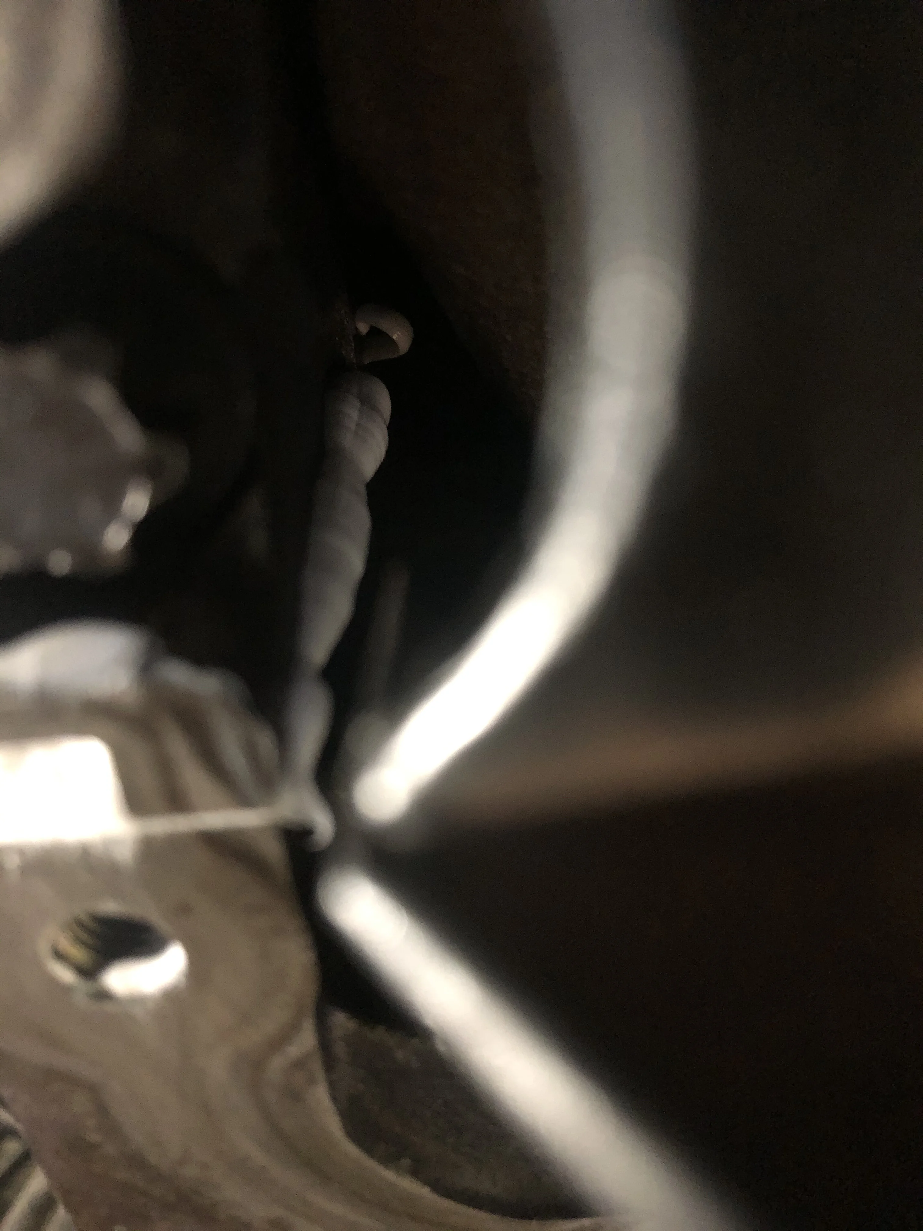

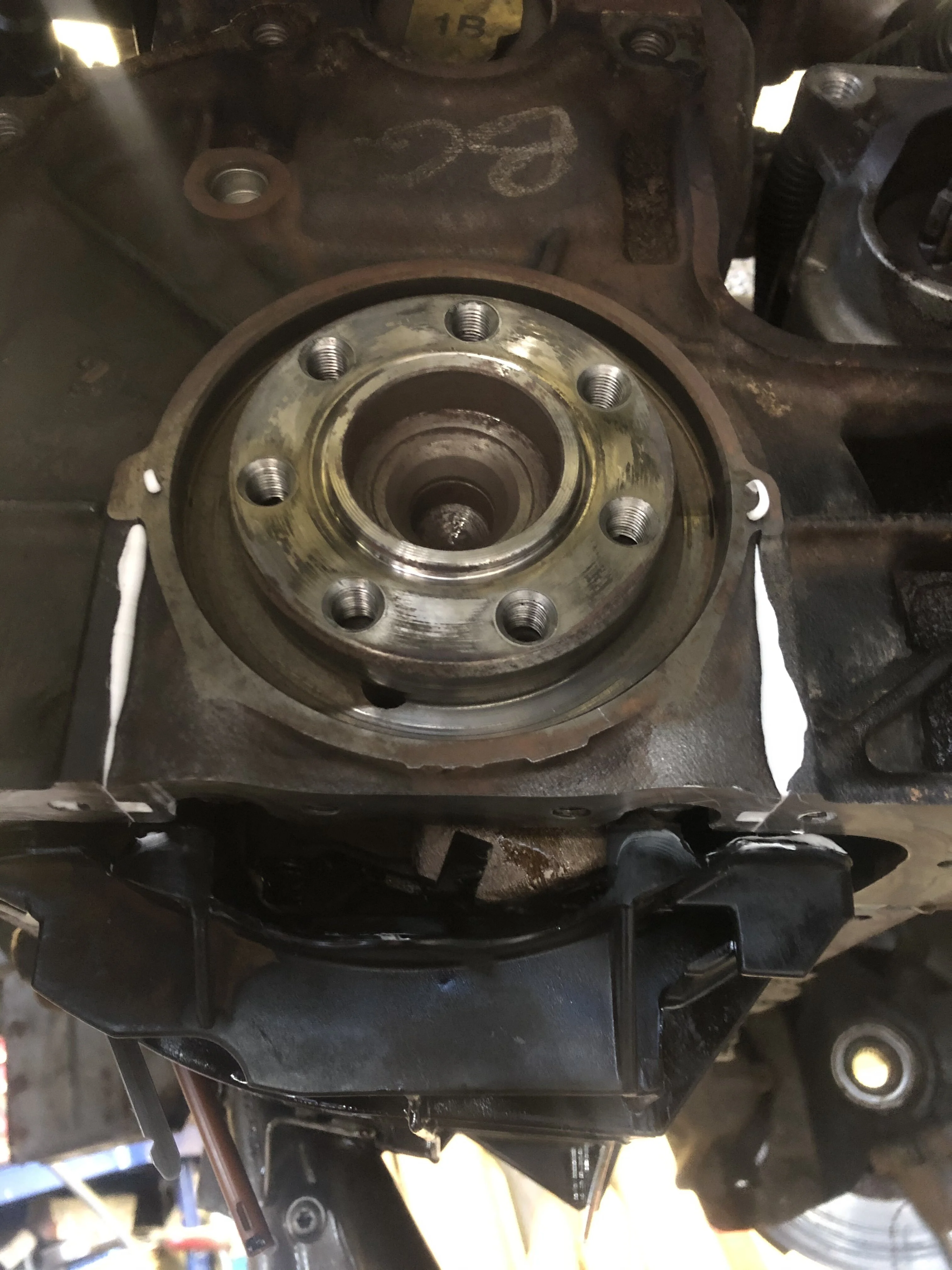

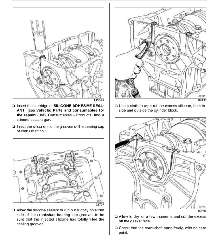

I recently did mine .
make sure you don’t tap in the rear main oil seal flush , it needs to stick out approx 5mm.

Fantastic, thank you very much @barnesautos that's exactly what I was after. Can you tell me what sealant you went with?
yeah I've seen on various threads the seal needs to sit proud and taken plenty of pictures of the old one too

Need regular sealant on the main cap as its not a flange like the cam cover. I used reinzosil on mine, the tube comes with a nozzle. Squirt it in the groove until it comes out of all sides, use a torch to check for any gaps.

It was hard to get it to fill properly without just pushing out the top. I think I got it oozing out the sides all the way up but definitely a lot more one side. Ended up smearing the bead a little to maybe catch any gaps.
Going to install the cap tomorrow when I take it off the stand. Will take some pics when I do

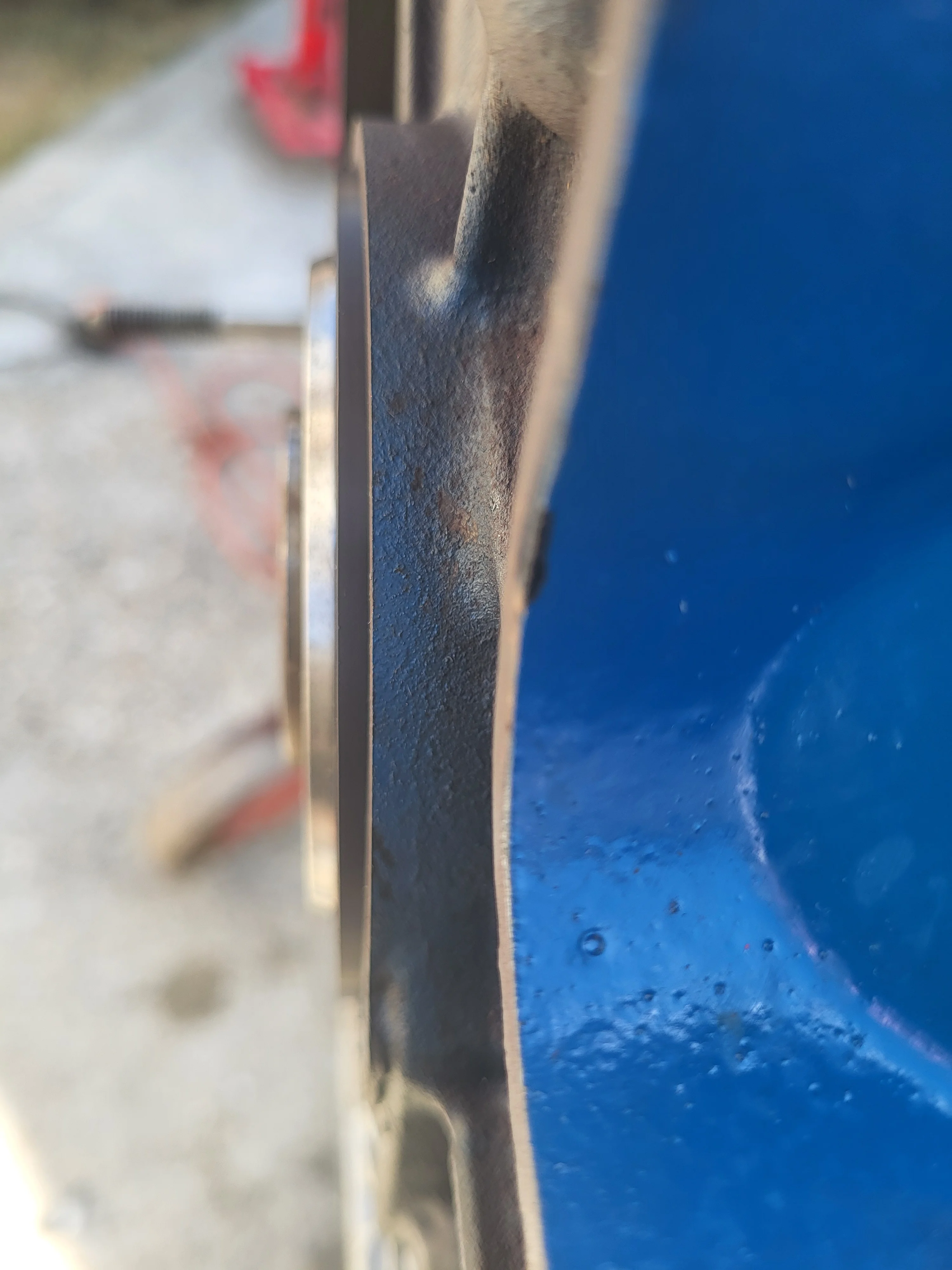

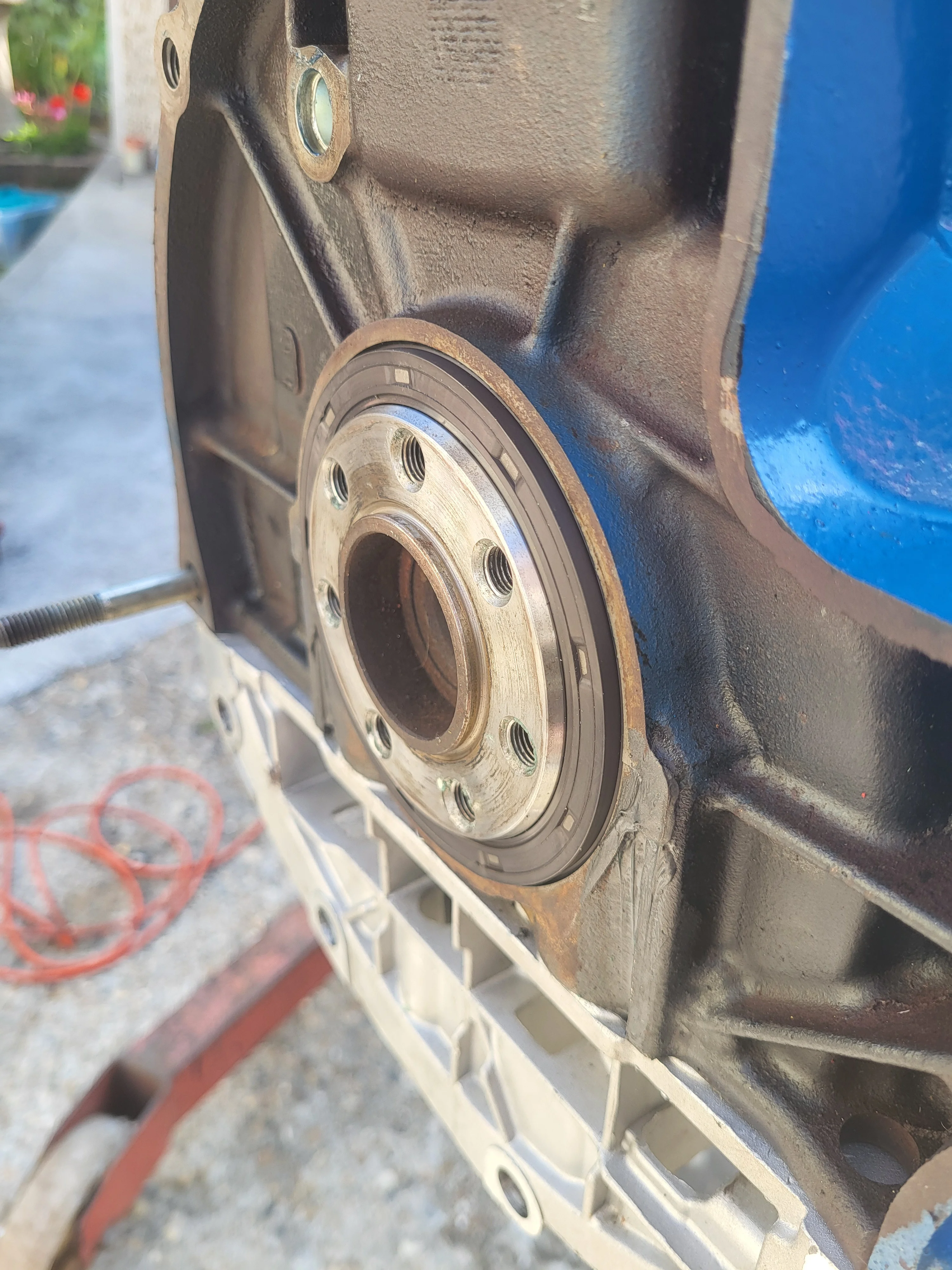

What do we think? I found lining it up and running down the flywheel with three bolts gets it in flush with the face and straight, then it was a case of tapping round the edge until you decide to stop.
I got to 2.8-3mm around, that is when the sealing ribs disappear into the block and you can see the end of the chamfer on the crank end.
I will report back when the engine starts 😬
Looks a neat job that. The one job you. were avoiding on the last build aswell haha. Glad you've managed to get it done ok
I don't suppose someone knows when leaks should become apparent?
Ran it up to temperature a couple of times and not seen anything out the bottom of the bell housing so I might have actually got it right first time! touch wood.
