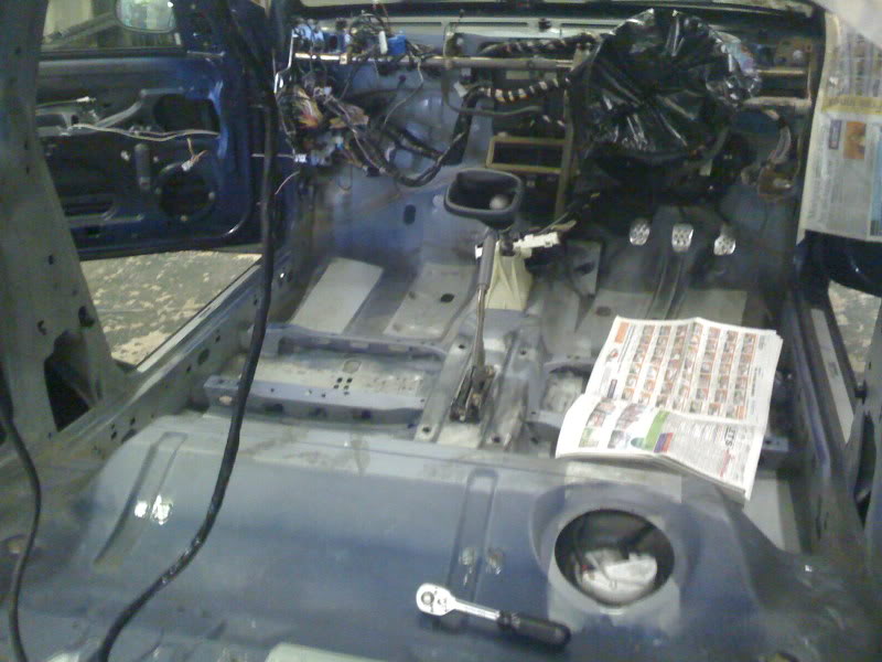

I know some of you guys are as mad as me and insist on stripping your car so Im hoping someone has had this done!!
Basically, I would deliver the car to the bodyshop with everything out bar the seats and cage and want it spraying inside. I dont want to piss about preppeing any more than that... so any ideas cost wise guys?

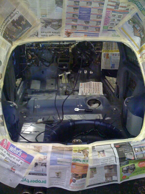

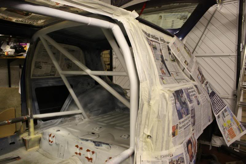

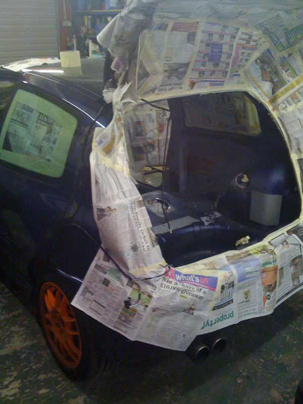

two local body shops I tried did not want to do the job LOL... Too much messing around for them!
So I decided to go DIY stylie... It really was not difficult
Prep time 4 hours
First coat of paint 1 hour
Second coat of paint another hour
Then left the car over night to dry ;)

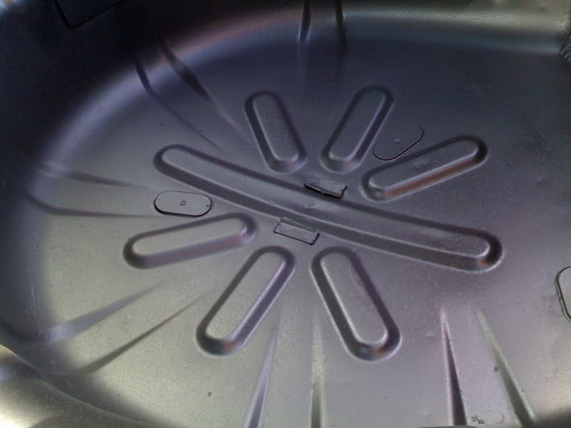

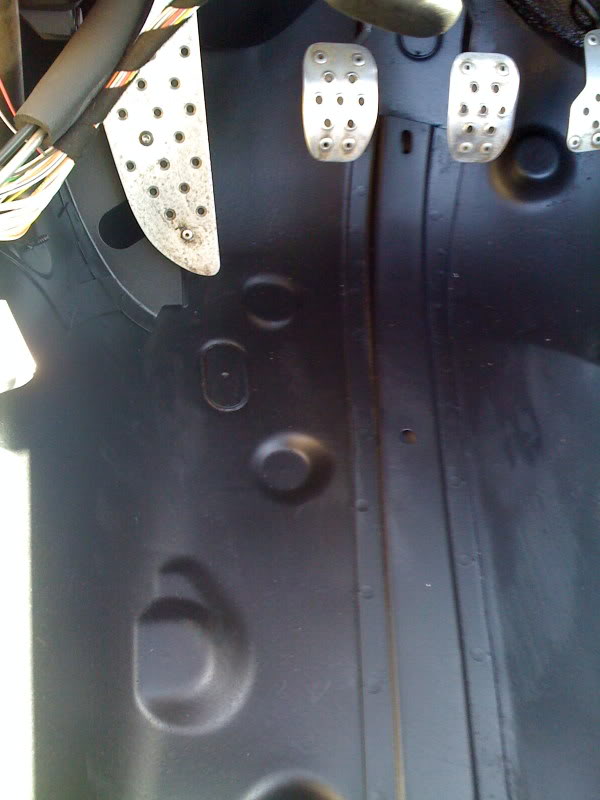

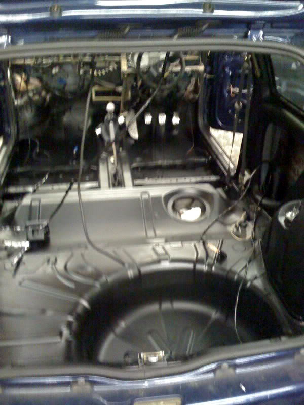

I used synthetic paint, this requires no primer and will pretty much paint onto any surface with no minimal prep work (A quick wipe down with white spirit)
  106 GTI
I really want to do mine but know that as soon as somethings put in it it will get scratched
  340i
Mine has stood up pretty well to scratches... Various trips to the tip, weekends away, wheels and tyres in the back etc.
Near enough no scratches at all tbh!
Be warned, a lot of bodyshops will probably give you ridiculous prices simply because they don't want to do the job.
