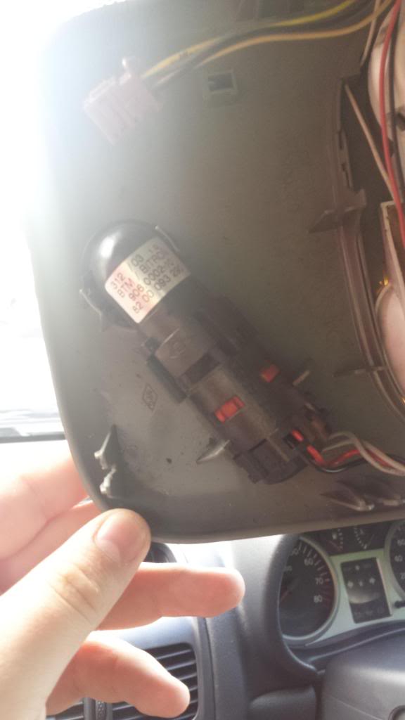

Hi all im just wondering what this is as it has started to buzz and is quite anoying. Clio 182 btw

It's to do with the climate control system, if you search on here, somebody has done a write up on how to stop it buzzing.

Yeah it's the climate interior temperature sensor. Probably got dust in. Get a low pressure air line on it.
