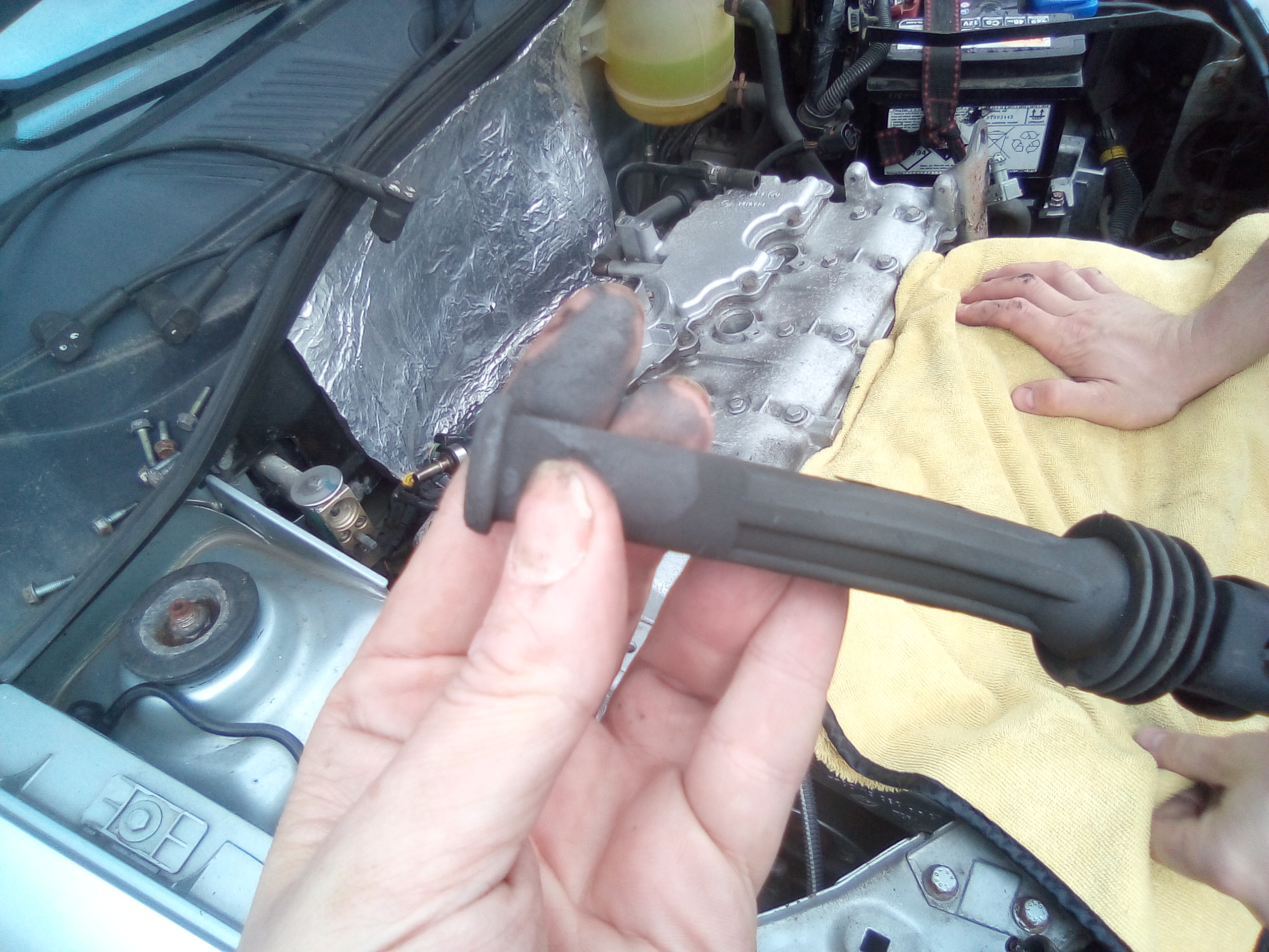

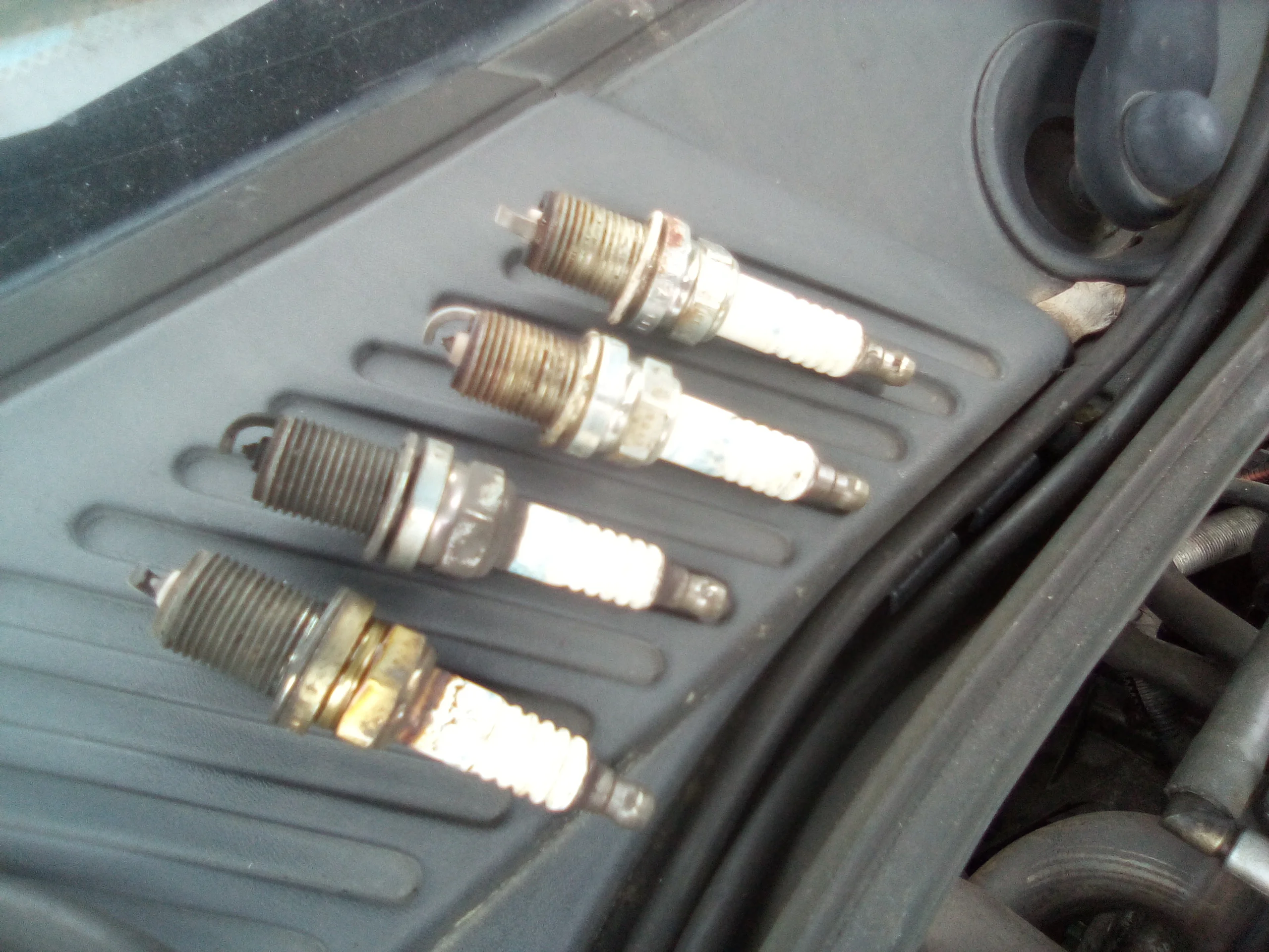

Well figured out what's wrong with it, spent the afternoon at Ryan's trying to get the bottom of this and as I was pulling onto his drive it cut out again and the dash lit up, Clip didn't tell us much so we had a look at the engine, two of the HT leads were moving about so we took the inlet off to have a look.
All the HT leads are covered in carbon
Spark plugs are beyond f*cked
So something has been arching and causing all it's cutting out and limp mode 'voltage regulator' fault codes.
Problem i've got now is it's bore washed the cylinders so many times it's caused another issue, we compression tested them and 4,3 & 2 were all spot on, cylinder 1 is down 45 psi, also one of it's exhaust valves is spitting, so a head rebuild is on the cards and possibly some work on the block depending how bad that cylinder is, at the very least it's new piston rings.
Not the best news but at least I know what's wrong with it now.

Should have said it got new plugs today after we saw the state of them, had to get multipoints with the wrong gaps but they still improved the running a fair bit, got it home without any problems.
