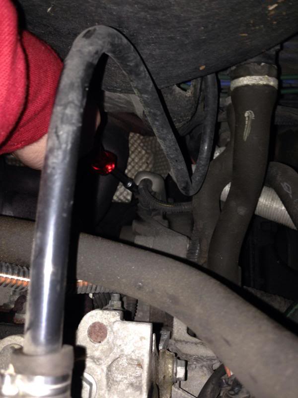

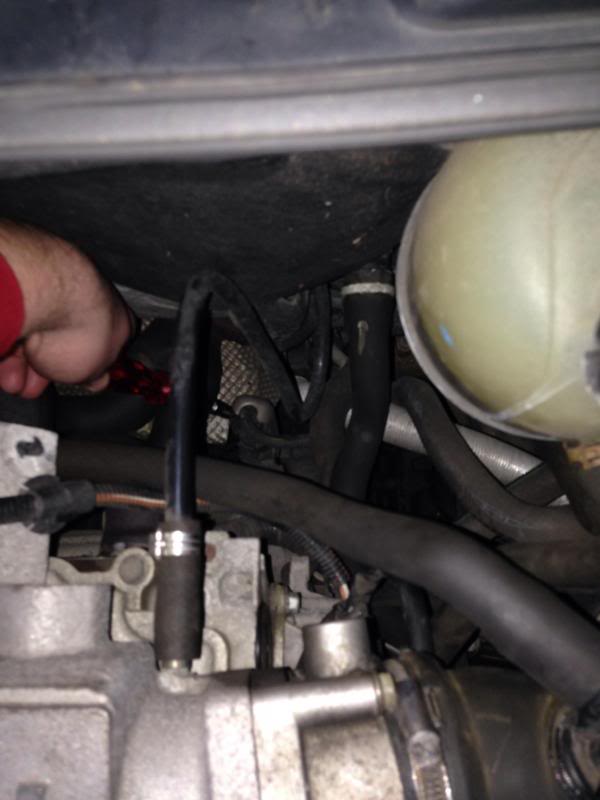

Thank you all! Speedo sensor it is then. Am I right in thinking that it is located behind the engine and down in the middle, almost under the bottom middle of the windscreen?

Heres two, looking down the side of the coolant bottle;
I'm pointing at the sensor with a screw driver;
Hope this helps fella!
