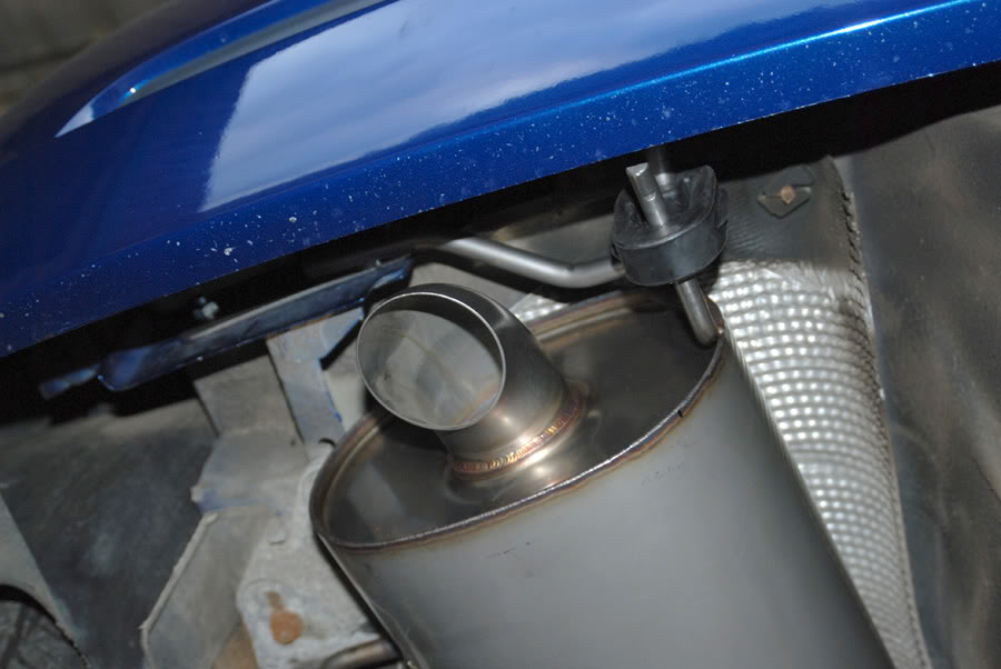

Do what dave says. Undo all bolts twist and push toward manifold and heat sheild. Get some one to hold it up then re-tighten.

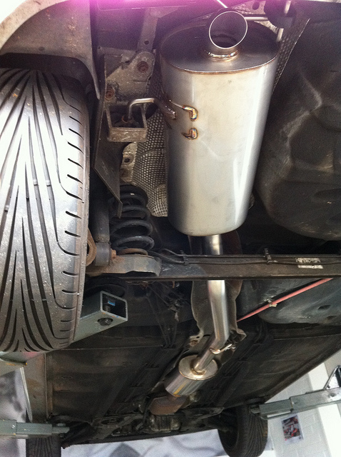

A ktec stealth I presume?
I like stealth systems on 172's. Its the only option I looked at for my ph1. I just wish I hadn't of gone for a ktec. Boomey, droney thing it was.

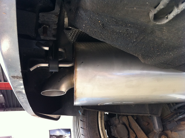

if you get the 2.5 inch without center silencer, then yes it is. The 2.25 inch, and the center silenced versions aren't
That is definitely not sitting right. You can normally see just a small part of the tip
