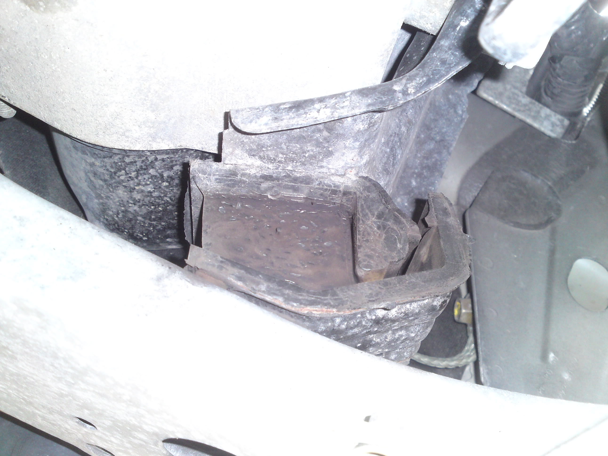

Is this a 'Healthy' Looking Lower Gearbox Mount?
-J-
Car  RS2'ed 172 Cup
Is this what the lower Gearbox mount should look like, or is the one in the photo damaged?
I'm trying to diagnose a massive engine/wheel wobble and was hoping that the mount looked knackered and i had found the issue :(
(The mount above is not mine but looks in same condition)
you tried the ball joints? Mine had a similar problem, changed upper gearbox mount and ball joints = job done. :)
All Upper mounds have been done, not done the ball joints but they look to be ok.
The issue I am having is when under load from 50mph the whole car is shaking as if a wheel is not balanced (Although I know they are as I have tried two sets of wheels and still have the issue)
That is totally normal, it really does do naf all.
