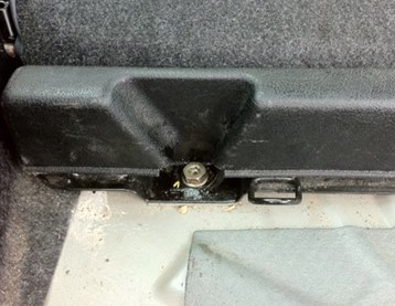

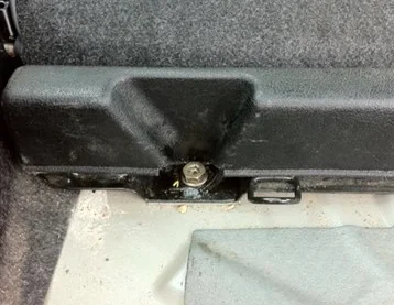

Anyone got a good solution to get these out? Tried smashing wrench with mallet and sprayed bolt with GT85 but still won't seem to budge!

Spray the threads with all sorts of s**t. They are located in the triangles where the spring pan is I think. When undoing mine I had to undo 2 turns tighten 1 turn to clean the corrosion from the threads.

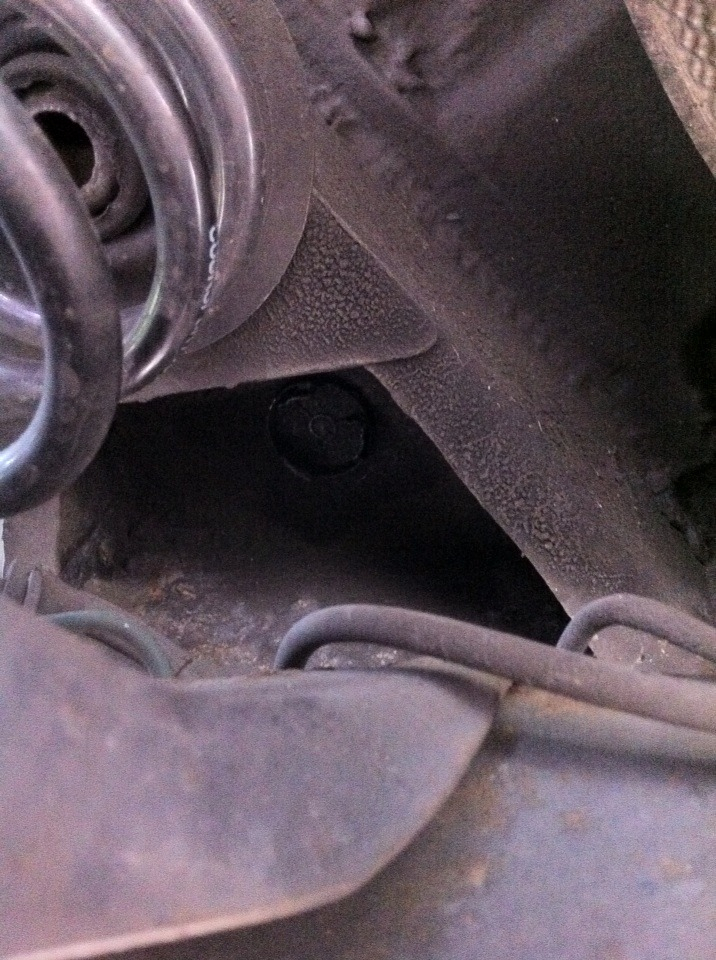

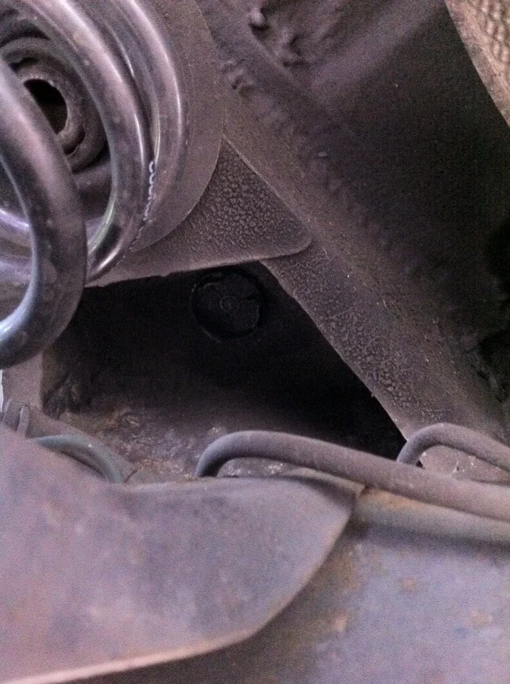

this one mate? (hidden in the shadow, flat bottom) This is the one I'm spraying... don't seem to be having any joy. Will persevere if this is the right one

Take the back seats out and use a socket and breaker bar. Forget the ratchet. They're rusty as hell!

ok well I've given up for today, its not essential. Will buy a breaker bar soon and try again. They really are little knunts those bolts!
