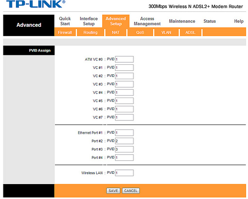

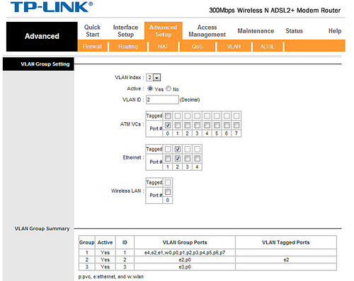

Looks like you were right guys, cabling all tested fine. Now I'm just struggling with VLANs, had it set up fine on the Cisco Router > HP Switch but I can't get it to work with TP Link Router > HP Switch.
On my Cisco I just created a 2nd VLAN, tagged it to a port 2. Tried this on TP Link below:

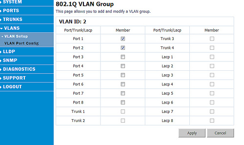

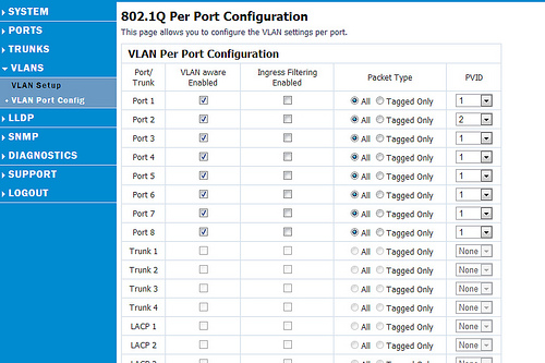

Then, on the HP Switch add a second VLAN for port 1 (coming from router) and port 2 (going to VLAN 2 machines), and have VLAN one on that switch on Port 1 and all other ports apart from 2:
Can anyone see where I'm going wrong? Ports 3-8 on the HP switch all have access to VLAN 1 (as they should) but port 2 doesn't have access to anything, including the internet (but it should have the internet!).
  2014 Focus Titanium
Got it sorted in the end. I needed to create a VLAN that encompassed the three separate VLANs that I needed, then viola!
