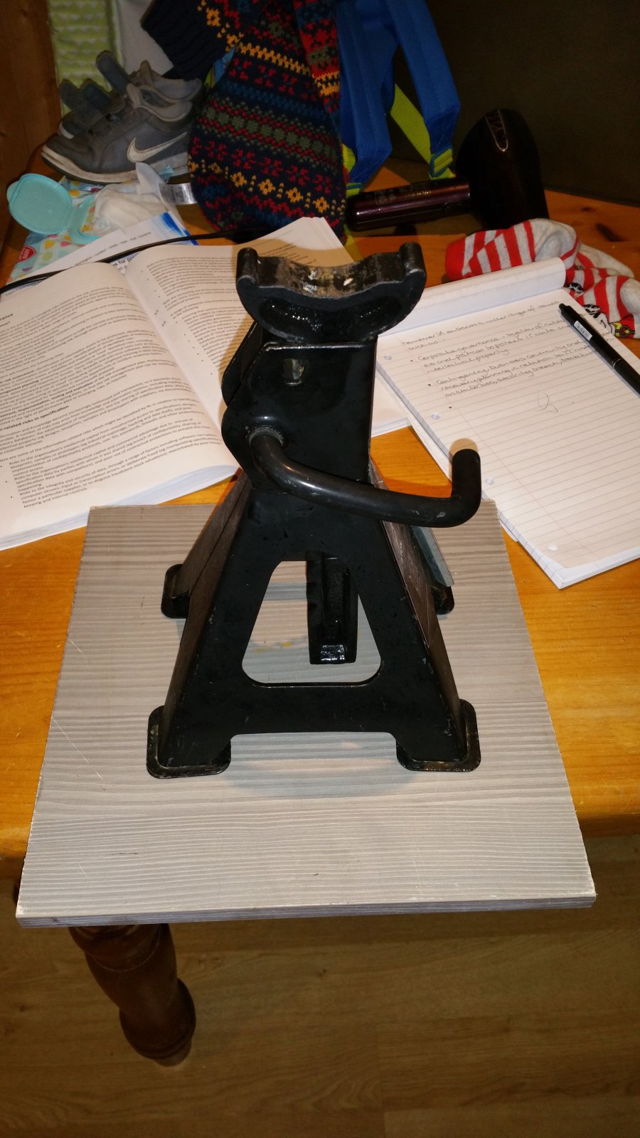

I just got some squares of end panel made up at work to spread the load... Still not sure I'd be comfortable using these on gravel.
