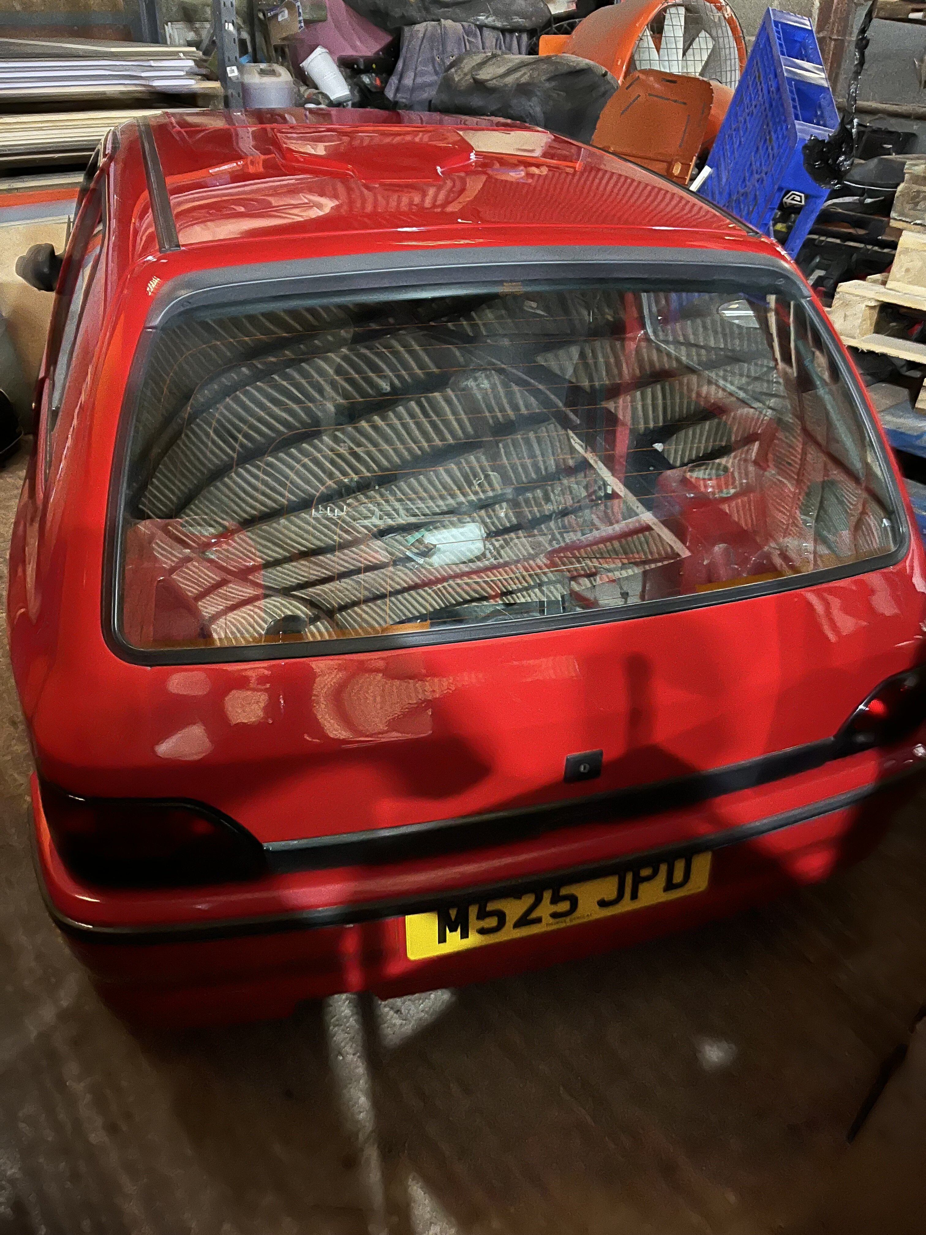

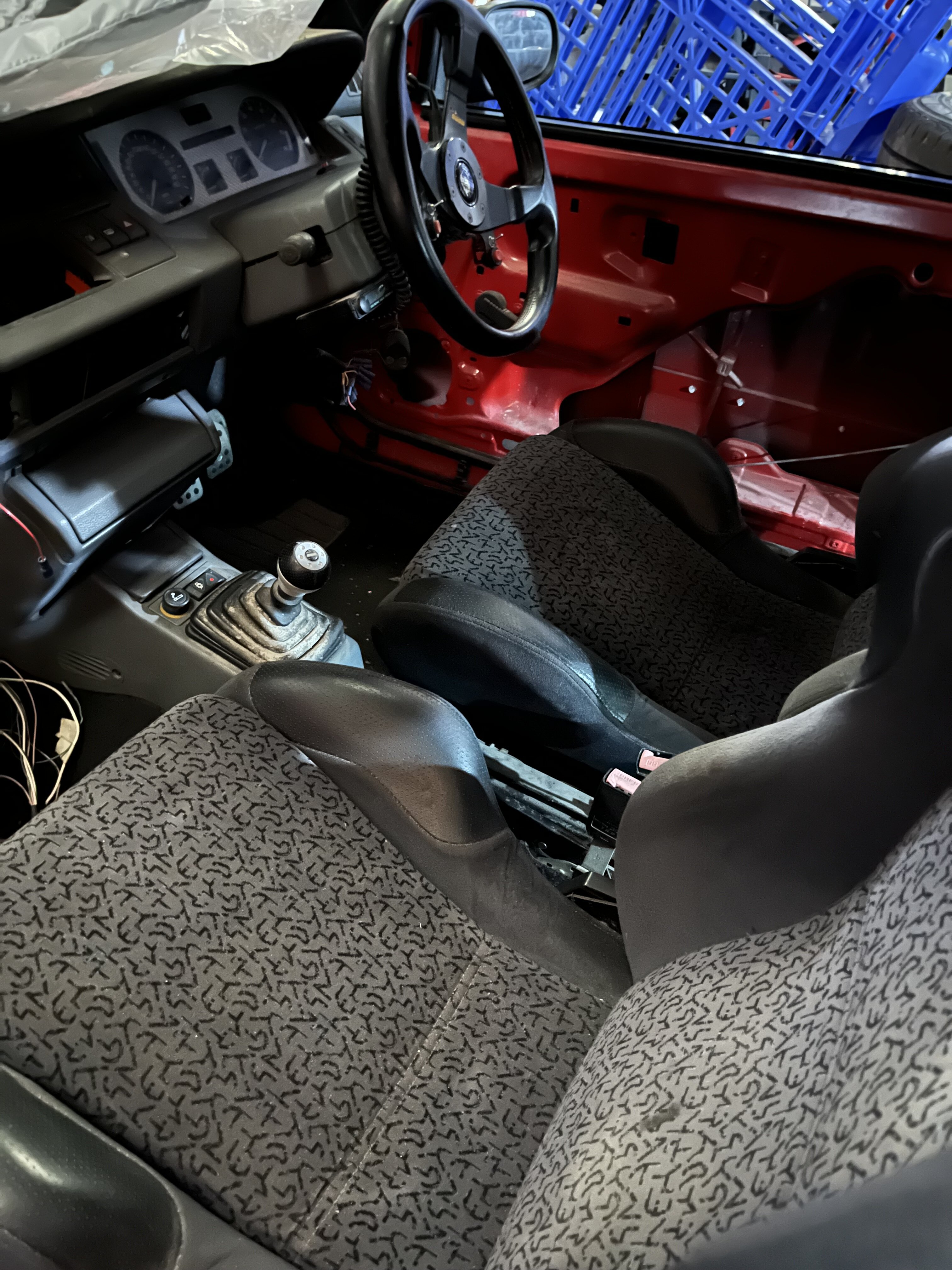

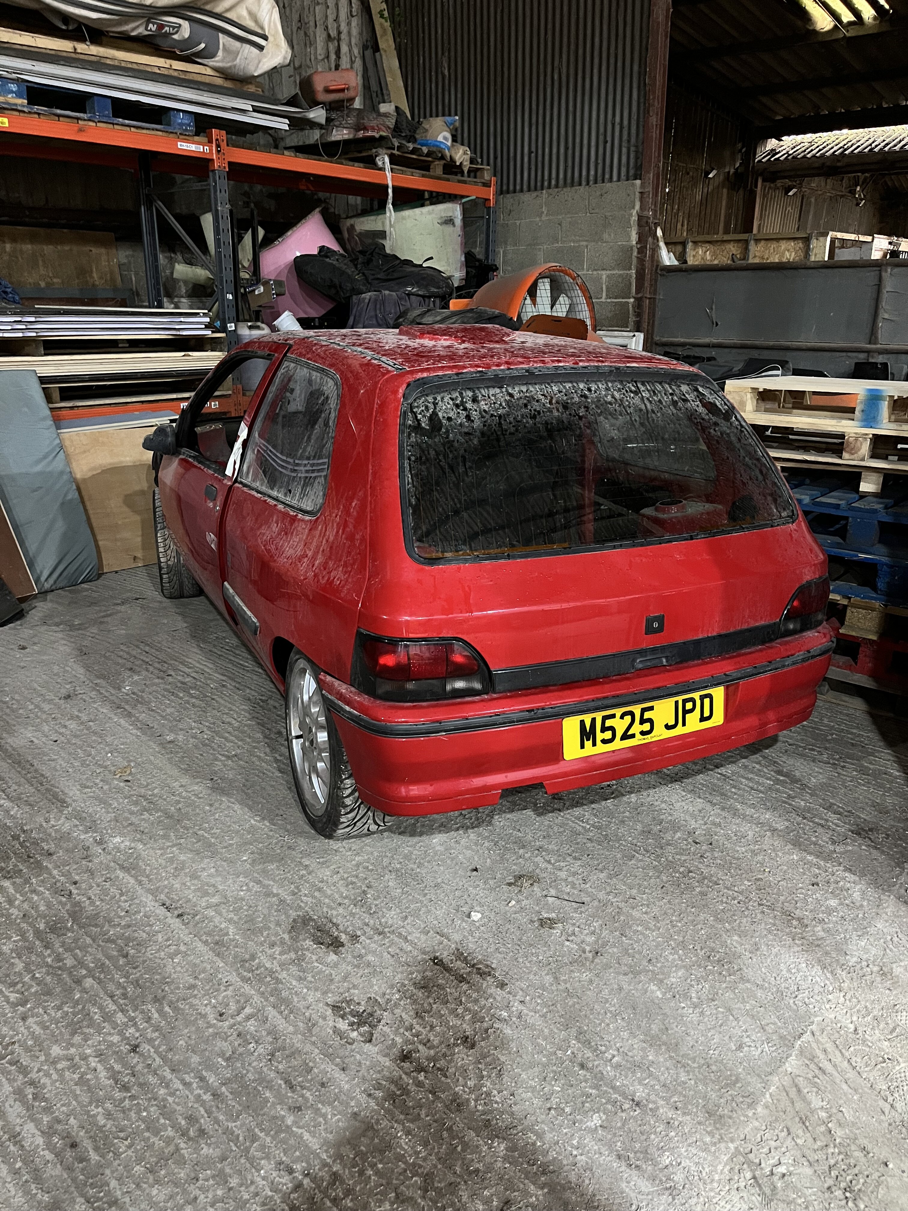

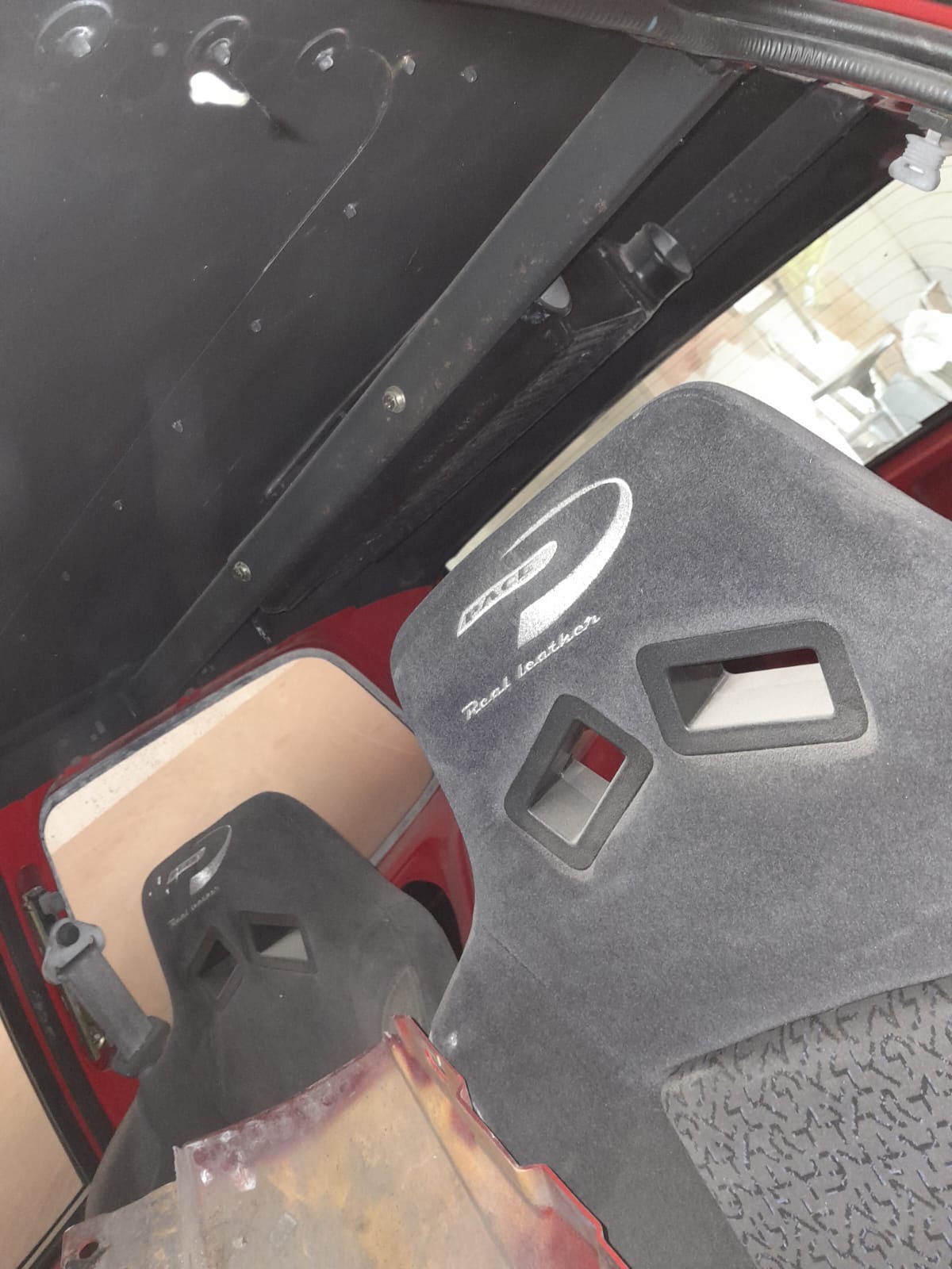

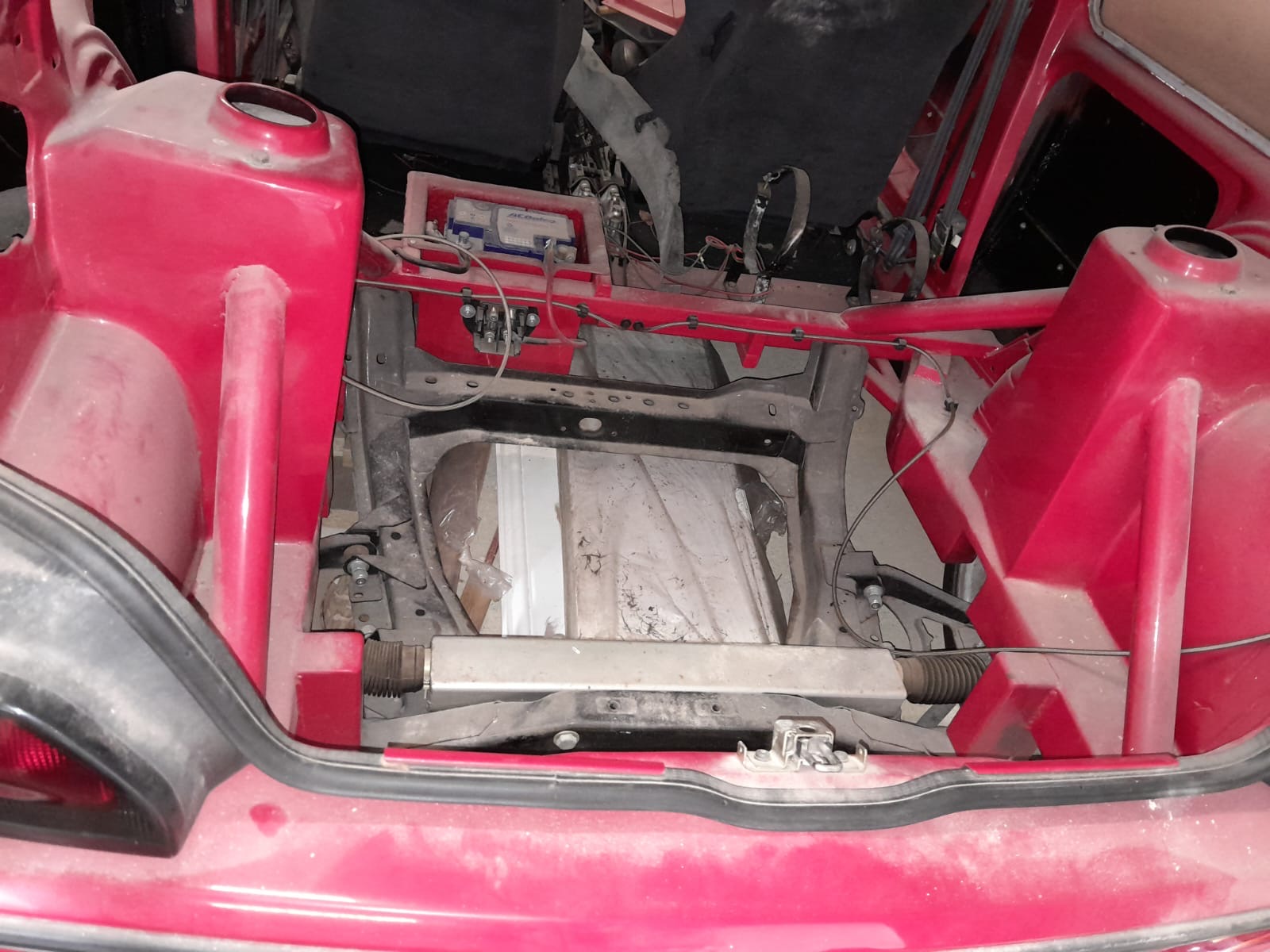

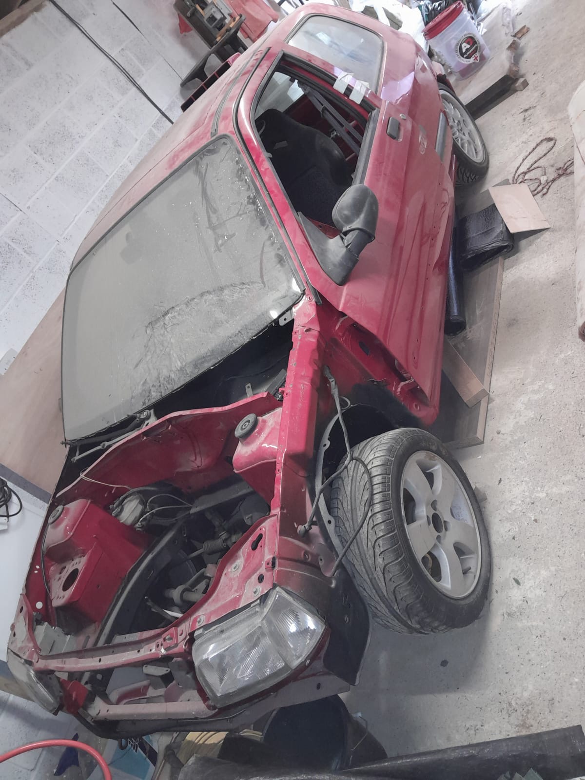

Hi I’m new to the forum, just bought my second ever mk1 valver. Used to have one around 15 years ago and loved driving it. I wasn’t really looking for another one as already have another car but bumped into a friend I hadn’t seen in a while that said he had a project I might be interested in. He had got it off someone he knew and it had sat in his garage for 5 years without him doing anything to it!
Long story short the price was way too cheap to turn down and I bought it on the basis of a couple of pictures. My friend even dropped it off for me to my other friends barn where it now sits.
So it’s an early 1995 1.8 16v with a difference. It used to have a Renault 5 gt turbo engine in the front but the previous owner decided to cut the rear floor out and for the engine in the back driving the rear wheels! It looks like he has done an amazing job of it fabricating front strut towers into the rear and using a modified front subframe in the back.
Unfortunately he sold the engine so at the moment its a rolling chassis.
This is where the project starts, it’s still filthy and there’s various parts all over the front seats. Next week I will go and give it a good clean and get some better pictures then make a very long parts list! Need to decide which engine to go for too.
Should be a fun project but will be very long term as time and cash is tight!

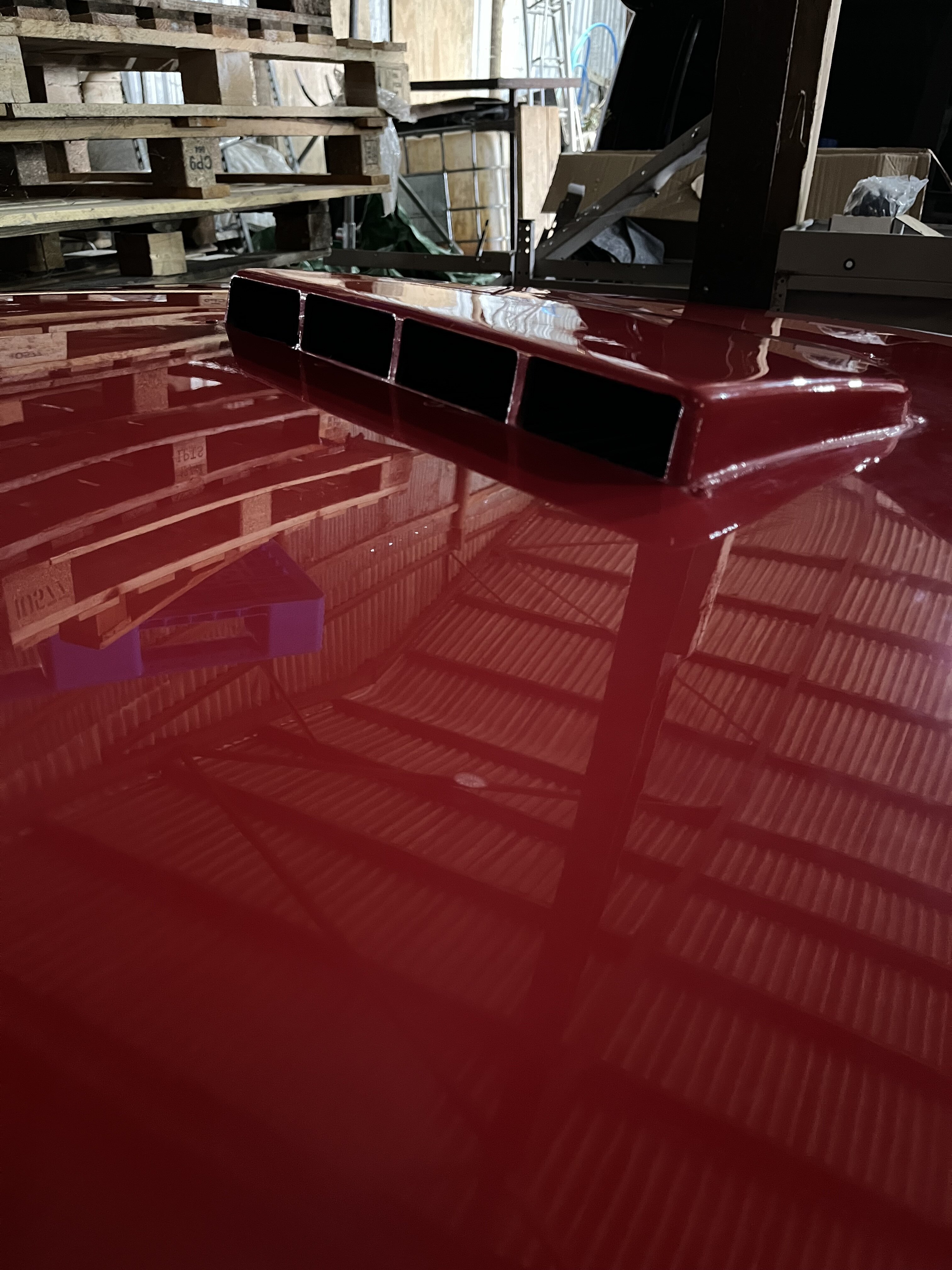

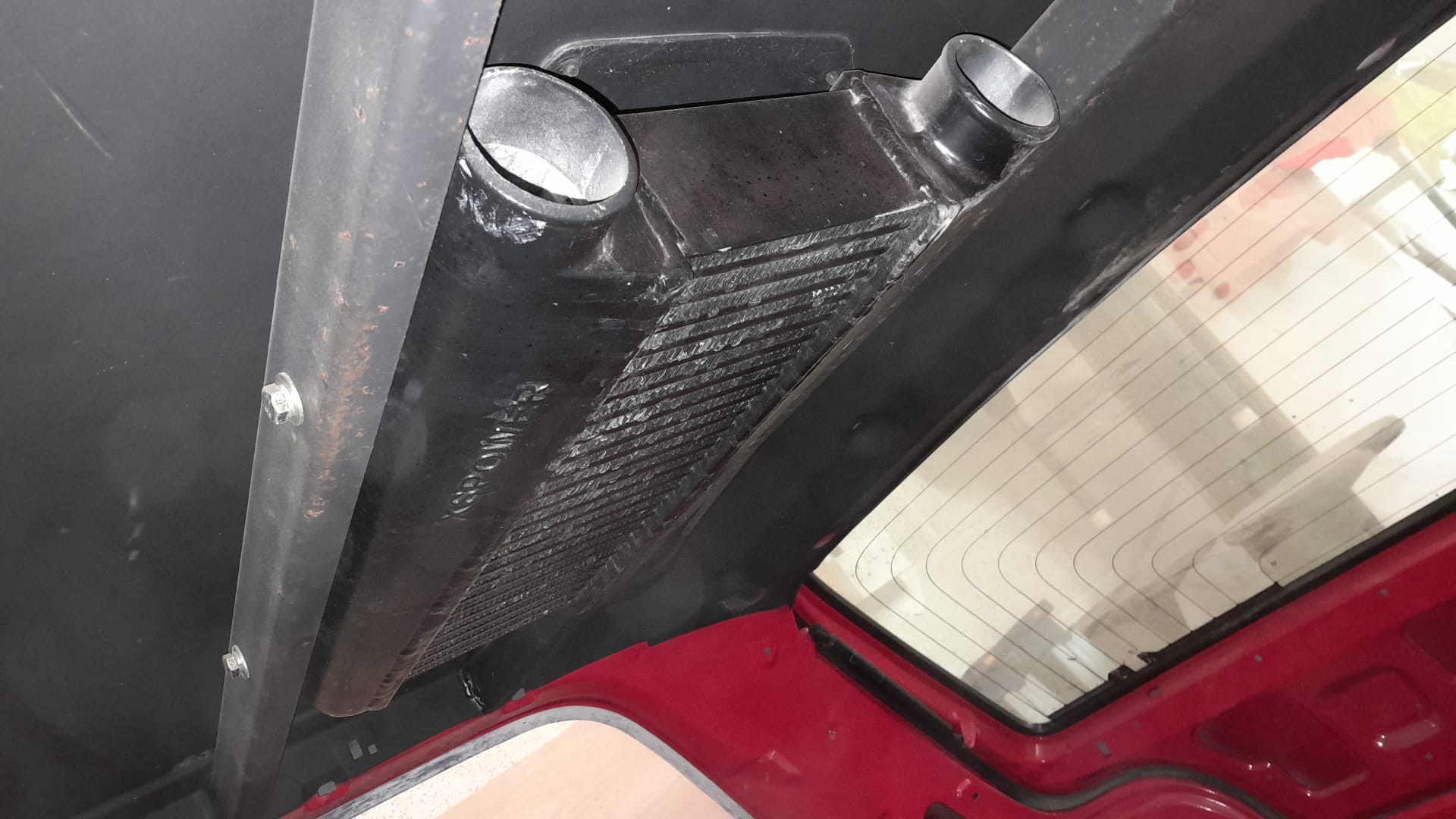

I'm loving the roof mounted intercooler :love:
There's a thread on here somewhere of someone's 172 with the engine in the back that might have useful info in it.

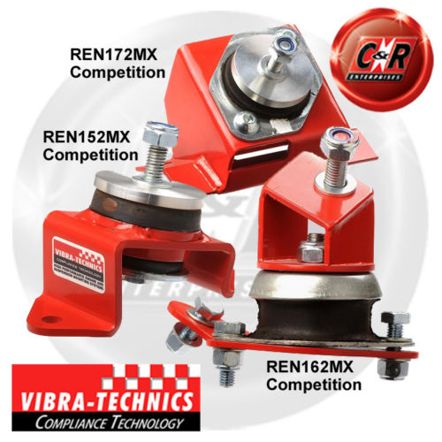

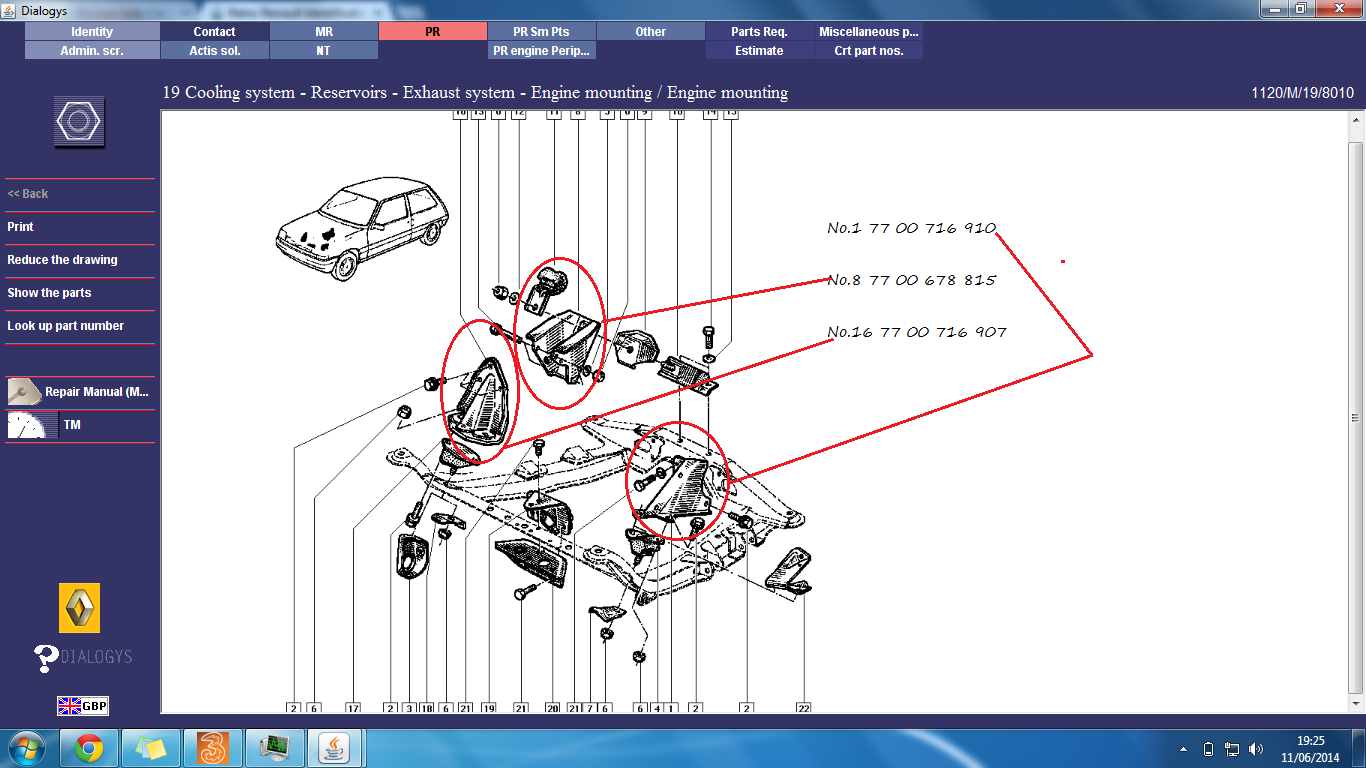

In the pile of parts, see if you've got the R5 engine mount brackets, those will make it easy to mount the engine onto the subframe and they can also be used on a Valver, Williams, Megane F7R or 1*2 F4R engines
Then get these mounts, I have them in mine & there's nothing as good or better for mounting an engine to these subframes

those mounts do look good will have a look thanks.

They're probably very similar but the Valver subframe needs an extra hole drilling in it to accept the front gearbox mount
As for the Megane turbo engine, they're completely different so that'll be some clever fabrication needed to get it to fit in there, from a mounting the engine perspective, it'd be a lot easier to fit 1 of the other engines I mentioned & convert it to turbo plus there's the added bonus of having plenty of room to have a decent exhaust manifold instead of the usual log type and a lot more options for turbos to choose from

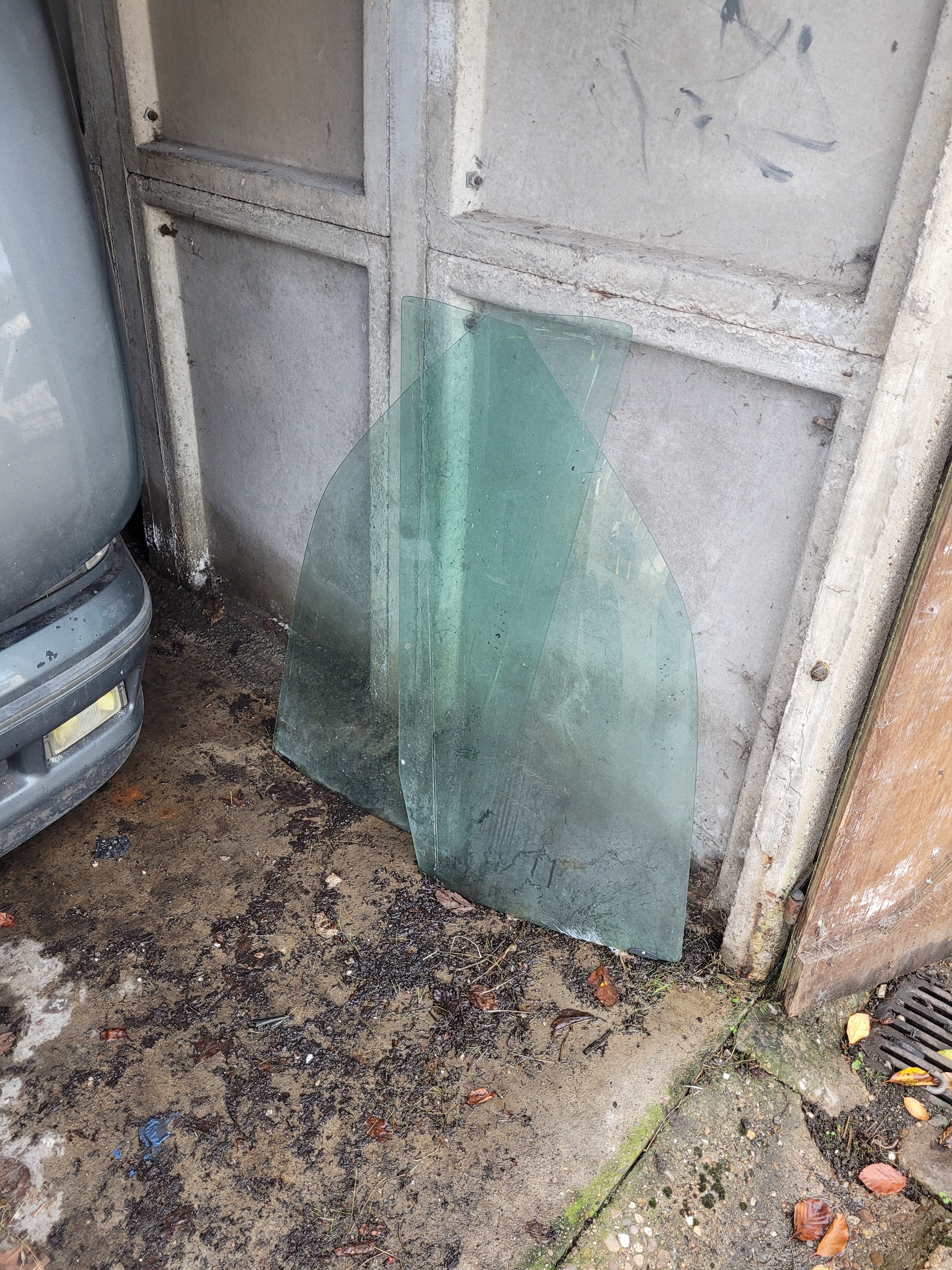

The main parts I need will be a front bumper, bonnet, N/S door striker and front window glass (or plexiglass glass like the rear).

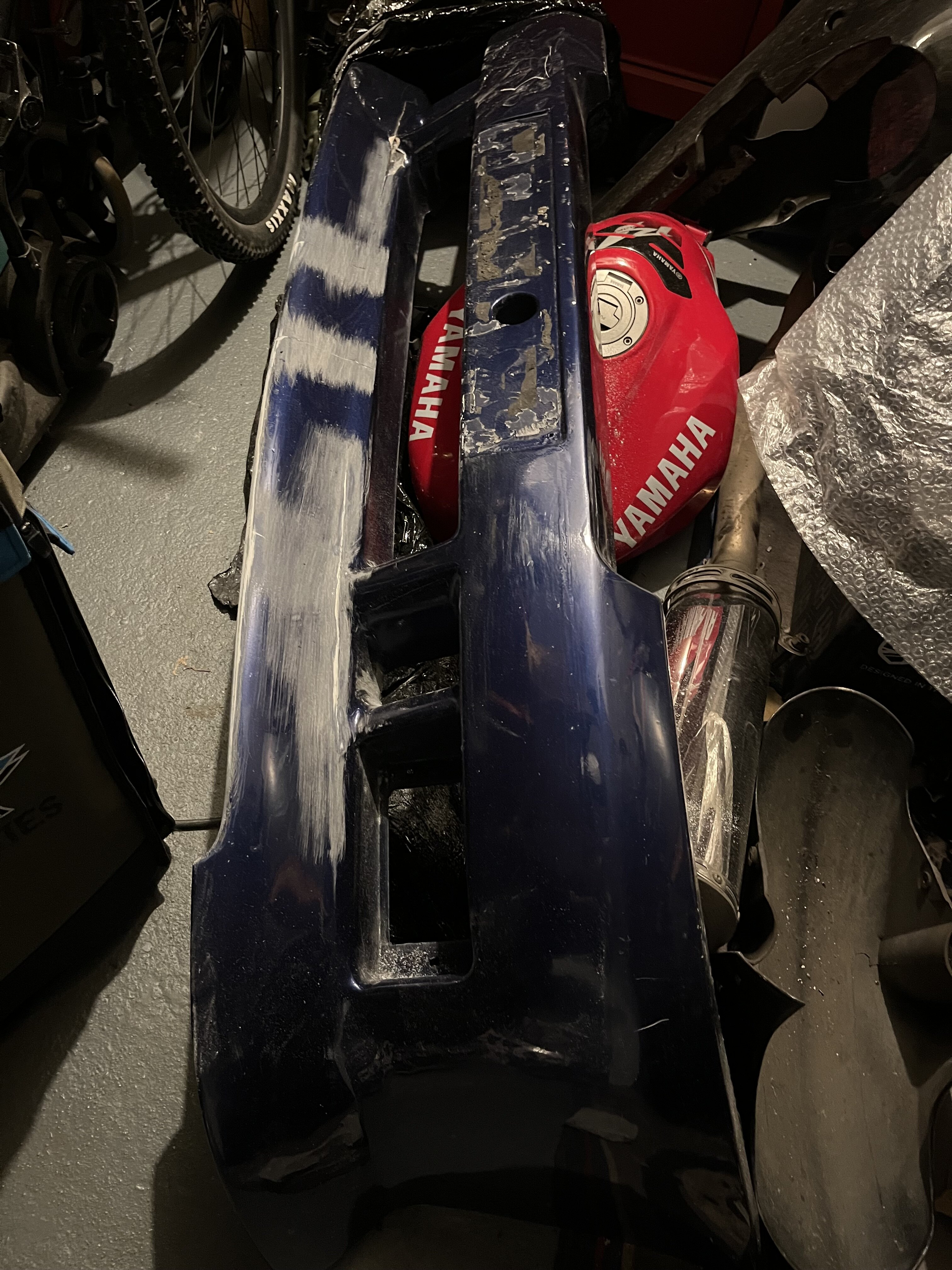

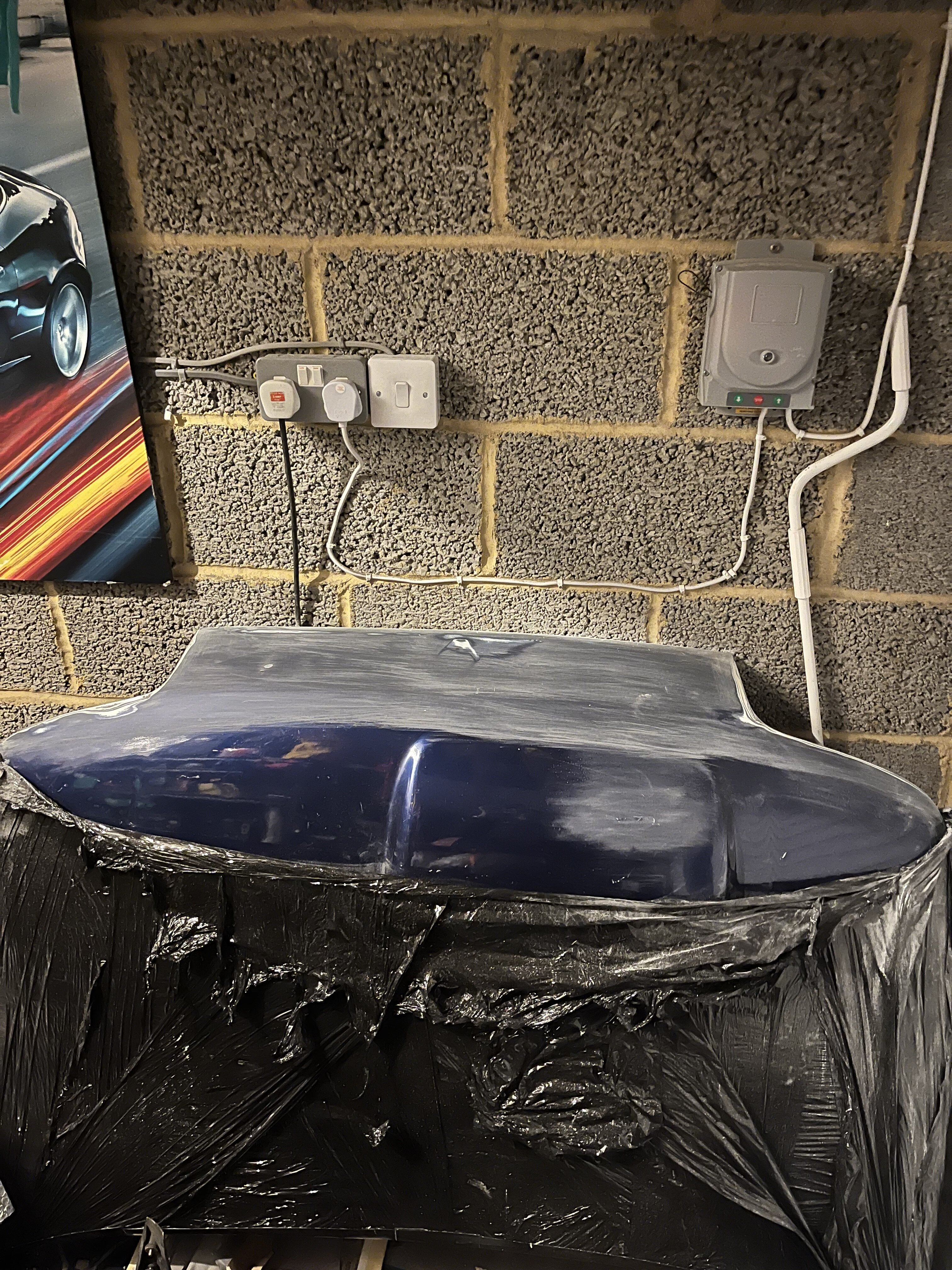

I couldn’t sleep so thought I’d update on what’s happening with the clio. I’ve been busy gathering parts and looking into engine conversions. When I got the clio the main things missing were the front bumper and bonnet. Seems they are getting very difficult to find and people want crazy money for them! I eventually bought them from my friend for a good price off his old max power valver!
The bonnet had the “bad boy” extensions and the front bumper had a what we think is a mk 4 fiesta bumper modded to the bottom.
The bonnet extensions were cracked and one side was loose. I’ve took both sides off and sanded the bonnet down back to stock. The front bumper splitter was so badly damaged I decided to remove it and I’ve never seen so much filler in my life!
I also ordered front plexiglass windows around 8 weeks ago that should be arriving next week.

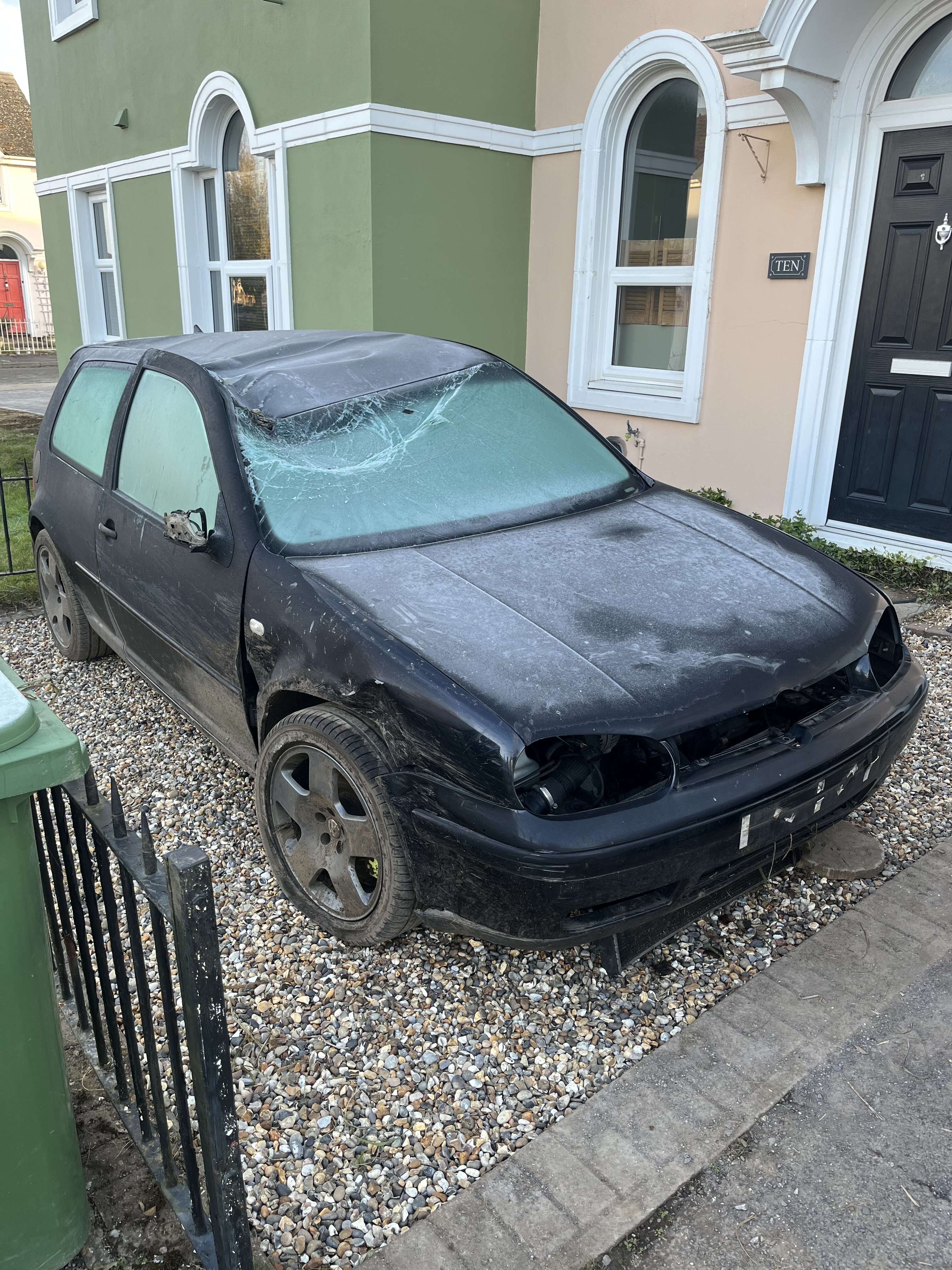

I’ve also managed to pick up a mk4 golf gti cheap! This will be my donor car and I’m in the process of removing the parts I need.
Also had a calk from my friend that rents the barn my Clio’s in. I need to move it soon as he’s moving to a bigger barn. As soon as the golf’s stripped and scrapped I’ll be bringing the Clio home to start the build!

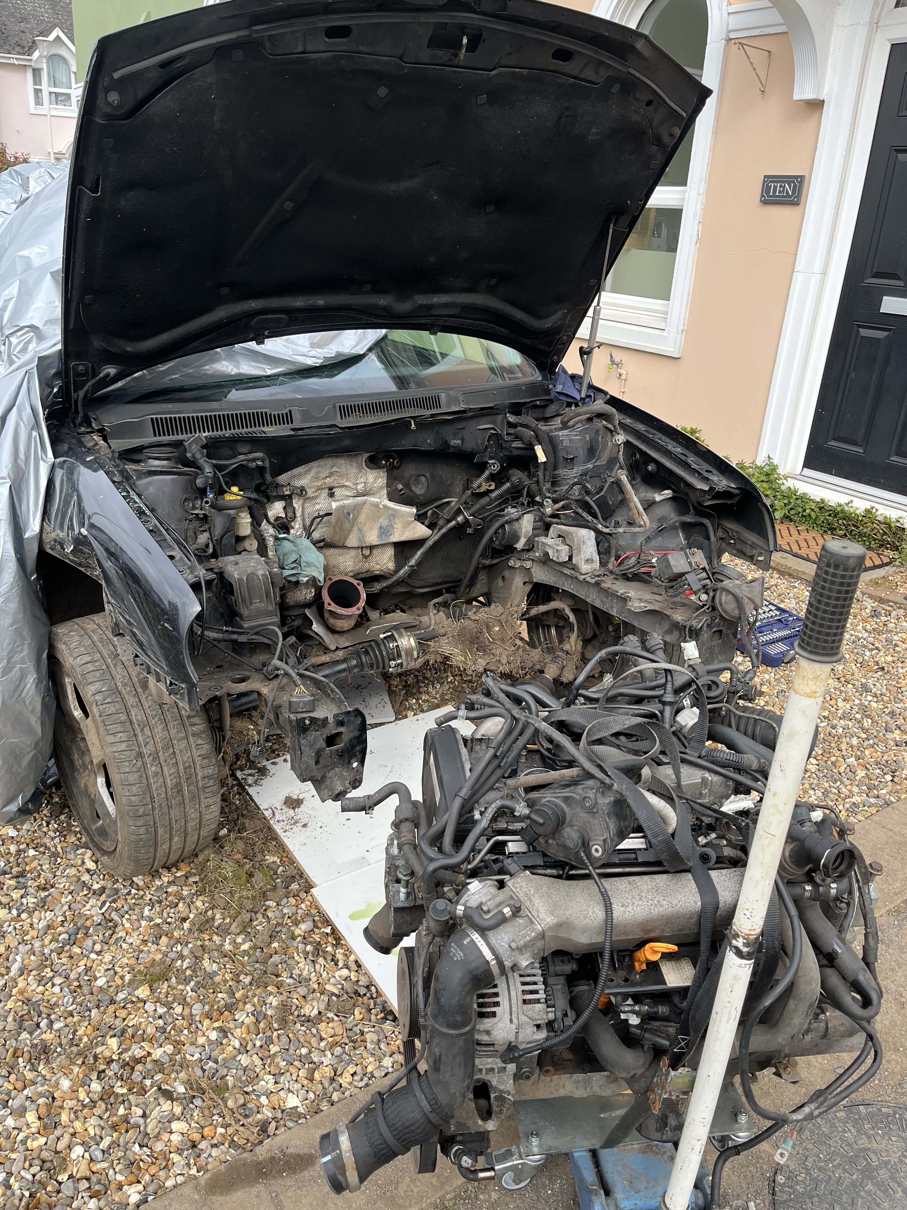

I’ve now managed to get the engine out of the golf, was a pretty simple job to be honest. Next will be stripping out the wiring loom, PCM, instrument cluster, gear linkage, fuel pump etc. Then any parts that could be sold will be on eBay and the shell will be scrapped.
Next stage will be bringing the clio home and see how I’m going to get this engine to fit!?! Should be fun!

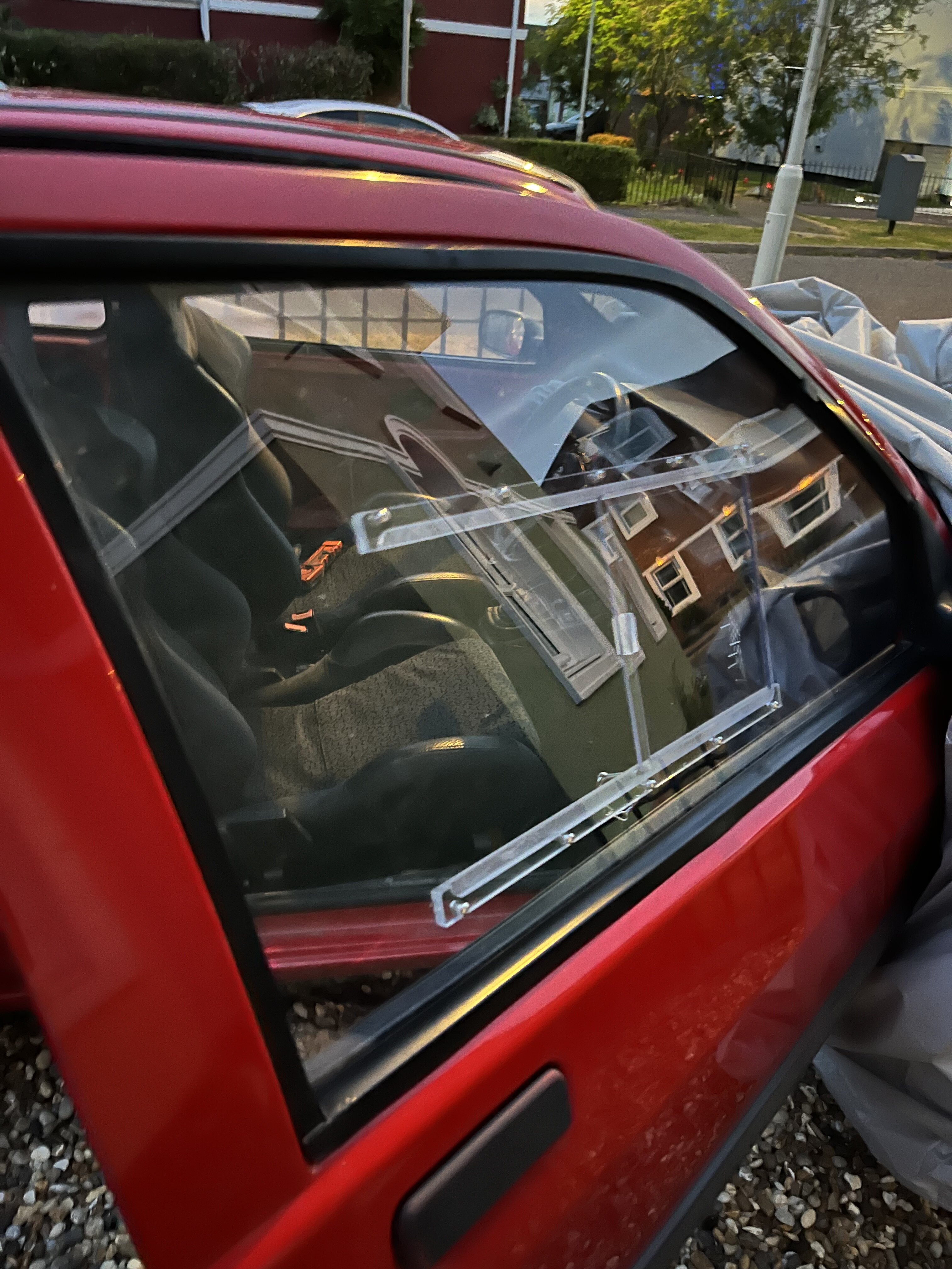

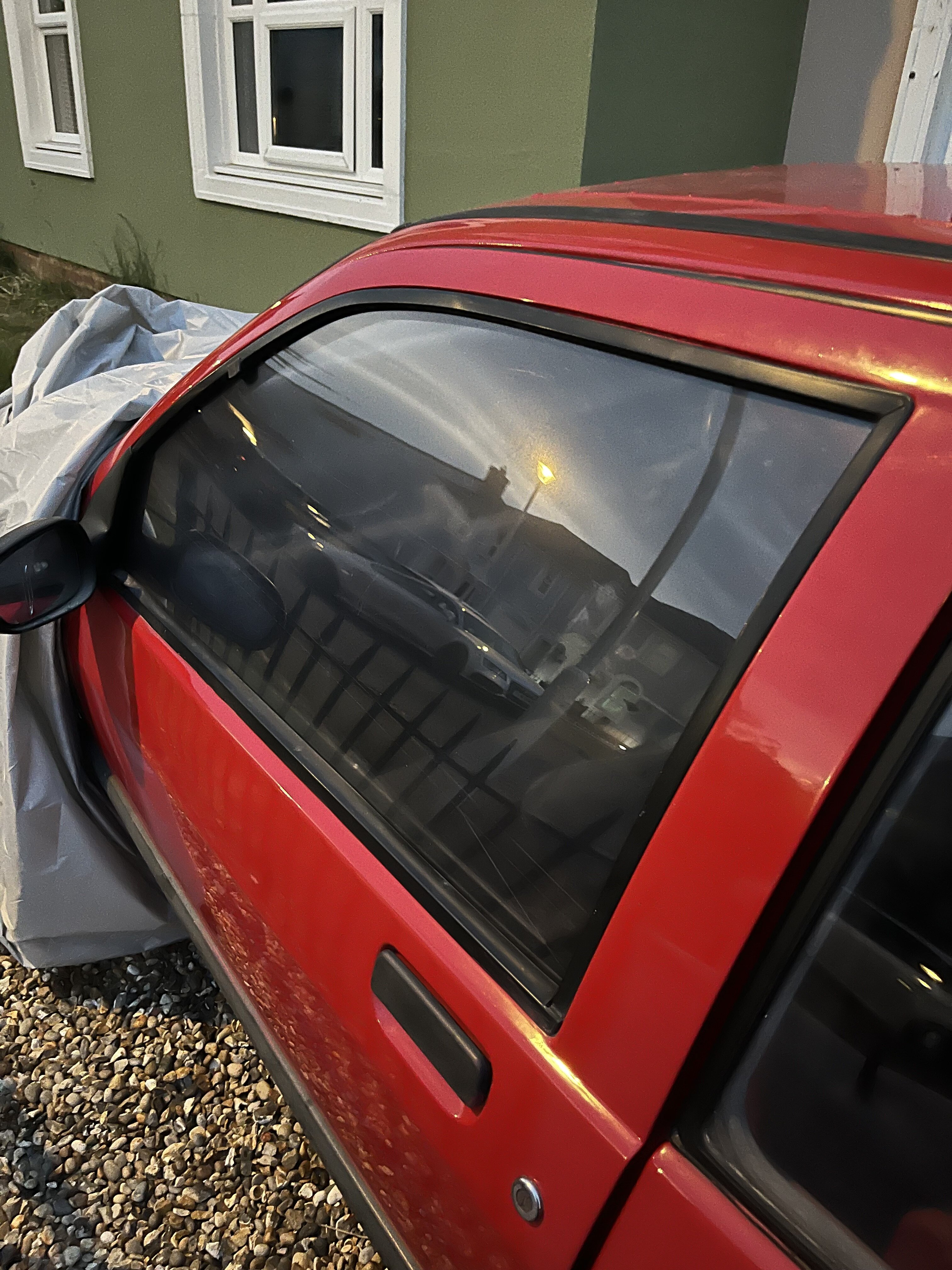

Having the car at home gives me much more of a chance of actually getting on with it. So far I’ve fitted the front plexiglass windows into the original door rubbers and they fit really well after a bit of messing with. I’ve also block sanded the bonnet and given it a light coat of primer to stop the rust and fitted it to the car. I’m still messing with the front bumper but it needs a lot of work, also been thinking of ideas for front splitters (want a low race car type splitter). Sort of want the car to look like a fairly stock clio 16v untill you look closer.

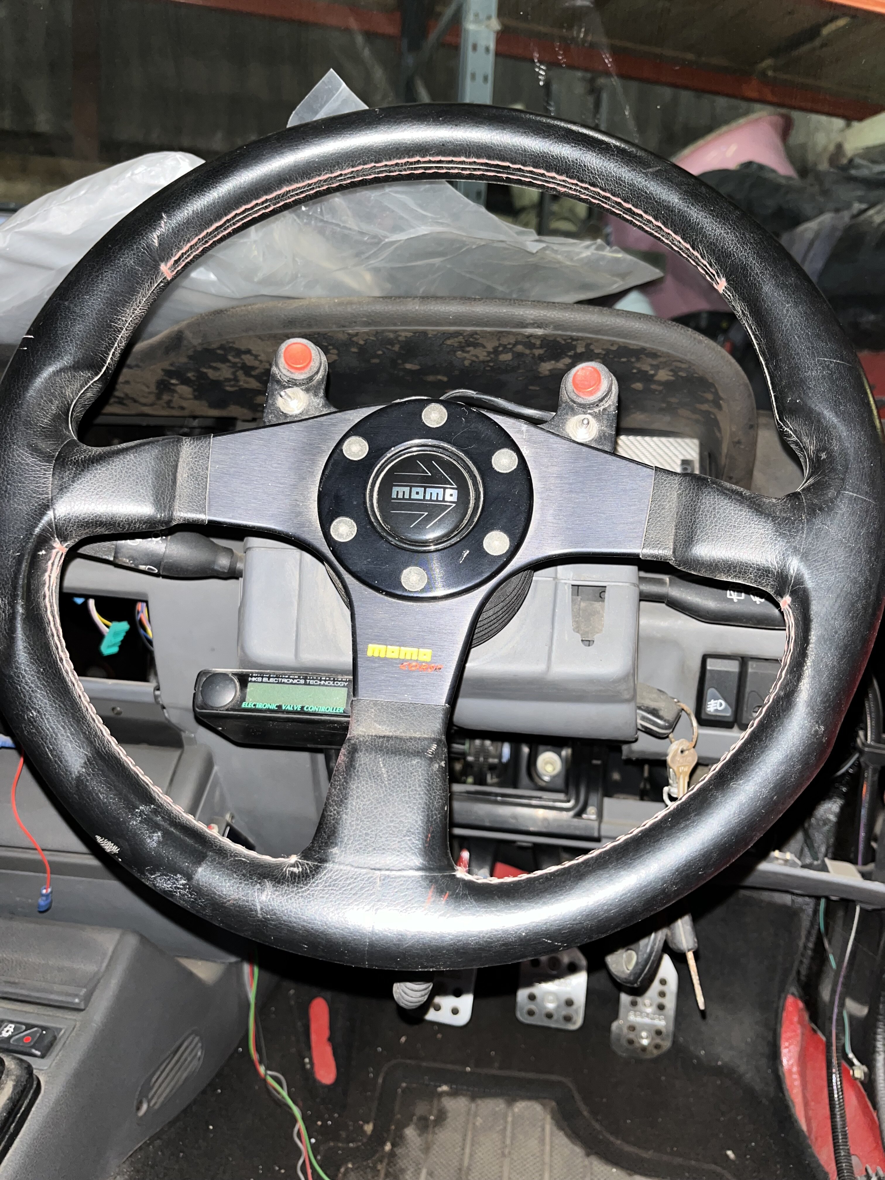

I’ve been thinking about what I’m going to do with the wiring. I was thinking if using the clio loom for the lights and switches but on closer inspection the clio loom is in bad condition and half of it is missing. Think my best option is to fit the complete golf loom and remove all parts of it I don’t need. I’ve removed most of the clio loom just need to remove the fuse box under the glovebox now.
After the loom is out of the car my next job is going to be to lower the golf engine into the back of the car (will be borrowing my friends engine crane). It’s going to be very tight getting it through the rear hatch and in! Once in position I will mock up my mounts in card then weld together some steel mounts.

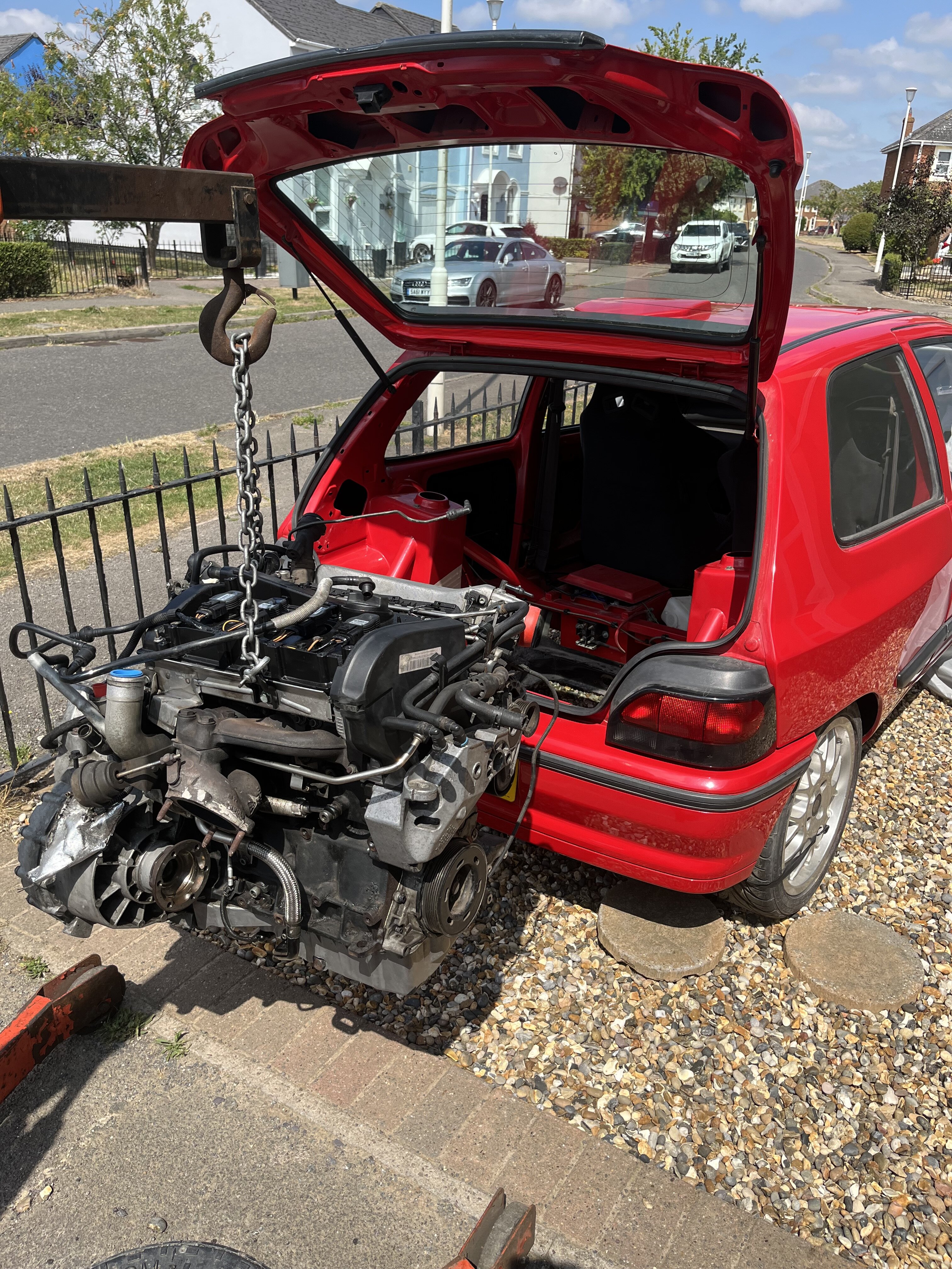

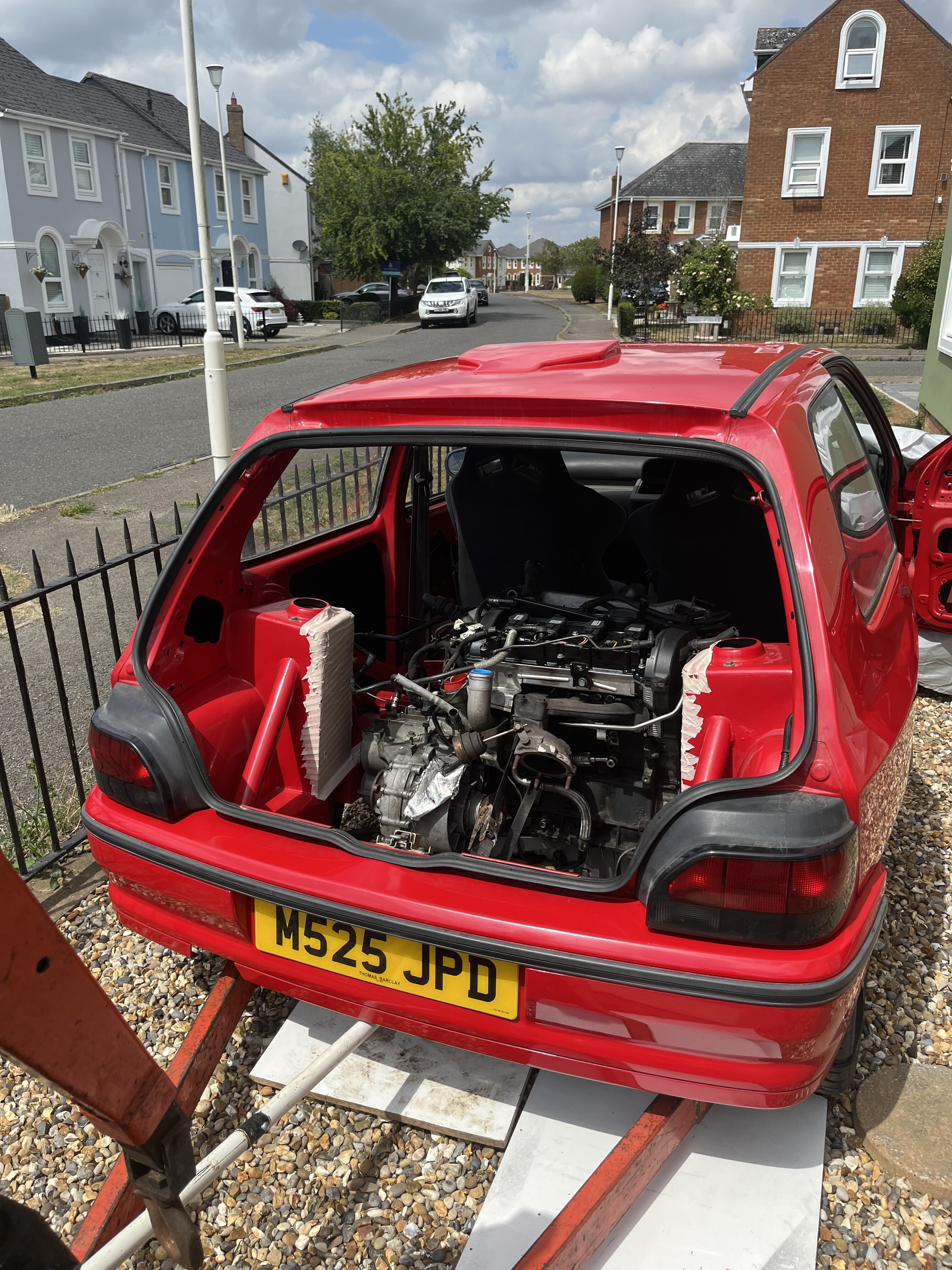

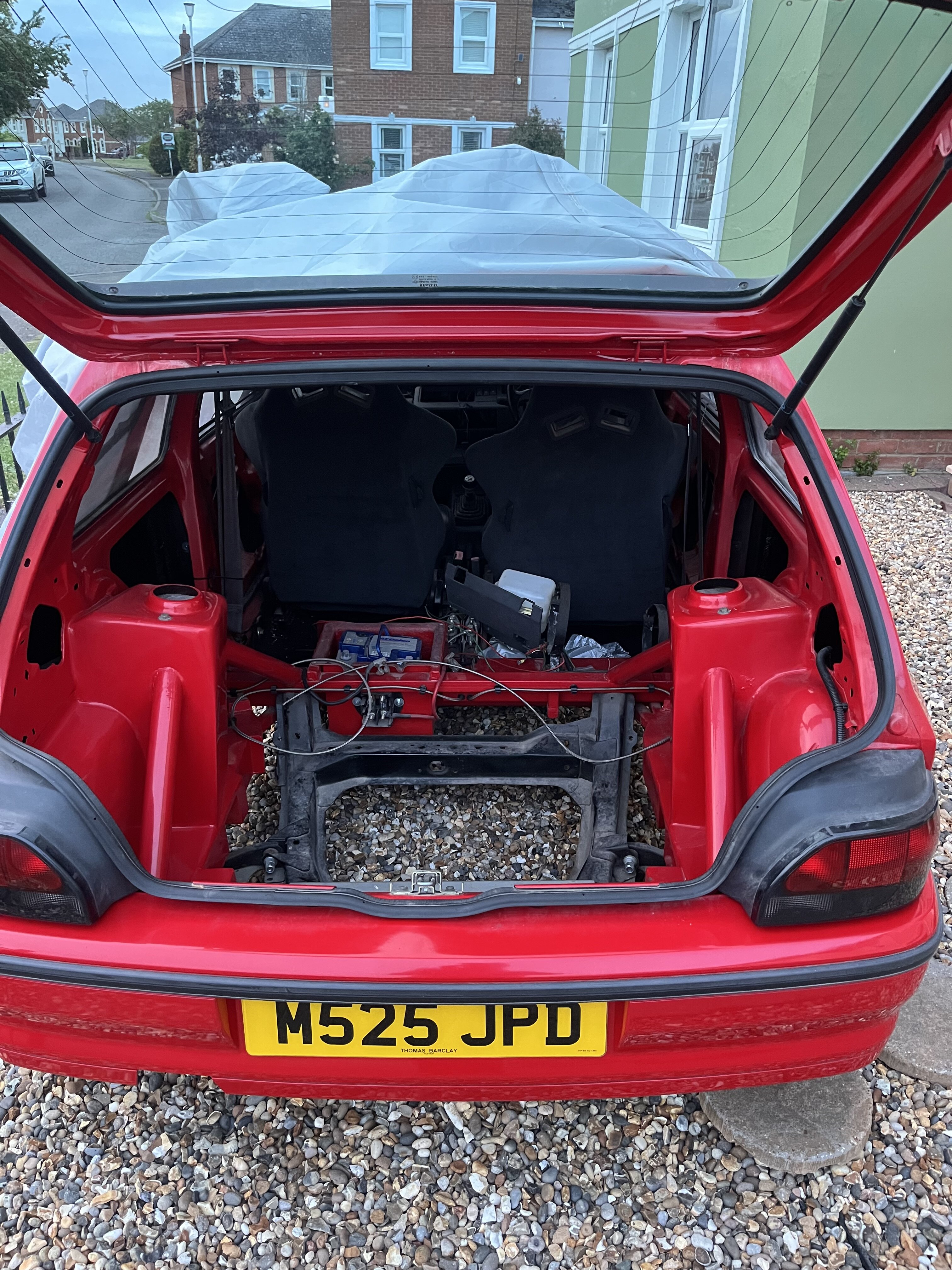

Had a free Sunday last weekend and as the weather was good too I thought it was about time I got the engine in the clio to see if it would actually fit!
After the removal of the tailgate and a lot of messing around with an engine crane and trolley jack it’s in! It’s only lowered in on the jack for now so I can get the driveshaft angles correct and mock up the engine mounts.
The driveshafts aren’t too far off, will just need the engine tilting back slightly to get the diff low enough for the correct driveshaft angle. Unfortunately the golf or Renault engine mounts aren’t going to work as where the golf mounts bolt to the chassis is exactly where the suspension turrets are. I still haven’t decided 100% but I’m leaning towards using a thick steel bar either side of the engine with a front and rear mount on each bar. This will give me 4 engine mounts and means I can mount the engine to the chassis legs in front and behind of the suspension turrets. Will also use a dog bone mount lower down to stop the engine rocking too much.
After the engine is properly mounted i will be sorting the driveshafts out then will be fitting the wiring loom. Still a long way to go but very pleased with how the engine fits and think it looks good in the back.
