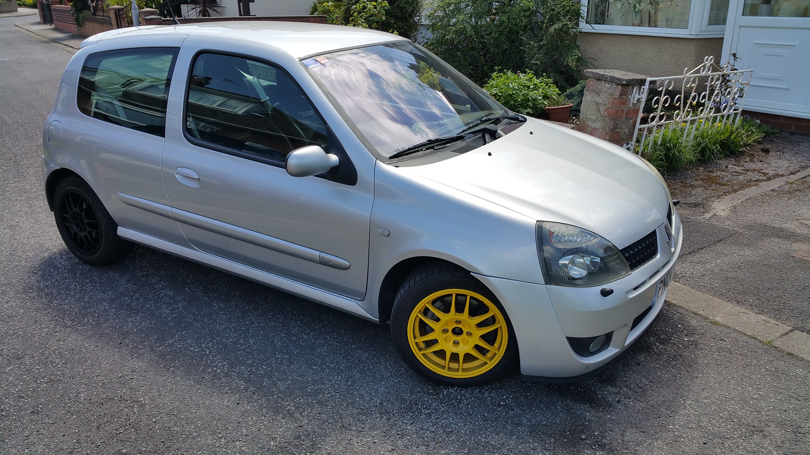

So went to fit the Compbrake kit and thought I'd check to make sure the callipers fitted inside the new wheels and nope, not even close...grrrr! So no choice but to fit the OE cup wheels with Pirelli P-Zero Nero's with the Compbrake kit. So a few days before got cracking on fitting and the supplied braded lines wouldn't fit for toffee, so got some make up quickly from a local specialist and got them fitted...phew, so all good now...NOPE! Car nearly killed me on taking it out as the rear was trying to overtake the front but noticed the ABS, SERV, HANDBRAKE light on so that was it, sold the track day to a follow member for peanuts. Not a good start to my Clio Journey so far!
Next set of problems came thick and fast with the car needing new injectors, leads, coilpack and plugs and when I'd finally sorted and brake issue which turned out to be the ABS pump the 4 pots turned out to be way to aggressive for my liking anyway, so ended up swapping them for a set of freshly powder coated OZ F1's with nearly new RS3's.

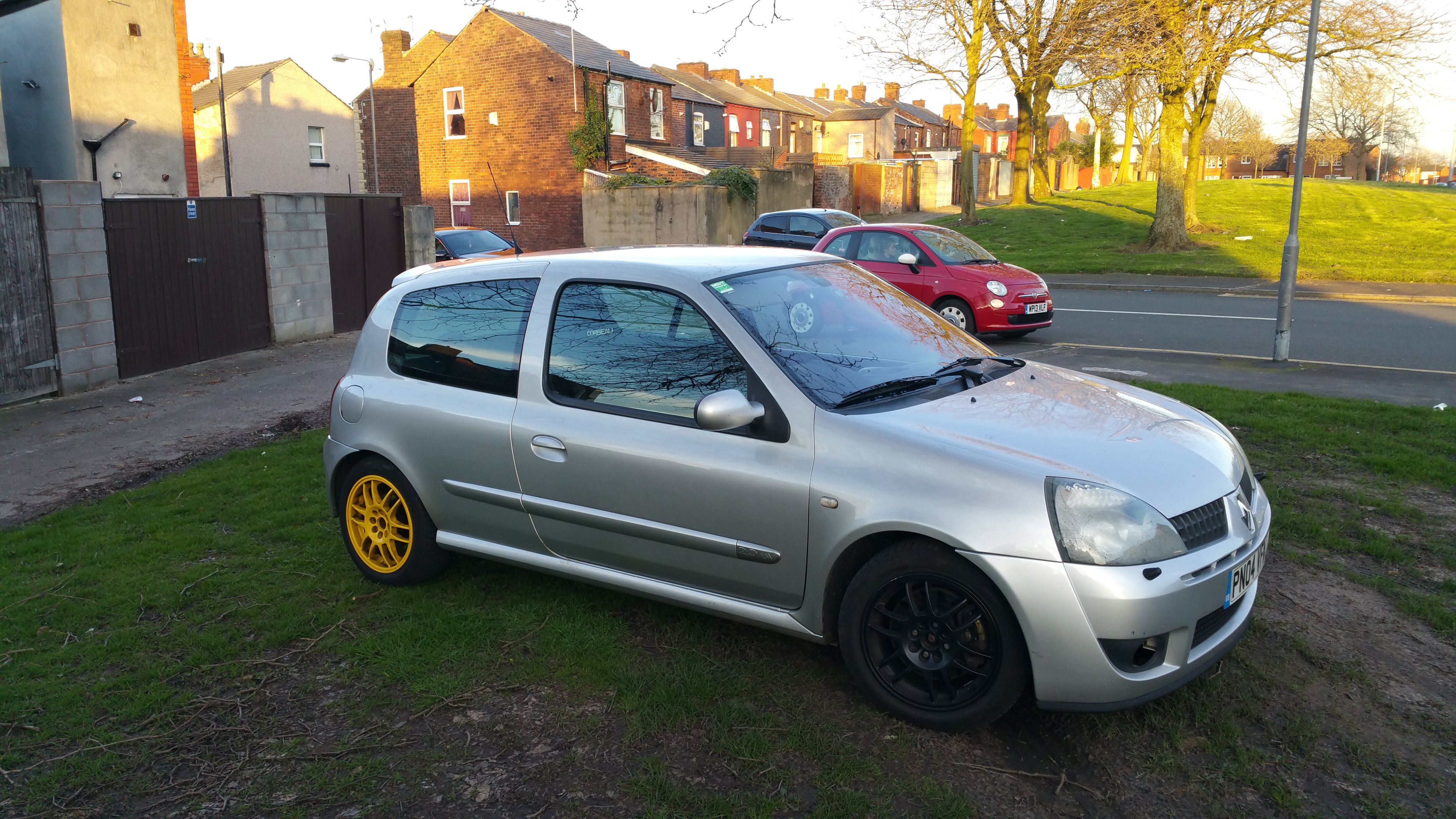

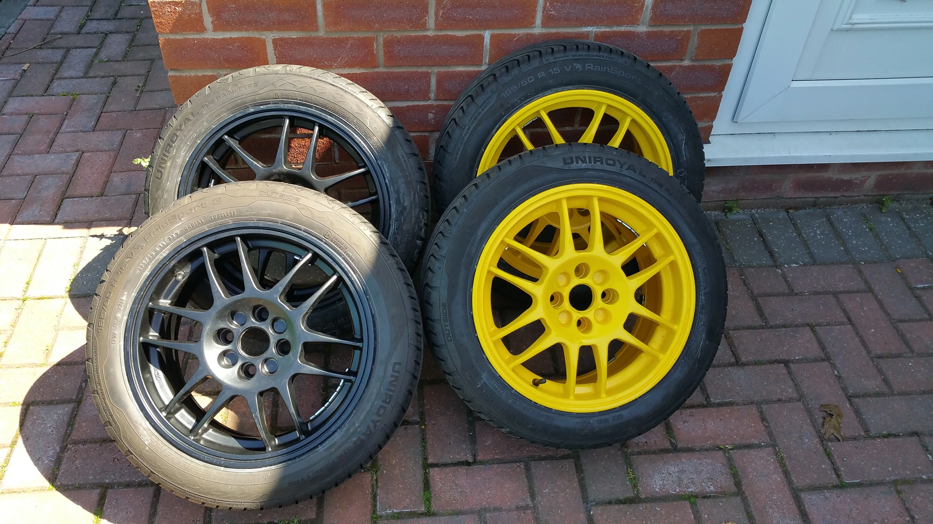

No idea why the guy specified 2 yellow and 2 black but there you go, I just wanted rid of the crappy Combrake kit!
Looked even worse on the car as well...

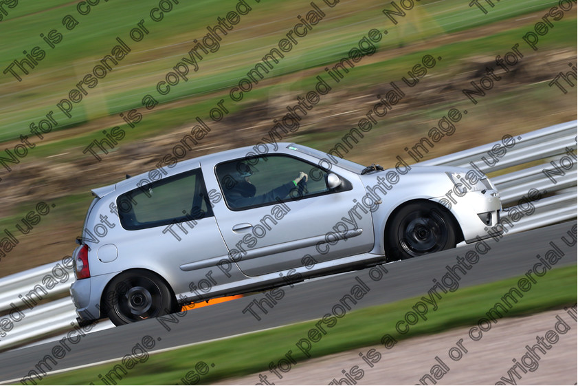

You can see the brakes starting to spark braking into Lodge, it was game over 2 laps after this.

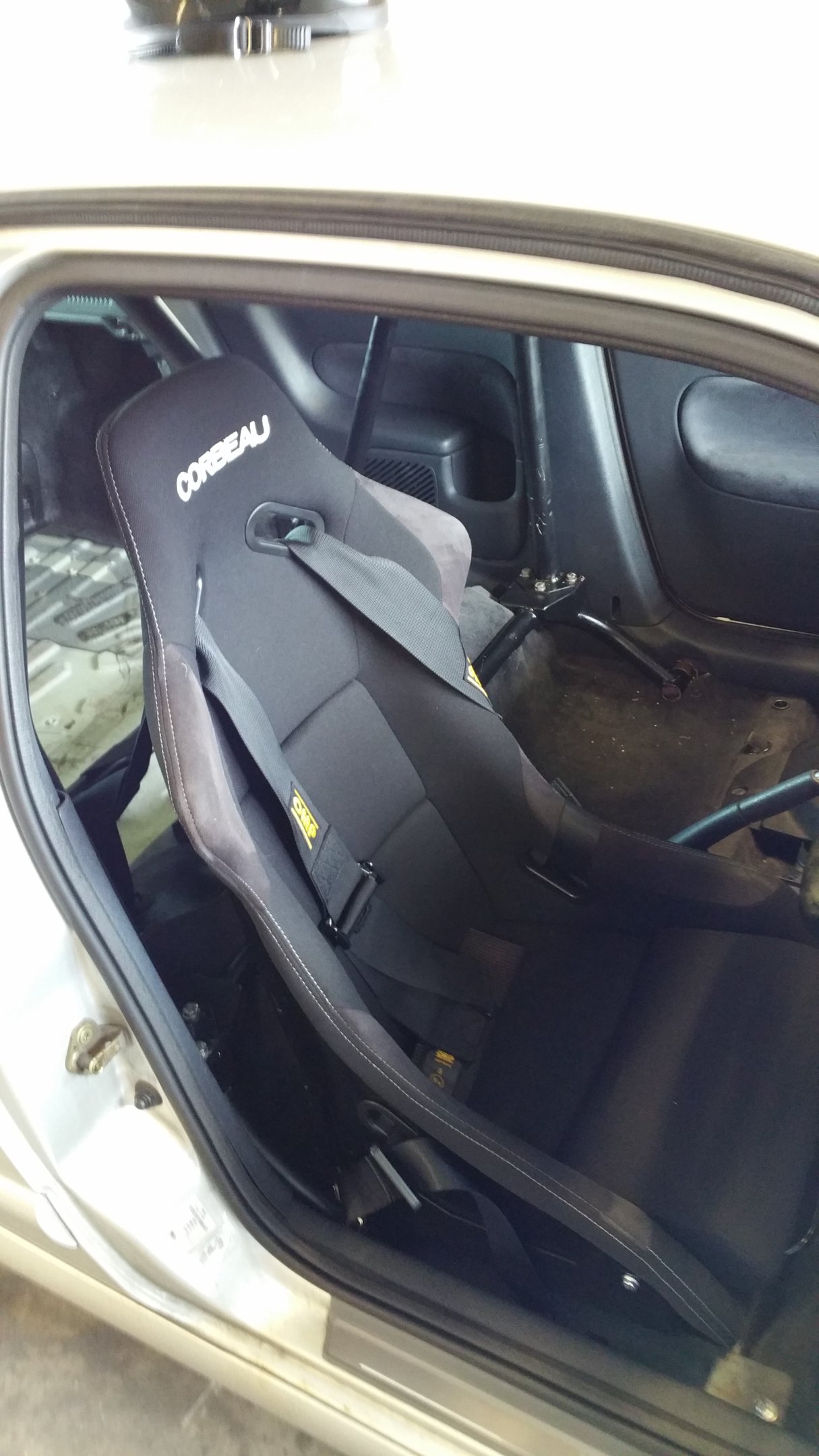

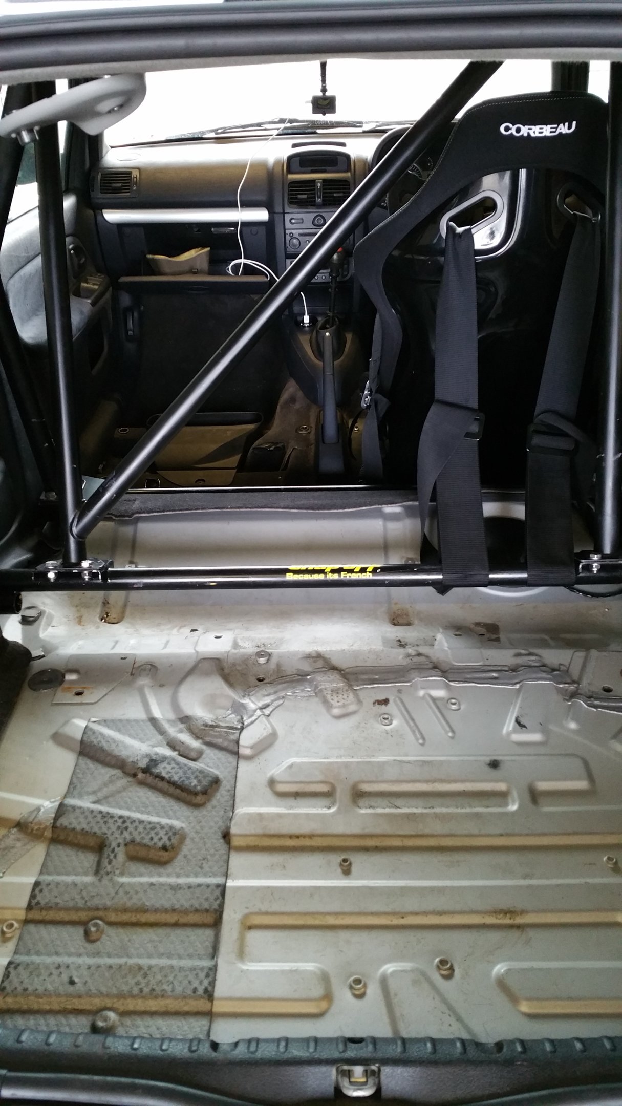

Next on my list was a cage, as I was really starting to push the car near its limits and just wanted that extra security. Didn't want a show cage and didn't really have the cash for a full cage but fortunately a MSV rear cage come up locally and a snapped it up. With this I also wanted a bucket seat and harness to really give us that confidence on track as with the OE seat and belt you really do get thrown about under braking a cornering, my mate especially being 18st and not really fitting in the car with the ride on feeling of the OE seat set-up. So purchased a Corbeau Clubsport XL, OMP 4M (3") harness and Jon Foz X-Low sub-frame.
Turned out to be a bit of a faff fitting it all with the MSV cage as it bolts directly into the OE seat belt points, so first of I had to chop part of the sub-frame off to accommodate the cage at the front mount points and then had to go and source some sort of brackets to fit on the inner mount points to attach the harness's to, so a quick thread on here explaining my issue the CS massive came up with this...its a Schroth B23A bracket.
I just got a pair of them and fitted them either side, with the inner bolted under the rear frame bolt, excuse the crap pic's.
