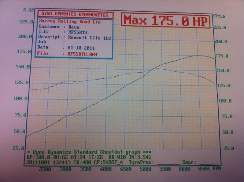

I'll put this one up for the RS2 Haters ;)
My good friend Sir dave's trophy - Remap, BTB cat-back, RS inlets, PMS aircon delete Kit & V6 airbox (Standard Inlet manifold)
So that's how many ftlb's laine, Oh yes 150 - for erm 200 rpm :)
At 2,500rpm its making under 120ftbs! Just in case you were un-sure :)
Then an RS2 car with the aircon still present -
At the end of the day this is all irrelevant as every car performs on different levels so you can never compare unless there's a before & after on the same rollers & on the same day, there was even a graph posted of a Catcam 438 car that produced under 190bhp :quiet: thought they all did 195+???
Dave hope you don't mind me using your graph ;)
that is an impressive torque graph!
