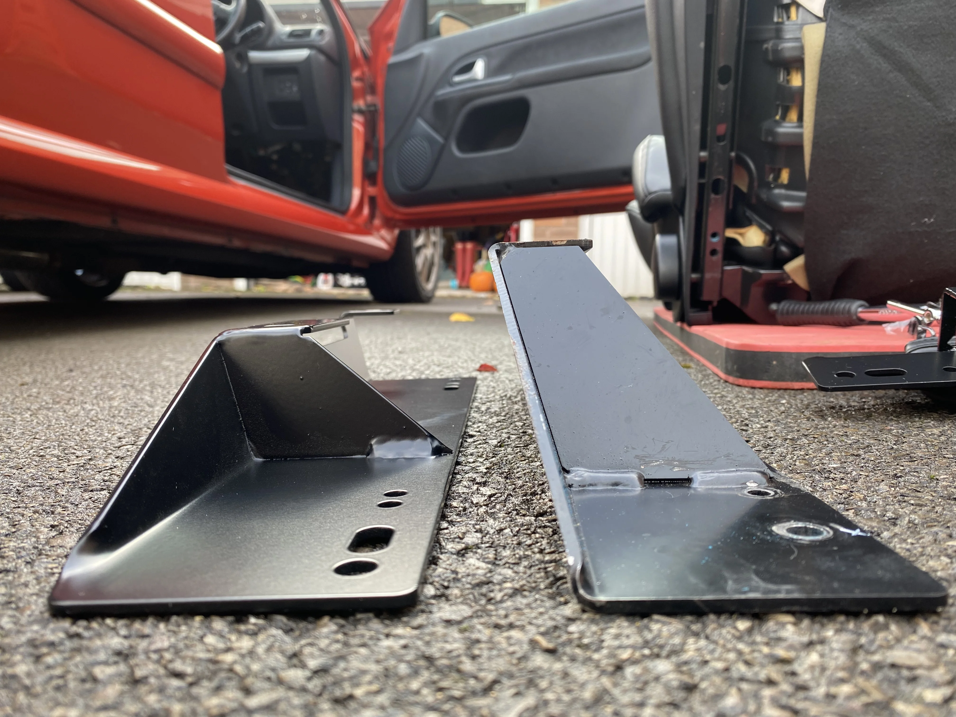

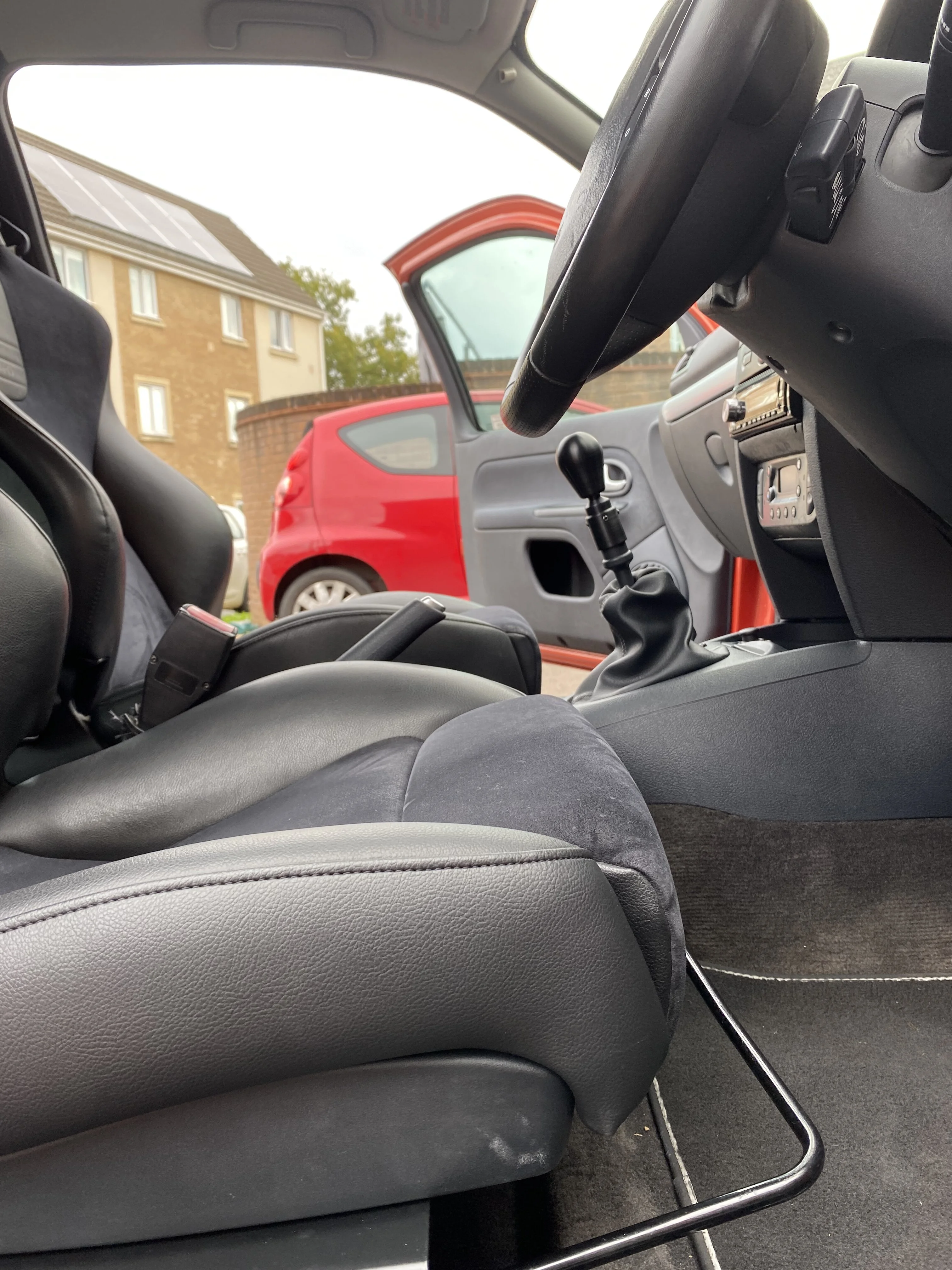

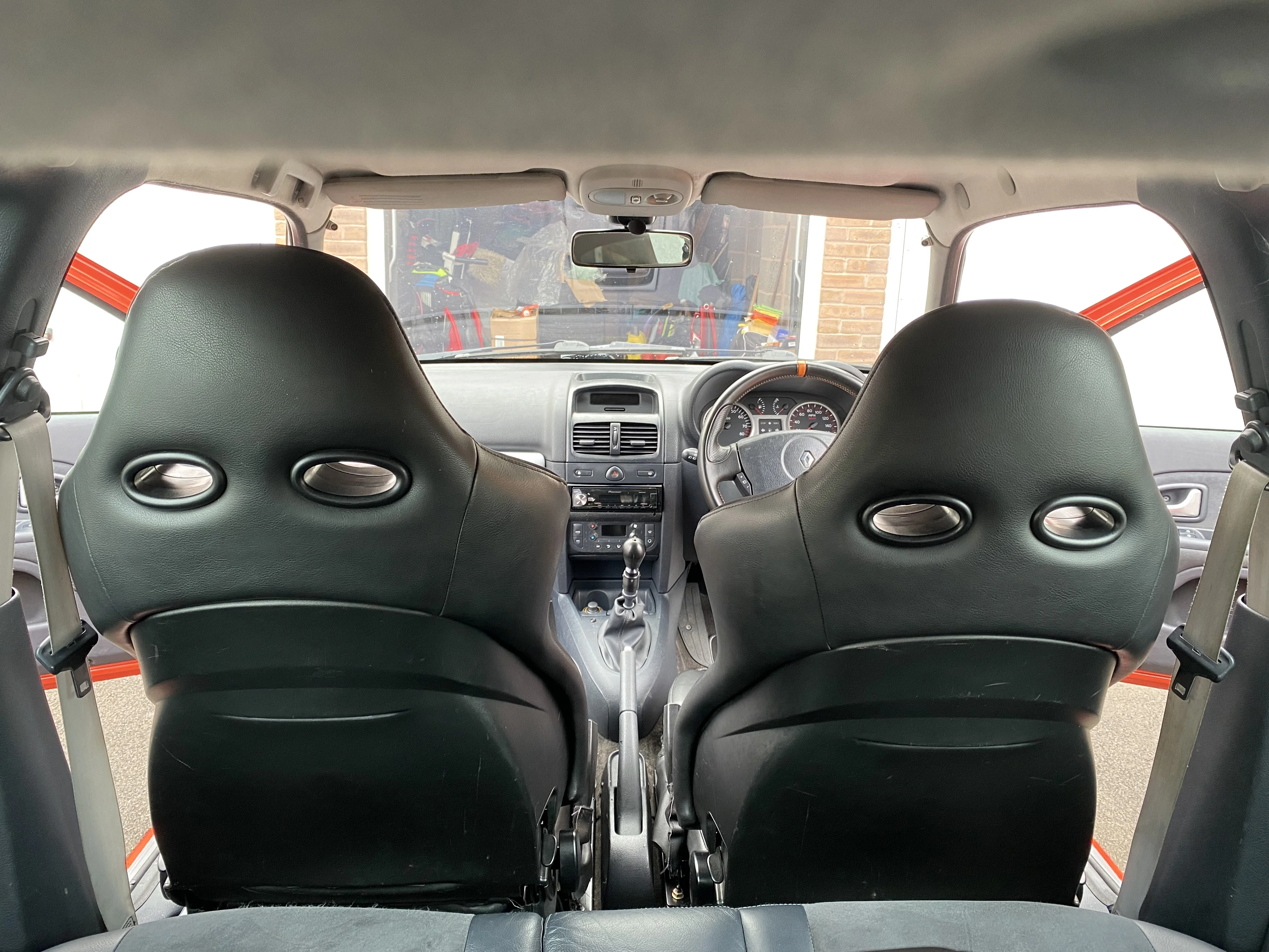

When I bought the car the previous owner had fitted Recaro Trendline’s and purchased new mounts from @JON FOZ but didn’t get the chance to fit them.
As soon as I sat in the car I noticed how high up the seating position was so I wanted to see how much difference they would make.
Wow, what a difference. So well made and adjusts the height perfectly. I have attached photos for comparison.
Highly recommend them to anyone who was thinking about it. Completely transforms the driving position.
