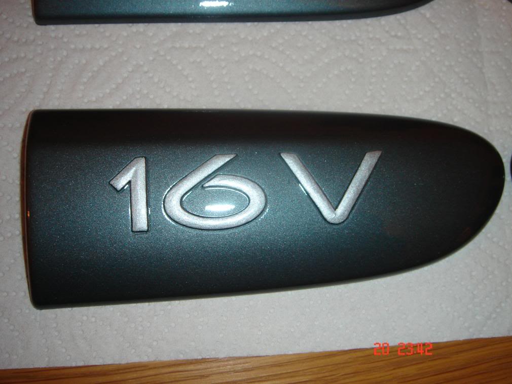

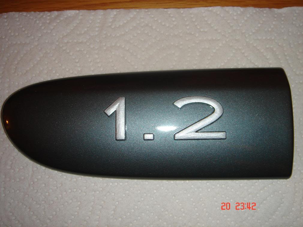

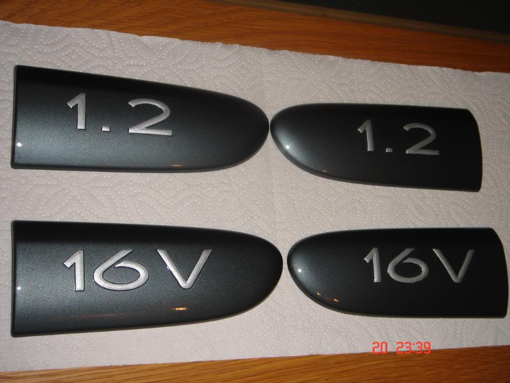

Just finished a couple different sets of badges
  titanic killer
what ya think?

thanks for the comments guys:D
i think im getting better at them every time i do another set
having a good brush and steady hand helps thou;)

without sounding dumb . . . what is the process of doing this and what materials are needed??? id like to give this a shot
  titanic killer
sand badges with 1200 wet n dry to give them a key for primer and also to get them smoothish then primer x3 then i use 2000 grade to get the primer smooth then x3 colour coats leave 24hrs then x3 layers of laquer
try it matey the first set idid were utter dog s**t but the next ones turned out pretty good
  Porsche Boxster987S
thanks bud. going to get some bought and have a go at it. cheers
