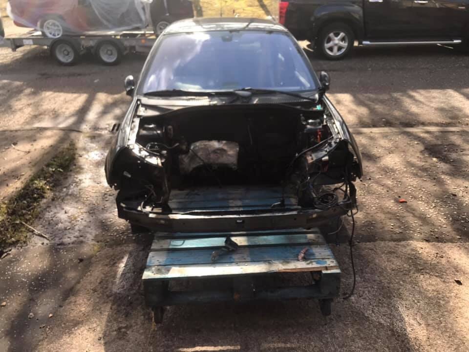

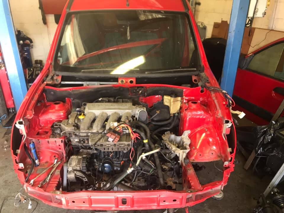

D David Stuart Car 2 Classic Minis, 182 Sep 10, 2019 #6 My mate in the middle of one just now. Started on Friday almost done my Monday. Sent from my iPhone using Tapatalk
