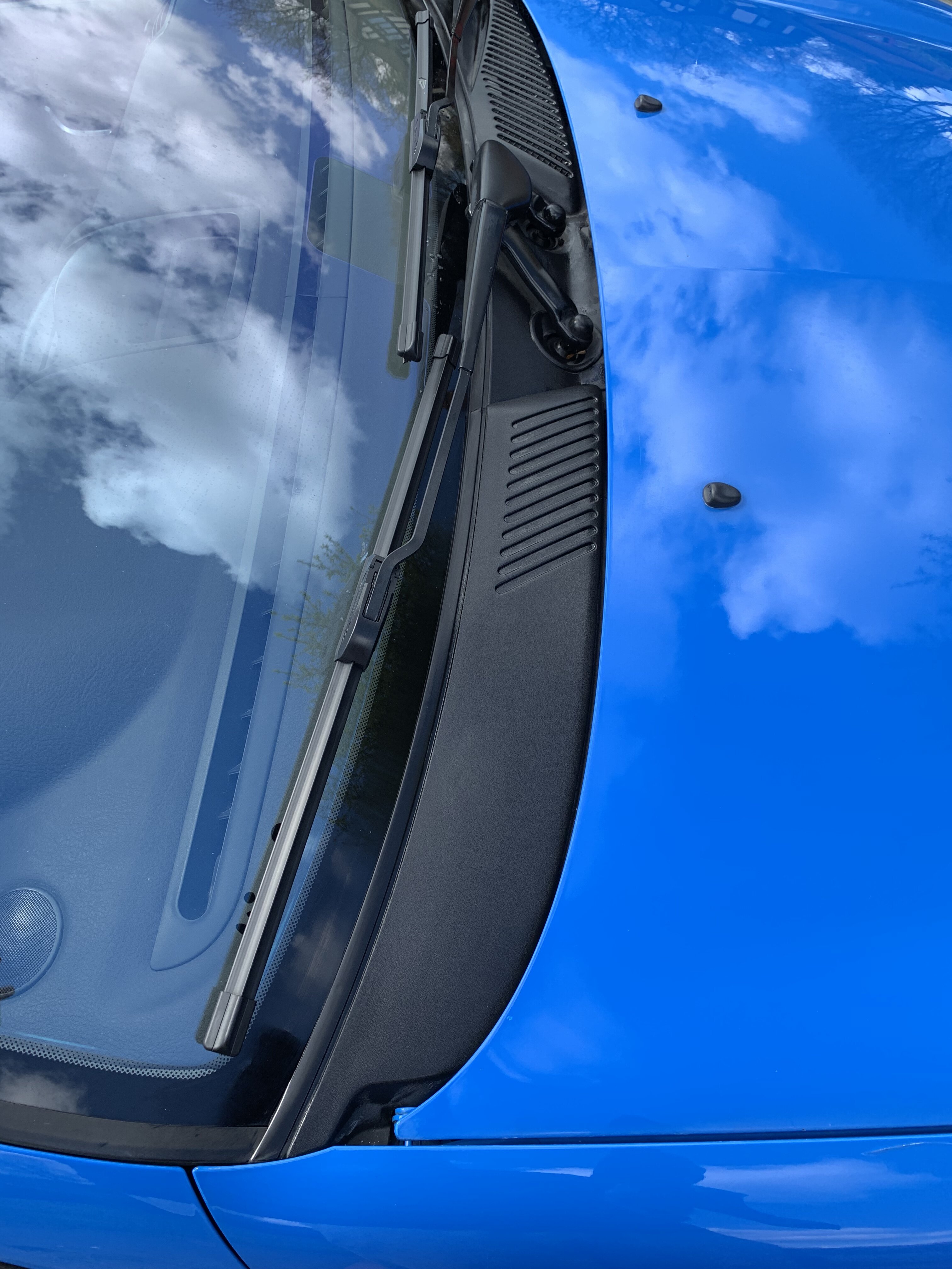

With a bit of a reputation of previous cars I’ve owned being better than factory condition & areas that are often overlooked it was only going to be so long before my previous nature continued with the Clio.
With the factory plastics looking rather faded and discoloured I decided while I had some time on my hands I’d coat the lot - (scuttle panel, mirror surrounds, front splitter, rubber window trims).
Shown a little 50/50 on the rear bumper trim with the before being the right hand side and the left being the after.

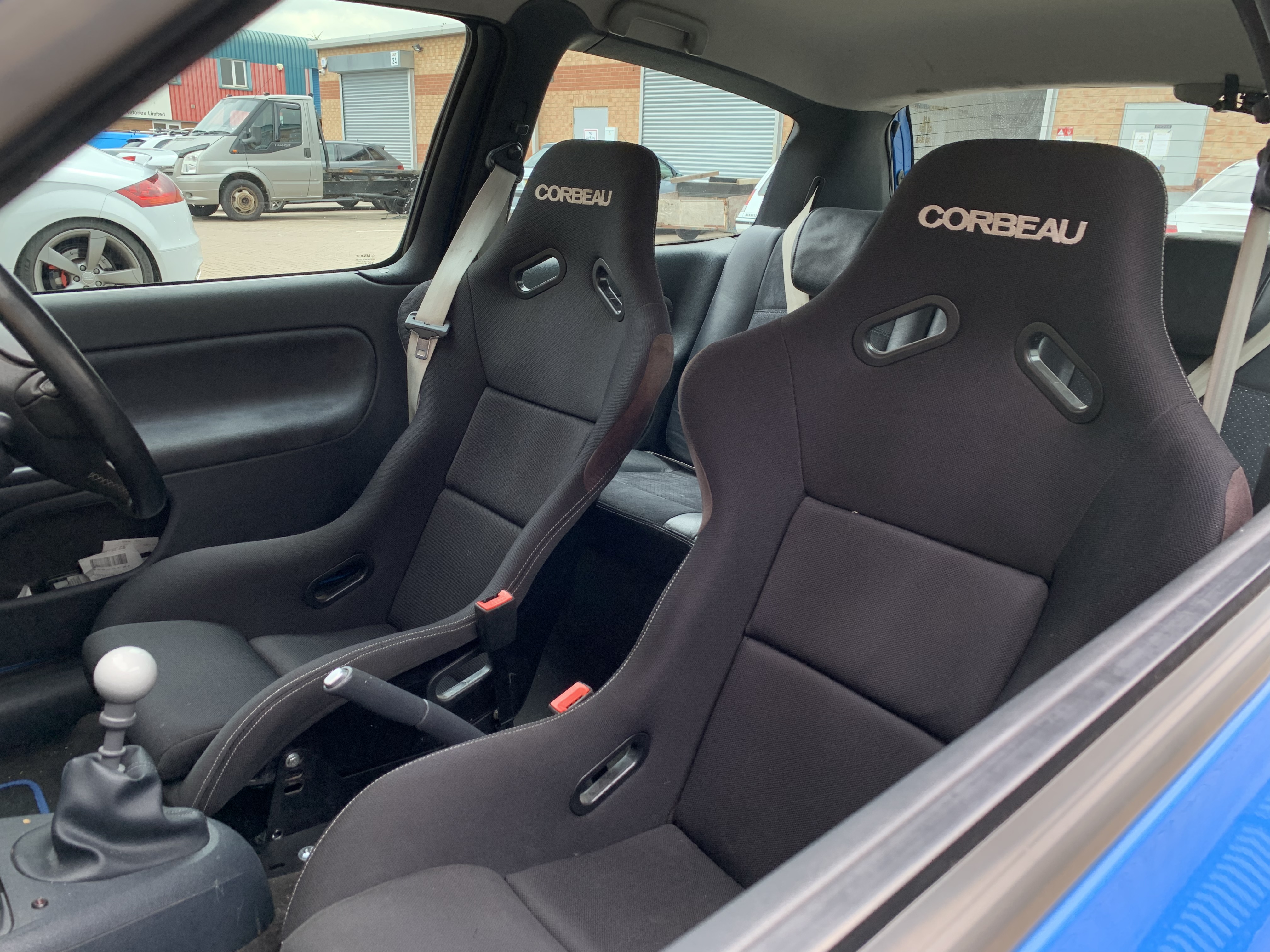

Finally, an update to the thread.
After what feels like an eternity since ordering some seats from a reputable online seat distributor at the back end of March, only receiving an update on my order two weeks back when I chased querying why it still said ‘paid - no delivery update’ on my order I was feeling a little deflated.
Add to that I then had to chase my refund as they seemingly ‘forgot’ to process it up until yesterday.
The update was as follows -
The seats were to be delayed until July due to factors outside of their control.

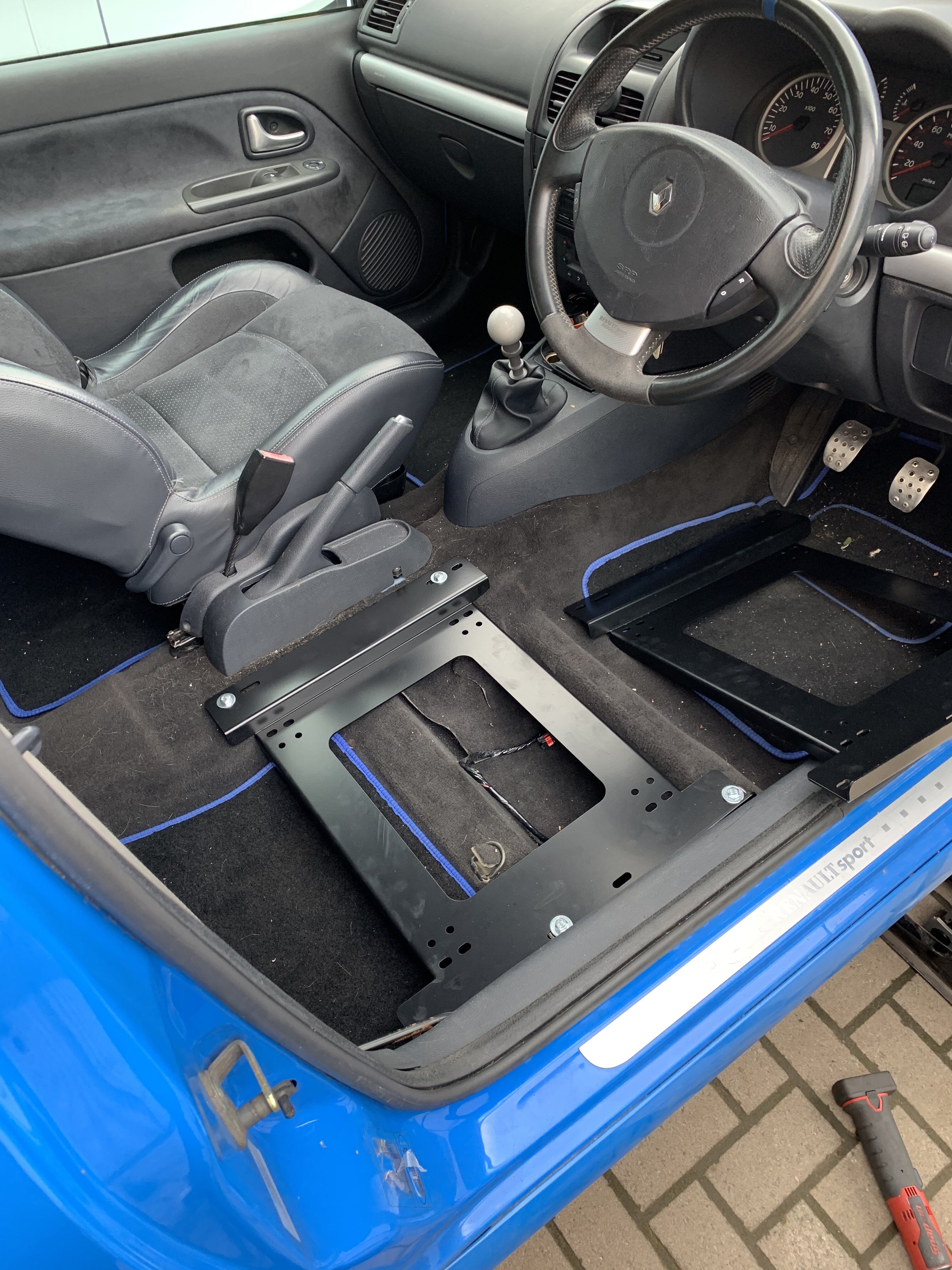

I was feeling a little fed up that my Jon Foz frames would be sat collecting more dust for the foreseeable.
However in stepped long term friend Craig (Supercharged Sunflower) who’s friend happened to be breaking their Clio which happened to have a pair of Corbeau Clubsports needing a home, so without a seconds hesitation I shouted BINGO!

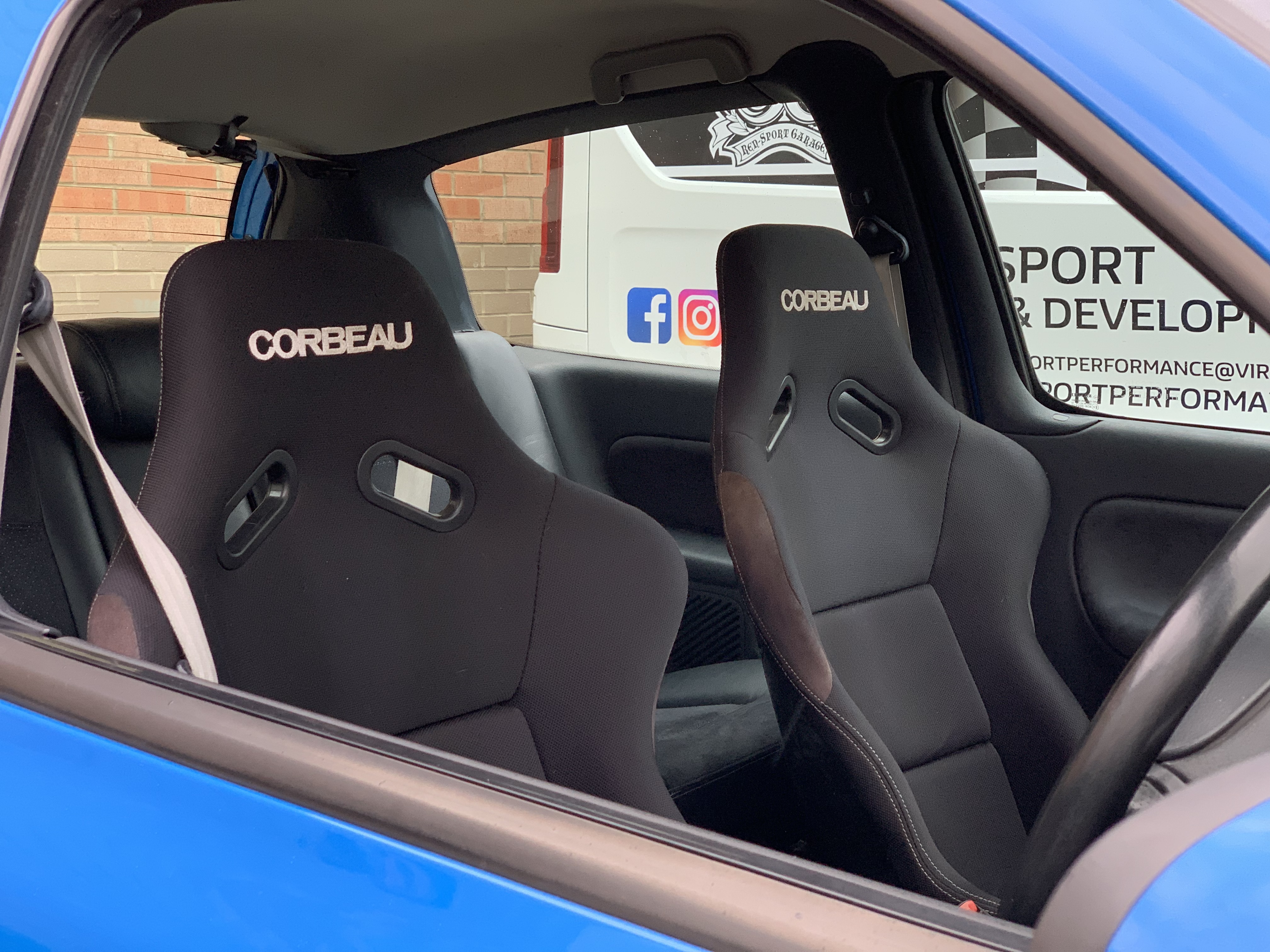

Fast forward a week (today) and I’ve travelled a little over 2 hours to collect the seats and swap out the factory half leathers while I’m at it.
Big hefty cumbersome things removed, slim lightweight supportive seats fitted.
A bit of time tweaking the driving position to ensure I was central and at a comfortable distance from the wheel and pedals.
Success.

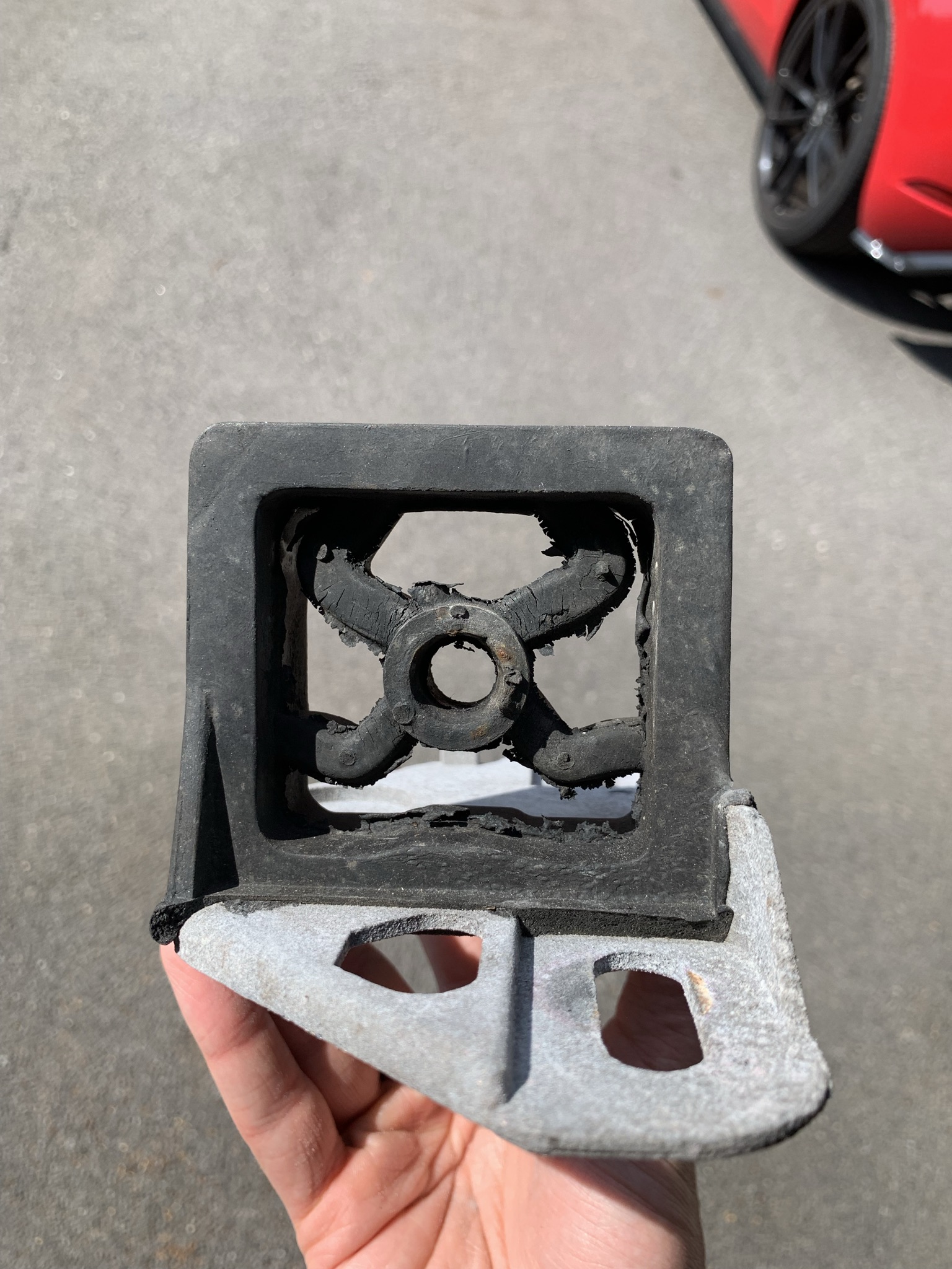

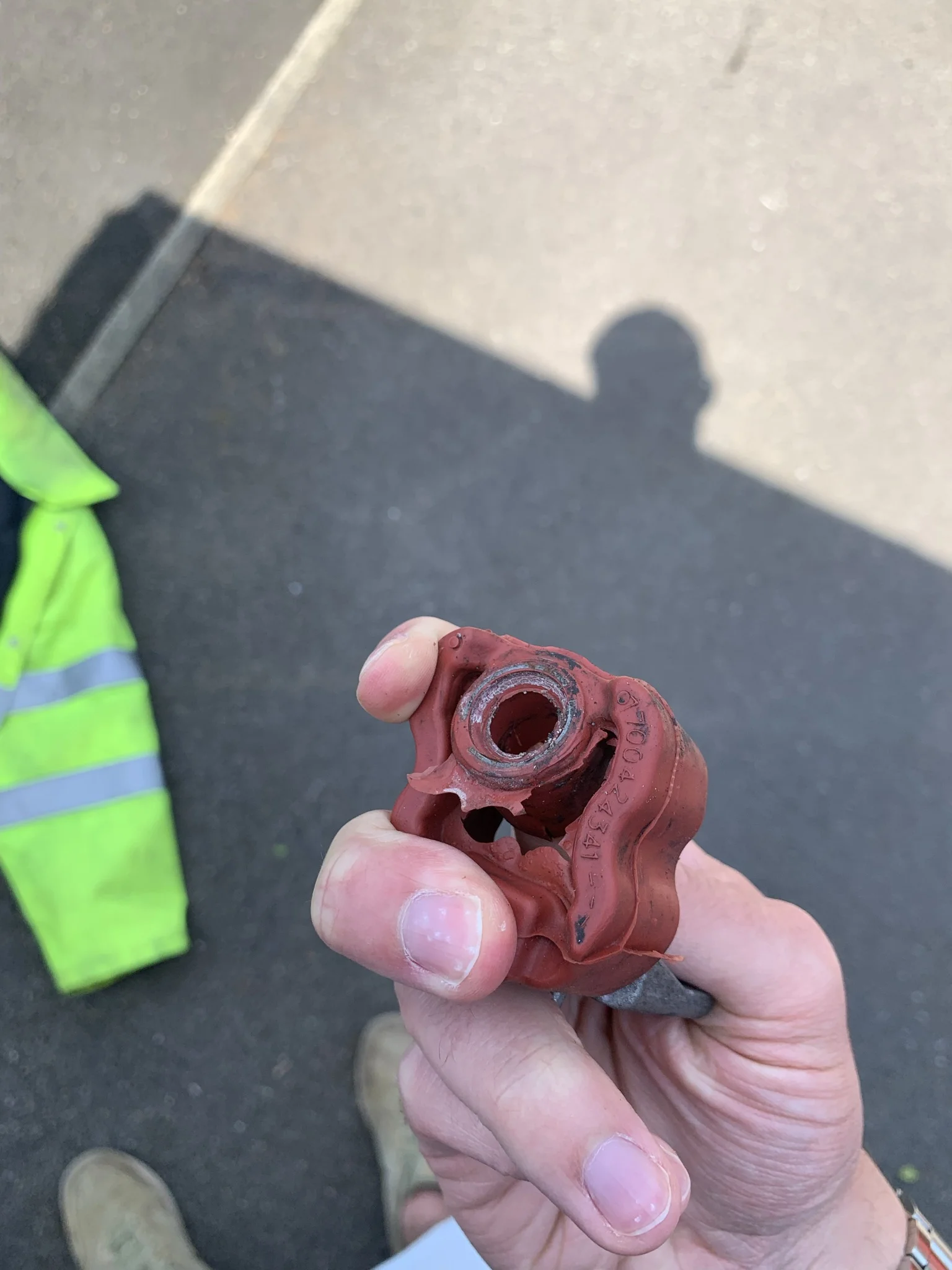

Car developed a rather annoying rattle while out on a drive last weekend, suspect heat shield.
Given the car had a Milltek system fitted in late 2020 I assumed, wrongly, new mounts/bushes would’ve been fitted….how wrong I was.
Hey-ho, a quick look under the car confirmed that the rear mounts had failed. A quick game of message ping pong with BTT Motorsport and I reserved 2x rear mounts and 1x centre mount for collection the next day.
Fast forward to Tuesday afternoon, I’ve been and collected the mounts and 30 minutes work all swapped over 🤙

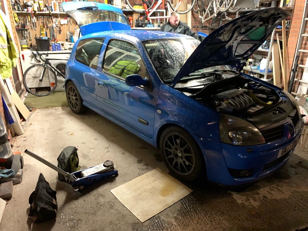

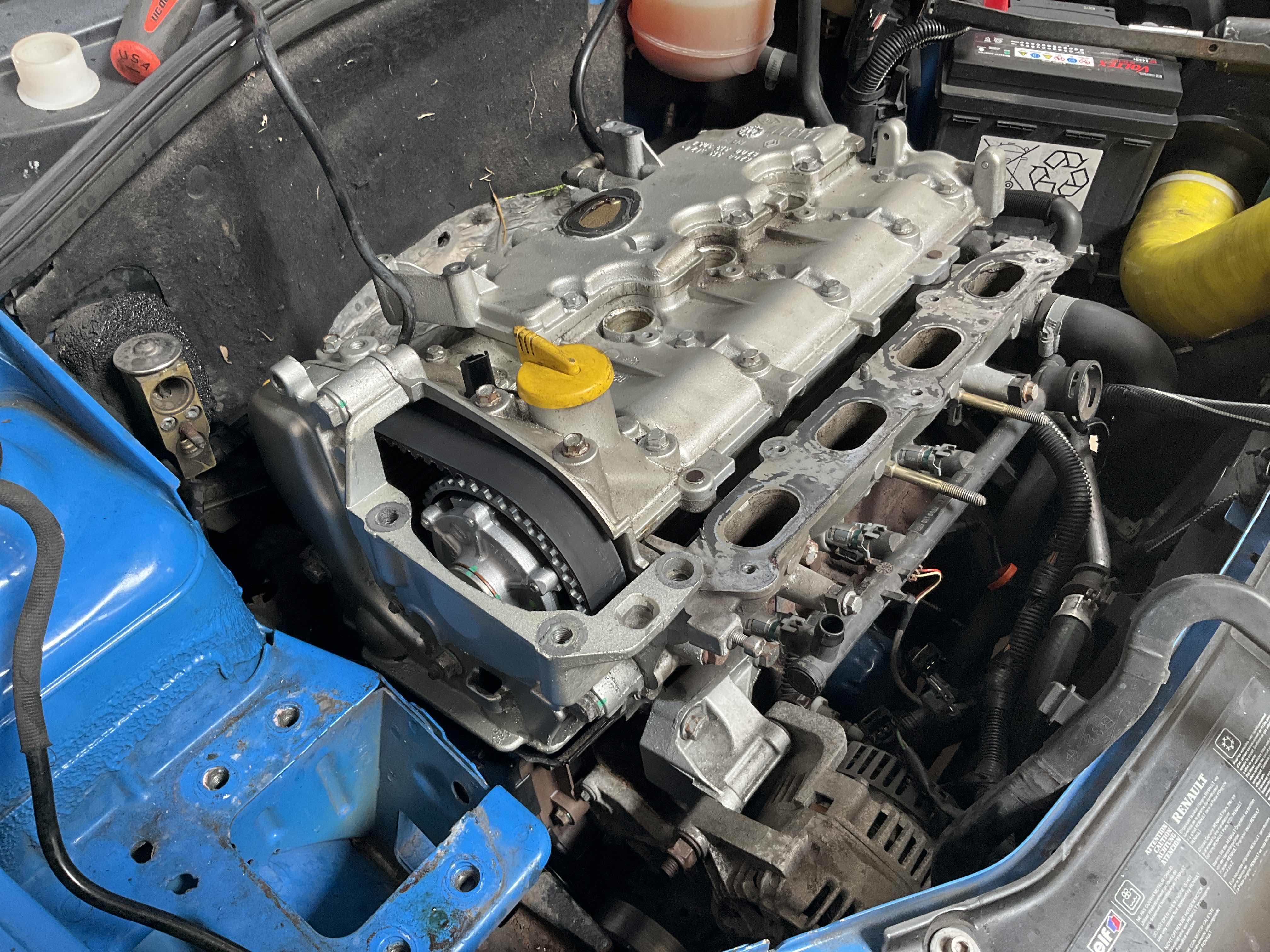

So almost a month has passed since the car was diagnosed as low compression.
However, something just wasn’t sitting right with me. The car drove perfectly minus the misfire at idle and a slight bit of hesitance around 2k rpm.
No blue smoke on startup nor through the revs.
I wasn’t convinced the car needed an engine so I had a second compression test carried out by another local garage, with myself present to review the results real time.
The car made 190 across all four cylinders, quite the difference from the initial compression test.

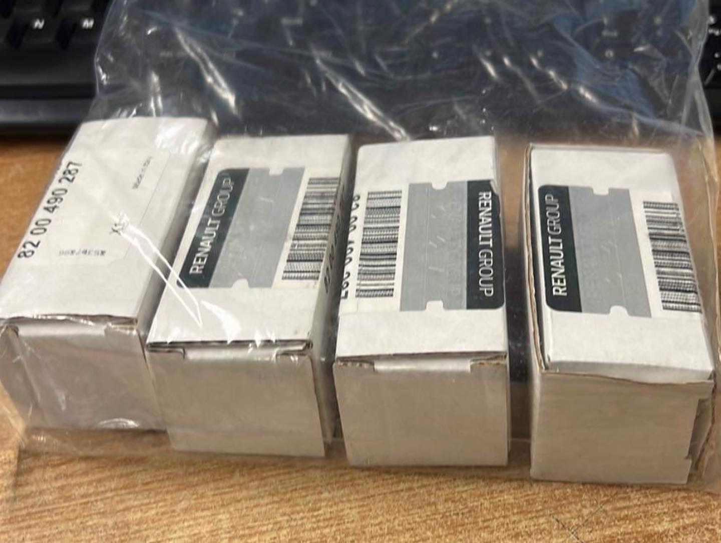

I then got in talks with a now good friend regarding looking at fault finding this issue. We had a lambda fault related code on a code reader so quickly replaced that while we had the chance but also decided to test a spare set of injectors he had lying about.
Low and behold. The car fired up with no issue, left to idle for 10 minutes and no sign of the flashing EML so a road test was in order.
The car felt like a different car entirely, buttery smooth throughout the Rev range and no hesitancy at all.
Total cost - £150 & a few beer tokens…quite the difference from the initial ‘new engine required’ diagnosis.
